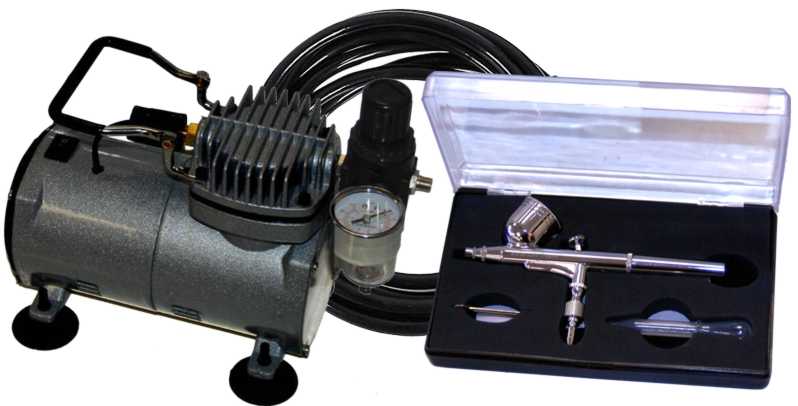

I found it for $100 shipped, came with a compressor and airbrush. It works great, I used it on my armor just last week(which you see in the US Med green thread).
