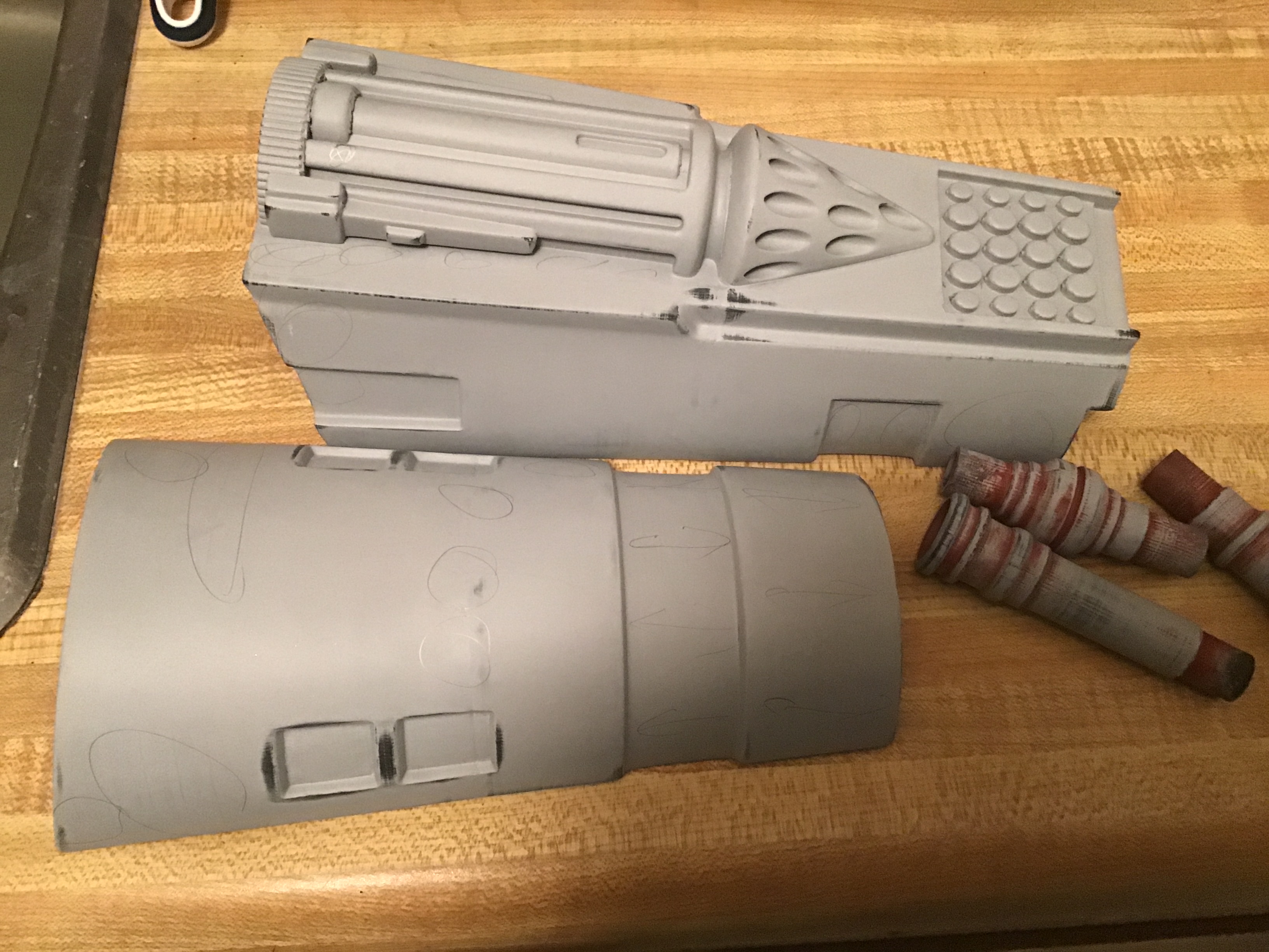

No pics yet. But I am plugging away at the filling and sanding of print lines in the beskar armor parts. The only Stuff I have at home right now is my left gauntlet and the gunsight parts for the Amban sniper rifle:
Pencil marks are areas where I still have print lines showing.

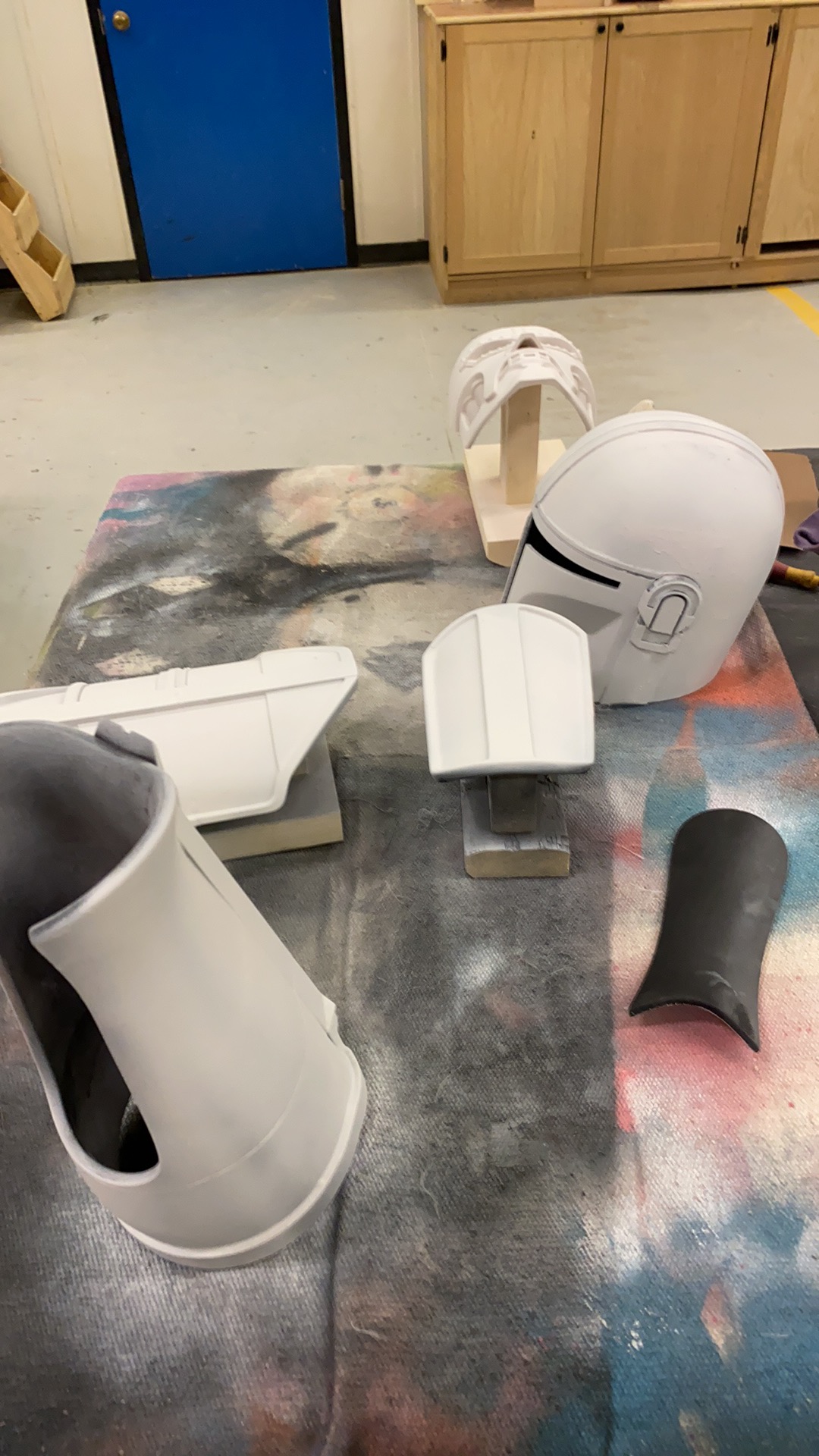

Helmet is on its last round of sanding and filler primer. Beskar chest and abs are moving from resin epoxy filler to filler primer and fine sanding. Shoulders need to be reprinted as they are too big. Right gauntlet is currently printing as I type this.

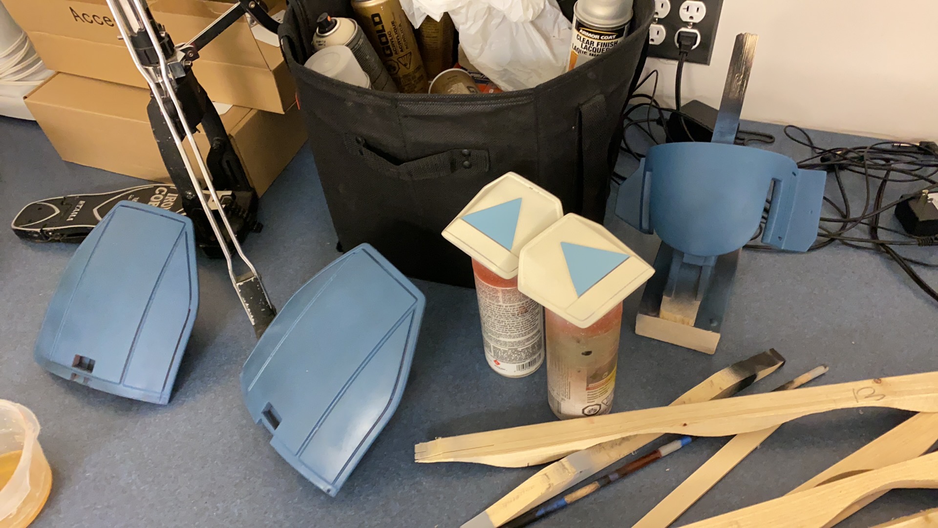

Hand covers and hip covers are finished and painted. Knee and shore trooper shin just got their second coat of resin epoxy as their print line filler.
I want to get all the non-beskar parts fully painted. I am going to clear coat everything all at once with special and fancy rattle can 2K matte clear protective finish. Then they need to be weathered.

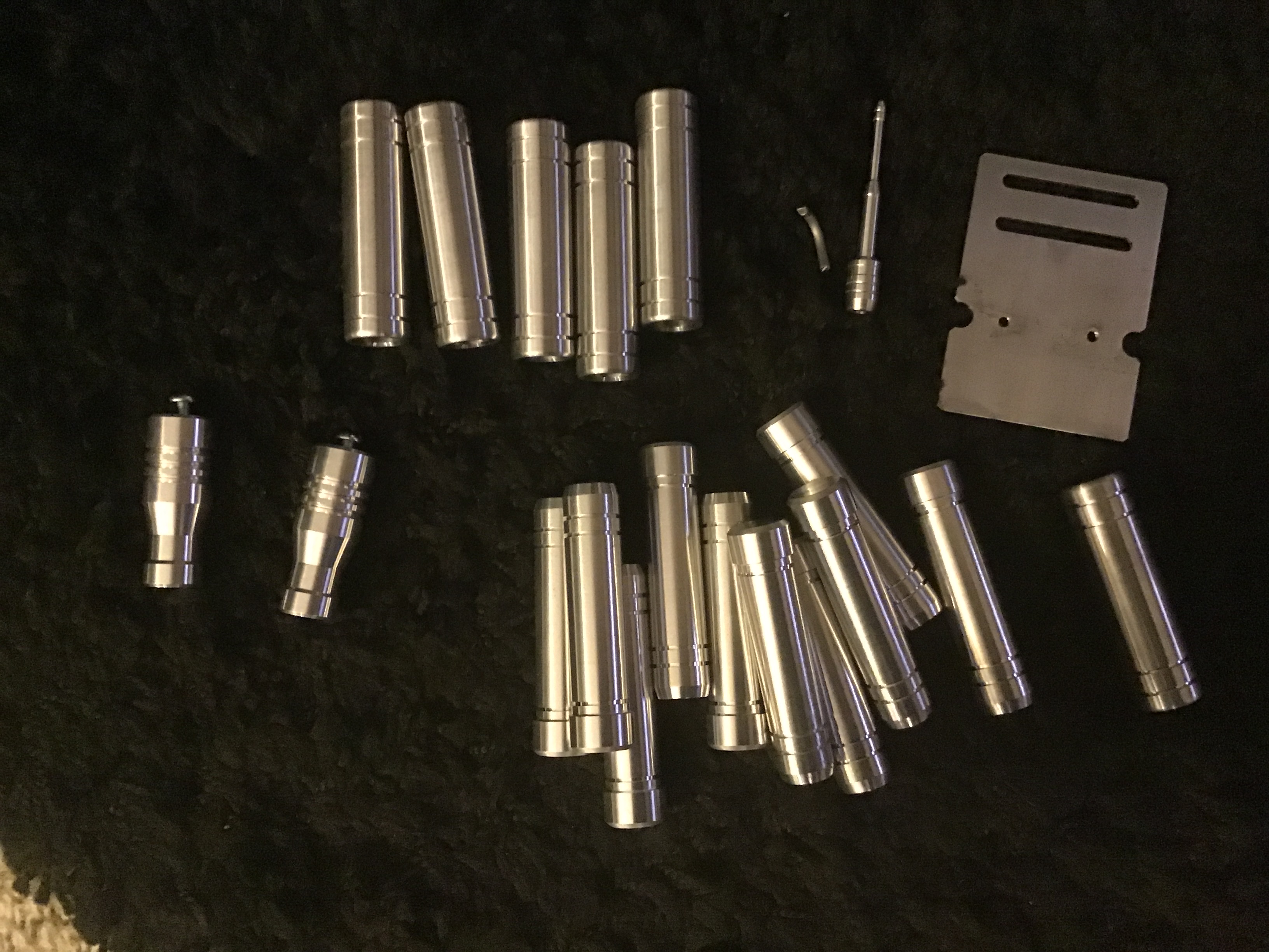

I also got this shipment of machined aluminum from ThinkBox Mfg on Etsy, on BKBT’s recommendation. I’m hoping they will also do the rectangular bandolier buckle that the sniper rifle sling clips onto. (And maybe a beskar spear? Or some beskar ingots? And maybe the demolition charge belt holster? )

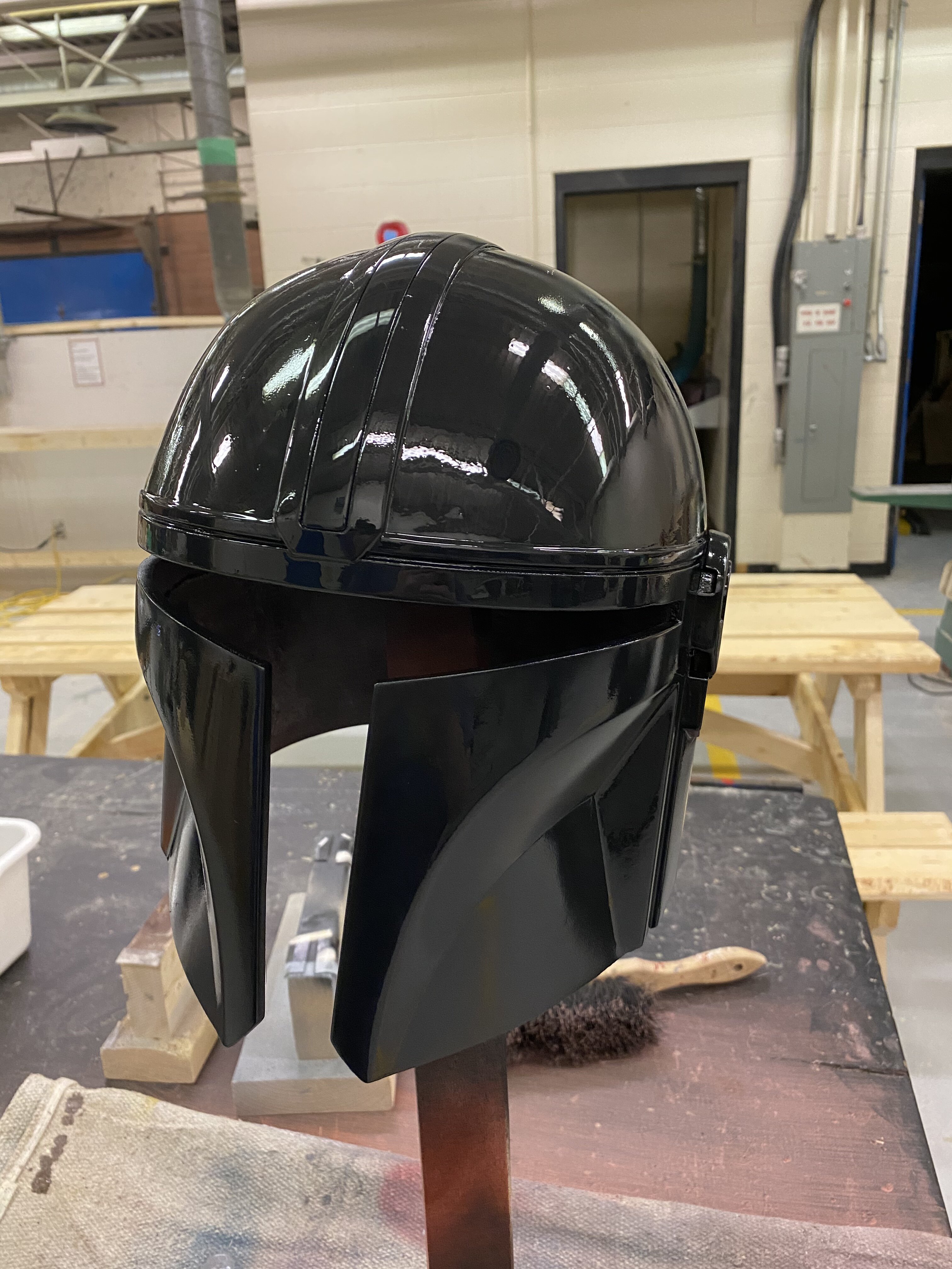

3. This helmet was a pretty bad print. There are huge gaps where the nozzle under extruded all over the helmet. I’m concerned that it won’t take a hit or drop without breaking. Best leave it as a practice or display helmet that I can experiment with. I sprayed it down with some Duplicolor flat black, then emptied a can of Mr Hobby Super Clear Gloss onto it.
My Duralumen should be here in the next day or two. I may try it on this, but I want to save enough for all of my reprints. I do have some Alclad Dark Steel that I can use instead, given its now a display helmet.

These are some of my finished non-beskar parts and some in-progress parts. The other helmet is one that one of my shop students is working on.
