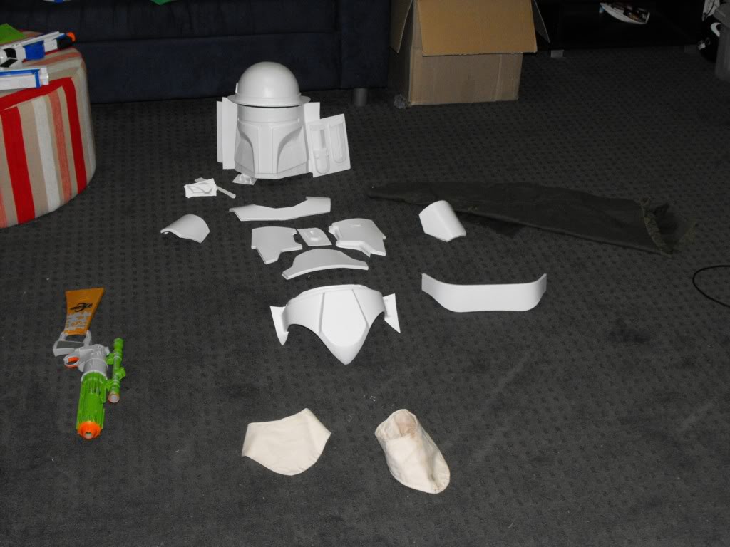

Hi all. Before I can start my ESB Boba I have two kids costumes to build, a Republic Commandos (Boss) and my youngest sons ROTJ Boba. It will give me a chance to test my painting skills before I tackle mine.
I got some kids armour from Greg kidsclonearmour. The Republic Commando for my other son which is about 80% complete just needs final paint, weathering and webbing. The kits are great and easy to work with.
I have a set date in mind the first week in August to have them both completed. They have book week at school where on one day in the week they come dressed in their favourite book character and the costumes get judged by the principal. Well this year the boys want to win :D They want me to come along on the day in my TK to help them. With that said I have just over two weeks left to complete my task.
Just wating on a couple of things they are the gaunts, knees, back plate and jetpack all are coming by the end of this week, fingers crossed. Just have to source a kids jumpsuit which is pretty difficult. I have a vest and a few other things left over from my Boba purchase but they will need to be altered to fit him and have to make some shoes based on one of the great tutorials here.

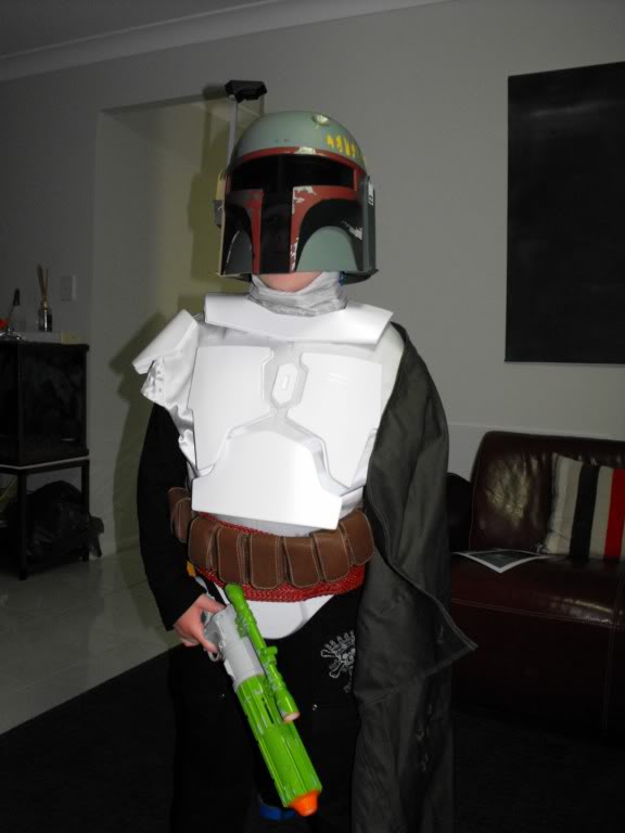

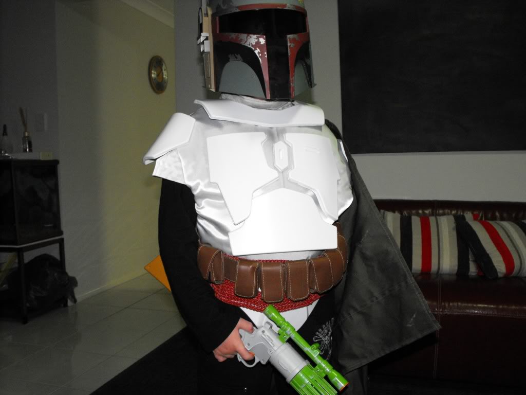

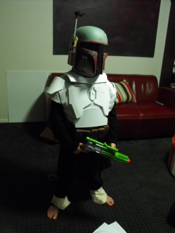

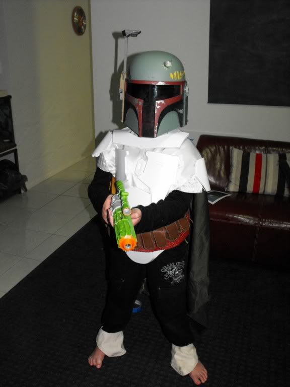

We did a bit of a test fit with the little Fett. Tried on his soft parts and double sided taped his armour in place temporarily. Will have to pin and dart up the vest and need to fix the girth belt, probably just industrial velcro. Have his boots which need painting and the toe spikes added and some piping to make them look like Boba boots. If the rest of his stuff doesn't make it from the states in time he can borrow my knees and will have to make do without gaunts, back plate and jet pack for a little while. Have sorted out the paints for his helmet and armour which are pretty close as we can't get the exact pain matches here in Australia. The helmet doesnt have a dent so trying making the dent by slowly heating the area and pressing gently into the plastic and sclupting it. His hasbro blaster will be the last thing I paint if I have time. I will be taking a lot more off the return edge of his body armour to make sit closer to his body.
Any tips from the other Fetts out there or Mandos on how the armour should sit would be a great help.
In the pics we used his hasbro helmet because there was some glue drying on part of his helmet.

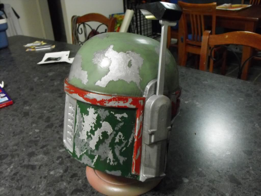

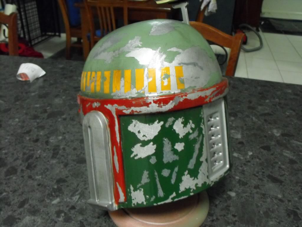

I have looked at a lot of pics for the helmet and I am at a bit of a loss to come up with a final colour scheme. Some pics show a red 'keyhole' at the back some silver same for the right ear some show silver and some beige/goldy colour. I would like to get it as accurate as possible for the little guy and for me. So any help would be great.
Myself I am leaning to the silver 'keyhole' and silver ear combo, but would love some of the experts opinions please.

The ears and the rear keyhole on all Sandy helmets (ROTJ, Pre-Pro 2 and Sandy) is 'metal' and that red you saw on the ROTJ helmet is also right: I think it was painted partially with red (and other colors?) then sanded to the silver layer. And for painting the helmet you can use my ROTJ helmet stencils as base, but you'll have to do some tweaking because of the size and shape of your son's helmet.

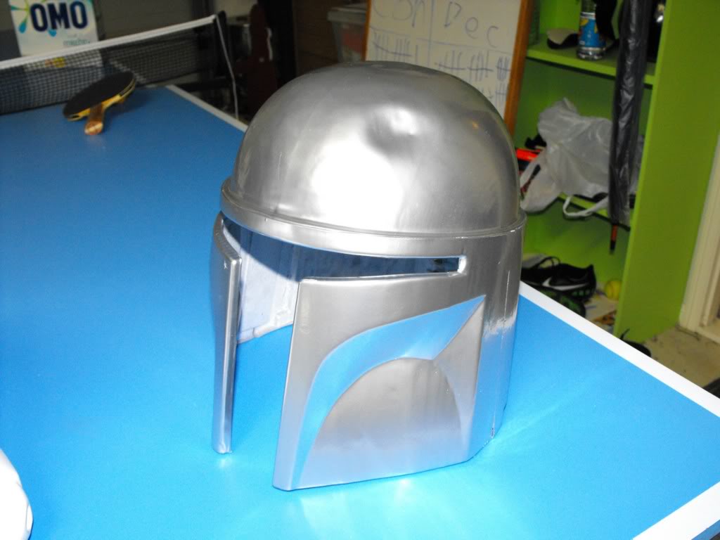

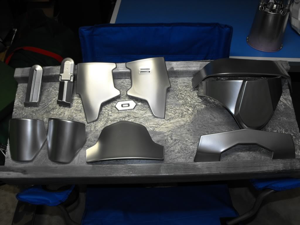

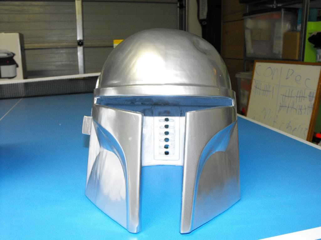

I got the dent in the helmet and it looks pretty good if you ask me :) I primed and painted the helmet and all the armour today silver. Will be attempting the layered painting system, as I want to do that for my Fett, so why not test it out on my sons Fett. I have also made his boots just need to get the toe spikes cut and painted. My wife is doing his wookie braids we asked him what colour and he picked, blonde, brown and green and interesting colour combo :) Will make the adjustments to his vest this week so I can locate his armour pieces and get the velcro on. We are also dying/fading some clothes for his jumpsuit. At this stage just a pair of cargo pants and a shirt, will look for a jumpsuit later on. Not much to show but will mask out his armour this week and get some pics.

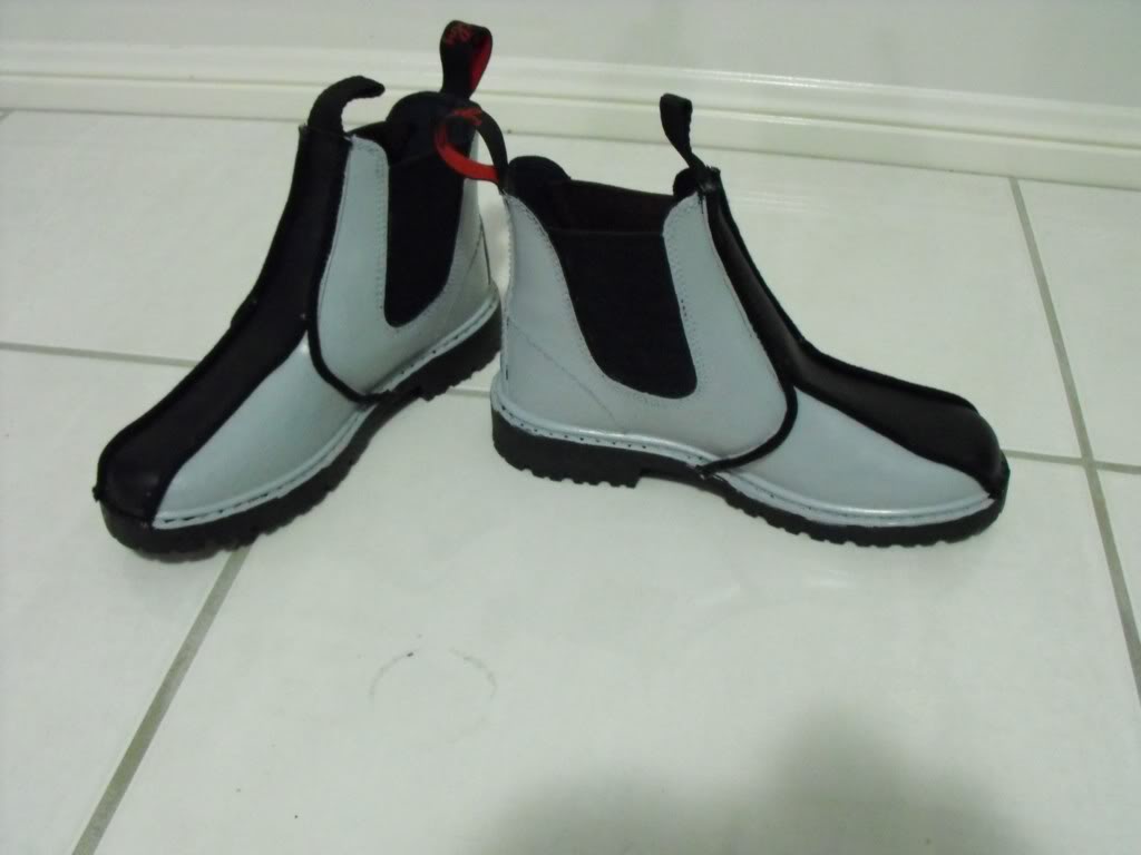

And made up his boots...just need the toe spikes which will be out of dowel painted silver and I have the aluminium bar to cut and bend. They arent 100% accurate but they look the part.

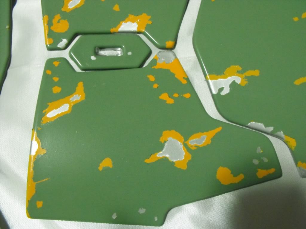

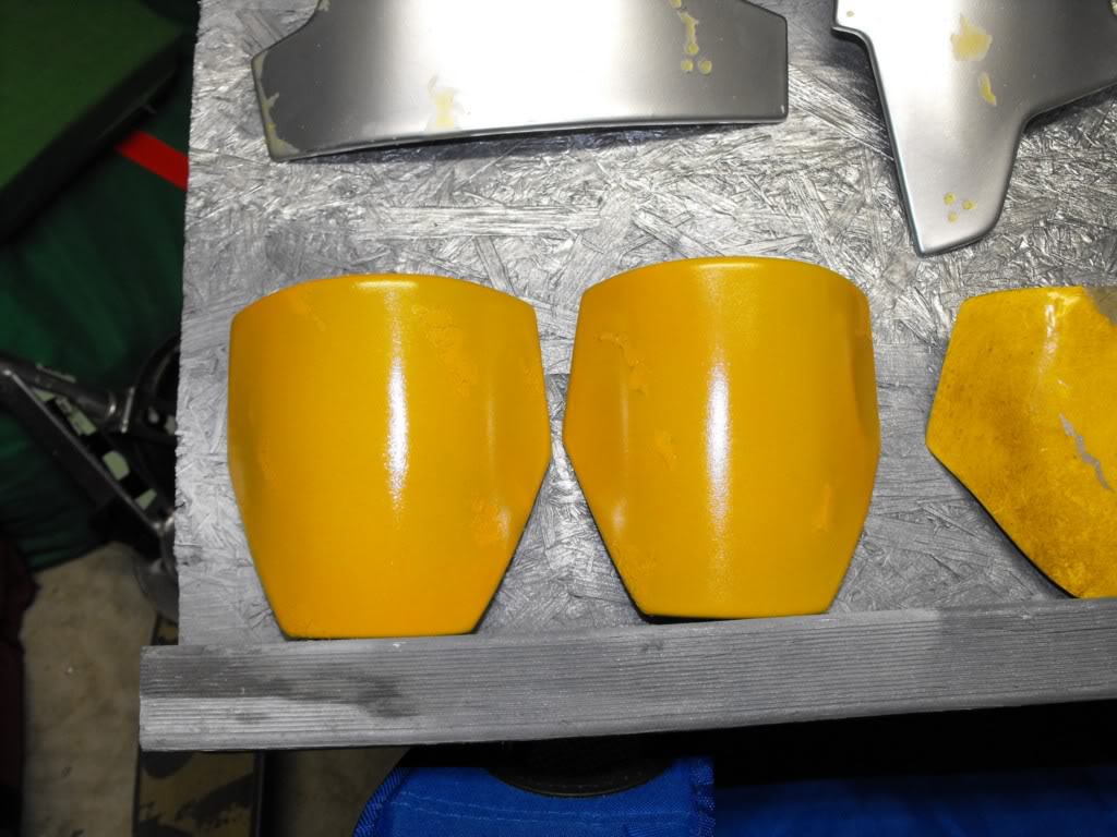

Did some trial painting tonight in a the heated garage. I am going for the layered technique for the paint job.

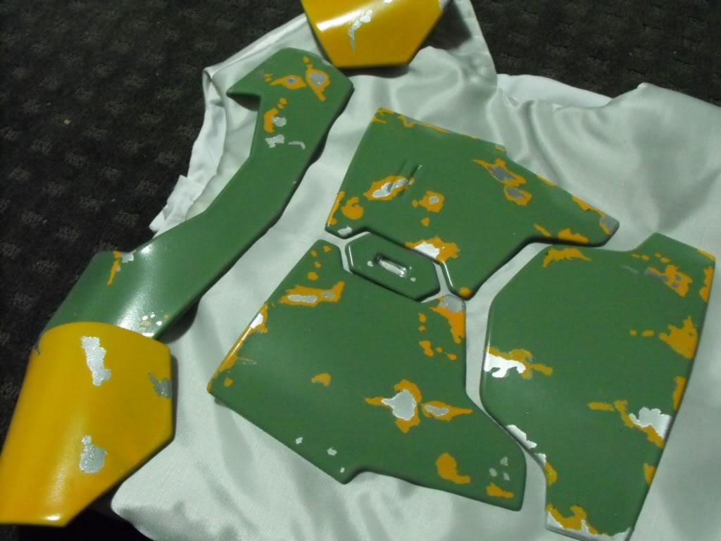

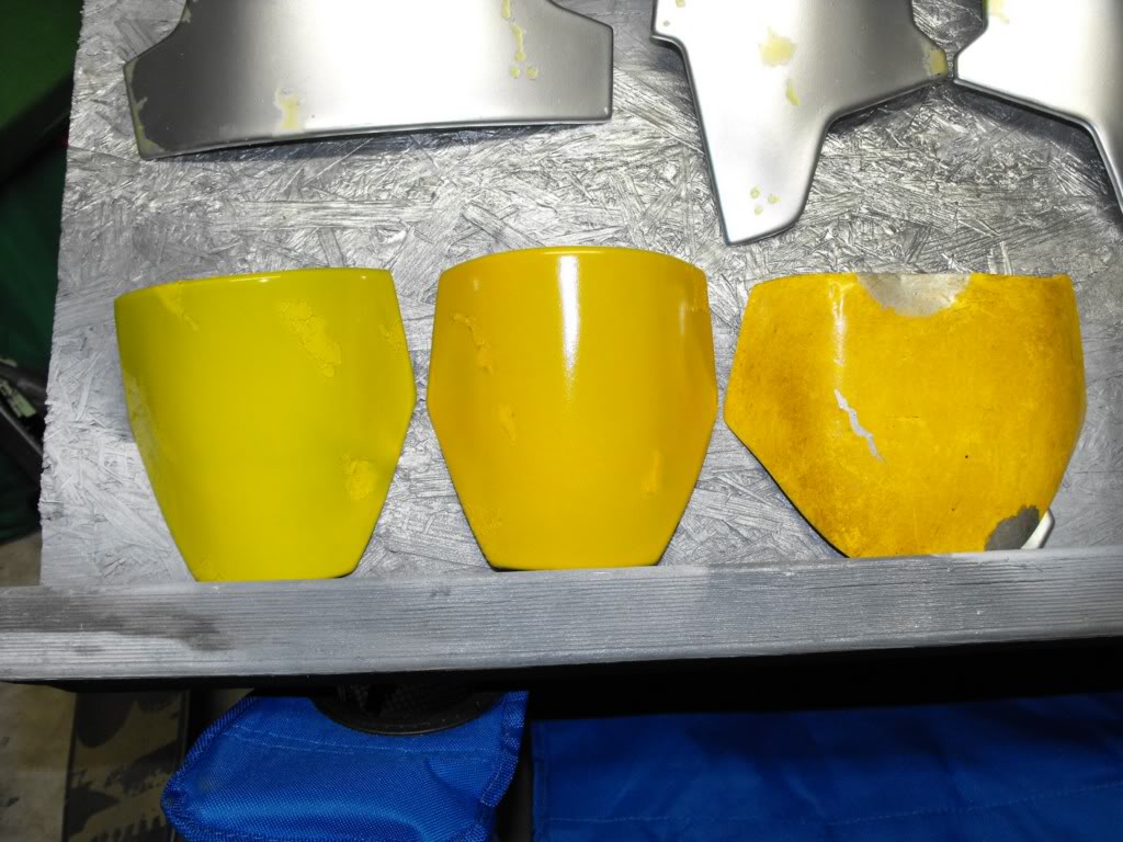

First attempt with the yellow which I thought was a close match but when sprayed on the armour :( no good way to yellow. I was kicking and cursing myself, I should have done a chest piece or something where it wouldn't be seen as much. Then I looked at all the spray paints I have and I misted the yellow with a yellow/orange and well I think it looks ok will be weathered with acrylic wash but 100% better than before.
Pics with my shoulder for a reference.
First try with plain yellow on the left and a light mist on the other one.
Both with a bit more of a misting.

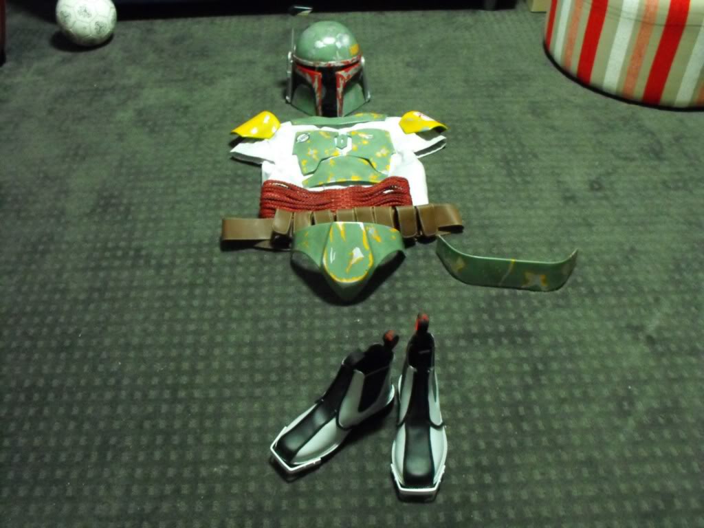

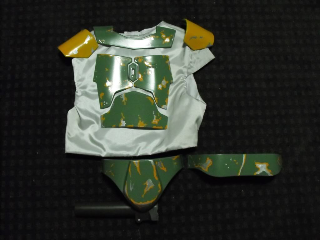

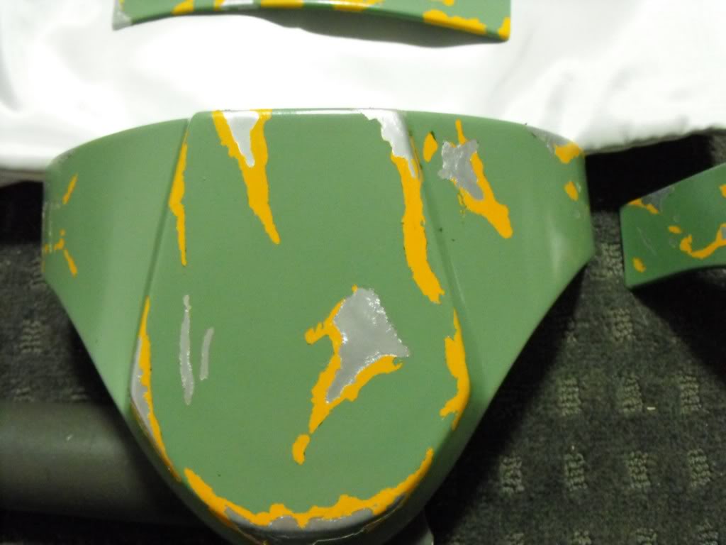

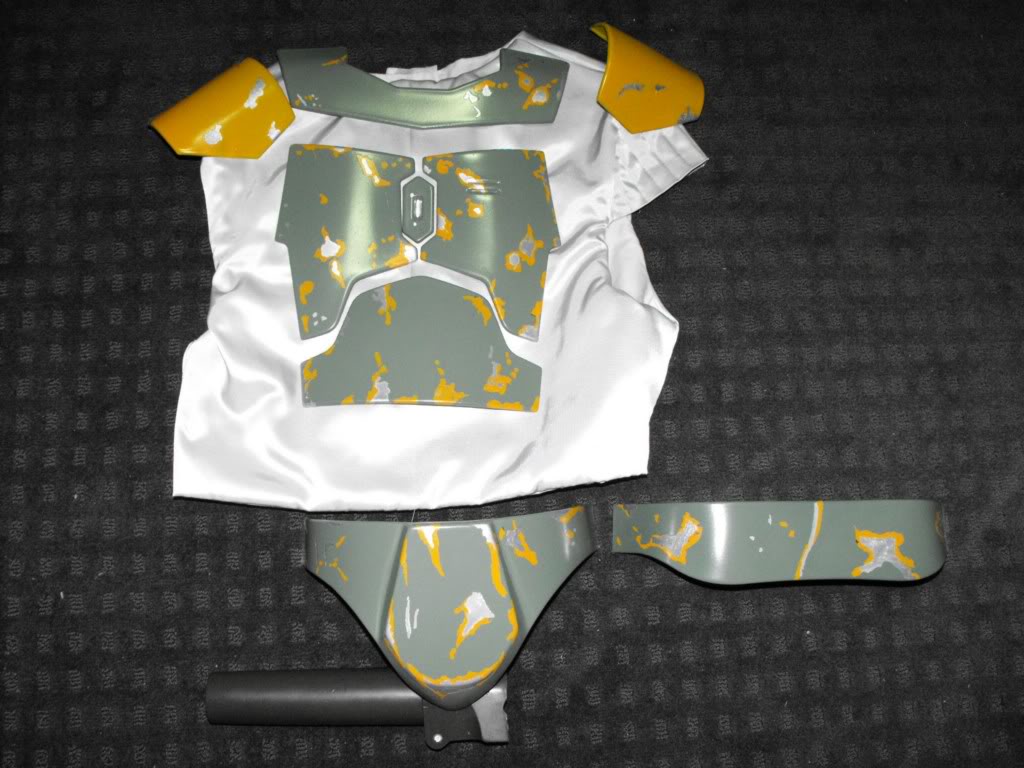

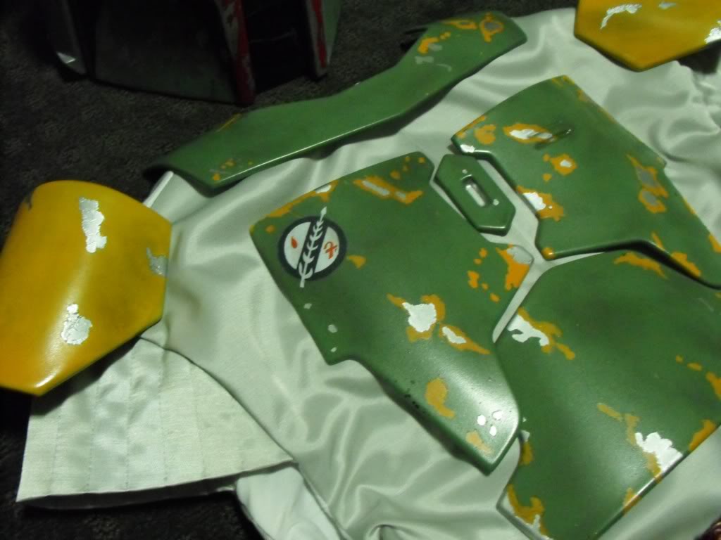

I did the layered techinque and I am quite happy the way it turned out. Just not real happy about the final green though looks a bit washed out, but it might have to do for now can always mask off the weathering and re-spray later on. Just masking off the helmet tonight and will paint it up. Looks like this weekend I will be flat out. Have to be done before Thursday week.

WOW! You've done an amazing job! I like it!
As you said, the green is a bit different and I think the yellow too (the armor scratch yellow), but as an overall image it's looking really good. Maybe you can dirty it up with a light mist of black or dark brown?

Thanks mate appreciate the kind words. I am pretty happy on how it turned out, just got to get the right colours before I start mine ;)
The yellow was a bit of a pain too but I used the same as the shoulders. I will dirty it up. I am using pastels and acrylic wash on my other sons RC so will probably just use the acrylic wash on the Fett and some very light misting of matt black in some areas and some paint flicked on in some places.

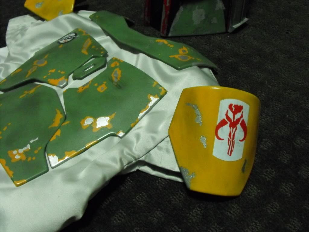

I do have some decals - ROTJ & ESB from fexinprops - that came with my Boba stuff when I bought it but looking at them they might be a little too big. So I might try and resize some images to fit on his armour and stick them on, not that steady with the hand painting, or might talk to one of the guys in our garrison about some smaller decals.

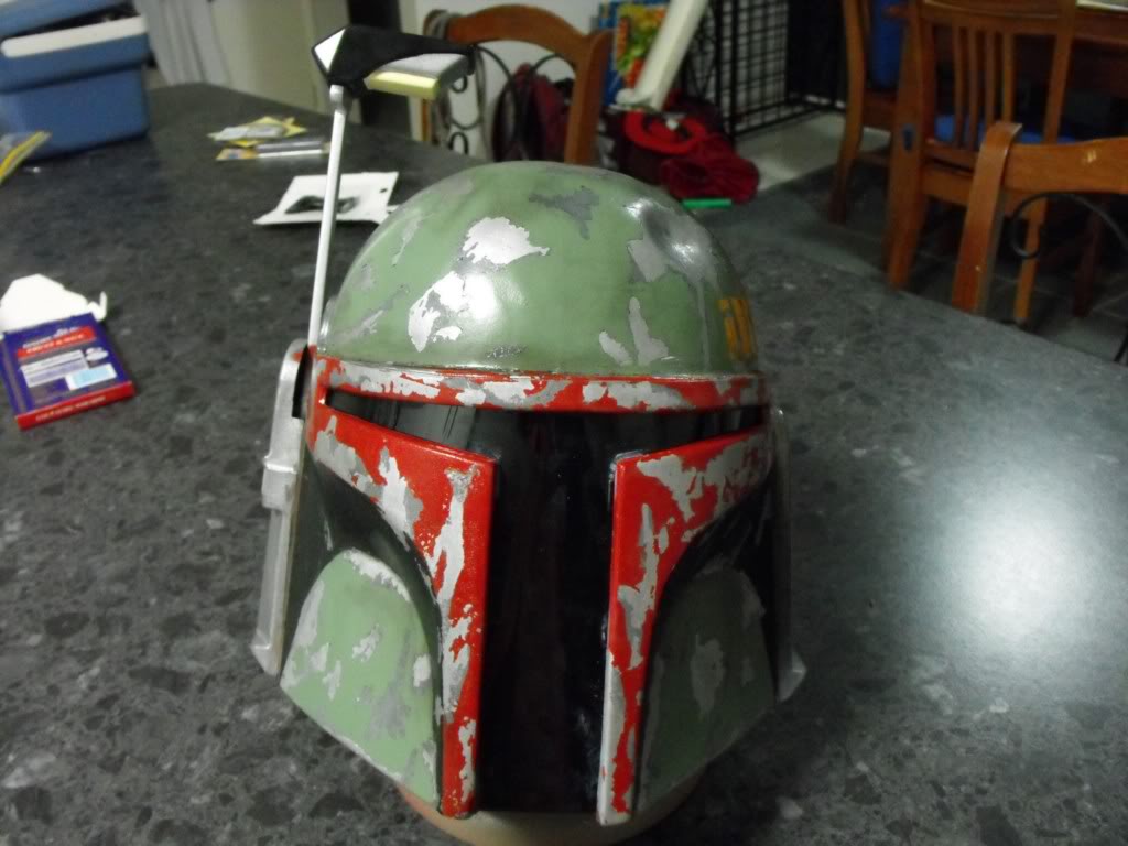

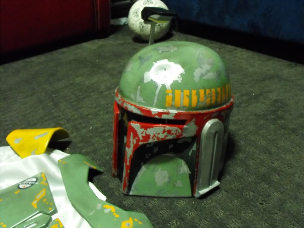

Well after a lot of mucking around finally finished off the helemt. Bec thinks it is a bit to weathered and marked up...she said looks like this Fett has been in a few big battles. I think it is ok, maybe a bit too much, but the main thing is that Declan likes it :)
Also weathered the armour with pastels as well it helped tone the green down a bit, also misted it with a bit of black matt paint. Put on the decals. We also pinned in the vest and altered the girth belt and ammo belt. The other stuff from the states hasn't arrived yet :( so will have to fix up my knees for him and he will have to go without gaunts and jetpack for now. Bec suggested not to put the toespikes on his boots for now. He went to sleep early so didn't get a chance for an armour fitting...hopefully tomorrow night.
