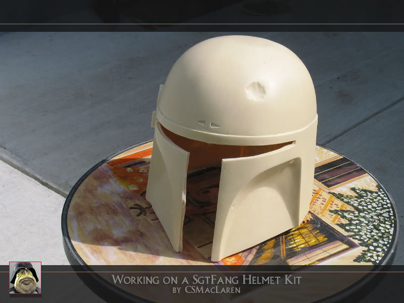

Woo-hoo! My first SgtFang kit! This is going to be fun. This is my first movie-sized helmet, and as many of you know, my first was the Golden Armor Fett kit. It's quite different from the Golden Armor -- much cleaner and the lines are better defined. The kit did have various tiny holes and bubbles -- some in very difficult to acccess areas -- but I believe with patience and my collection of detail metal files, I should be able to bring this up to presentation condition!

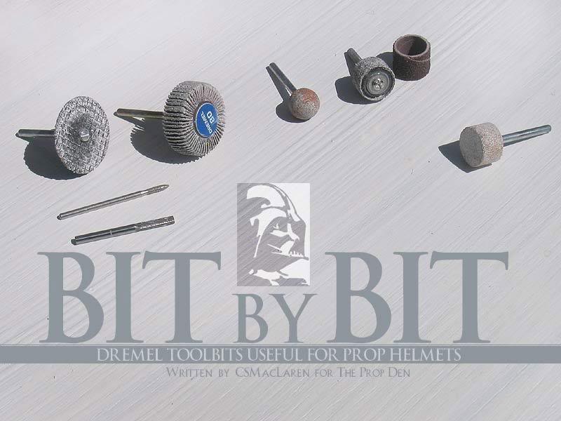

The horizontal part of the "T' is a different matter. But in the photo below:
... on the top row, the second from the left -- that particular Dremel bit may do the trick.
I'll let you know!

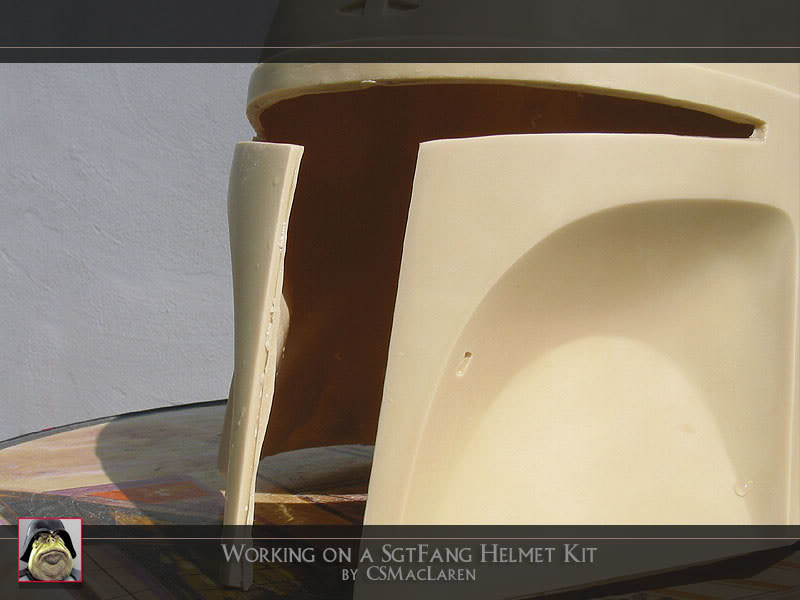

Question: the ears (near the opening) have this little notch that people say should be levelled off, and that the angle is wrong.
I see some people squaring it off so that it's level with the ground, but that looks "off" to me somehow. I was thinking of making it parallel with the edge of the helmet opening, just like I have it in the last photo I posted.
