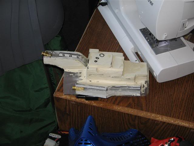

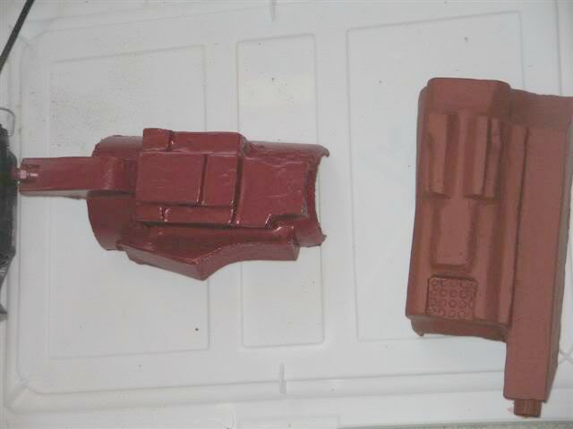

My Gauntlets are scratchbuilt.
Steps:
1. I cut a plastic pitcher in half and heated them up and formed them.
2. Left gaunt is formed in legos for the most part and the right one is formed in foamboard.
3. attach legos and foamboard filling with hightemp hot glue.
4. Filled in the gaps and some integral curves with joint compound (works better than spackle and has a quick drying time.
5. Sanded and refilled with more JC, Sanded again.
6. 3 coats of Polyurethane.
7. Polyester resin coat, sanded.
8. Polyester resin coat again, sanded.
9. Joint compound as the final filler, sand and refill where needed.
10. Attach bottom halves.
11. Paint.
12. Add the little details (switches, darts, etc)...
MY estimated total cost is probably $30 + my time.
They wont be accurate, but will look good at sight but not under inspection.
