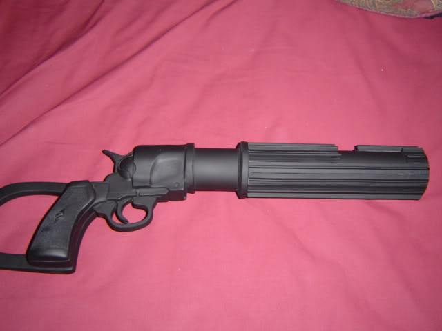

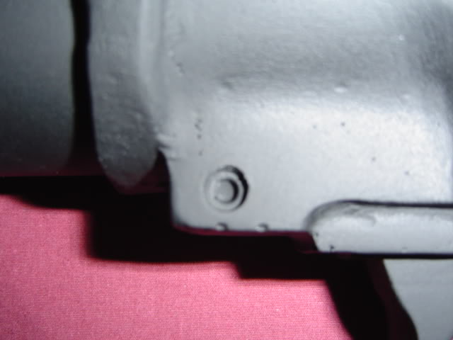

And in primer...
I cleaned up some of the detail and tried to make it look a bit more Webley-ish. One day I may even use the same method I used on the trigger and guard to make a more correct looking hammer.
I have yet to add the greeblies, scope mounts, scope or blaster tip (which is done, just not affixed).
Is it passable now? Comments are welcome and ideas for change are as well.

The New and Improved Blaster... Now with 100% more Ultra Flat Black!!!!:lol:

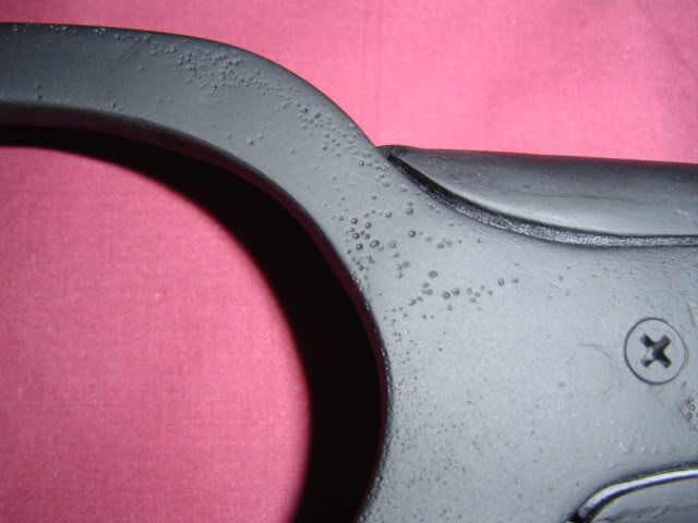

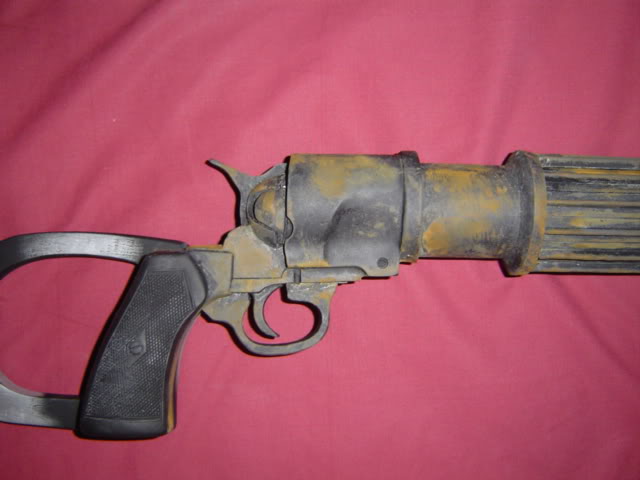

I decided to leave some air bubbles unfilled. On the parts that would be metal I thought it almost gave a nice weathered "pitted" look.
Thanks for the kind words everybody!
I chose to leave some casting bubbles, and flaws in mine too. It just gave it that 'been around the galaxy' look. Your on your way! Keep it up! A little here, and a little there, viola!

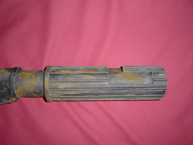

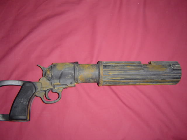

Awww...man! I left the darn thing outside after painting it and then it rained!
The flash really washed the color out of the rust. It's a lot darker in person with mixes of oranges and reds. I'll try to take a better pic tomorrow. Now I'm starting on scratchbuilding the stock greeblies!
Are you going to scratch build the bomb racks, or the mid-chamber wings? May I suggest you contact Fetthunter for the bomb rack. You will not be disappointed! His castings are crisp and clean. If memory serves me correct, they are only $7. Its a shame to see a nice blaster rusted :lol:

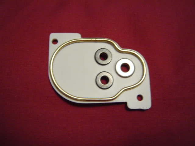

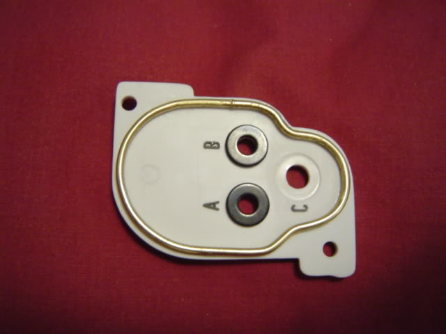

The master for my 1st stock greeblie...
I just realized upon further inspection that the hole to the farthest right inside the brass ring does not have a raised area around it. Have to pop that back off.
I think I even have an idea how to do the A, B, and C that are by the holes on the model pieces.
