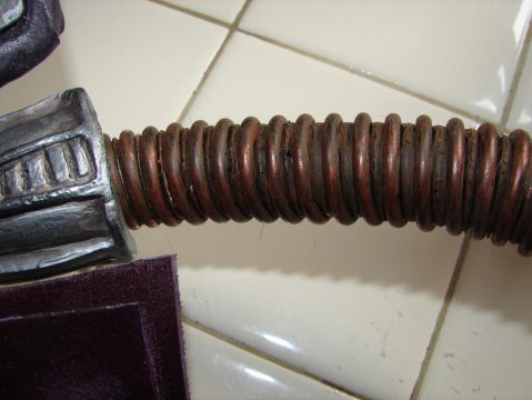

JDFett
i like the look of that...whats the quantity you need to buy? maybe we could all pool together...get enough for those who want it and have it sent to one person who can cut it up to length(plus a few inches on each hose for connection options) and have it sent out?
the hose im using right now is from a respirator machine in a hospital...looks pretty good but the ribs i think are still a tad close...
not sure if the other hose john posted is any more open coiled than what i got or not, hard to tell in the pictures
