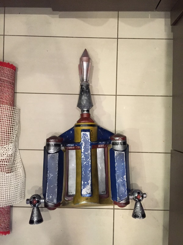

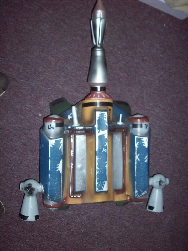

For those of you that haven't seen this costume in person, it's terrible, truly awful, I kept the jet pack as that's quite an expensive part to get (for a good one), so thought it was worth trying to mod this one. The actual main body of the jet pack isn't too bad quality wise, quite rigid/solid and light since it's hollow plastic (it did need quite a bit of work though (sanding/filling etc) to get it in a good state ready for painting). The rocket and thrusters unfortunately are a different story, they're very cheap, very thin vacuum formed plastic, and to make things worse they're made in 2 parts and the shells are poorly glued together (very cheap and nasty). As the rocket and thrusters were terrible, they had to go, so i removed the rocket down to it's base, which left quite a large hole so i covered that with some sheet plastic (filled, sanded etc) and made a new hole for the new rocket. I also removed the thrusters, which also left holes, but on top of that, the holes weren't in the right position (they're far too high up on the Rubies version) so I filled the holes and resculpted the sections of the jet pack, then made new holes for the new thrusters to go in.
I bought a new resin rocket and resin set of thrusters which are a vast improvement on the awful plastic ones. Then it was just a case of giving it all a nice paint job and putting it all together. I'm pleased with how it's turned out, the only bits I have to add are the 2 metal parts that sit on top, other than that it's done. Let me know what you think
BEFORE (not my pic, but it was like this)
AFTER
