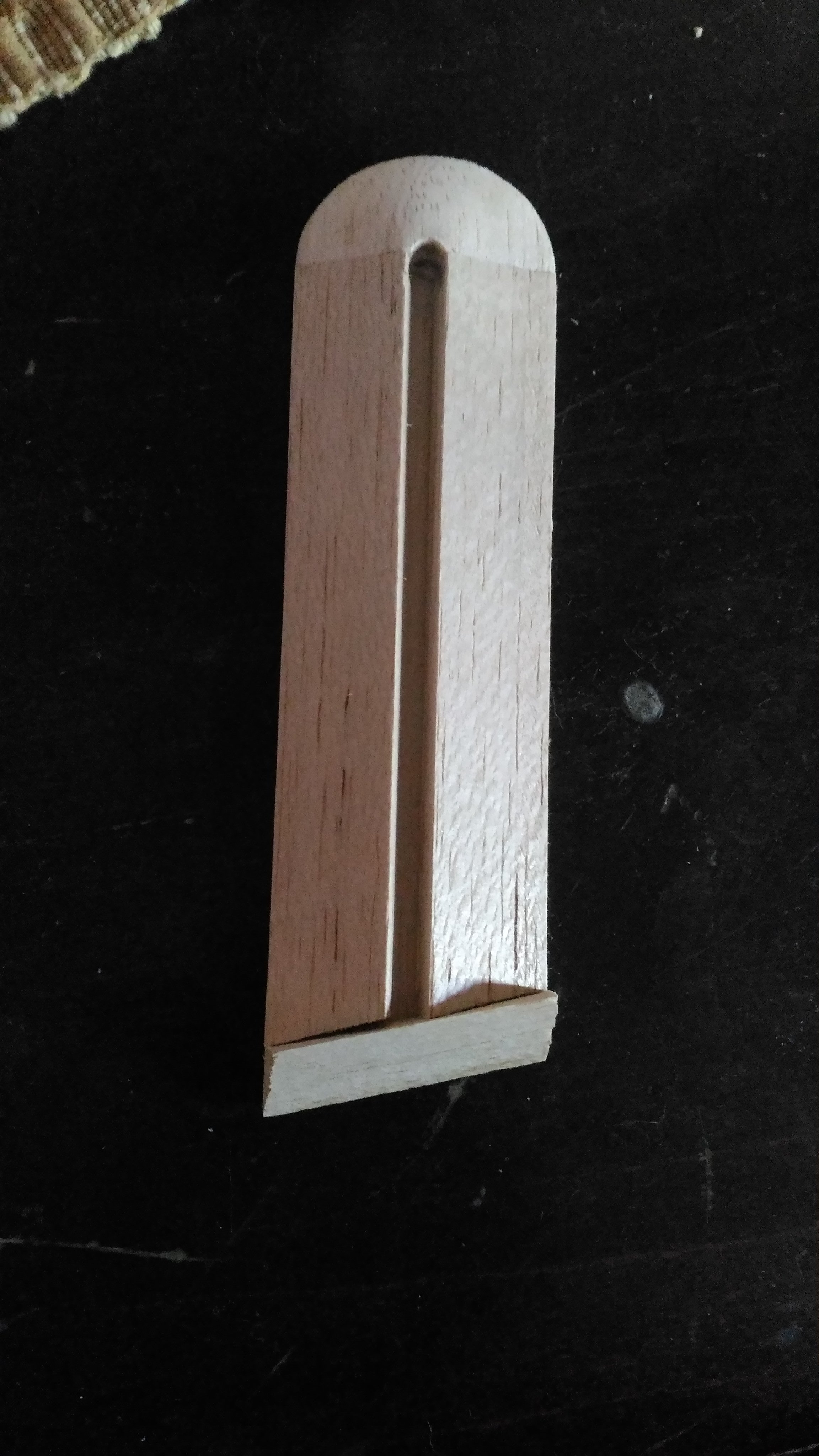

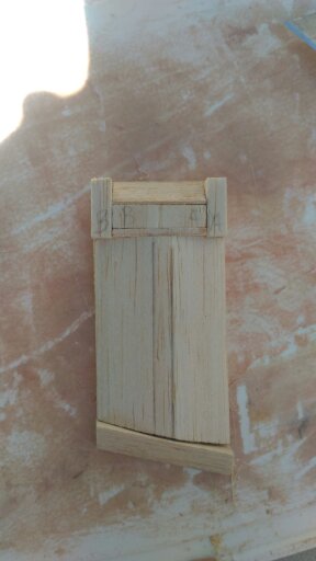

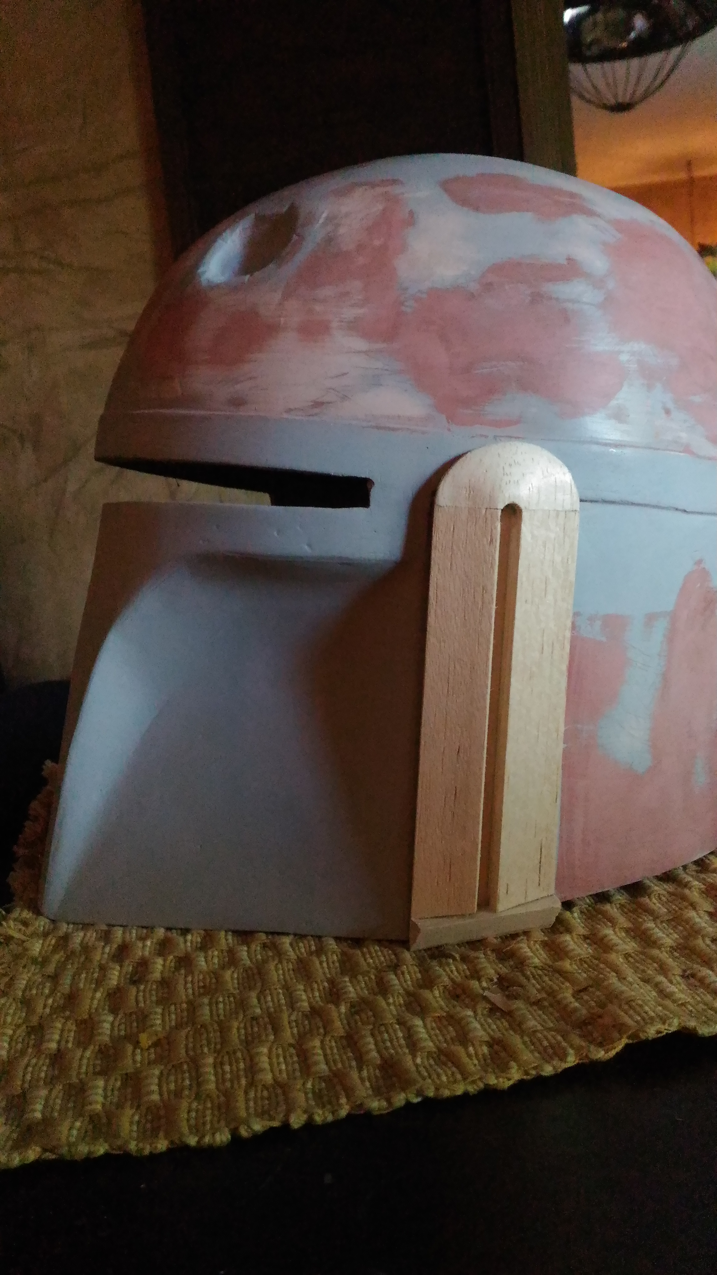

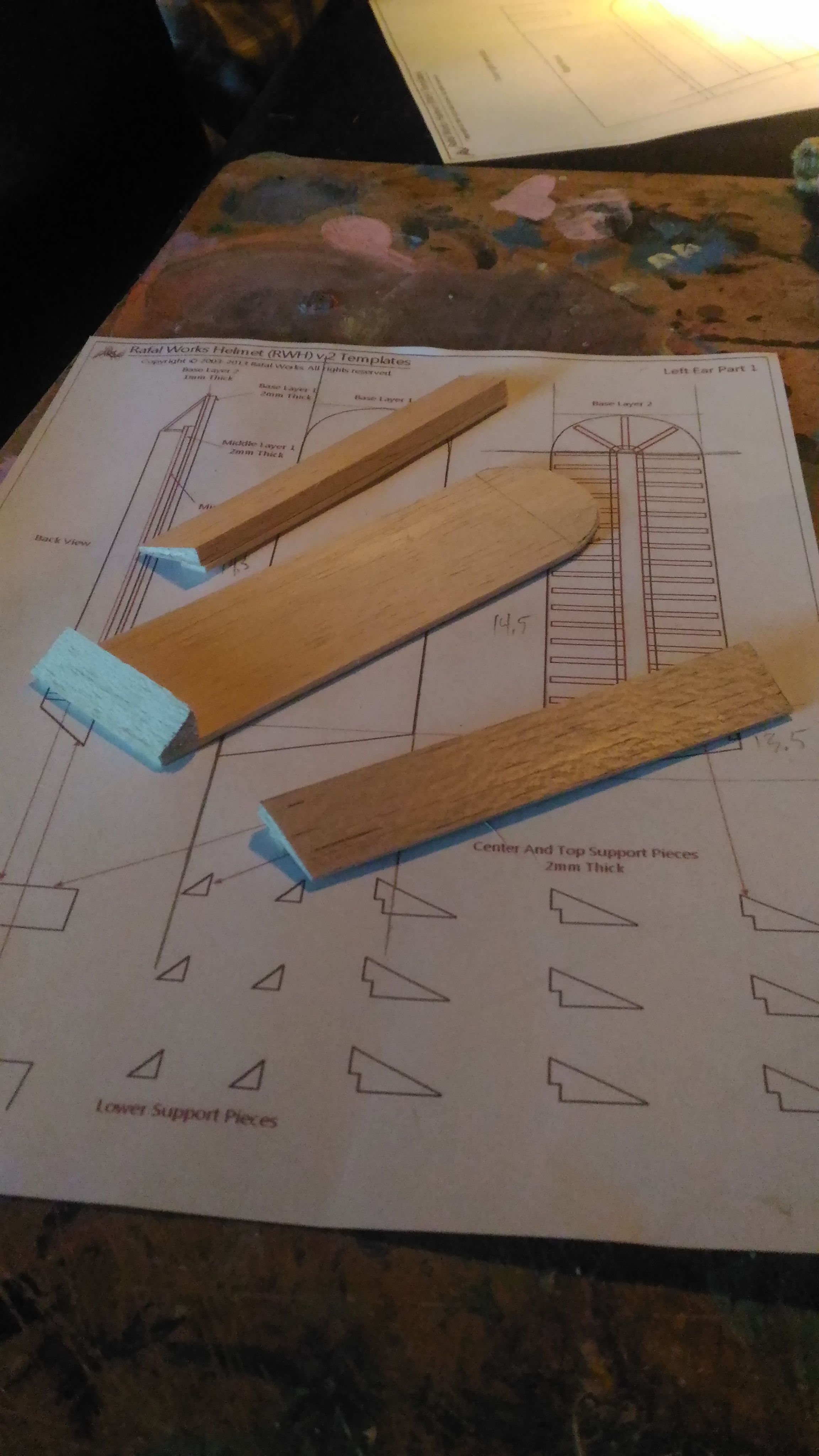

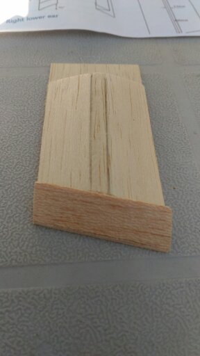

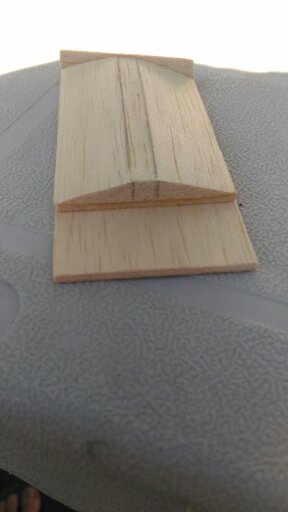

so while I give my tennis elbow a bit of a break from sanding sanding sanding.....I thought I would work on the ear pieces. Using Rafal Fett's template I found it pretty crazy cutting out all those pieces, and when I was done, well....I was frustrated. had an idea to try and build the ear piece from balsa wood from the local hobby store. I remembered a lot of the balsa pieces look similar to the shapes in Rafal's templates, so I gave it a go.
the center gap is a little off, but i'll correct it with bondo. ear shown taped on for size
View attachment 101571View attachment 101572View attachment 101573View attachment 101574
Very nice! Great ingenuity, this needs to get saved!
Very cool. I was thinking about using wood for a good few elements of my build, but decided against it with what all the plastic already infront of me. Good to see how well it can turn out though.
Makes me think that a pure wood build, all nice and linseed oiled up, would be really cool as just a work of art.

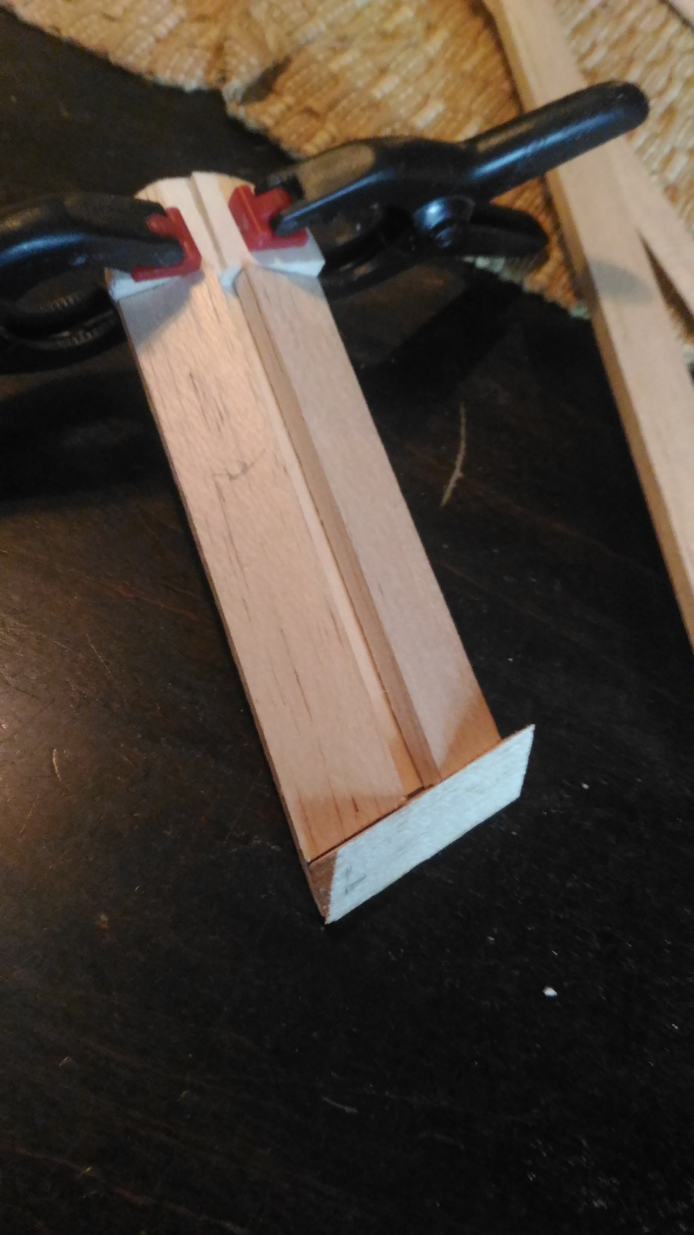

the balsa wood is nice because it is extremely light, but will damage easily. sanding it is a dream, just a few passes of 100 grit will do the trick on minor defects. I had to carve the tip of the ear piece in the picture then sand it. The whole assembly time of the ear piece in the picture is just over an hour (for glue curing)
i'll apply a resin coat before bondo to give it some protection. I would hate to sand through the bondo and into the wood.
Thanks! I'll probably re post this as a forum topic when the other ear piece is built. I think that with a resin coat, you could easily make a mold for casting with this?

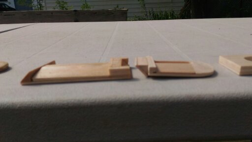

had some time to work on the right ear pieces. they were a lot more difficult to work with because of the details, and trying to interpret a template meant for cardstock and translating it into a balsa wood dimension.
I'm pretty happy with how they turned out. I did put a resin coat on a couple of pieces, as you can see in the pictures, the colour is a little darker. the resin coat doesn't really protect from dings or scratches. will have to do a skim coat of bondo which will fill in the gaps and protect the pieces.
