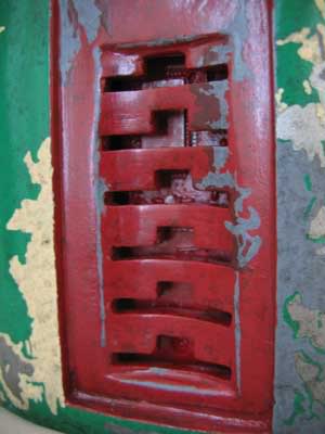

Had a little fubar with the keyholes. The two paints didn't like each other.
A black wash to dull down the colors, and there you have it.
