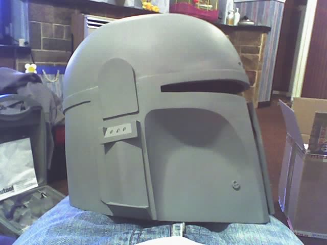

The first pics show some shots of the bucket prior to painting, taken as I got it out the box.....
The third pic shows a close up of the crack on the visor. I created this using a screwdriver and then re-primed it with a priming pen.
The next pic is the keyholes cut out.
And the final pic is of the first coat of chrome. For this I used Humbrol silver spray. It comes up really well.

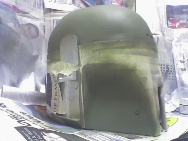

I've hit a slight stumbling block!
It appears that the masking tape I am using is the very sticky kind, which has meant some of the silver paint has "lifted" in some places. To counter this I have decided to mask entire areas with Copydex. I don't know whether this is available in the states but it is essentially a type of glue that is similar to the masking fluid.
I have painted this stuff over the large areas to be protected, and also used newspaper to cover some areas.
Any further lifting of the silver can be resprayed...I recommend getting some of the low-tack masking tape though!

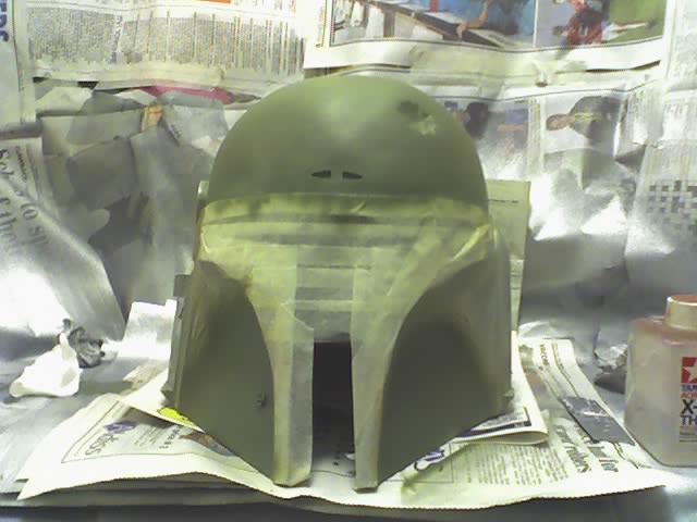

Ok guys heres the first coat of the dome and cheeks. I had a bit of a problem when the gas cannister ran out of juice for the airbrush!
I must acknowledge the input of FETTSTER for his advice on paints for this helmet.
This first coat is made up of a mix of Tamiya Olive Green (XF58) and Tamiya White (X2) with a a few drops of Tamiya Field blue (XF50) I mixed the olive green and white 50/50 and some blue drops. I then just ended up adding a bit more of each until I was happy with the colour. PLease excuss the quality of the pictures, the lighting does affect the colour.

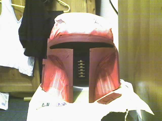

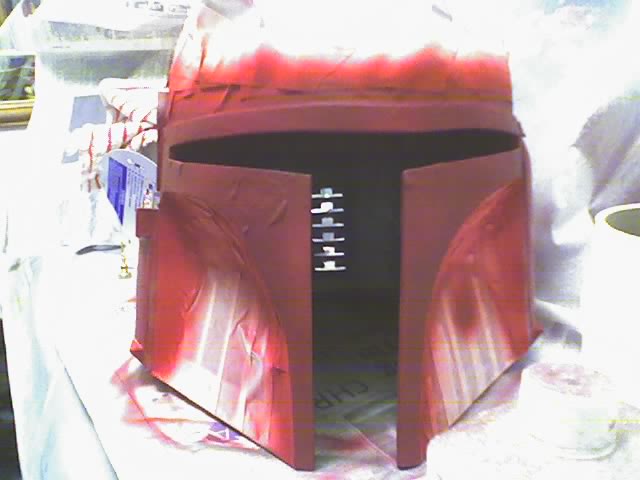

THe first three show the red on the mandibles

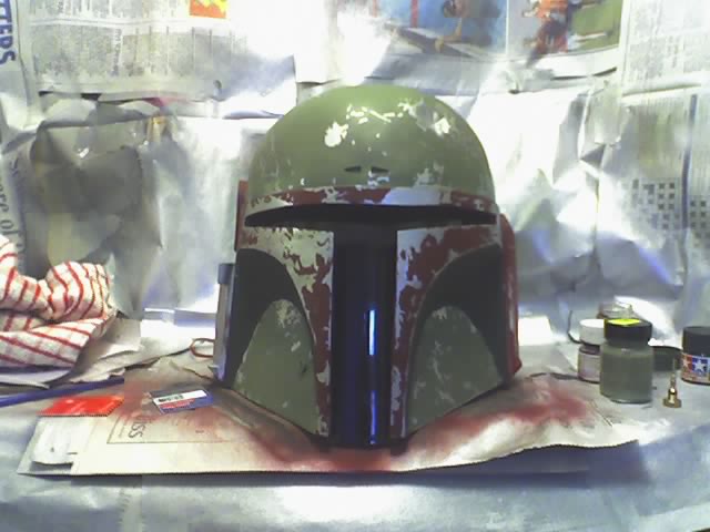

THe next one show the helmet de-masked, I still have to do the upper cheeks
The final set shows the helmet with the upper cheeks done, and totally demasked. I now need to do the back, and then start with the topical colouring and weathering
