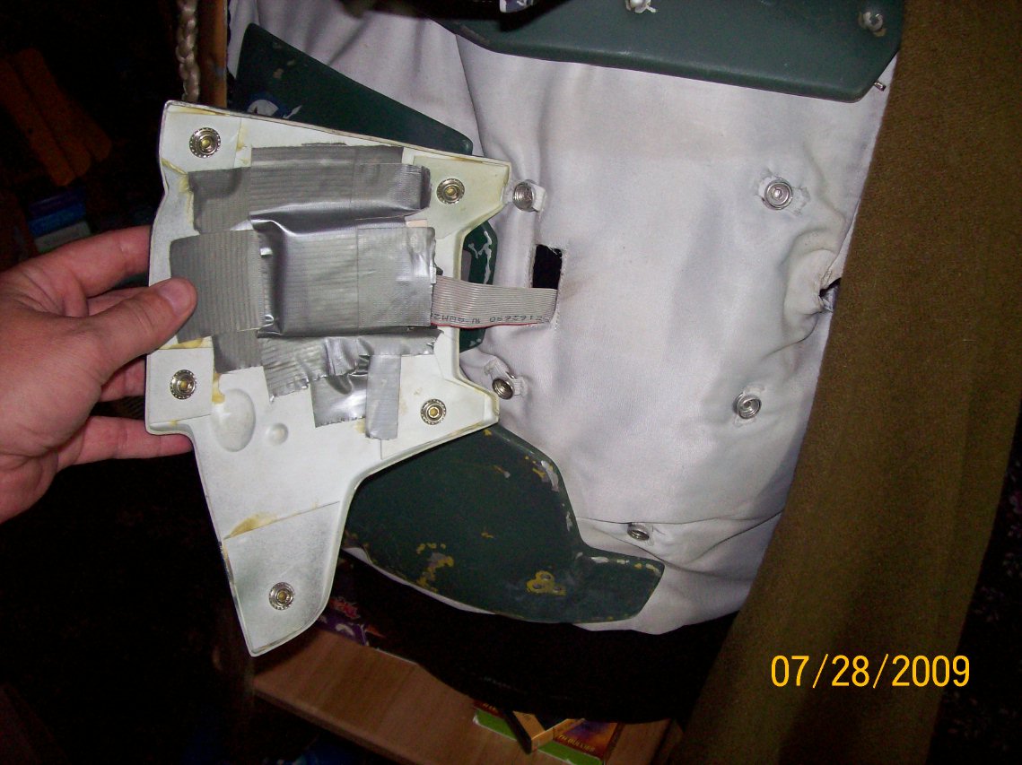

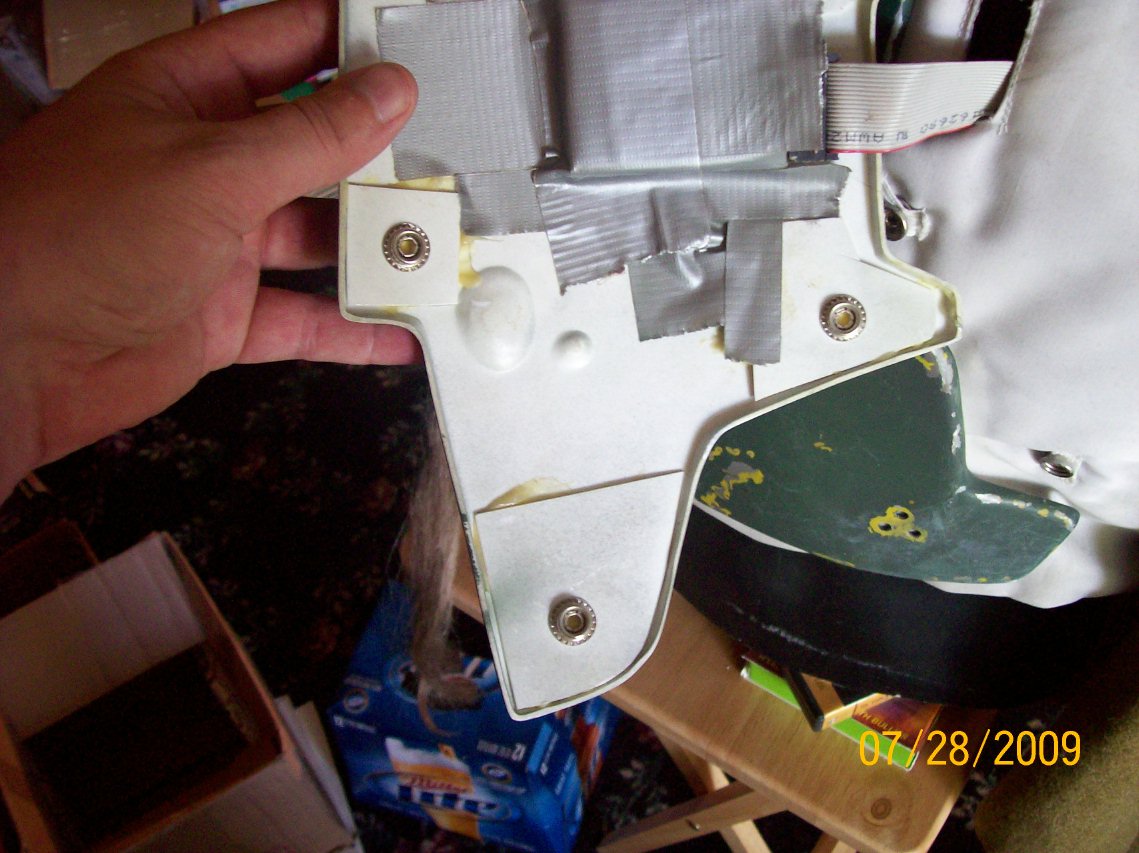

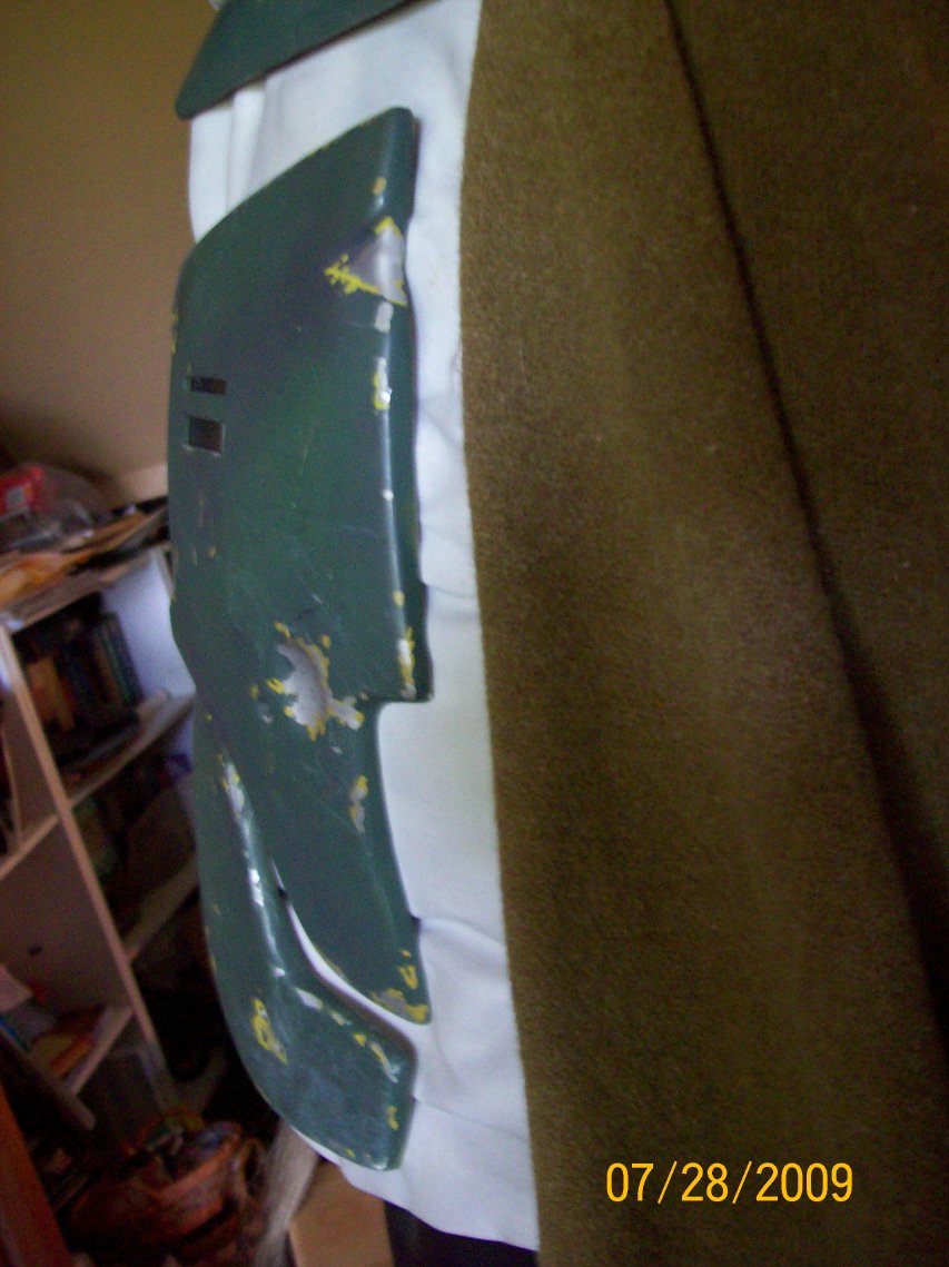

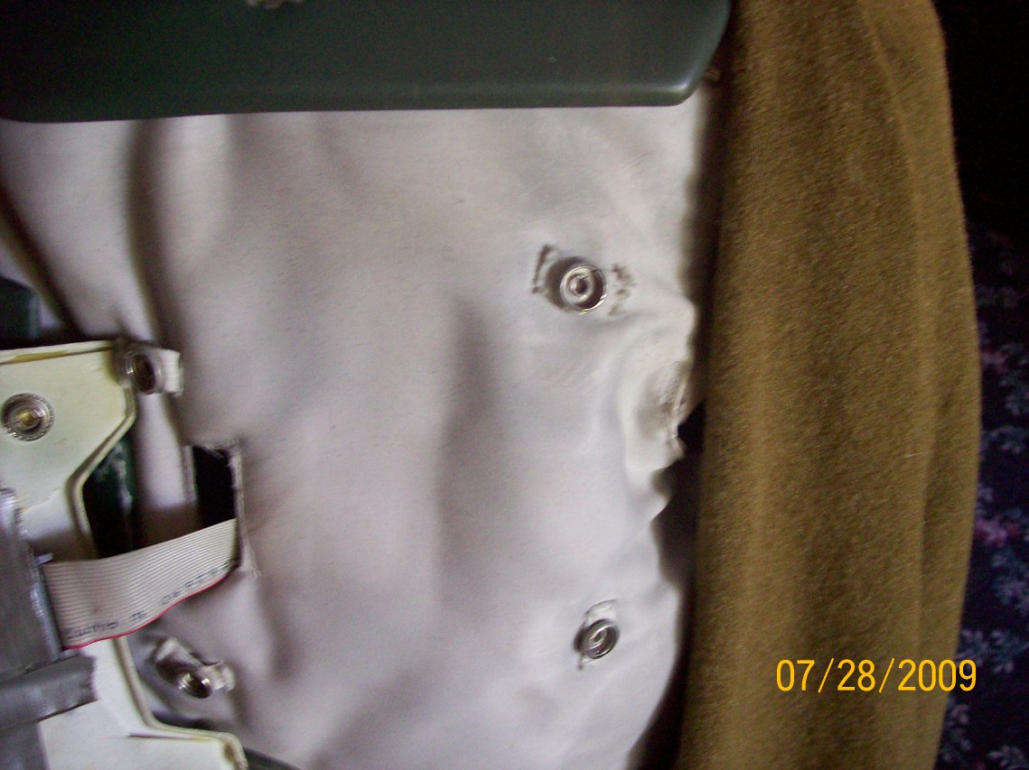

There are a whole bunch of tutorials and tid-bits on here as far as methods. Try the search. Seem to be able to find pleanty about using bolts, but the snaps ones seem to be a bit more scattered, so heres how I do my snaps. (nevermind my shoddy looking duct tape on my shest lights!!!!) LOL
Many use either bolts or snaps. I guess I always had good luck using snaps, so I never switched, but eventually I may, since that is what was done on the real suit. I get my snaps at Walmart. I've always had my snaps hold very well though. Get yourself some thin styrene sheets, and cut to shape on your armour, then punch holes in it for your snaps. Put your snaps in, and then glue down your styrene pieces to the armour. I always use plastiweld epoxy, and I would think that would hold well to your PVC plates as well. On the other end, get some elastic strips. Attach the other side of the snap, and line up & sew to the vest.
What I like about this method, is that if i screw up on my placement of an armour plate, its pretty easy to rip out the stiching on the elastic and reposition to re-sew. Some will say that you do get a nice flush fit with the bolt in method, (which I imagaine is true,) but if you do a good enough job placing your snaps and then fitting them to elastic on the vest, you will get a pretty good fit also. Just take your time. ;)
