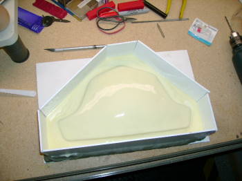

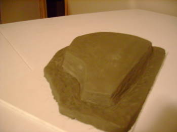

Quick question. I have my ab mold almost ready to cast (except for the walls and some smoothing) and was wondering about doing a mother mold for it. I read in Thurston's book that you can make a ''Mother mold'' for silicone molds. I take it as, pour on the silicone (thin stream) wait for this to cure, then go ahead with plaster or ultra-cal on top of that to save on silicone.
Can someone tell me if thats the right order for the whole thing ?
Thanks guys (y) ,
-Tim-
Here are some pics.....
I use Liquid Latex and then pour plaster over the back of it to keep the shape. You then take off the latex from your sculpt, place it back into the "plaster matrix" or backing and then pour whatever you want into the latex. IE: plaster or whatever your using for your mold. Quick and easy
Yes, build a box around the whole thing and pour silicone over the master. Then strengthen it later with plaster once the silicone has cured.

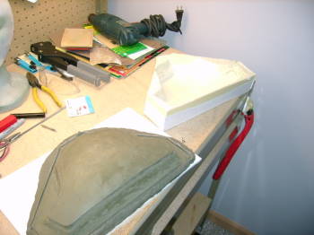

I have made some progress on this. What I did was sculpt out the ab plate, covered it in alumilite silicone, then on top of that I poured plaster of paris.
After the plaster dried, I knocked off the mold box walls. Then just seperated the pieces and put the silicone mold in the plaster. Now I will reuse the clay and start in on the chest plates.
