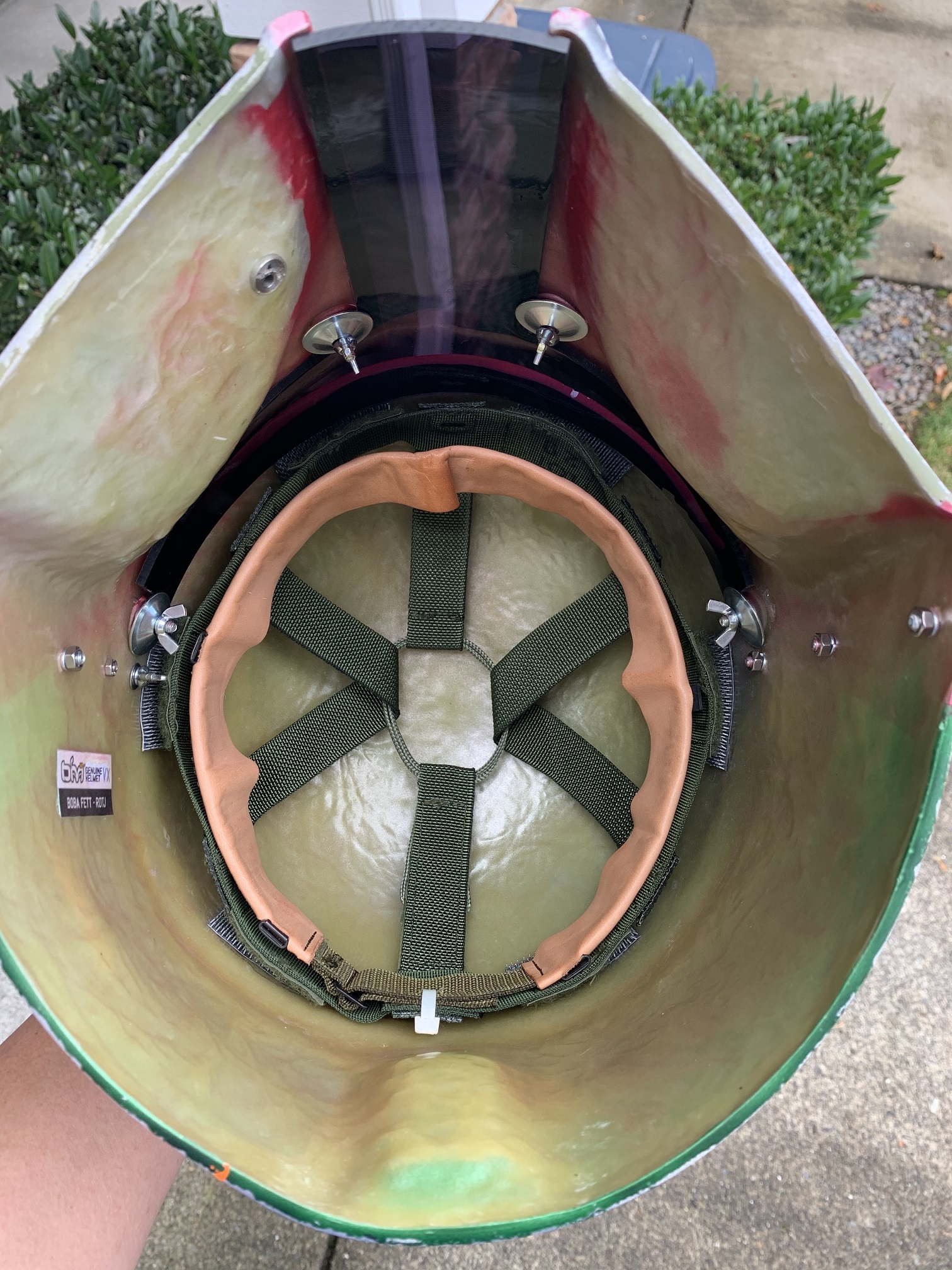

When building my ROTJ Fett, I looked at various different headstrap options. Being a former soldier in the US Army ('94-'04) I was familiar with the PASGT (Personnel Armor System for Ground Troops) headstrap suspension systems they use on their Helmets (We called the helmets "K-Pots" or simply "Kevlar"). Obvously as a soldier wearing a standard issue military helmet for extended periods of time can be taxing. So I imagine the Department of Defense went to some lengths to make them as comfortable as they could be. But here is what mine looks like installed in my ROTJ Boba Maker VX Helmet.....
I secured mine with heavy duty 3M velcro, and have trooped with it a couple times. And I can say it is very responsive on my head, even with quick turns of my head (No Bobbling). I don't have a chin strap on mine and since I don't plan on using my costume to do any action moves that would involve me jumping around. So, I didn't think a chin strap.....for me, was necessary.

I ended up heeding Irongladiator 's advice.
However, I bought this one - US Military Surplus PASGT Helmet Headband Sweatband Hook & Pile 1.5" STRAP S-M-L | eBay for the sweat band. It uses velcro instead of the metal snaps so it's a lot easier to use imo. I couldn't figure out the other one at all. It also adjusts for the size of your head with velcro too.
The chin strap didn't really work. I couldn't get it to actually get to my chin and trying to snap the button proved impossible since it's so high up in the actual helmet. This PASGT system is much more secure than my foam insert I was using before. I can look left, right, up, down and it stays on my head pretty well and is comfortable. All of it is secured with velcro since I just stuck some sticky velcro on the inside of the helmet.
This is my set up now in the picture below! It's a BobaMaker VX.

Nice setup! I was gonna say that helmet looks familiar!
:cool: (y)
While I can't speak to the foam insert, I have only ever done the PASGT system. And like you, I thought it worked out pretty well. It was comfortable and very responsive when I moved my head around. Glad to hear you like it.
