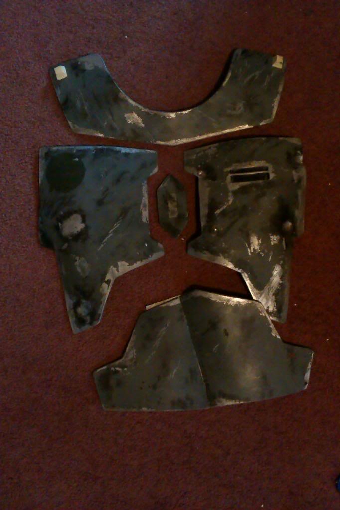

Some hunting I found torso armour BUT think I will need to make a better set myself and more appropriate as it is too small for me. Moreso now wizardofflight helped size armour for my 6ft 5".

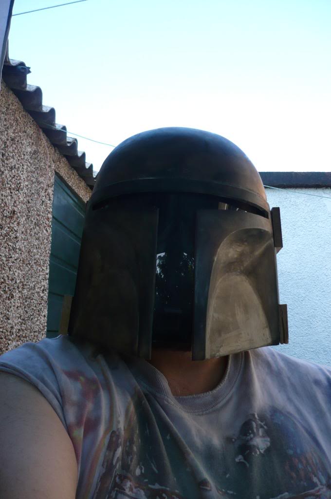

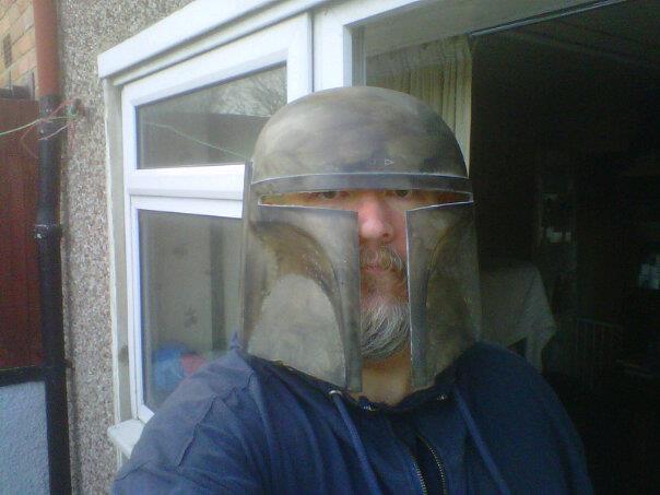

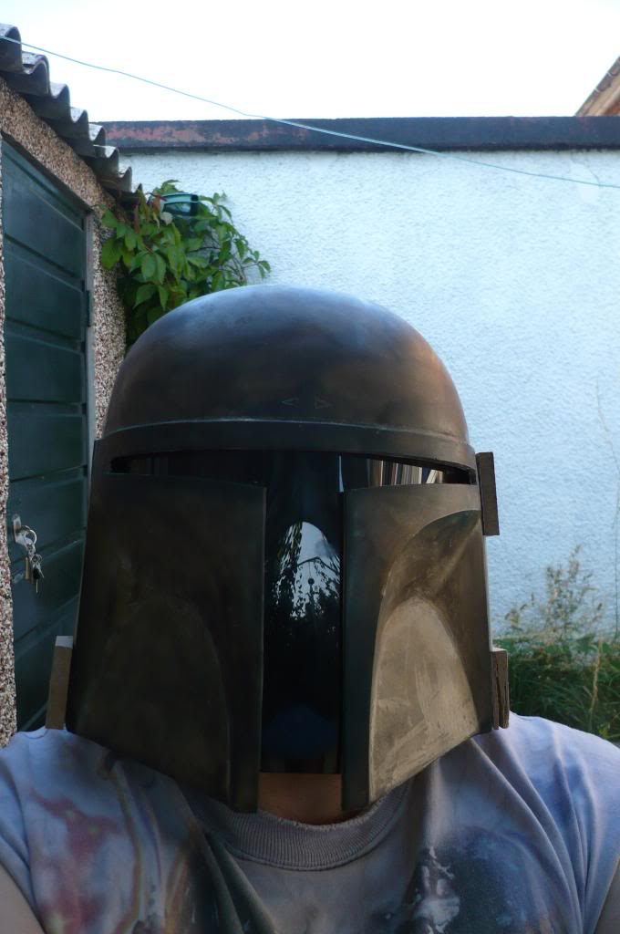

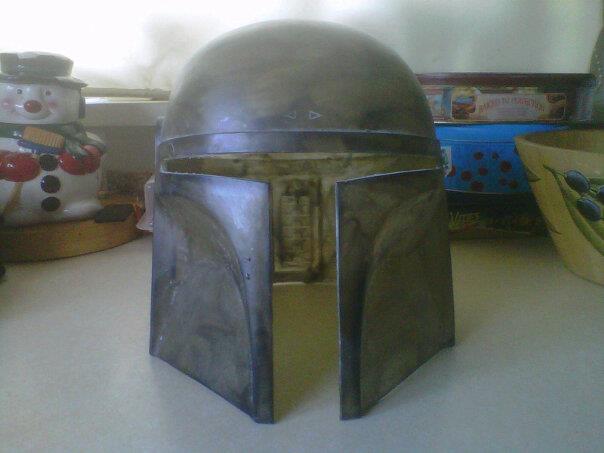

My Fiberglass helmet I bought last year.
Lid
No padding BUT big enough for my XXL head LOL

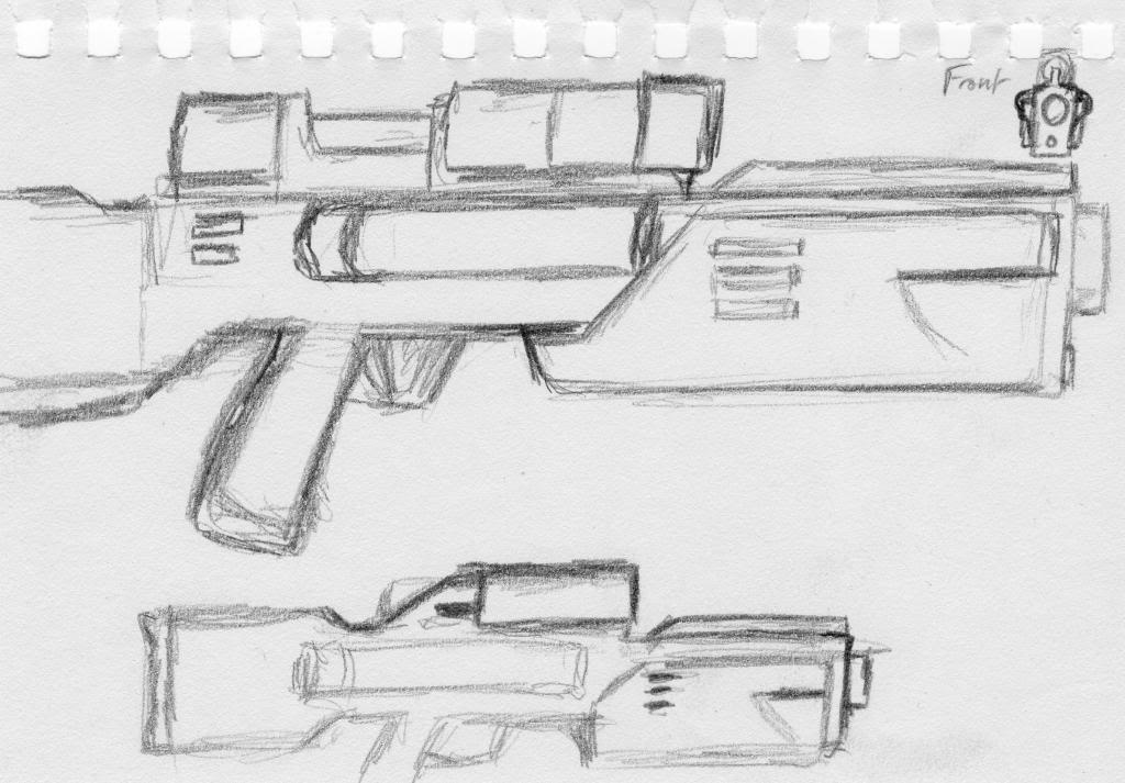

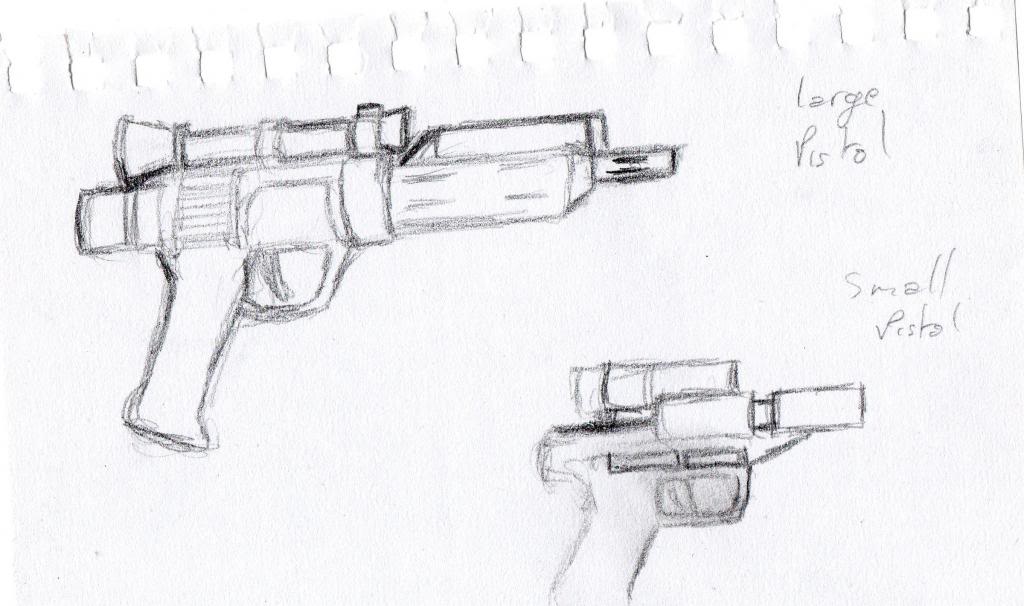

Sketches of His weapons I am doing.
This one I have sketched twice as if you look in my first post with the two images, same weapon, however they are slightly different even though same Mission at this point in "OPEN SEASON".
Two pistols they had Montross using. A larger one and the smaller one. They are actually used on two different missions within the 4 parter "Open Season". I like the larger of the two.

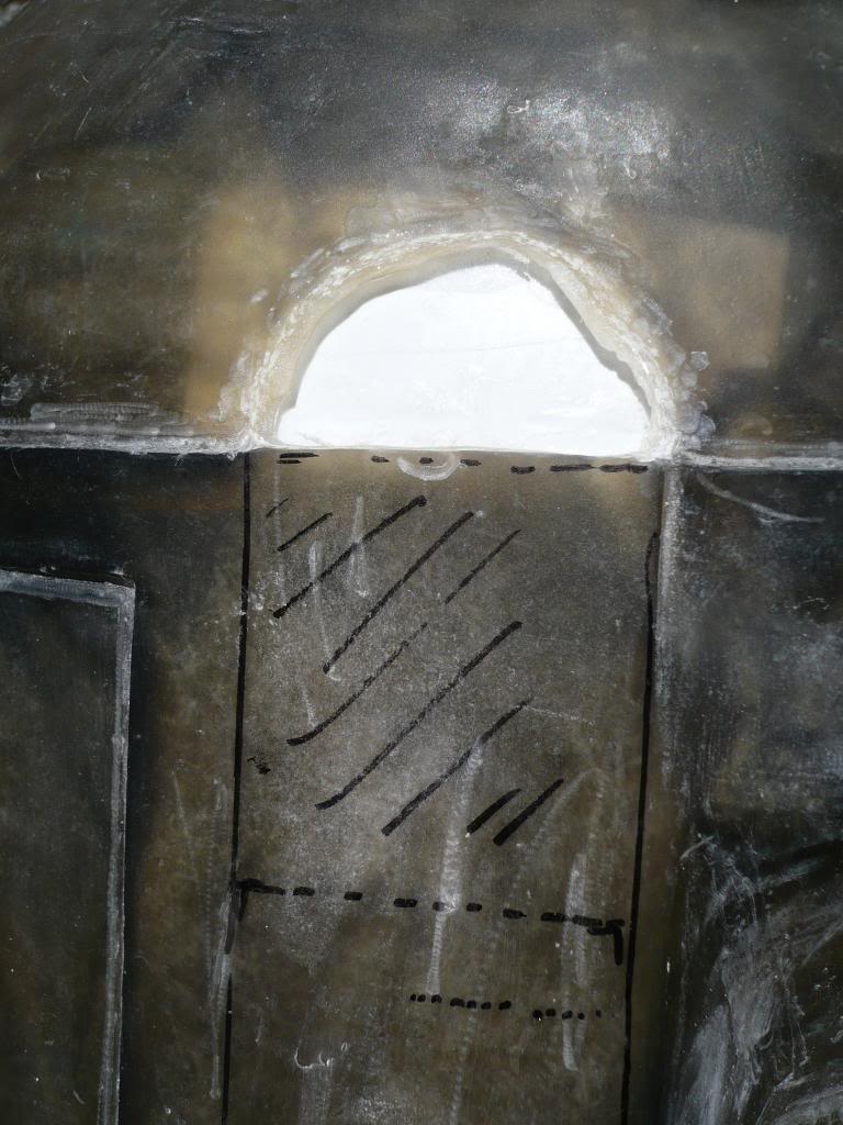

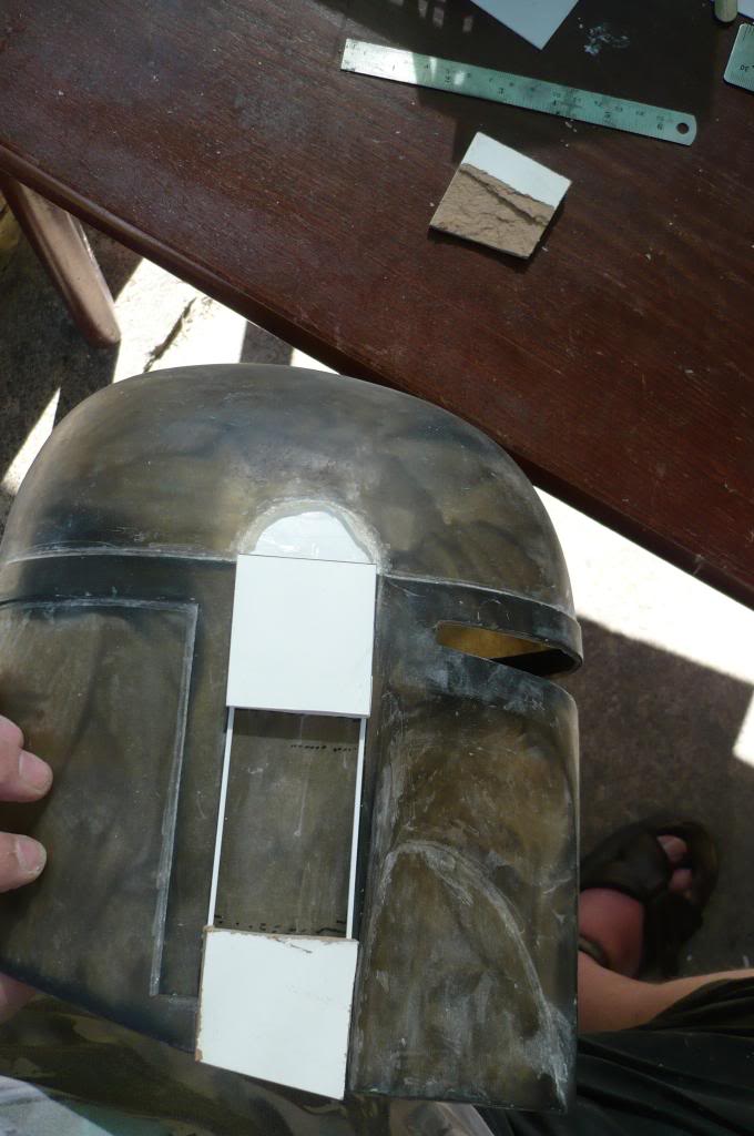

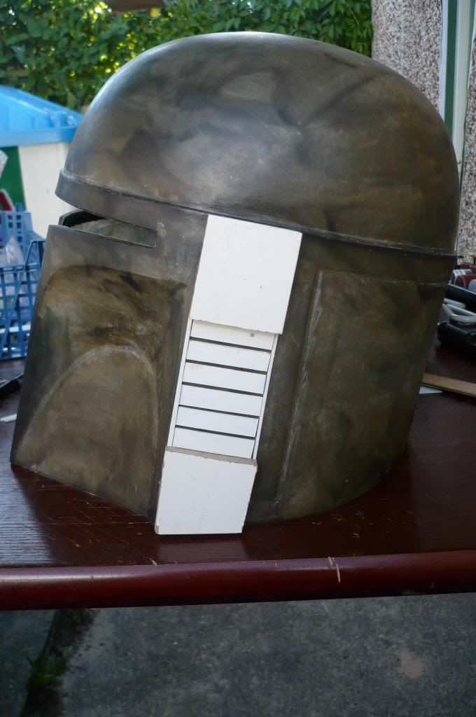

More so as I only recently noticed the side recess vents. So looking at 3-4 ways we have to tackle them.

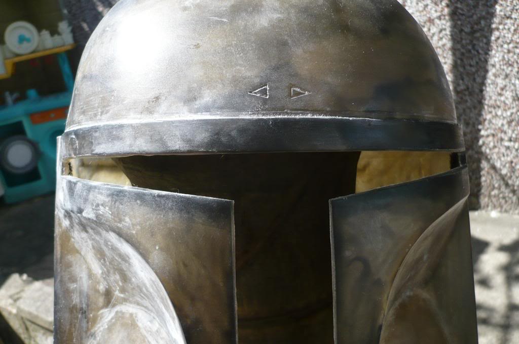

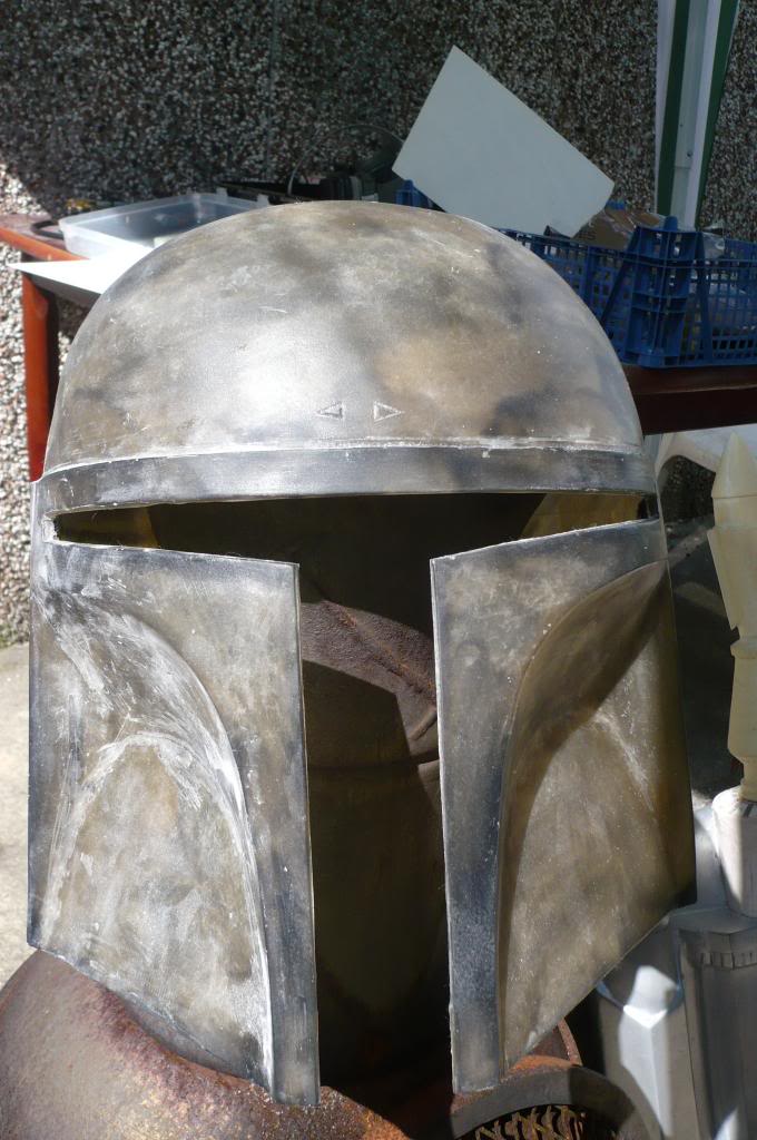

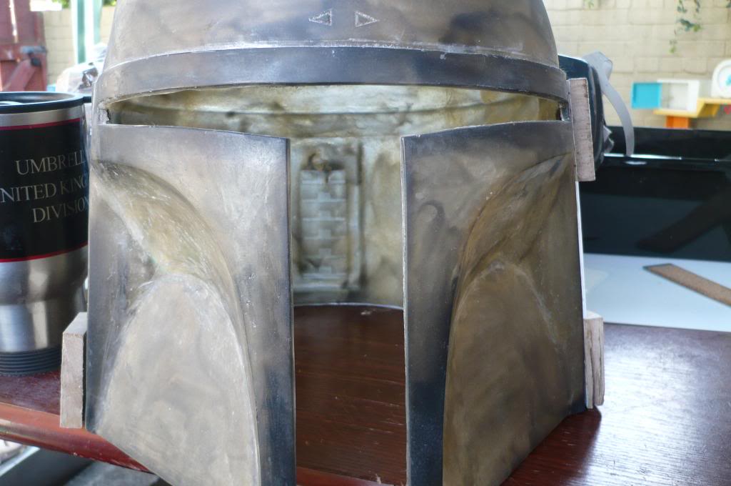

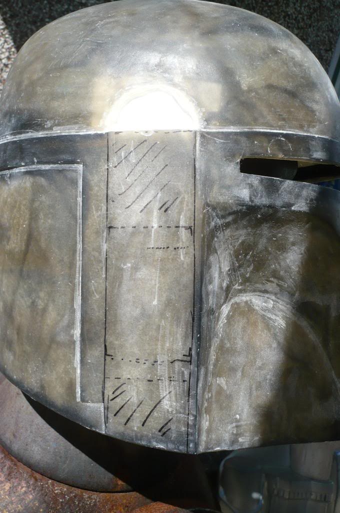

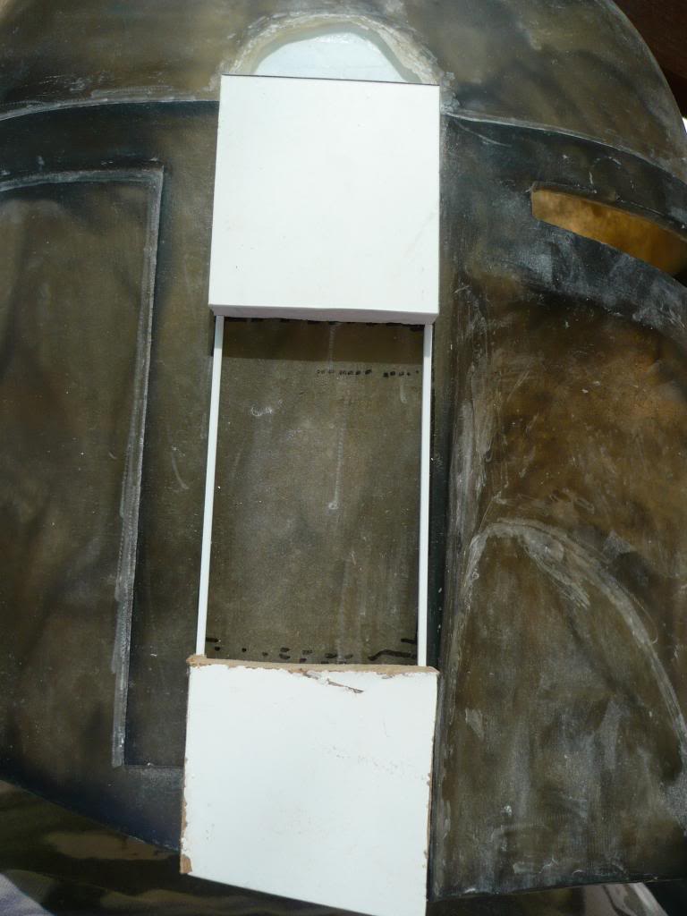

Helmet build Underway.

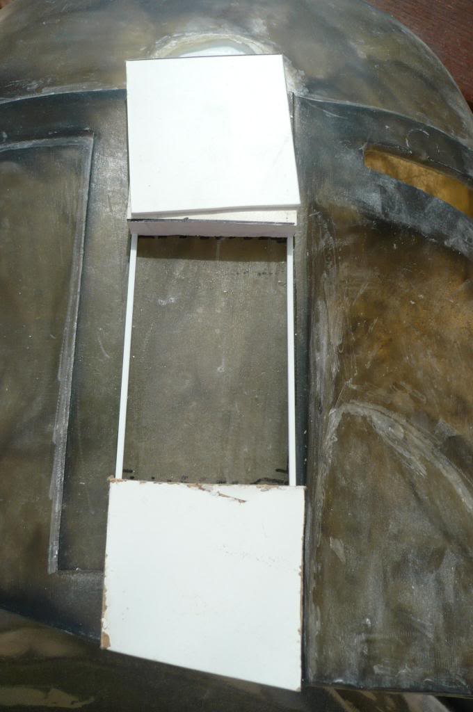

This is what I have been doing with some guidelines from Heatshock (as I have never done anything like this LOL)....
First off, dremel off the built in arch on the right side.
Test fit of the New Right side "ears" and New range finder housing.
Left side "ears" test fit.
Now attached, with vents fitted too.
- - - Updated - - -
Front view with ears on, though still need afix housing unit for range finder stalk (just waiting for Mojo fett's to arrive).

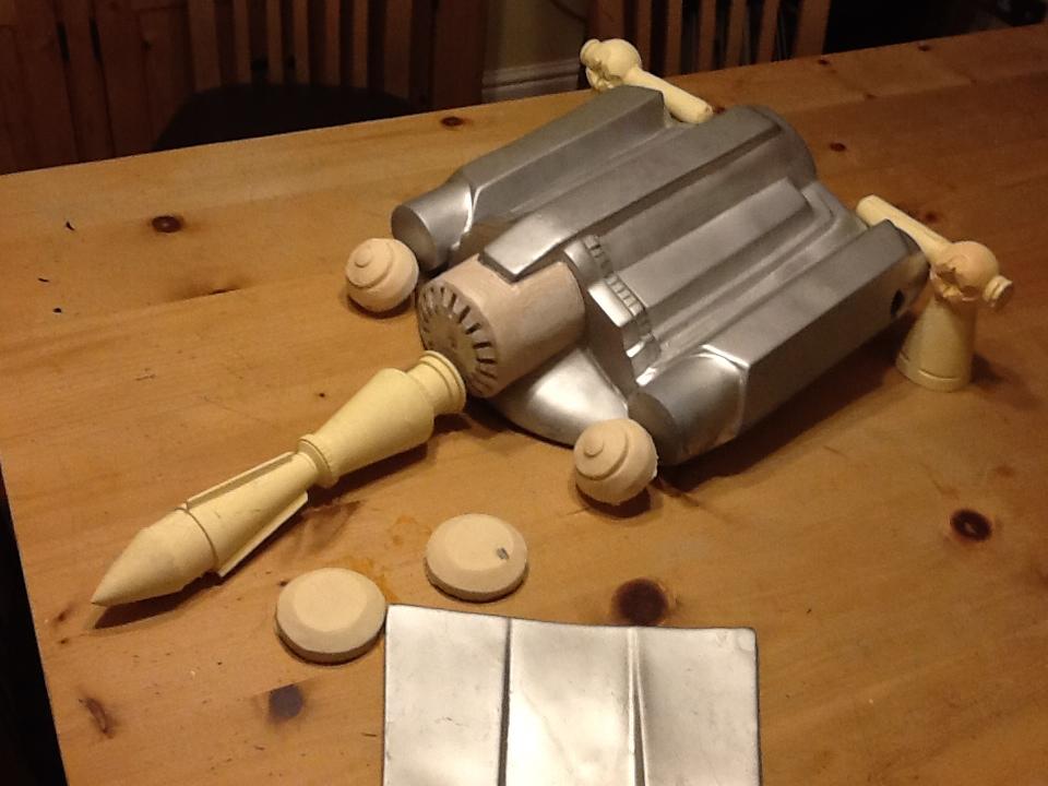

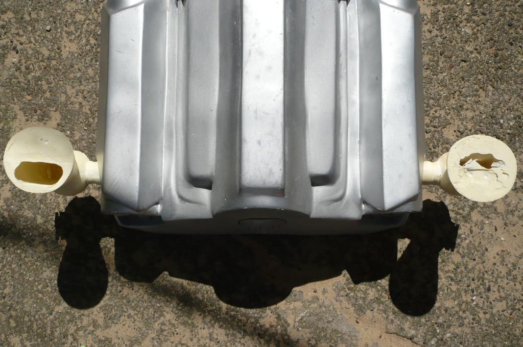

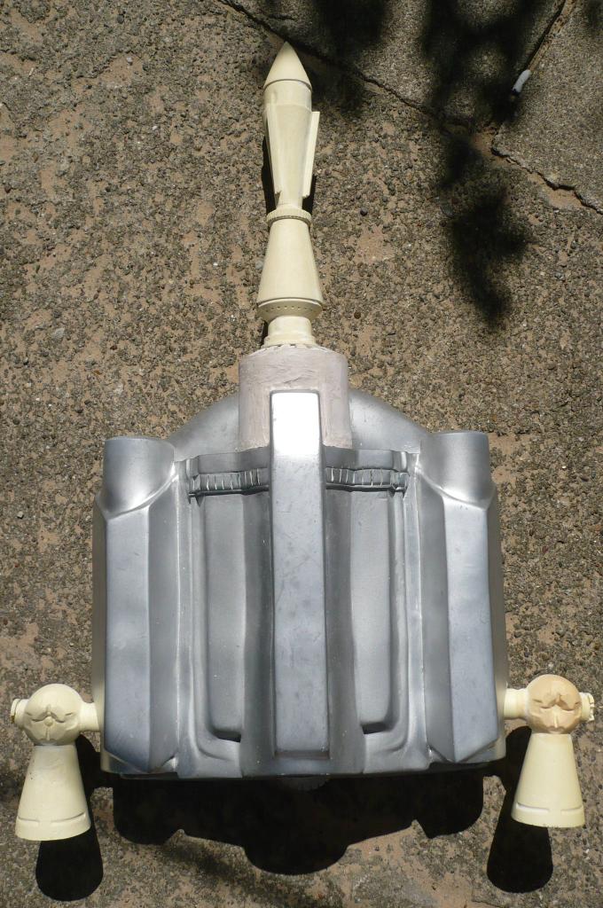

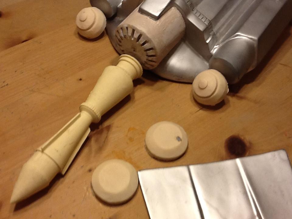

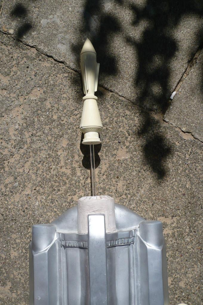

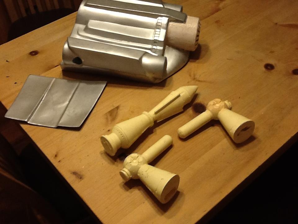

Also worked on the jet pack.
Now the thrusters fit and swivel. Also added a rod to the rocket to insert into the jp body. May switch to a metal rod.
Oh Yeah, FYI this is a "T" LONG, visor from rembrandt-enterprises on ebay. As you can see I Do have a big head the LONG still doesn't quite fit LOL
Have 2 ideas on what I am going to do about that little bit.

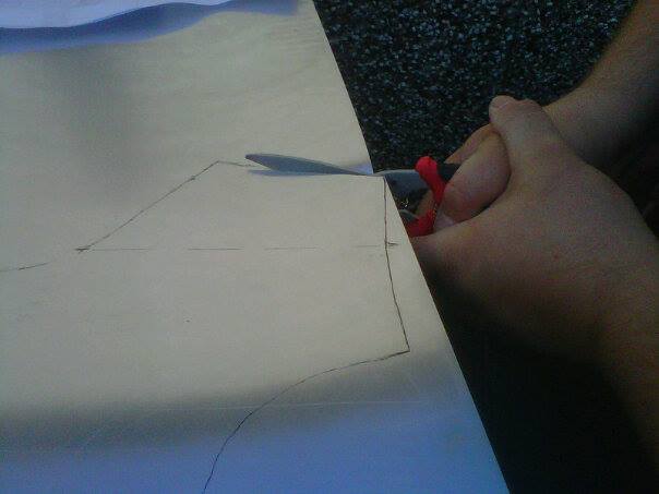

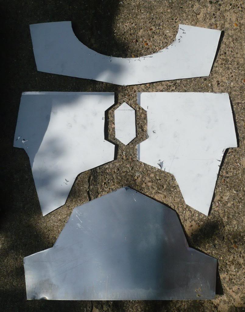

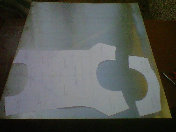

Well helmet is well under way, Jet pack well under way and now the armour is underway.

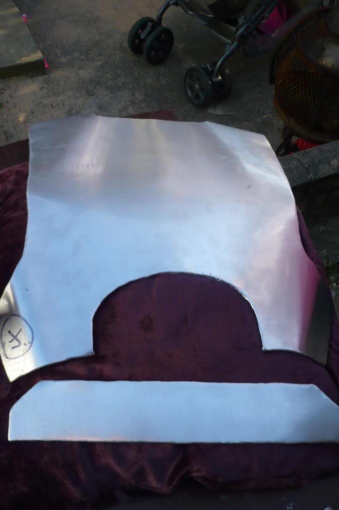

Thank's to WoF who was kind enough to scale up plans for a 6ft 5 individual. I finally got around to starting this and being brave and doing it in Aluminium.
So photos.....
"Plans are Afoot"

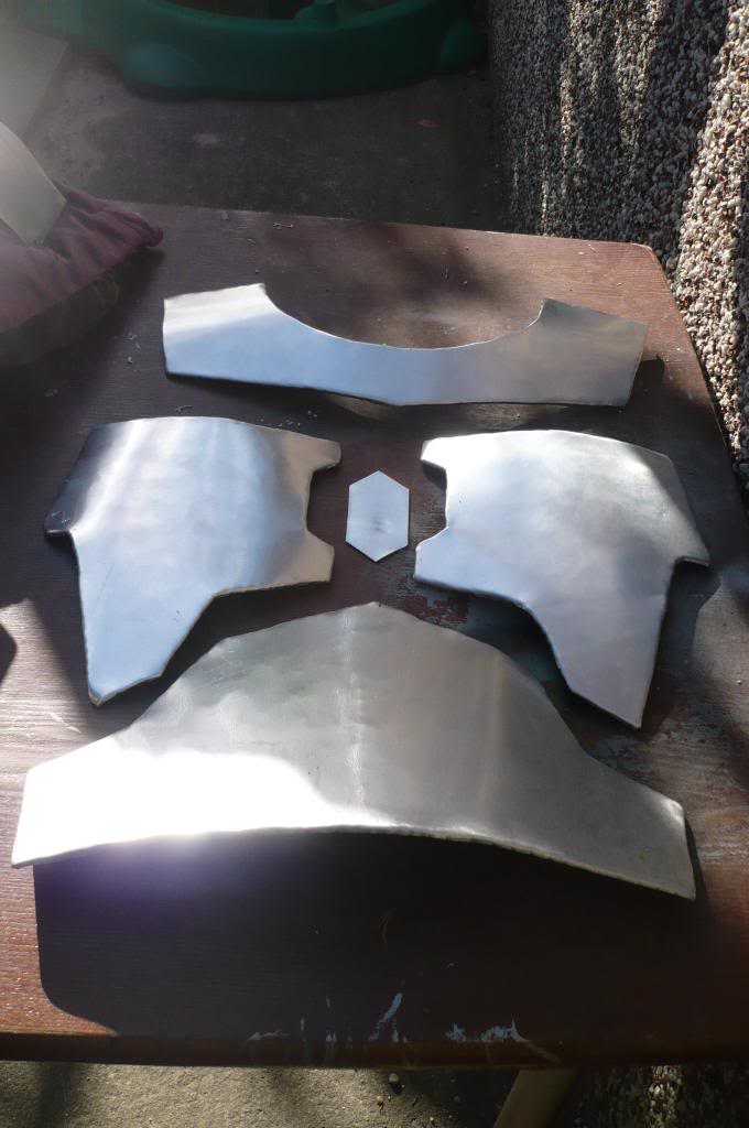

The first cut, so NO turning back now!

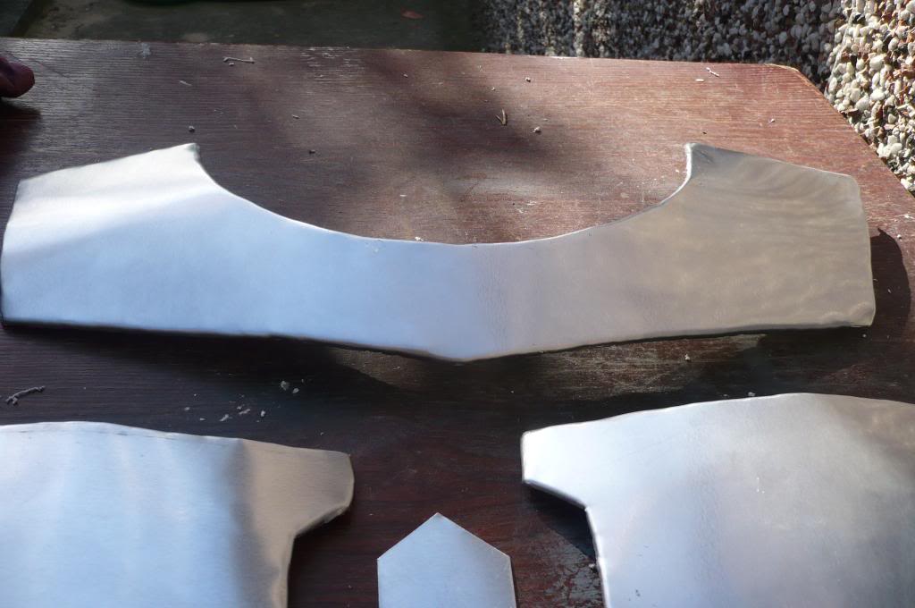

Torso Armour all cut out.
FRONT
REAR
So started but a long way to go.
So quick questions.
A, Best way to attach Aluminium armour to vest?
B, What is the best way to tackle the groin armour?
Look forward to input from you guys.

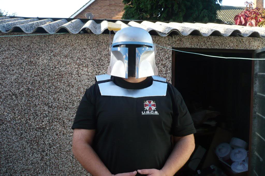

Spent the evening (after playing with the kids) dremelling the Scope and fitting my MOJO FETT Aluminium stalk which arrived today.

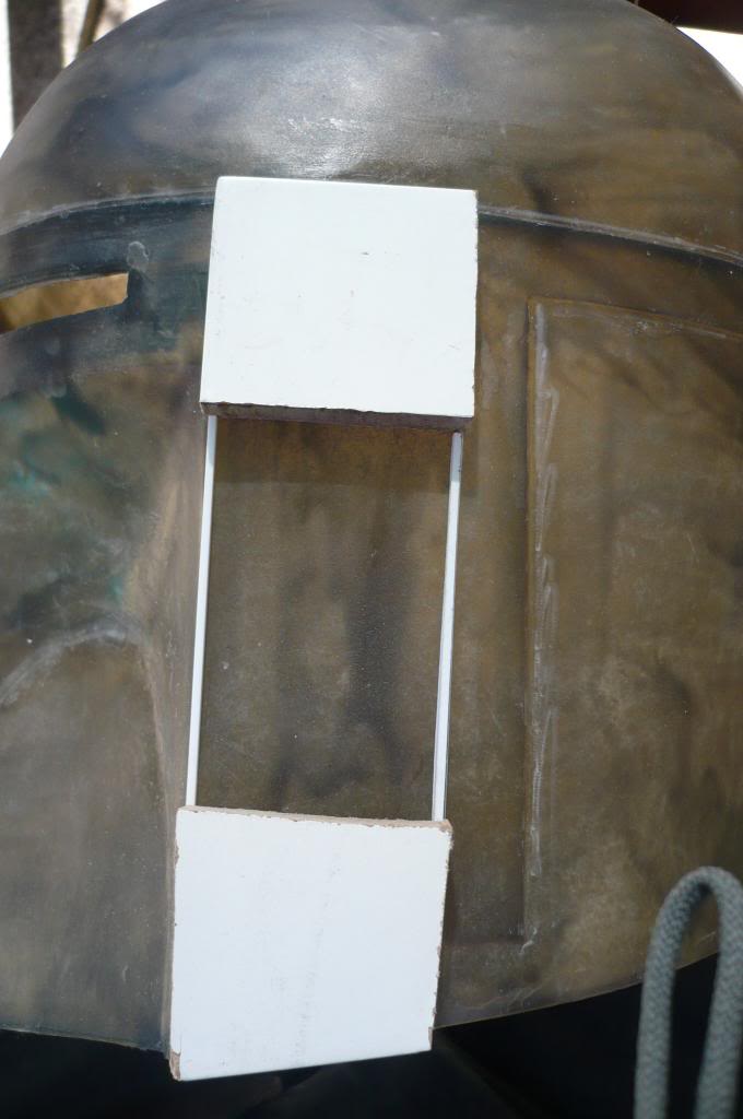

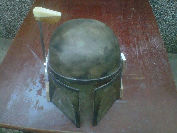

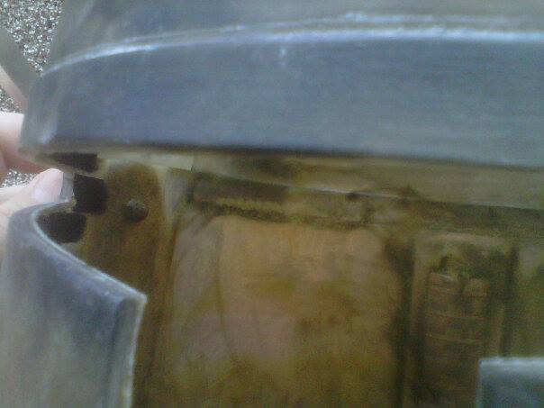

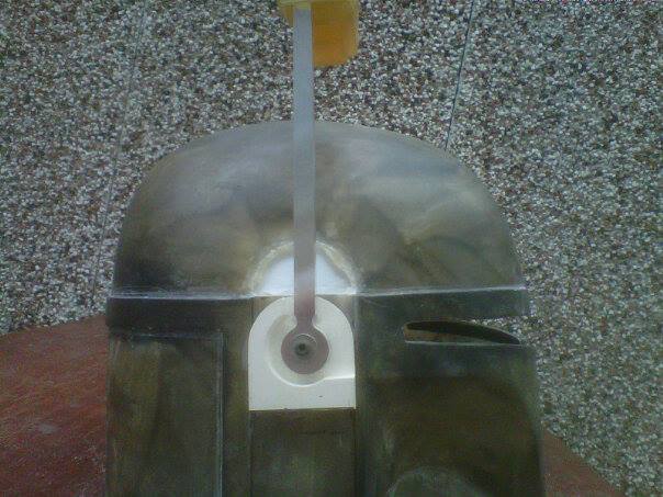

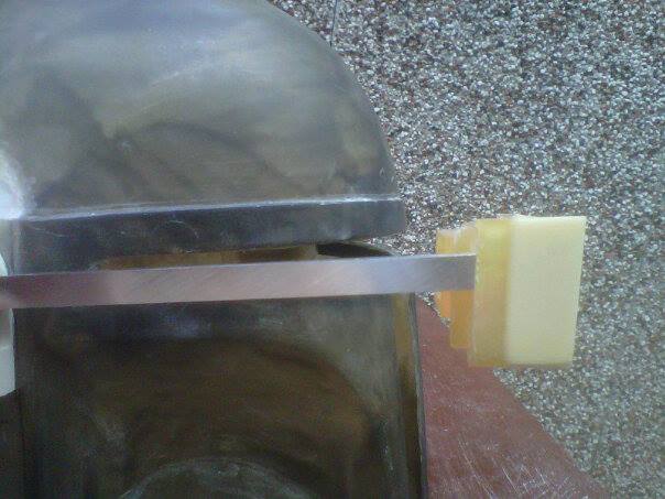

Worked a little more on the helmet this morning and dremelling on the Jet pack.

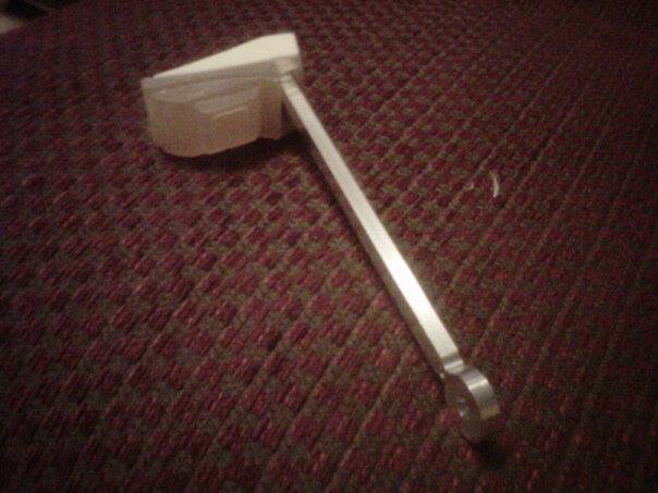

So helmet. Test fit of stalk and stalk housing to Lid.
Please LMK your thoughts, as not sure if this is the right way or if could do it better etc.

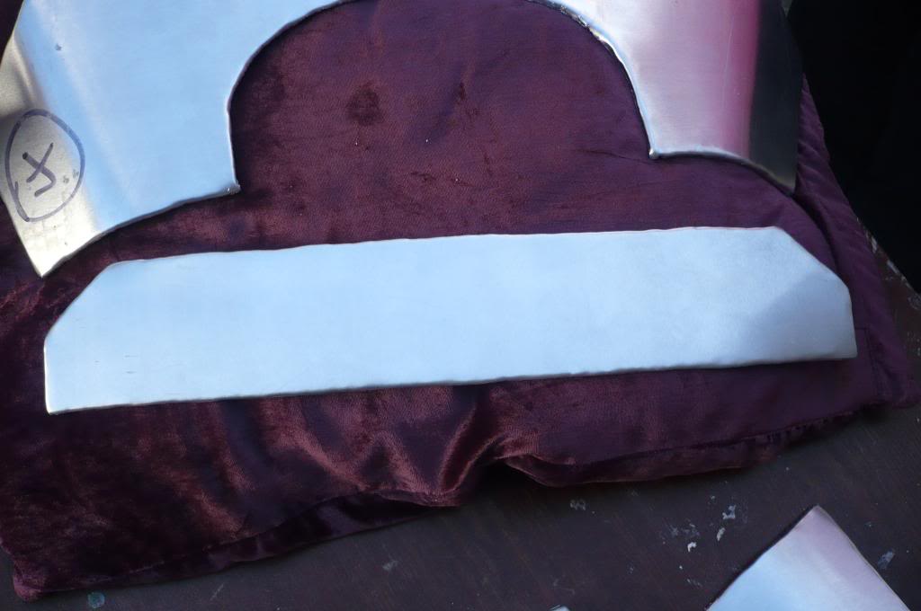

Well sorry for the delay, been busy between family and some costume fun none Star Wars. So not had much chance for Mando build :/

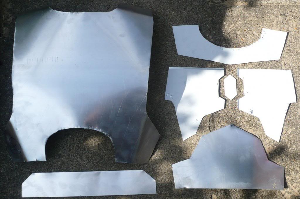

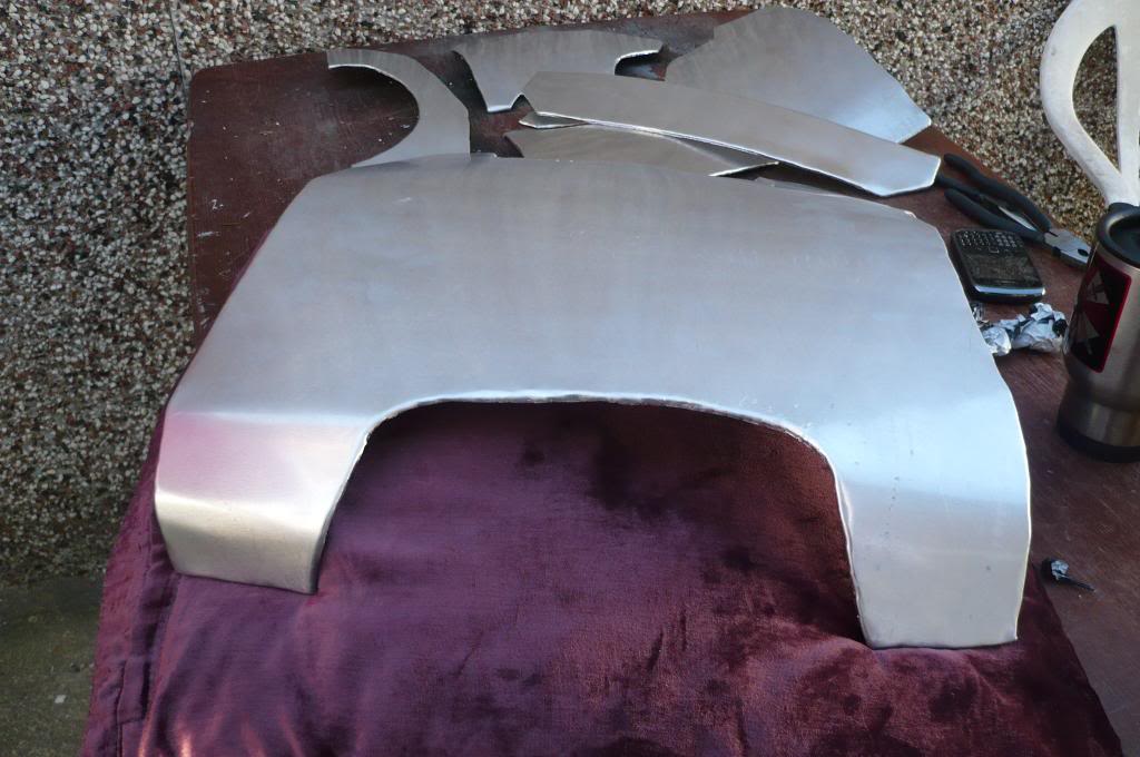

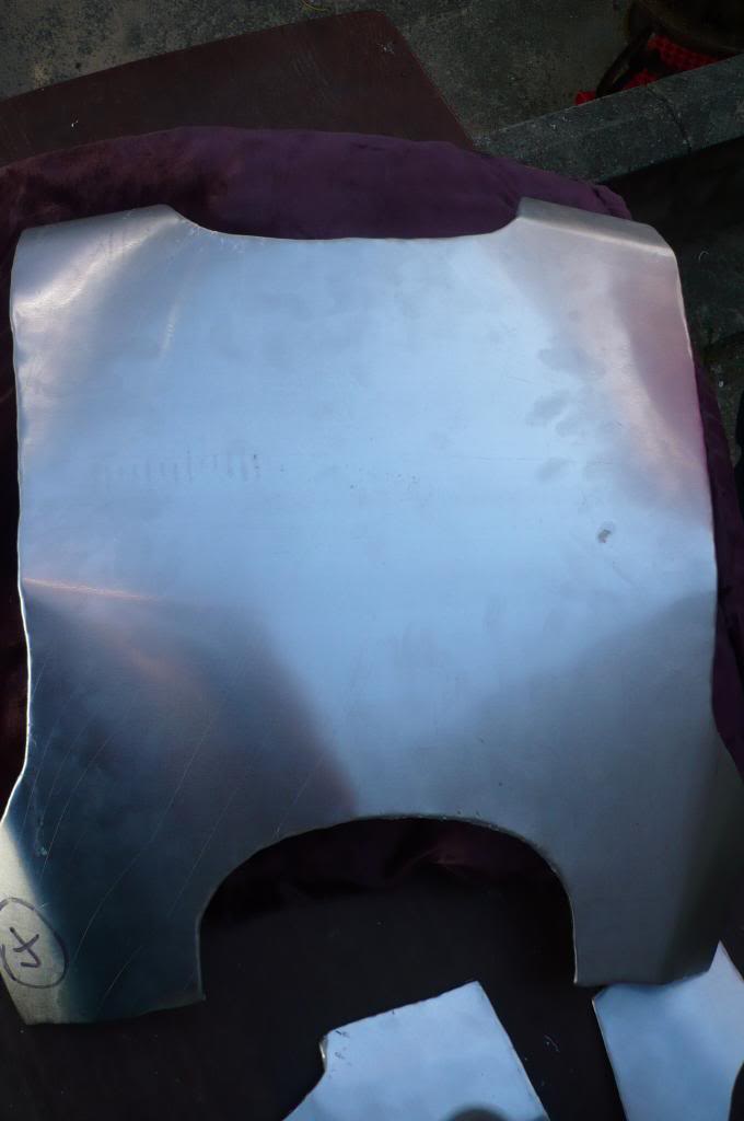

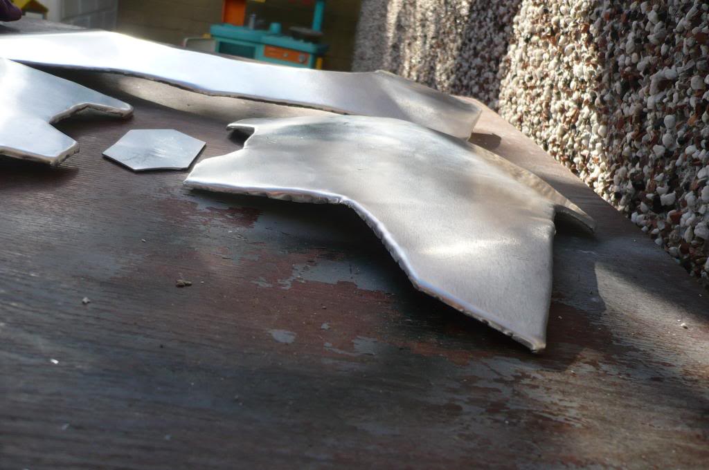

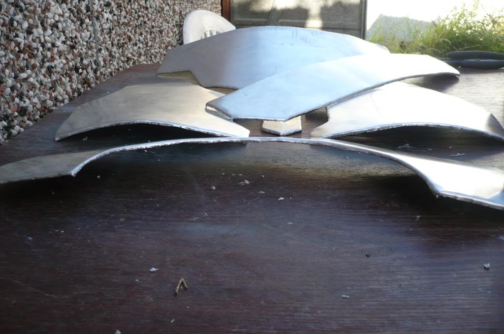

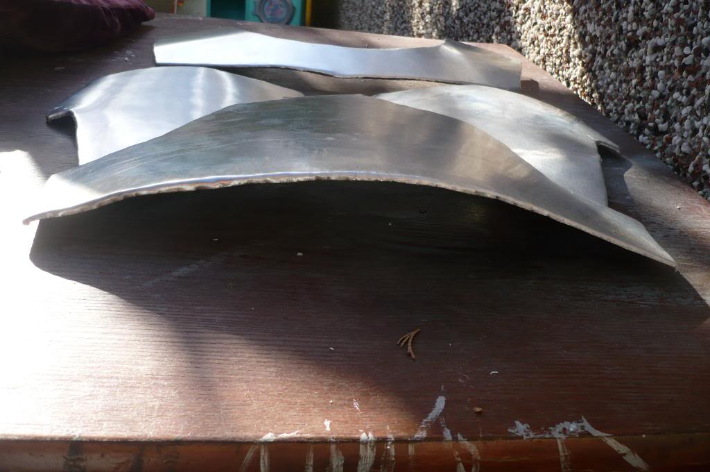

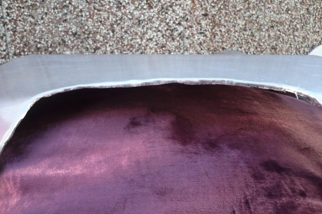

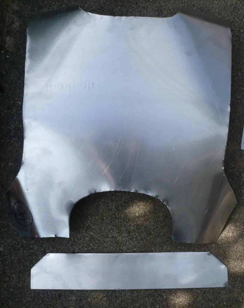

Well today got the armour in my sights to work upon.
Been crimping the Aluminium armour and then starting to shape it.
FRONT ARMOUR
- - - Updated - - -
REAR Armour
& the money shot
