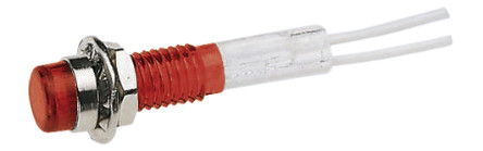

So .. back again working on my ROTJ Fett i decided to upgrade from the generic LED/holder to a more accurate incandescent part that fitted the measurements i'd found here on TDH
RS 576-478 (6V 40ma)
Unfortunately the old part was larger than the new which meant I'd need fill & repaint the area, i also wanted to replace the switch as it was a little difficult to operate i was almost put off doing the whole thing at the thought of having to re-do the paint part myself but after years of TDH lurking i felt up to the task haha

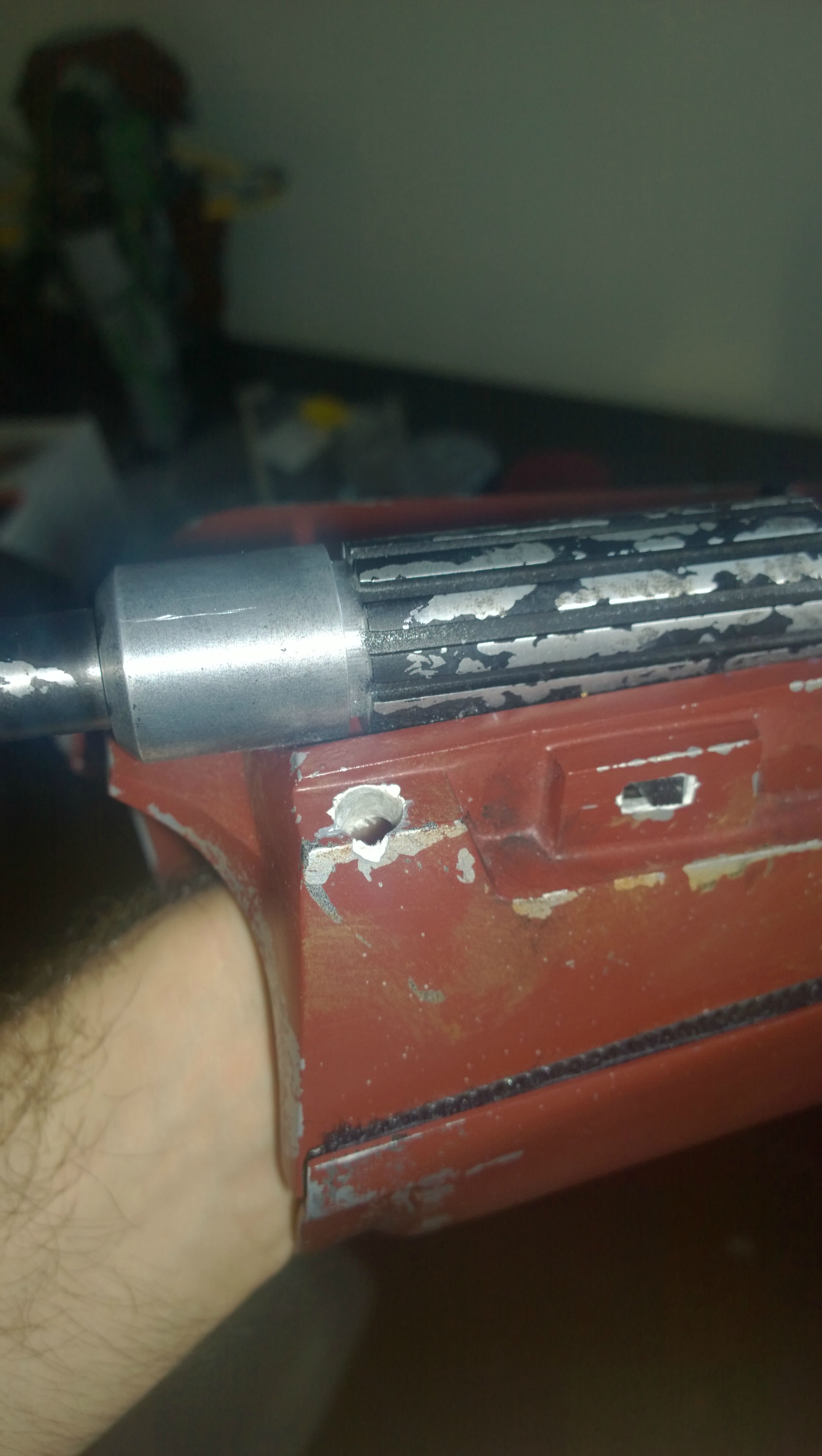

so here is the gauntlet without the LED fitted as you can see the side must've taken a little damage when it was fitted so it was good to patch that up anyway !

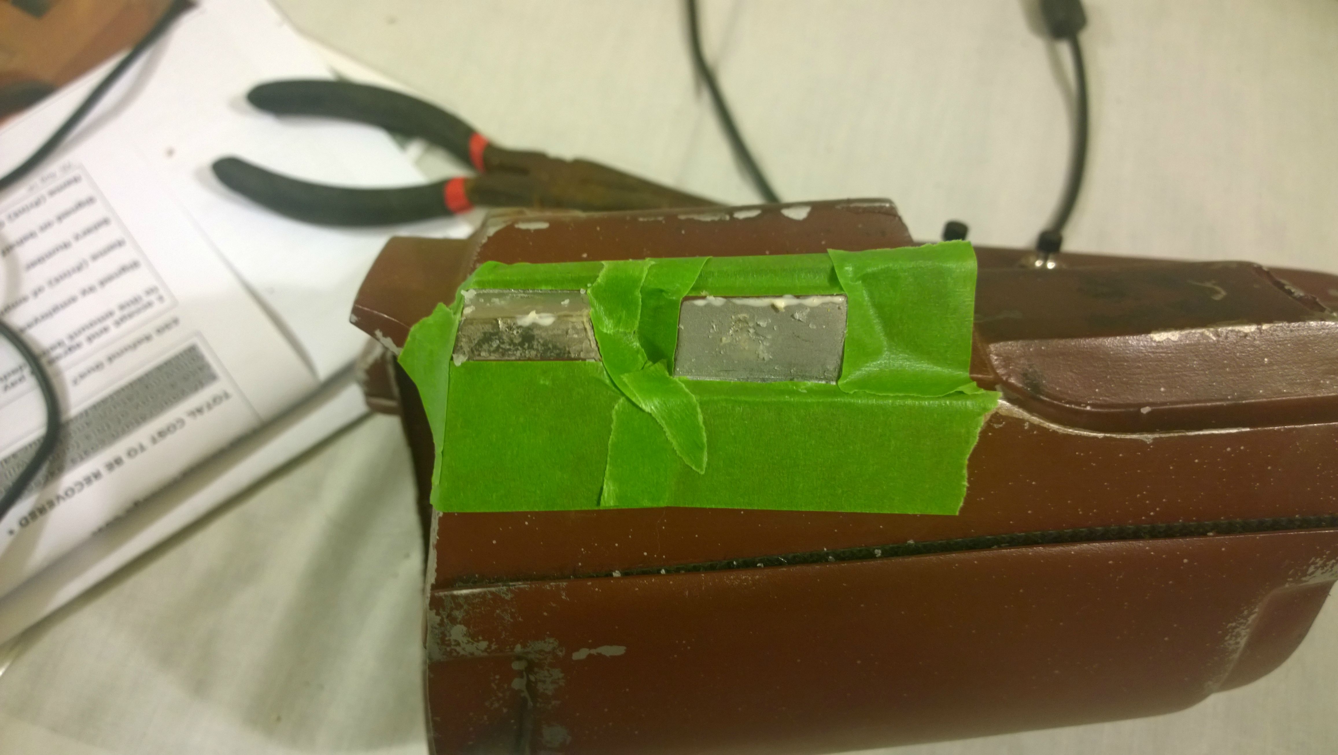

first up i removed the rocket and masked the area around the LED and the switch as well as removing the glue and switch from inside the gauntlet, I used Multi surface Frog Tape to mask my edges having used it for years for several house painting touch ups i was confident it would do the job (i NEVER use ordinary masking tape after several horrendous experiences with over adhesion or left residue.

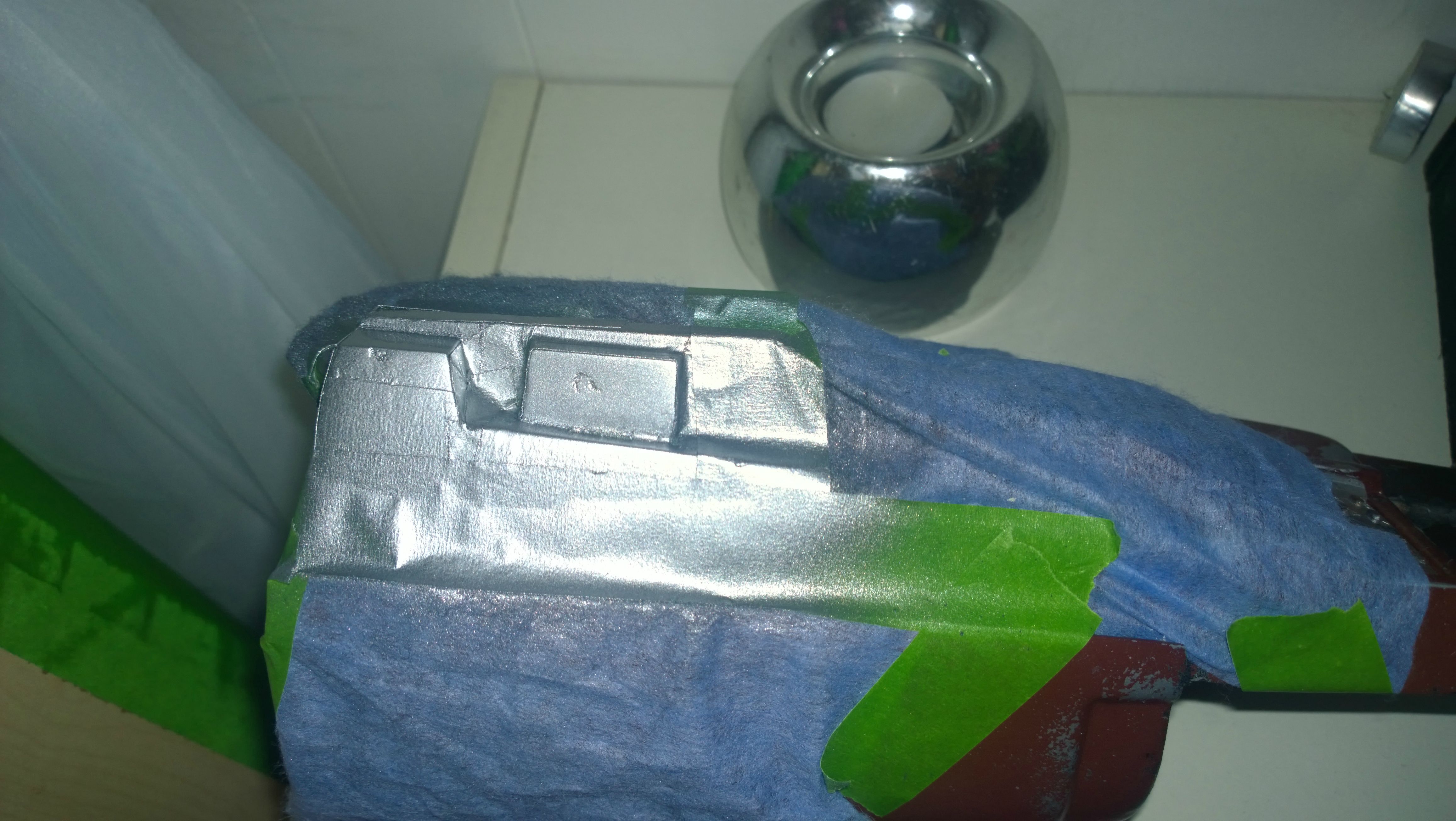

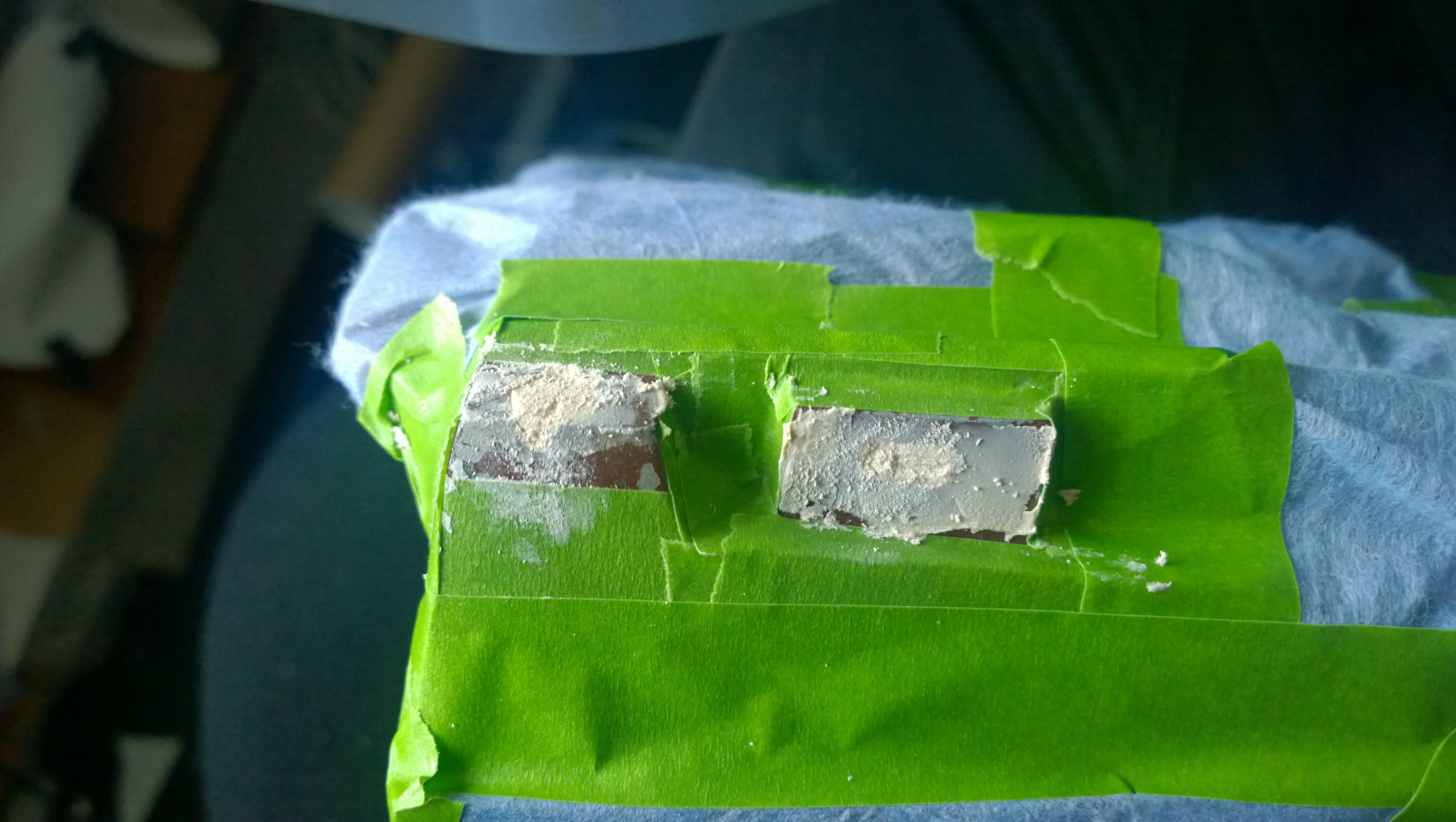

anyway after 20 mins it was set hard and i started with a sharp wood chisel to take the faces down followed by some wet & dry, below you can see the part after cleanup with a layer of herron grey velspar all in 1 primer/paint as a base coat with 2 coats of Rustoleum Elegant Metallic Silver
the few pits you can see where the filler hasn't covered enough i wasn't too bothered about as i'd be re-drilling in that area, or would add some damage texture to the edge
anyway after it was finished i removed the masking looked pretty decent

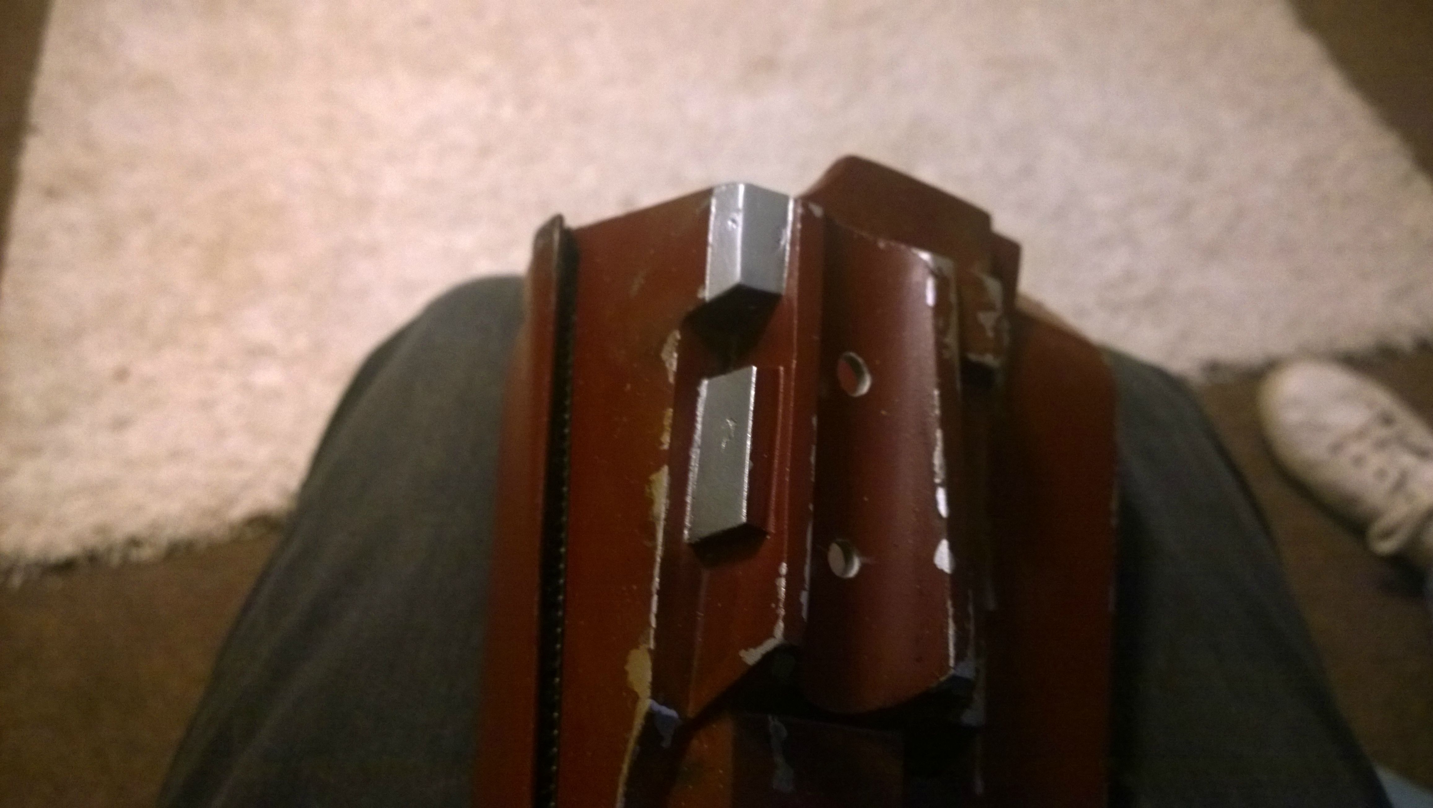

once this was dry i applied 2 layers of Rusoleum Claret Wine which was a close match to the paint on my gauntlet however after applying I might later repaint with Tamiya Flatt red & Hull red (which i've seen is another common used combo here in the UK)
for weathering i used a pin to remove the salt particles and the liquid latex mask, i also applied a layer of tea water to add a rusted hint to the silver to match and lastly which i think was my own addition to dirty up the switch and the light/as well as the paint/blending i applied shoe polish brush (with black reminant on) to the whole area to dirty things up

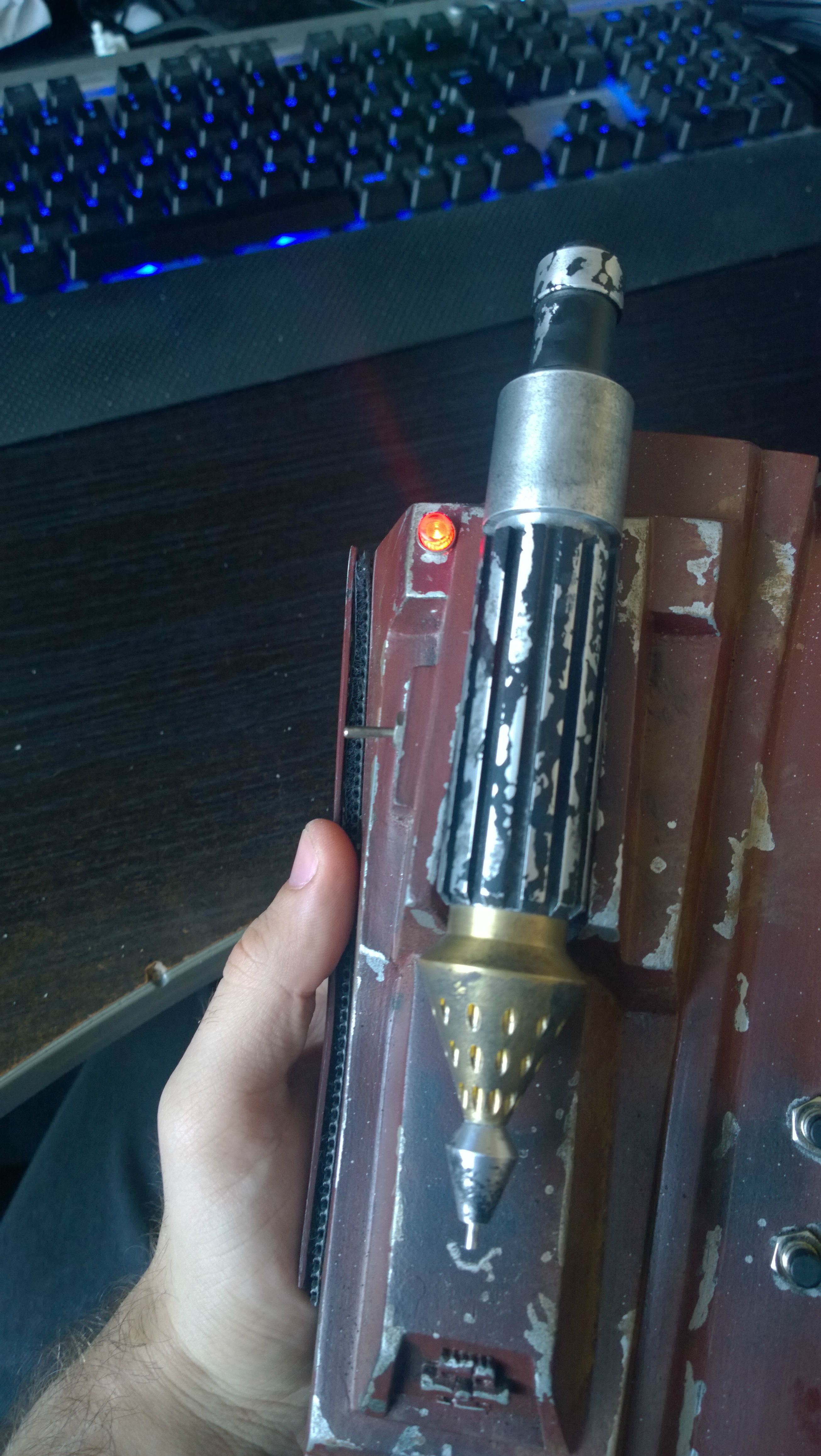

and now for the results with the new 6V Incandecent wired up to a 9v temporarily while I work on my fett-lectronics (combined rf servo/motor/GOW bulbs & gauntlet light/switch coming soon)
