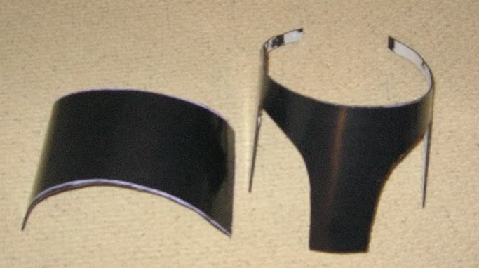

I grilled the bigger sintra pieces to heat them up to start shaping them.
Worked liked a charm, although I don't recommend actually placing them on the grill. Just hold it over the heat and bend it. I did lay one piece on the warming rack above the main grill and that left some grill marks, but it's where the keyhole slots are going to end up being anyway.

Pieces I cut and then shaped with the BBQ:
In the above pics you can see how I taped the "inside surface" template together in the back and then cut it where it goes behind the ears so that it won't have a seam in the back.

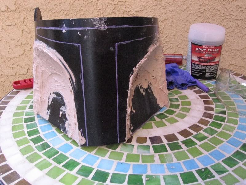

I had a lot of trouble with the gluing the cheeks and finally got impatient and just gooped them up with Bondo really thick. It looks nice on the outside, but the inside is pretty ugly. ;)
I then ran into some problems with the bondo "cracking" away from the joints with the sintra where it meets the T-visor. This was finally solved last night after I learned a great trick for pouring baking soda on top of super glue. It makes the superglue cure right away and also makes a filler for cracks. I also reinforced the joints with epoxy on the inside.

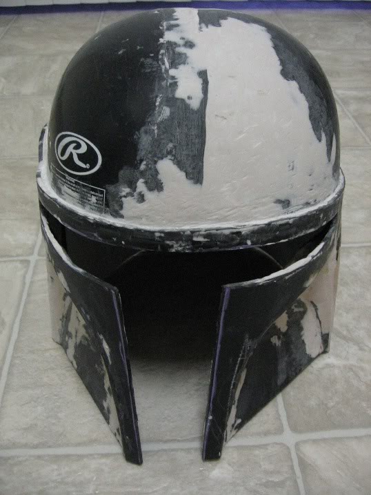

Okay, I went to "Play it Again Sports" (used sports equipment store) and all their batting helmets were 50% off. Prices ranged from 7.99 to 29.99, so of course I bought a $7.99 helmet that cost me $4.30 with the discount and tax. It was an adult size (6 1/2 to 7 1/2) and after I tore out the padding and cut the visor and ear guards off it was darn near the perfect size. I only had to cut it in half front to back to make it fit. A few sizes bigger would probably work without any modification.
It glued up nice with good old super glue (also used the baking soda trick to fill a couple gaps) and then I bondo'd the gap in the middle. I didn't have time to shape it, but I will soon.
I know a ton of people have said this, but it's really true that you have no idea how big this helmet is until you see it in person. With the dome on, it's huge! But I know i got the dimensions vaguely right because with just an inch or so of padding, my eyes center up perfectly in the T-visor area.
I took progress pics, but they are still on my camera. I'll probably get them posted in a couple days.

The batting helmet:
Glued up:
Bondo'd and sanded:
Side view:
Detail showing how I tapered the bottom:
From the side view pic I was thinking that the T Visor slit is too wide, but the more I look at it, the more I think I need to extend the slit out a little bit more (which will also make it come to a narrower corner). What do you guys think?
