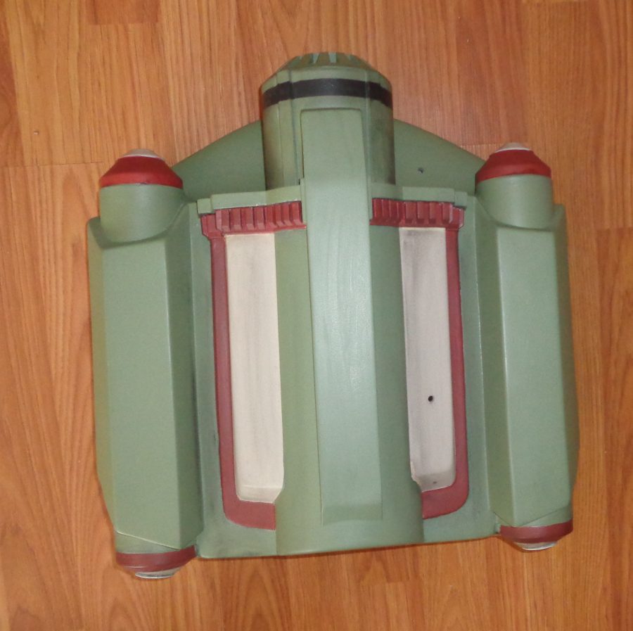

My Boba jetpack I made the piano keys using pepakura. I folded & glued the pieces together making a shell & filled them with a glue/spackle mix. Letting them dry then sanding them square. I didn't really give a good work in progress photos of them though.
Here is a link for the thread:
http://www.thedentedhelmet.com/f20/pepakura-jetpack-47919-post622406/#post622406
Here are the pep files in letter & A4 formats you will need the Pepakura viewer to open the PDO files. The PDF files can be printed at 100%.
Cutting out and super gluing them all was tedious and time consuming. But incredibly cheap and very close to accurate.

(I have to respray the left side. :()
