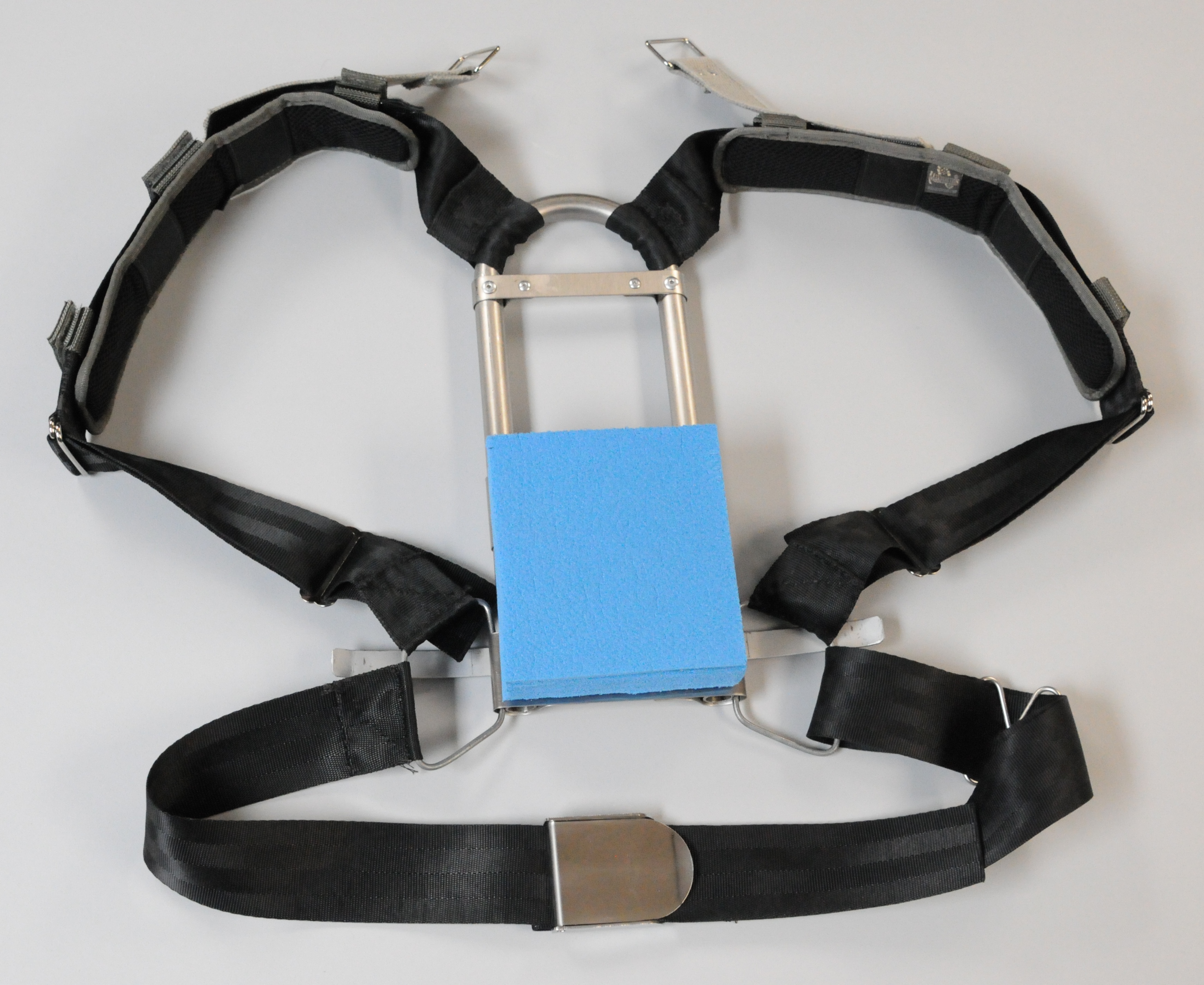

As long as I brought up the pull back problem with the front collar ,here is how we,in addition to the placement of the lower slits, fixed it. This is if you are using the metal pack frame patterned after the movie one. When viewed from the side we are trying to make that straight frame sit vertical on the convex curved surface of the upper back. Adding to the problem is the concave surface of the lower back. When you tighten the waist belt it tends to pull the bottom of the frame into the lower back and tilt the frame back off of vertical. Because the back armor is trapped between the jet pack and the frame and hooked to the collar armor.... everything pulls back with the tilt and weight of the jet pack....no fun. To keep the frame vertical when the belt is tight I made a foam pad to fill the space between the frame and lower back. It's about four inches square and attached to the lower part of the frame and fills the gap between body and frame. Use a fairly sturdy foam and build the thickness that works for you. I adjusted with 3/4" thick pieces glued together with contact cement. When done this can't be seen and added greatly to the comfort factor of our ESB Bobba. No pull back at all.
placement fit vertical
The armor will slide straight down between frame and jet pack and hook cleanly on top of your shoulders.
Because of the thickness of your individual pad it should help anyone on pull back problems.

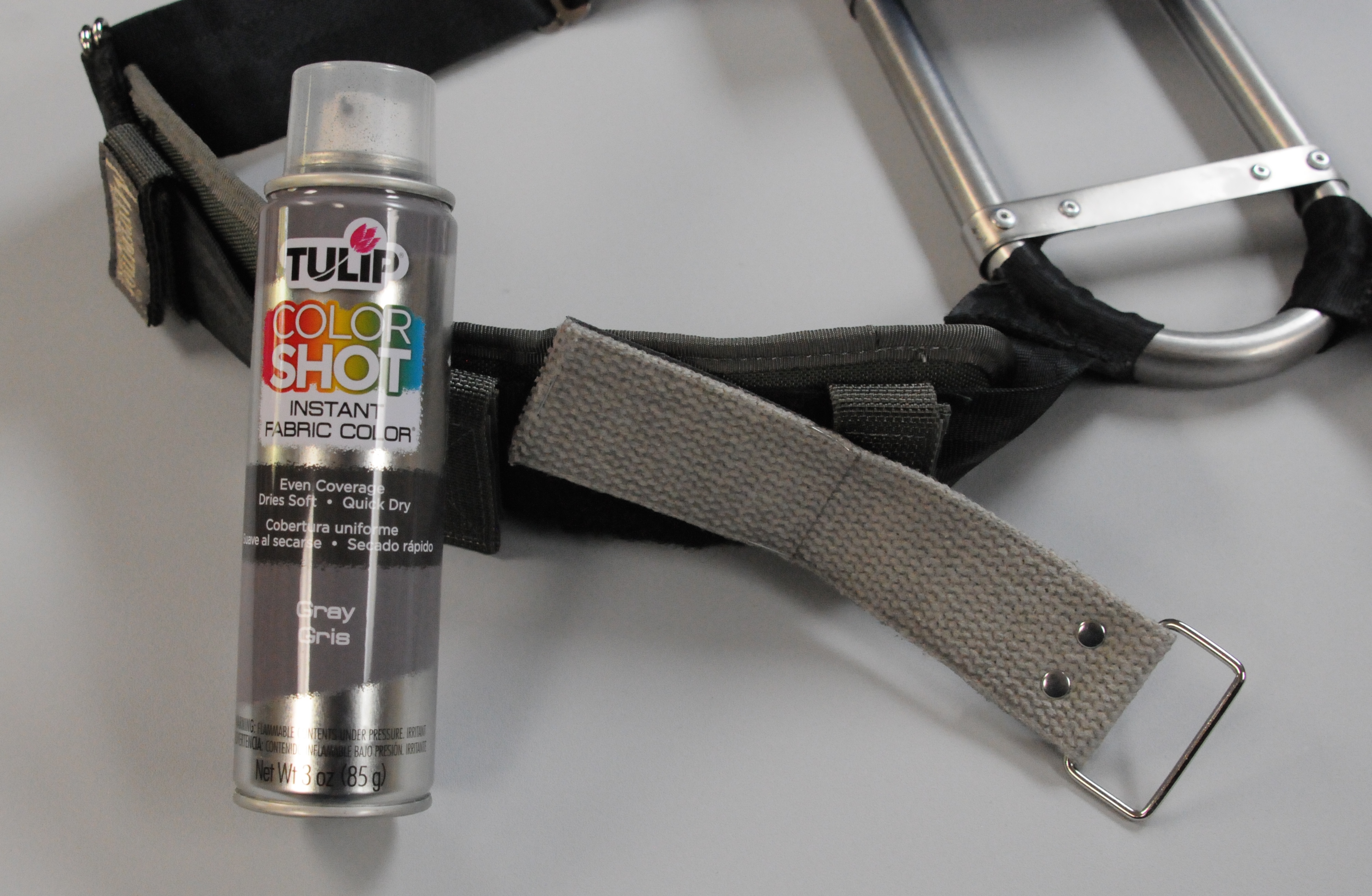

Even though the 501st CLR says that the jetpack shoulder straps are white.. they are clearly gray in ESB.
I used this spray dye to change white strapping to gray.Rubbed them down a little to even the color.

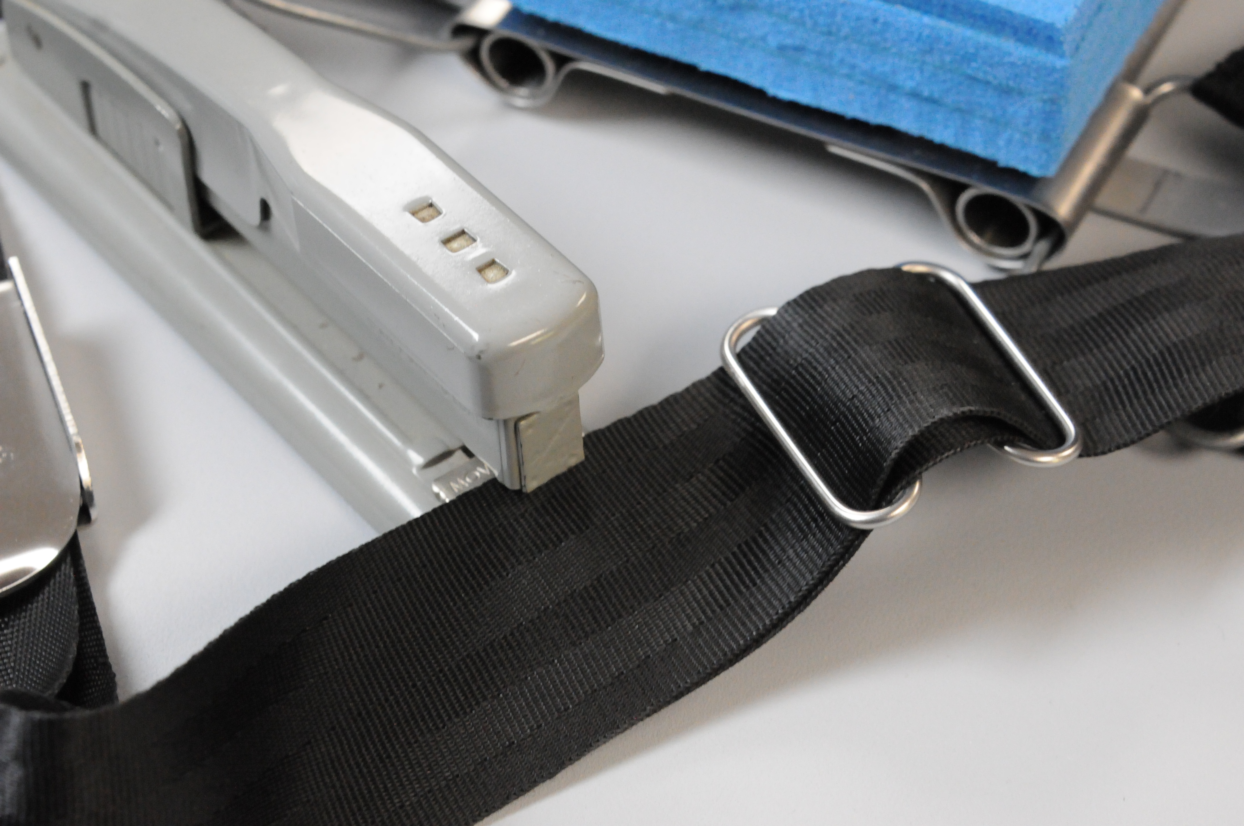

When adjusting or for permanent hold on straps I find that staples work very well.
Just crimp them with pliers or tap with a hammer when you're set. They last but remove easy for adjustment.

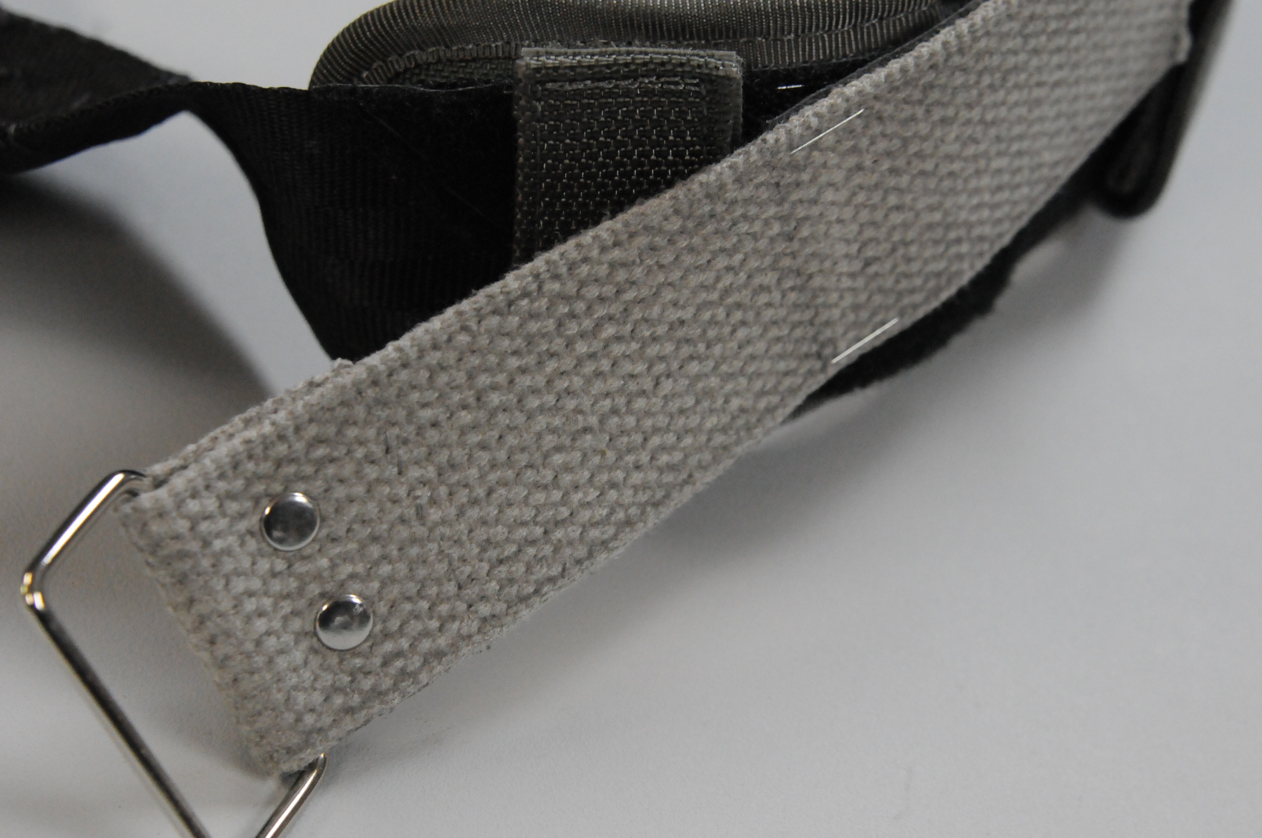

Here I'm using them to help hold sticky back Velcro on the jetpack straps
