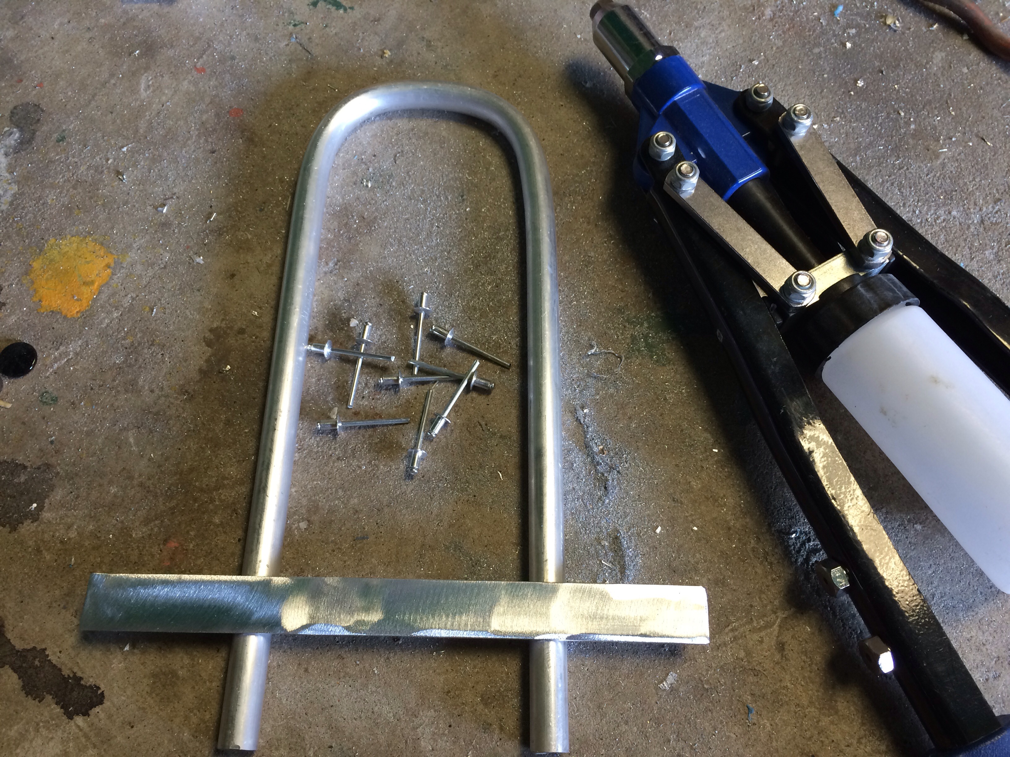

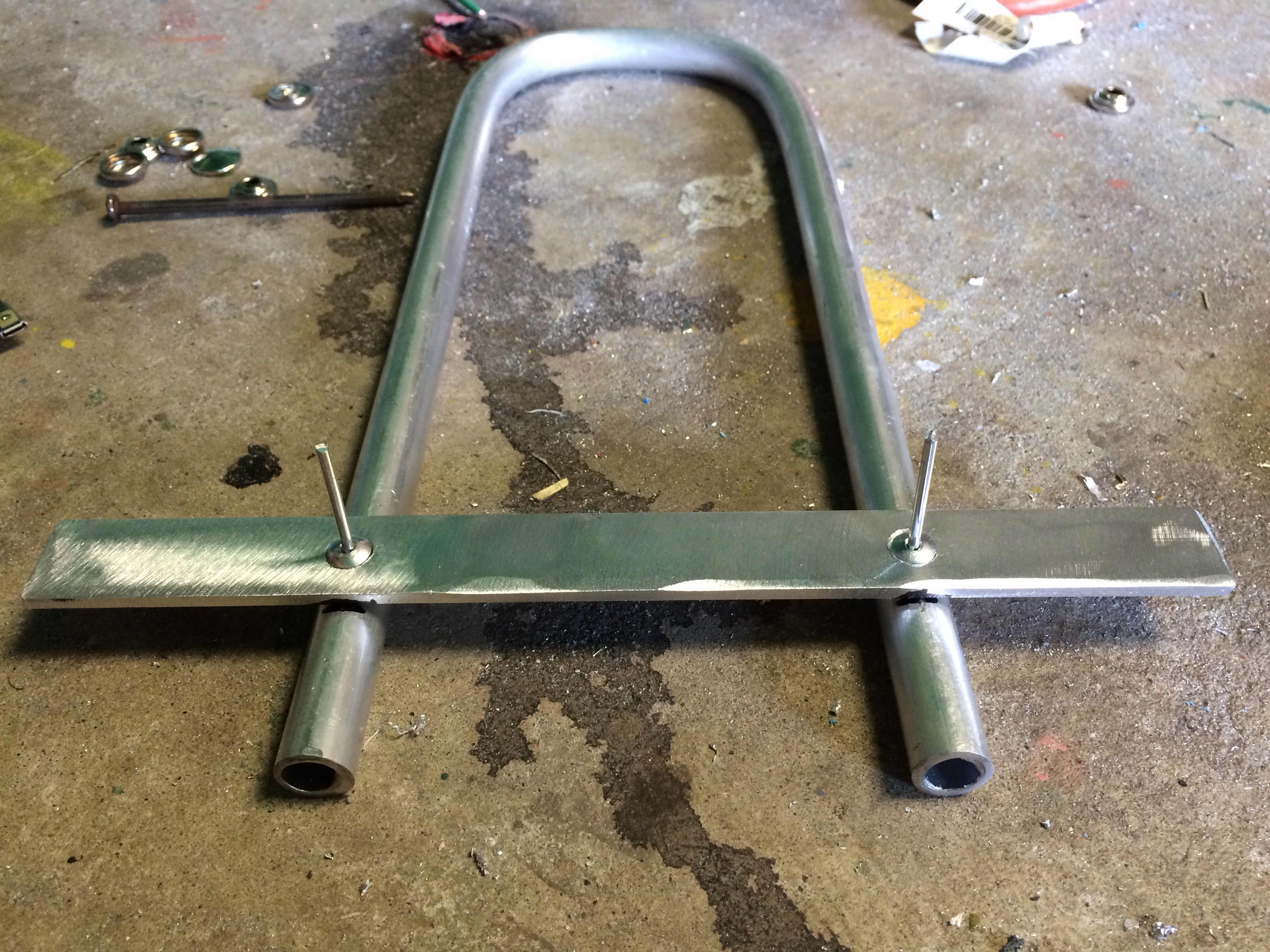

This has got to be the cheapest and simplest build to date
all parts can be found at Home Depot for around $15
aluminum tube $5
here is a tip plug one end of the tube fill with water then plug the other end freeze the tube when you go and bend it around something round the ice will keep the tube from crushing or kinking

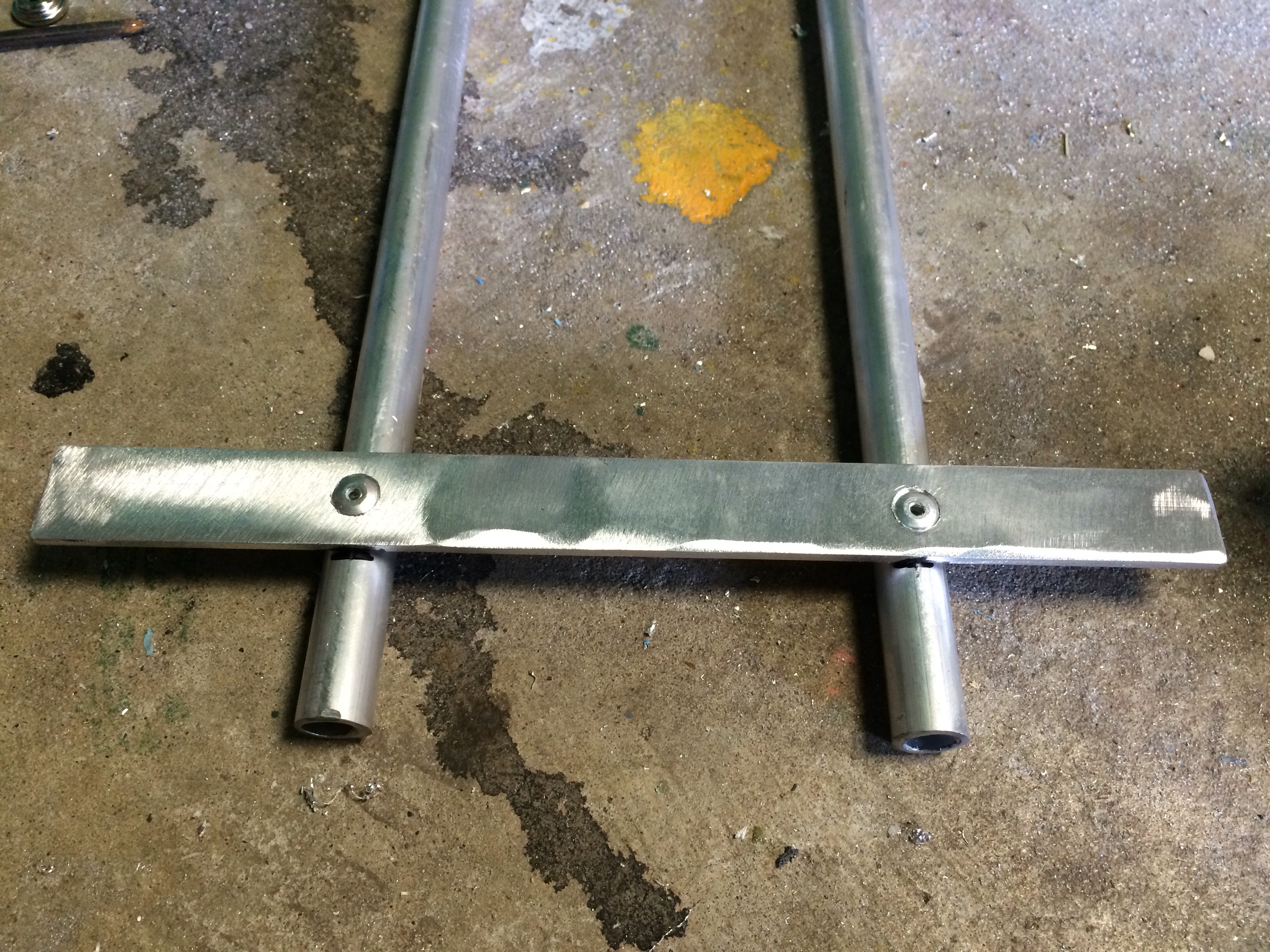

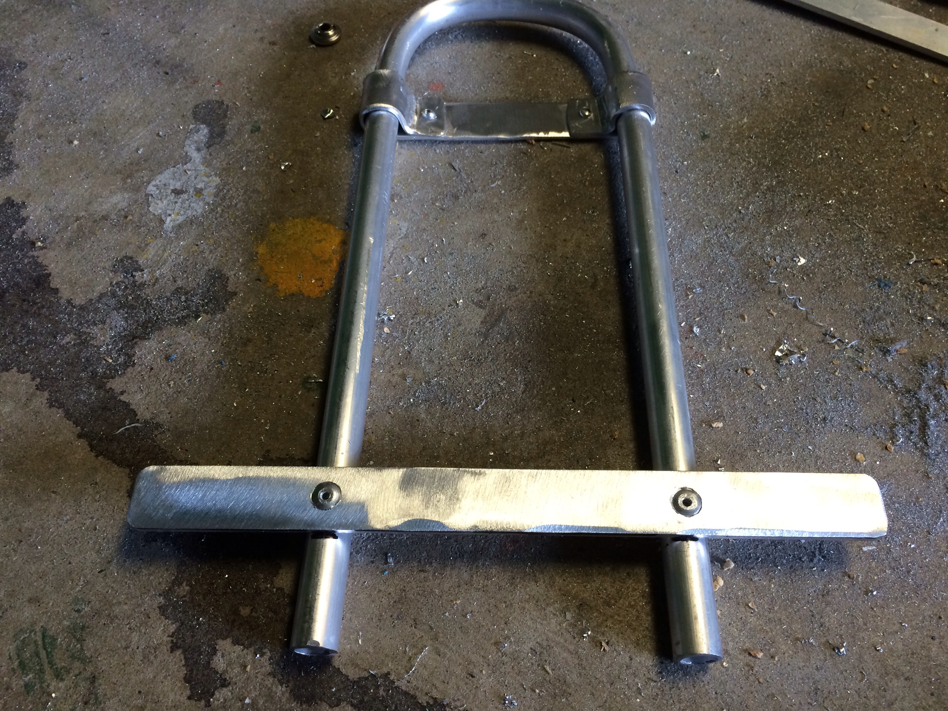

So once you have the tube bent take the aluminum strip you cut and align it up and Mark your holes then drill and counter sink them use your rivet tool to join the metal peices

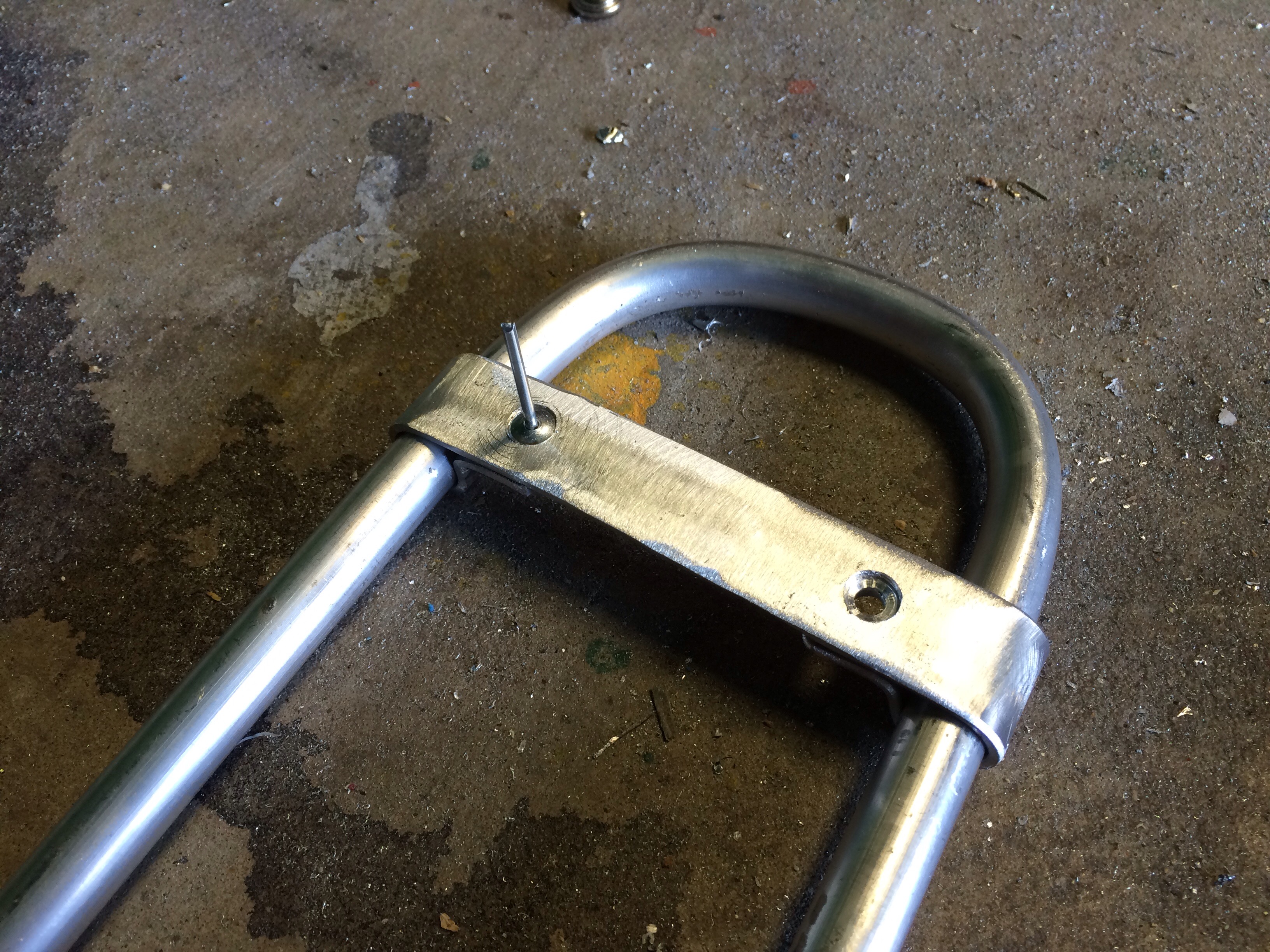

Do the same for the top support as well.

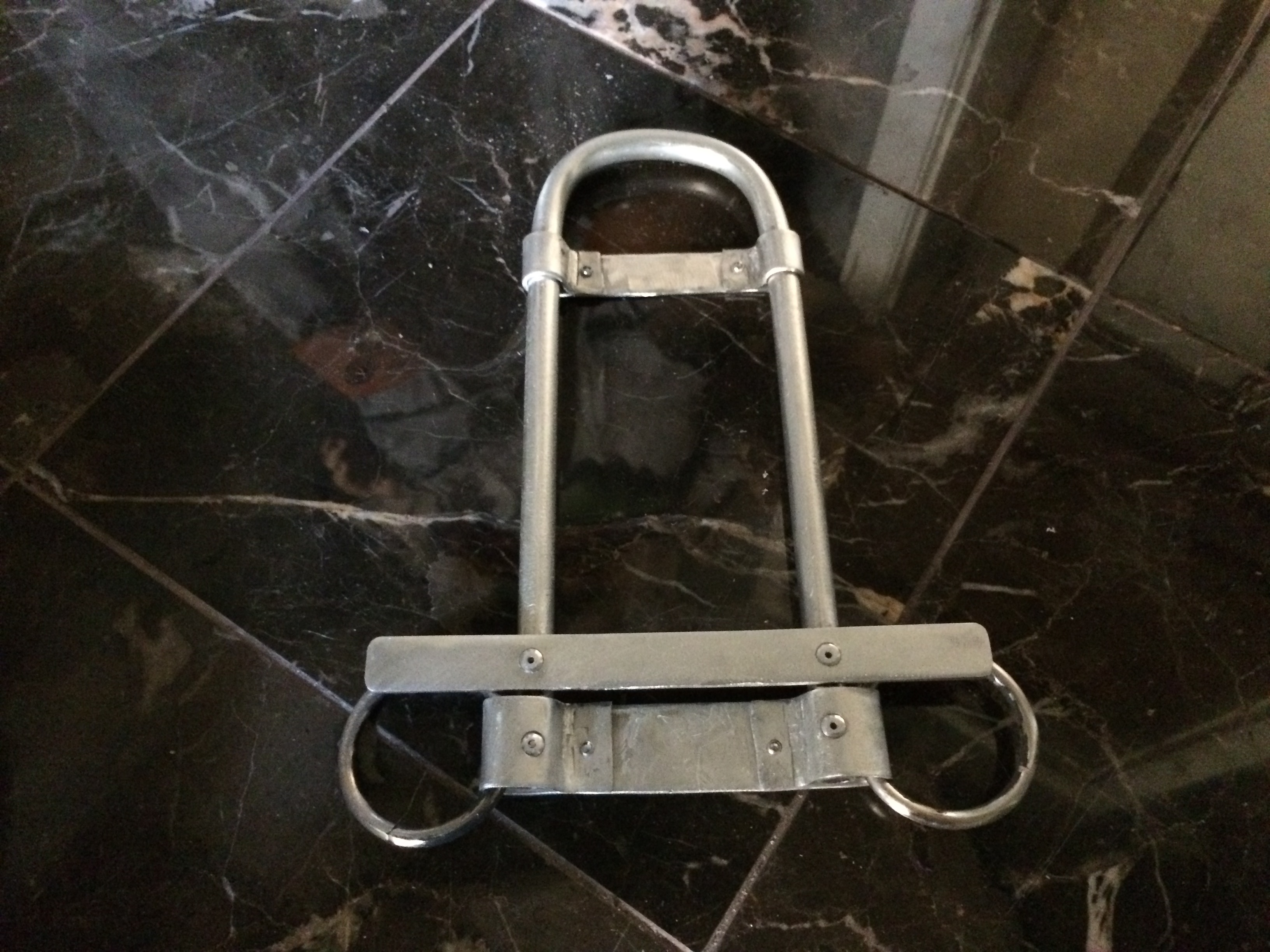

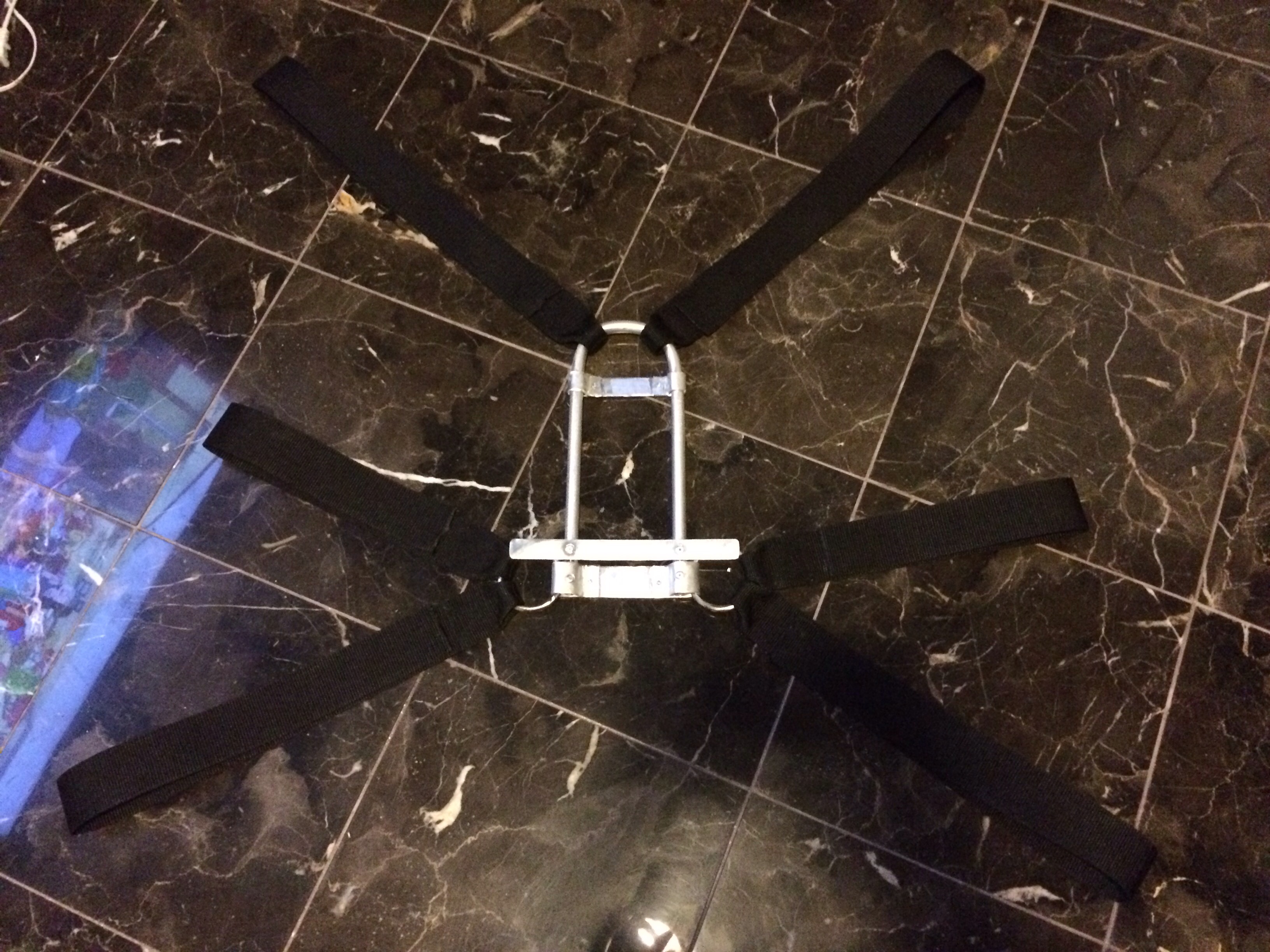

Finaly ls wrap the bottom support around you d-loops I used a hammer a flat bar fotr he tight inside bend.
Sewn the the straps on I should have the clasps soon

great ideas with the water -n- sand !! i will be going to the hardware store this weekend
Never heard of this before, with the ice, but it sounds interesting!
I gotta say, that is legit af. the only thing i can think of is that if you make another in the future, see if you can find some square rings for the belt.
I can get them from strap works I just needed this thing done I have only 2 weeks left till Dallas con. Mike hurry up and start making gloves again I neeeeeeeeeeed a set lol :P
