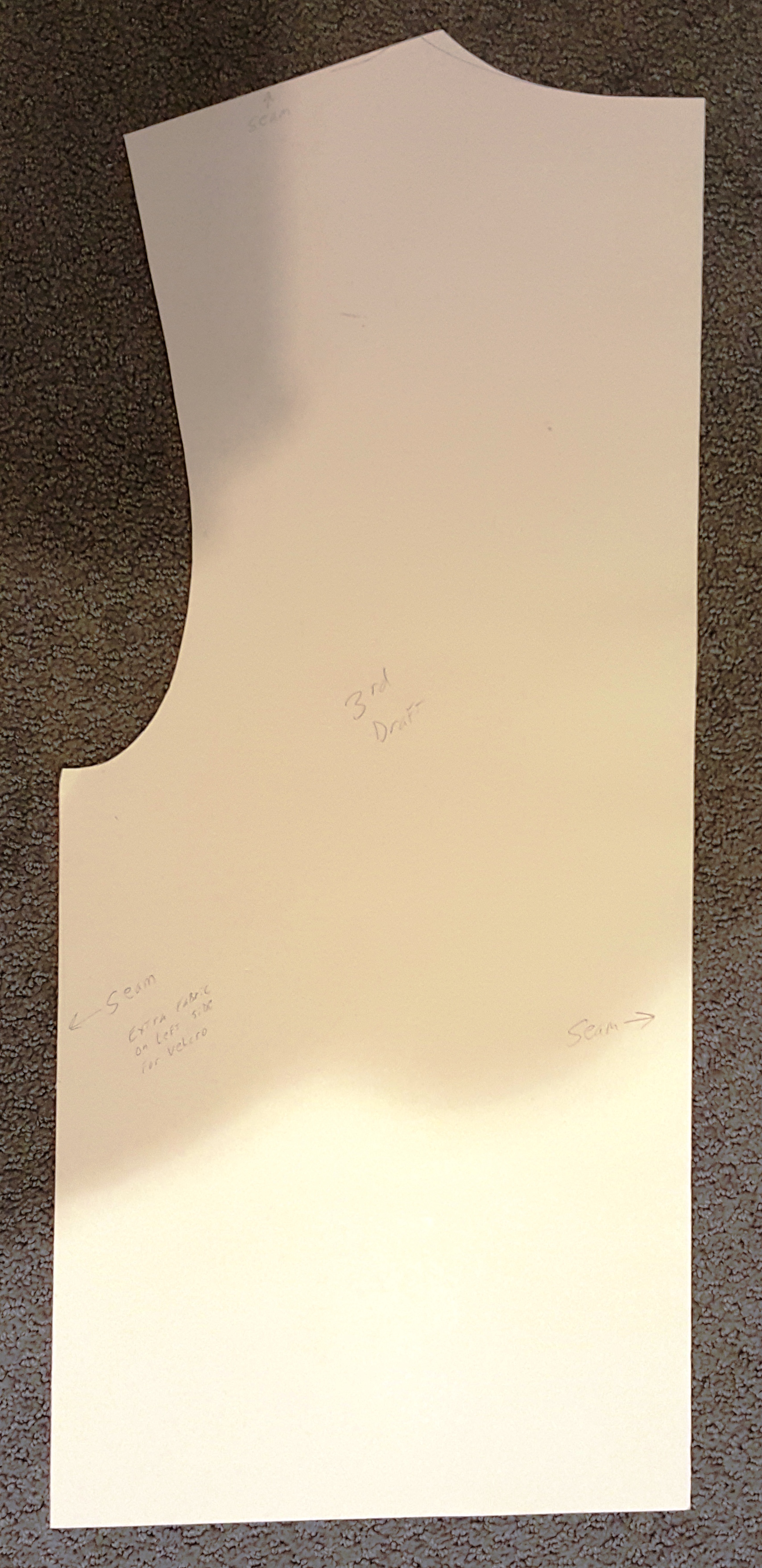

This is what my pattern looks like.
FRONT BACK SHOULDER

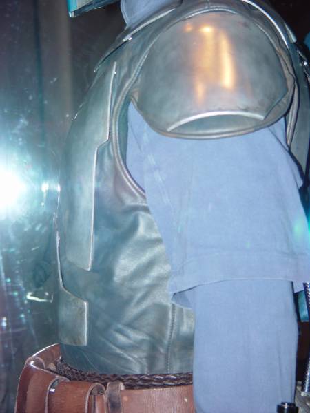

As far as the stitching goes there is a seam down the middle of the back (double stitch) and one down the right side from the armpit to the bottom (double stitch). The top of the right shoulder gets the same stitching. The top of the left shoulder has a seam that is Velcroed together it is only stitched for about the first inch from the shoulder (not double stitched). From the left armpit to the bottom is velcroed all the way down (overlap type of Velcro).

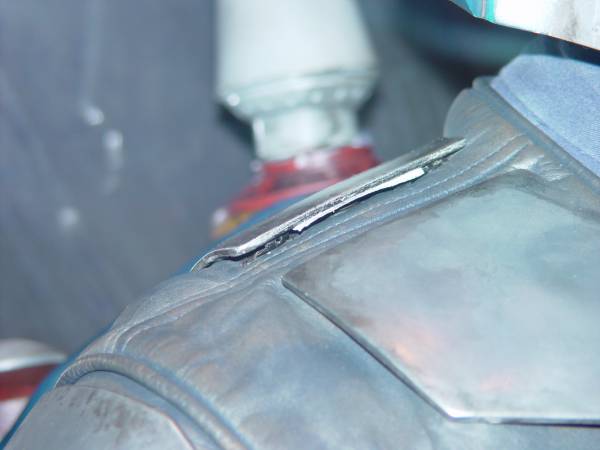

The piping must have a filler in it or it will look to flat and has to be sewn in. The seam from the shoulder and middle back soul not extend into the piping. See pics.
LEFT SHOULDER LEFT SHOULDER RIGHT SHOULDER BACK STITCH

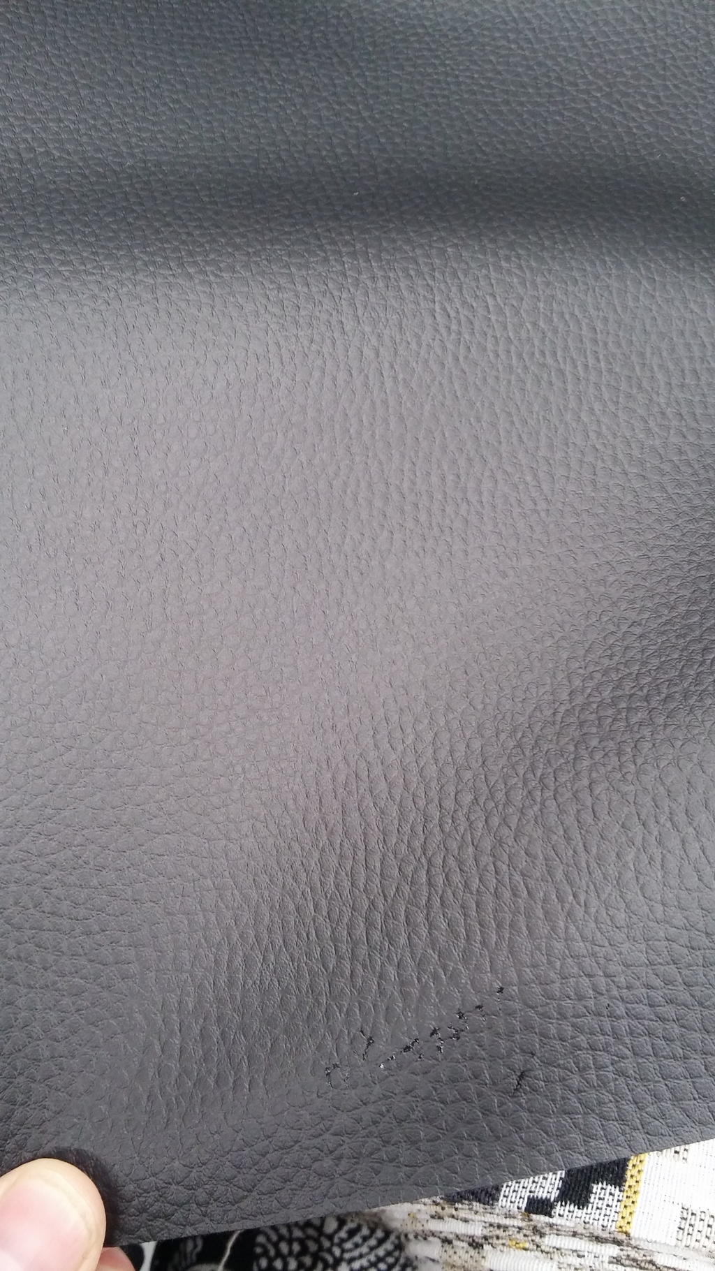

Is that material leather? and where are you getting it from? I might be interested in purchasing some since I'm having a difficult time finding the right color.
Thanks for the info. I actually got lucky and found the perfect leather (I Think) it was at Tandy leather on the bottom of their pile. Lots of digging to get to it lol. It has that slight bluish hue to it and goes from a dark grey to a light grey depending on lighting, The rough side is a denim blue color. It was the last one they had but I probably have enough leather to make 2 maybe 3 vests. I don't know what it's called all it says is Made in Argentina but for anybody with a Tandy Leather near by it was on their Whole Hides Assorted Colors table and measures .047 to .038 in thickness so basically 2 - 3 oz. (I measured it with my Digital Calipers)

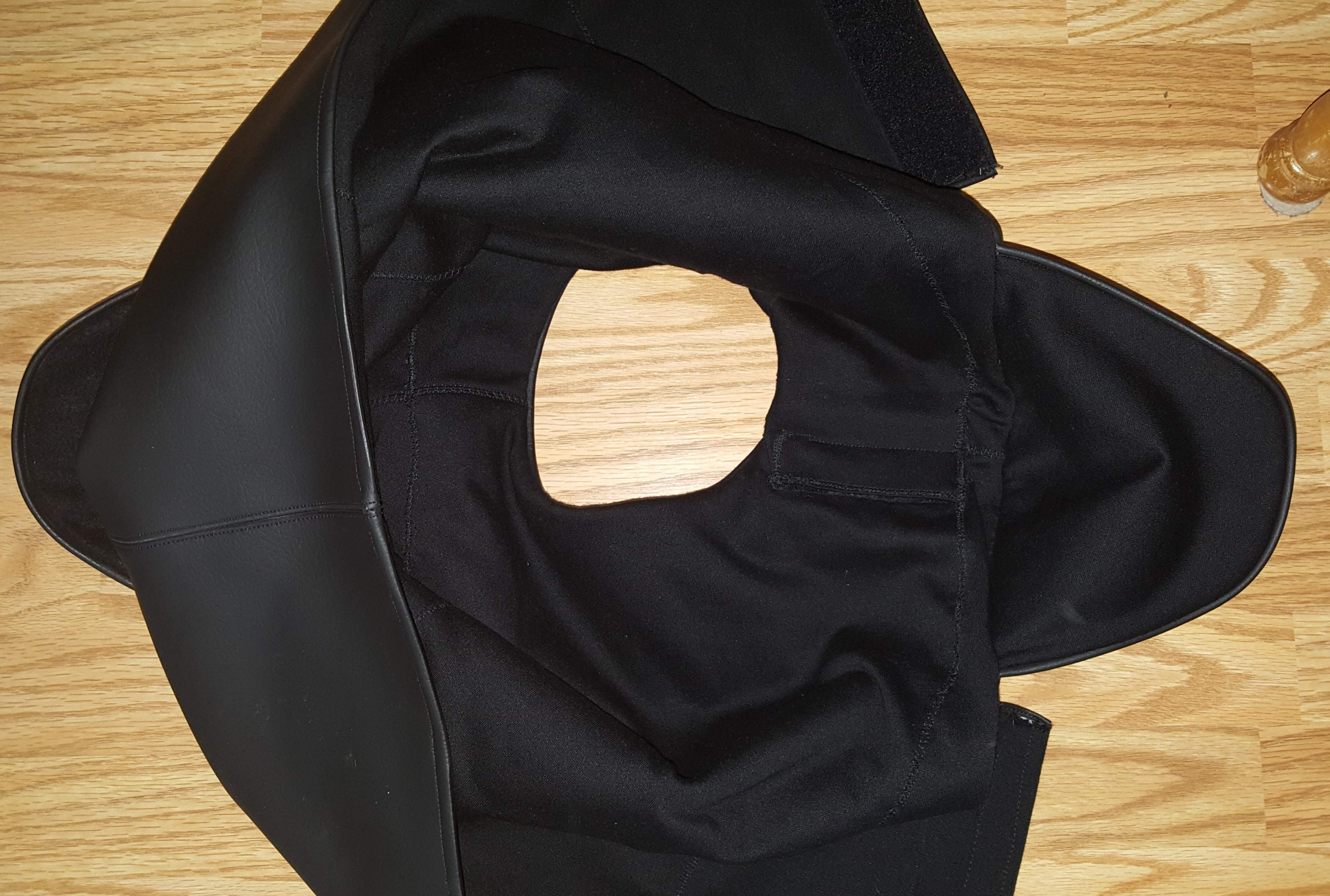

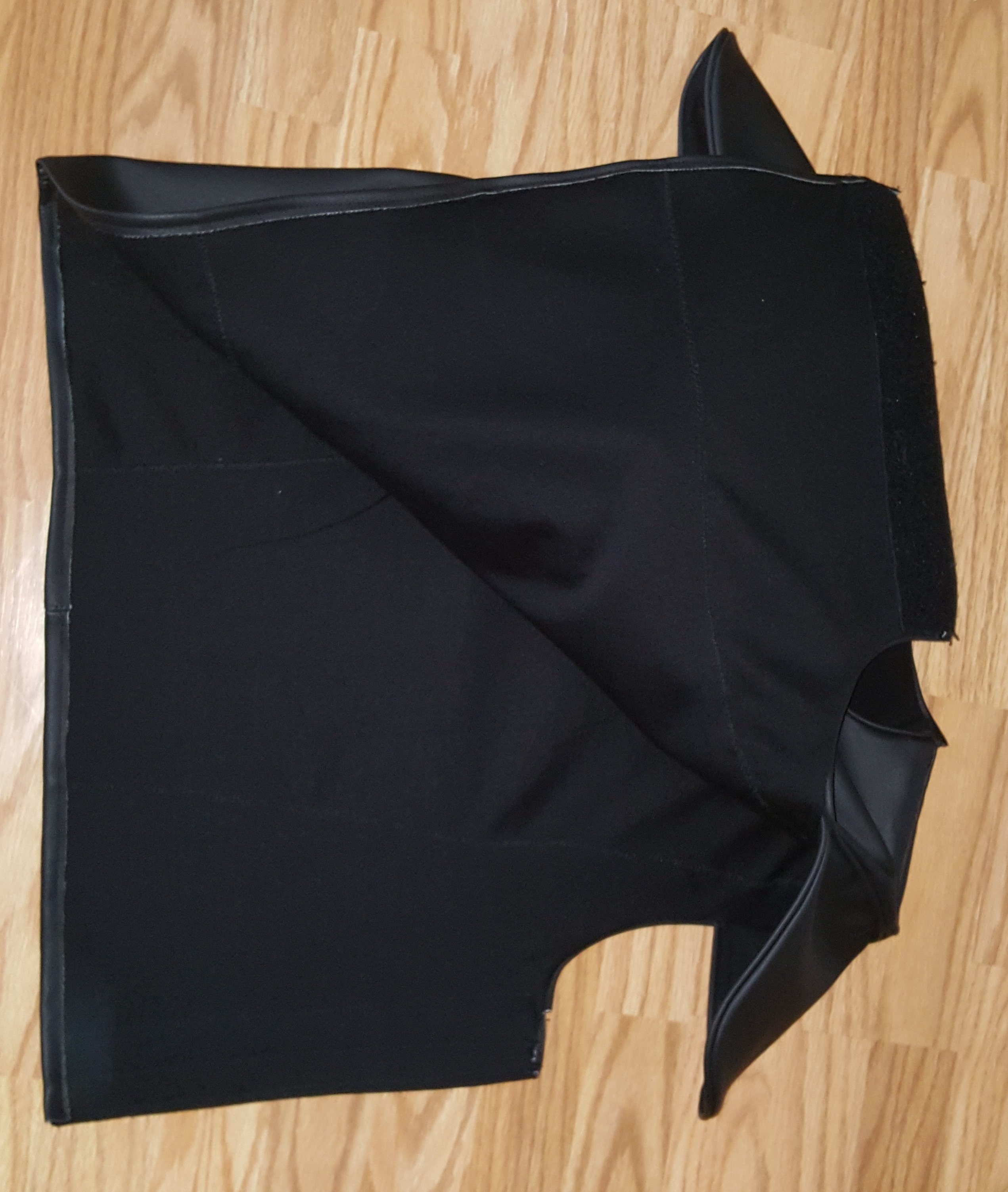

Other wise I will be selling the one that I am currently working on but it may be a few months before that happens. I'm making my current one out of a charcoal colored vinyl to get the pattern correct and work out the assembly process. The hardest part so far seems to be putting in the liner I'll post pics once it's done. I'm also testing the use of a zipper down the left side (under the arm) that will be covered by the Velcro flap. I already tried the zipper with no Velcro on the shoulder but couldn't get it to lay flat so shoulder will be Velcro. I might try the shoulder zipper again on my other test vest but using a smaller zipper. I just hate Velcro it wears out and sometimes pulls apart when moving around.

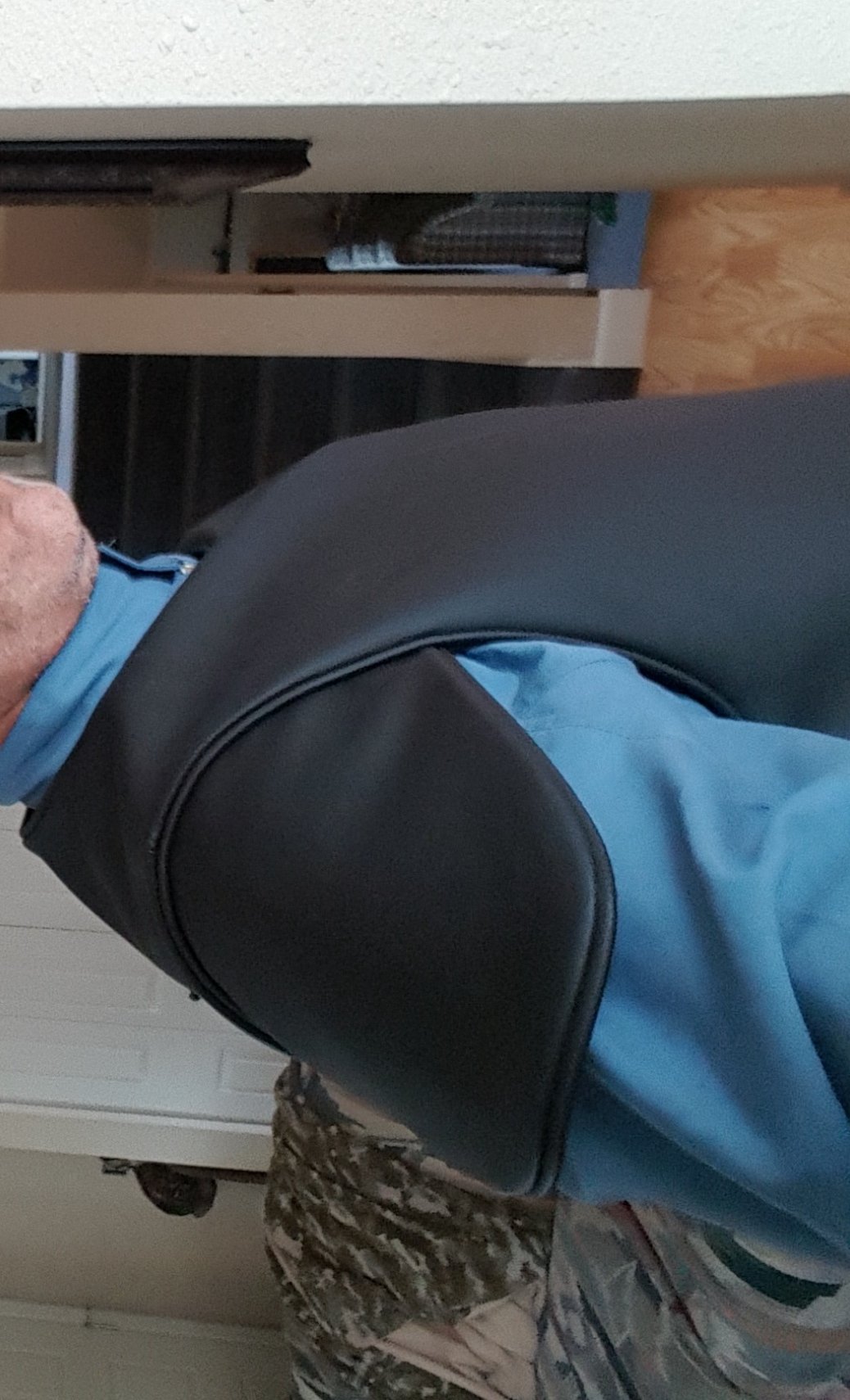

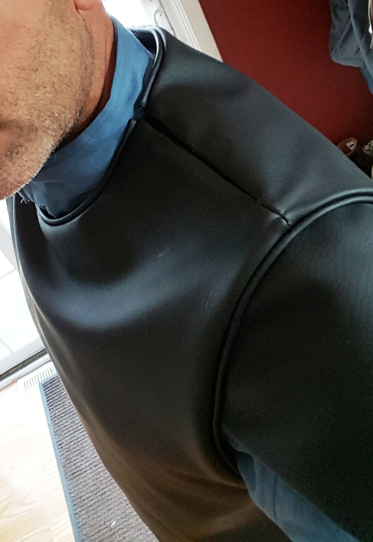

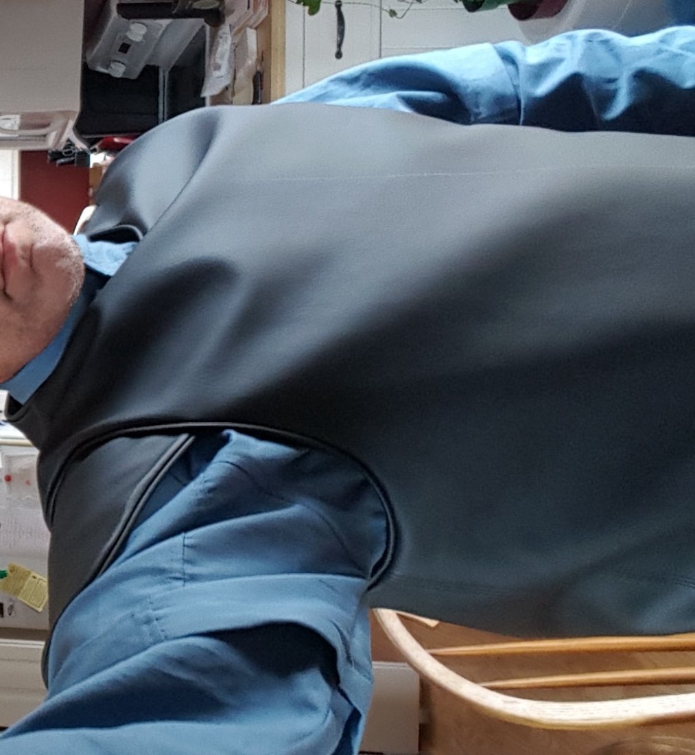

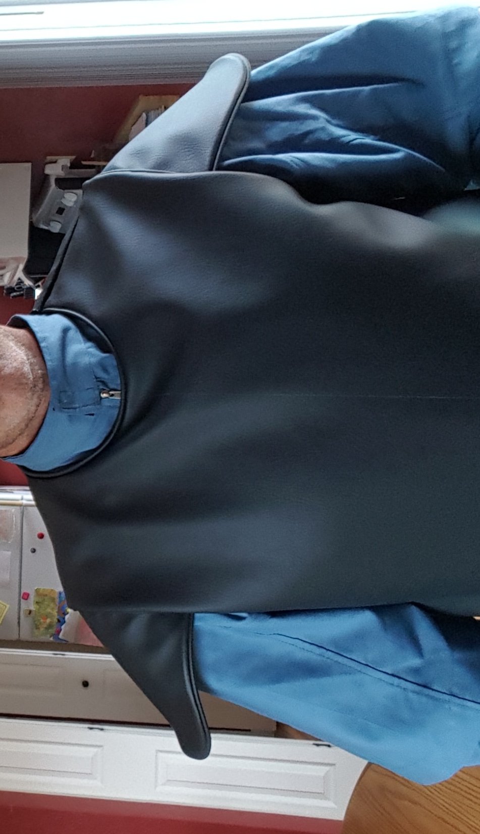

Ok well I just finished my second vest and it turned out well but I still think I need to make some adjustments to the pattern. I was thinking about dropping the bottom of the arm hole 1" and reducing the chest material by 1/2" on each seide, I think the front neck line needs to come up about 1/2" and lower the back neck line by 1/8". tell me what you think.
Vest 1.jpgVest 2.jpgVest 3.jpgVest 4.jpgVest 5.jpgVest 6.jpgVest 7.jpgVest 9.jpgVest 10.jpgVest 11.jpgVest 12.jpg
View attachment 99221View attachment 99222View attachment 99223View attachment 99224View attachment 99225View attachment 99226View attachment 99227View attachment 99228View attachment 99229View attachment 99230View attachment 99231
AMAZING
looks amazing , I love it!
Thanks for the kind words. I still think it needs some adjustment though. Can you se anything aside from what I mentioned that should be adjusted?
Just an FYI this one is made of vinyl I'm dot doing my leather vest until I'm happy with the fit.
