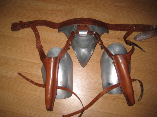

Here are some pics of how I have mine set up........but again just use these as ideas. If you are going to make the items look heavily at the gallary and screen shots for your specifics. Just for ideas......

i have cruzers belts/holster n so worth the wait they are just perfect u be so happy with them i have the harness(made by seeker) attached to the codpiece/belt to help with the non strangulation issue just had to age the edges abit to look worn look but looked so nice it was so hard to do it ....must like weathering nicely painted armour
I have a seeker harness also and wondered why there were the straps hanging down...... I was given the explanation, but your pix make it clear. Thanks
So is your Thights Armor only hold by the the screw in the Holster? I was already wondering how to attach my armor. I thought about velcro as well to secure it a little more.
The holster straps around the back of your thigh as well to hold the thigh armor in place. Some people also put 2 screws through the holster into the thigh armor.
