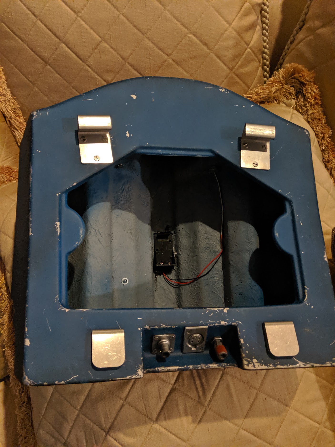

Also as an update for any forum lurkers... my Bobamaker jetpack actually has the part that touches your back (part that you put the metal clips/hooks on) as ABS plastic so drilling it should be relatively straightforward since plastic is way easier to deal with than fiberglass.

I just used the drillbit that came with my power drill, which is just a twist drillbit.
I did mess up two of the holes in chipped a tiny bit of extra paint around the hole, but it's hidden underneath the metal clips so it doesn't really matter since the plastic didn't crack or anything.
I'm so glad the back is ABS plastic. It was way simpler than I anticipated since I've never drilled anything in my life.
