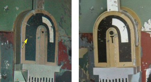

Take the spatter on the ESB helmet as an example:
There are certain areas on the helmet where it's more apparent. I concentrate more on these areas, and then let some of it
carry over so it's sort of "feathered" out. If you have good clear reference pics, there are a few places where there are pretty
obvious spots of spatter. There are 3 streaks or drips on the left mandible, some good sized blotches on the outer corner of
the T-visor on the right side, and a few on the upper RF ear piece. Once I spatter my helmets, I go back with a small detail
brush (size 3/0 or 5/0) and dot in some of these spots by hand.
Here's the RF ear I mentioned above. On the left is a reference pic of the archive helmet with a couple of those spots identified.
On the right is one of my commissions from a few months ago.
The black spatter on the ROTJ armor is another example of this. Especially on the right chest plate.
