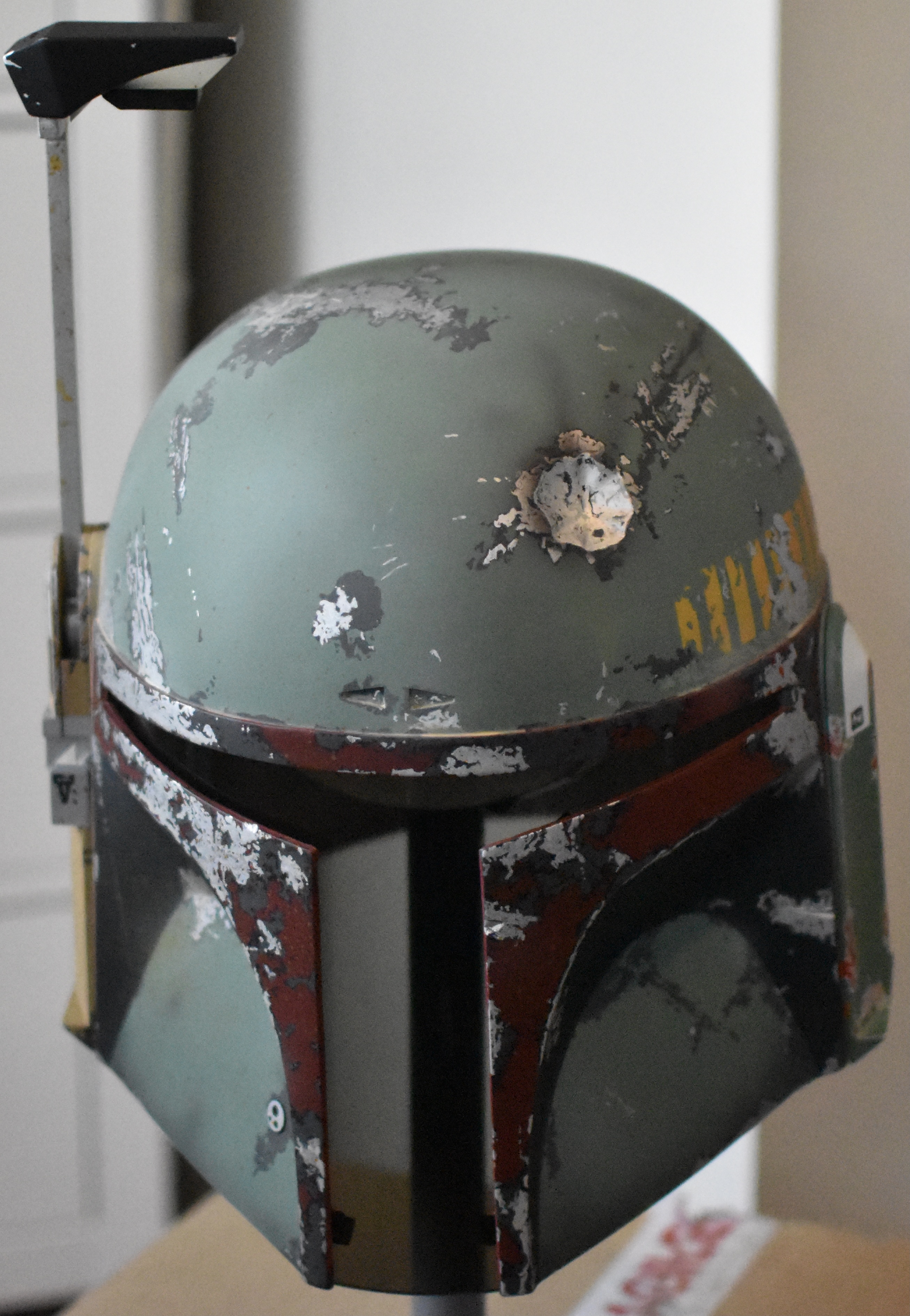

I’ve not used the Acrylics on a helmet yet. But the Enamels I used are as follows.
ESB Helmet
Dome and lower cheeks Light Green and Grime 50:50ish, tape pull was same but with more Grime. SP Dark Lark for main grey and greenish grey parts SP Lettering Grey
Visor/Mandible/Keyslots D&H Caboose, SP Dark Lark, Maroon mixed 50:50 Engine Black. Greenish grey parts done with SP Lettering Grey.
Upper Cheeks were painted D&H Caboose first then Grimy Black. Grey is SP Dark Lark.
Right Ear Earth Lt, SP Dark Lark, Engine Black and Tamiya White Primer
Left Ear Coach Green first, then Light Green. Lighter grey is ANH DS Surface Grey and Red is Caboose. Spatter is Rust. White for decal/graphic is Tamiya primer.
Killstripes SP Armour Yellow with gradient to Mixture of SP Armour Yellow and Rust.
Rear panels main green is Engine Black and Dark Green 50:50. Then Dark Grime, SP Dark Lark and SP Lettering Grey for greenish grey parts.

Here’s the same helmet in different light. Light changes colour massively. In reality it’s in between these.
My advice is to test colours yourself. Do what feels right to you and study the reference well.

roger12RAMJET ’s list is great, I will echo what he says about studying the reference material and trying different paint combinations yourself. definitely join the Archive X Facebook group to see some discussion on this topic.
I ended up mixing the LT Green and Lark LT Grey for the main green, and it took a few tries to get it where I wanted. I think you want to tone the green down a bit by mixing in some Grey or Grime, and then tone it down further with misting and washes.
