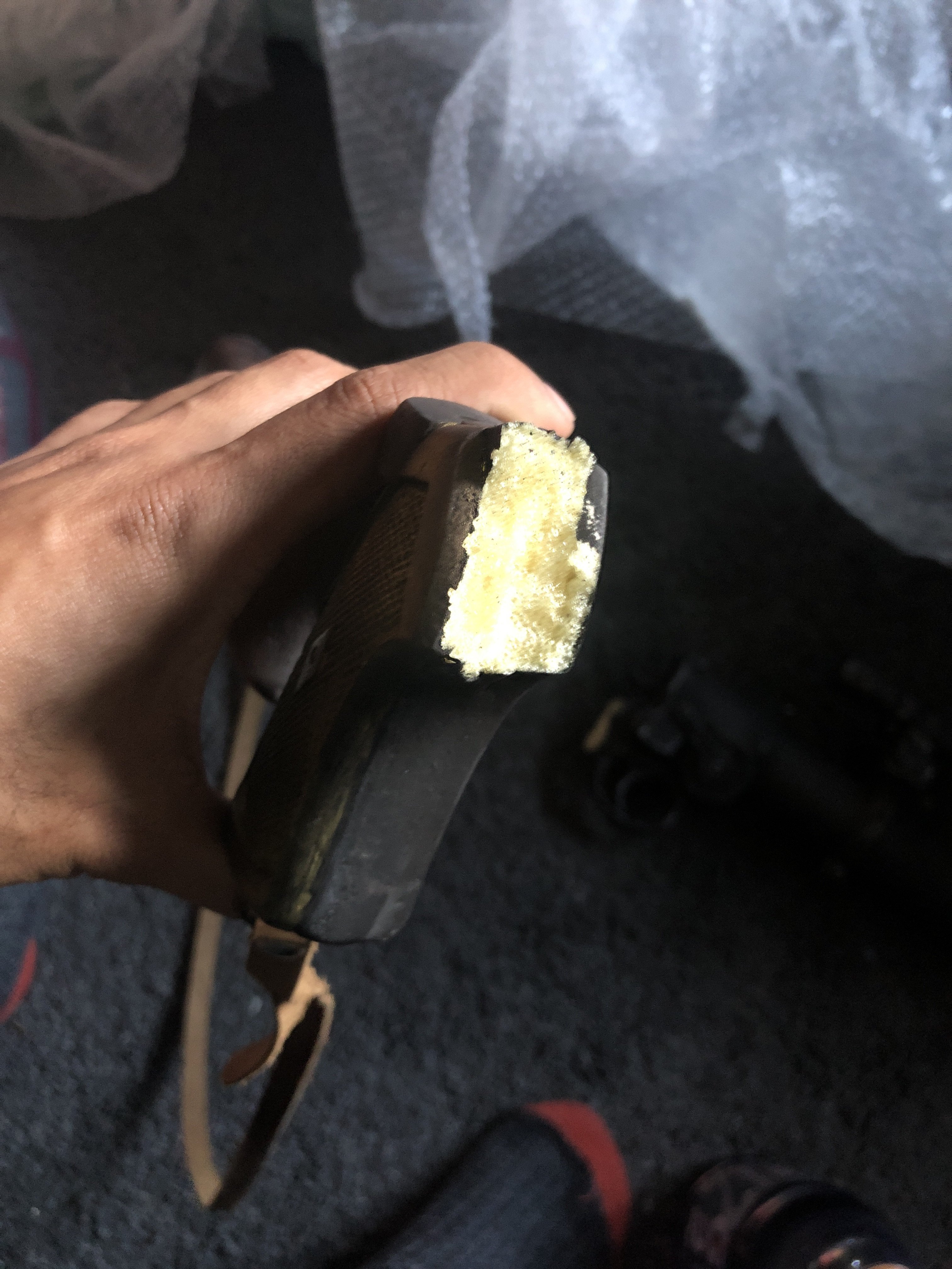

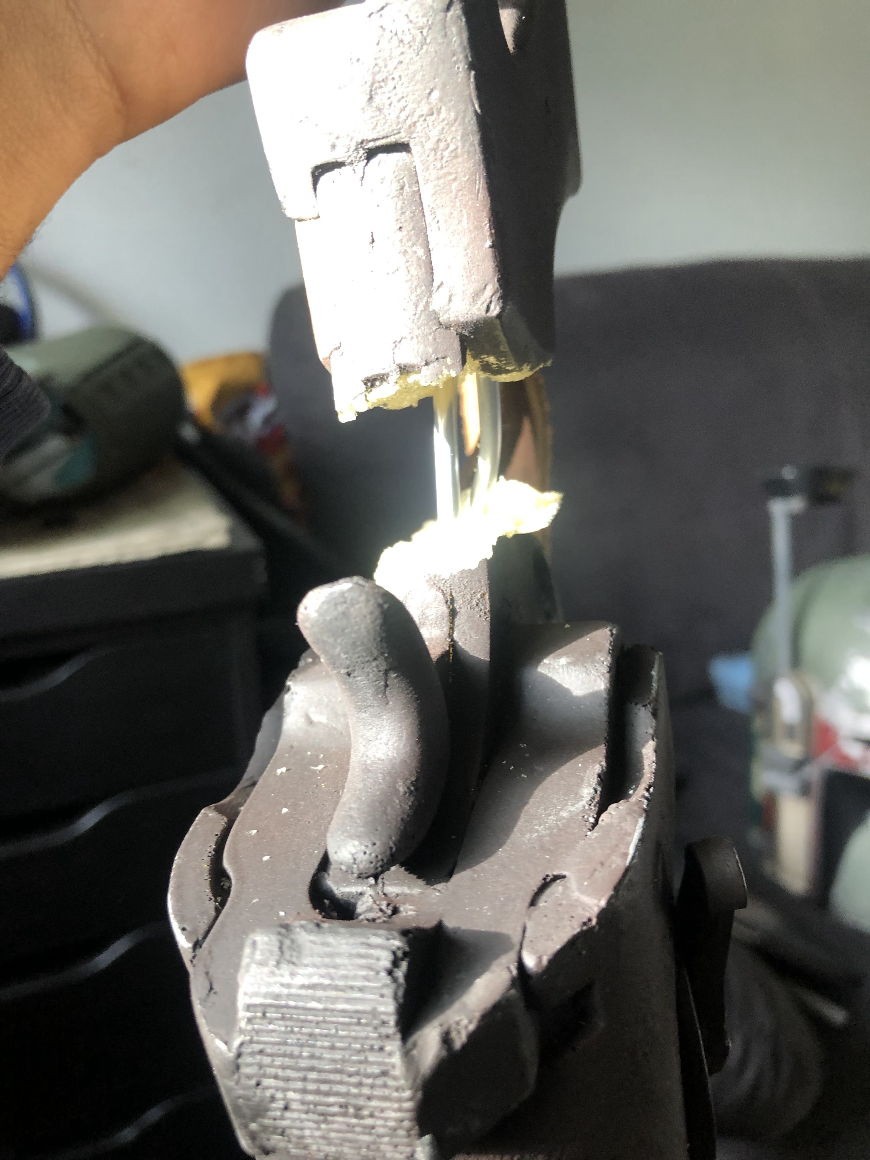

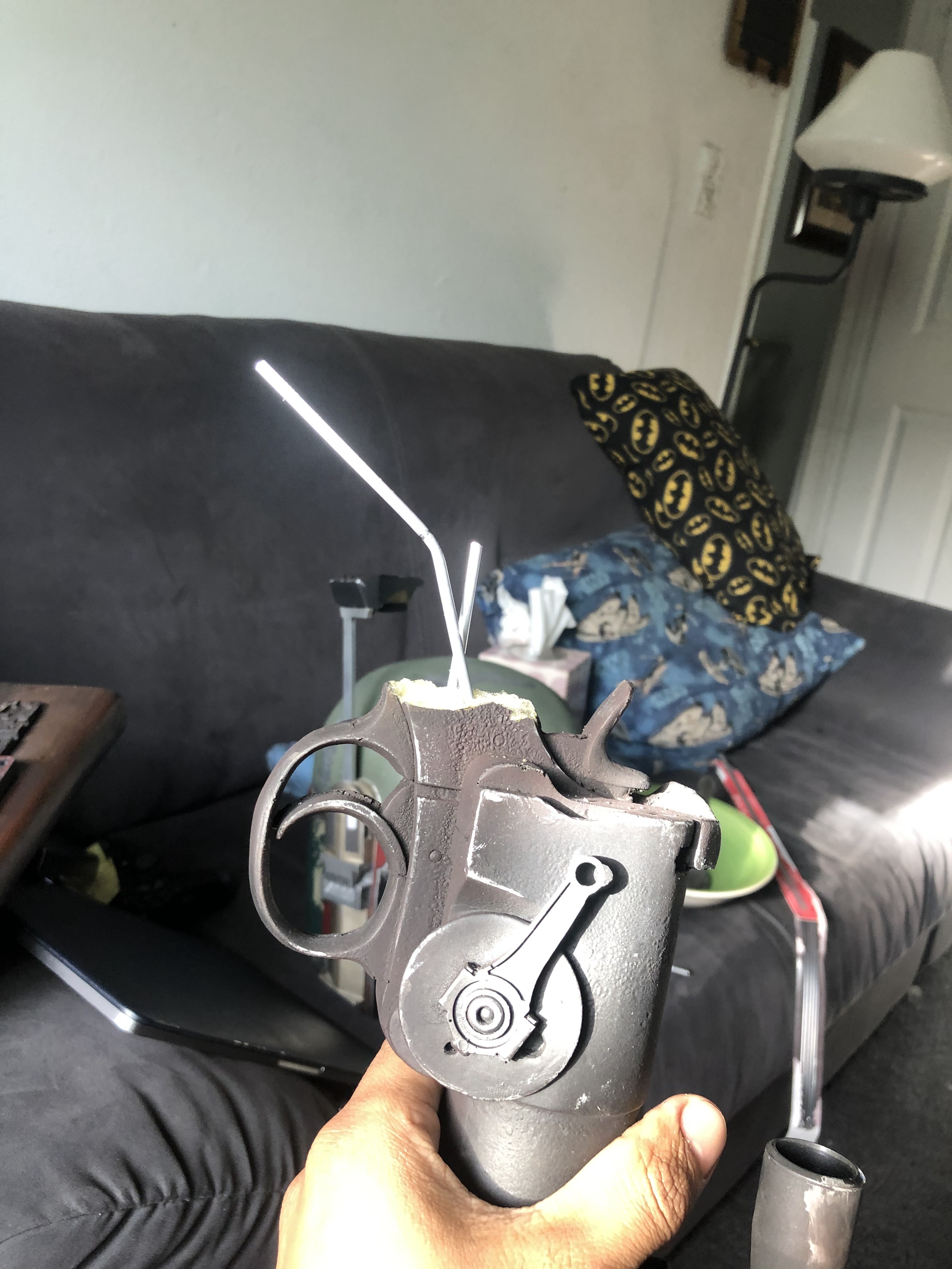

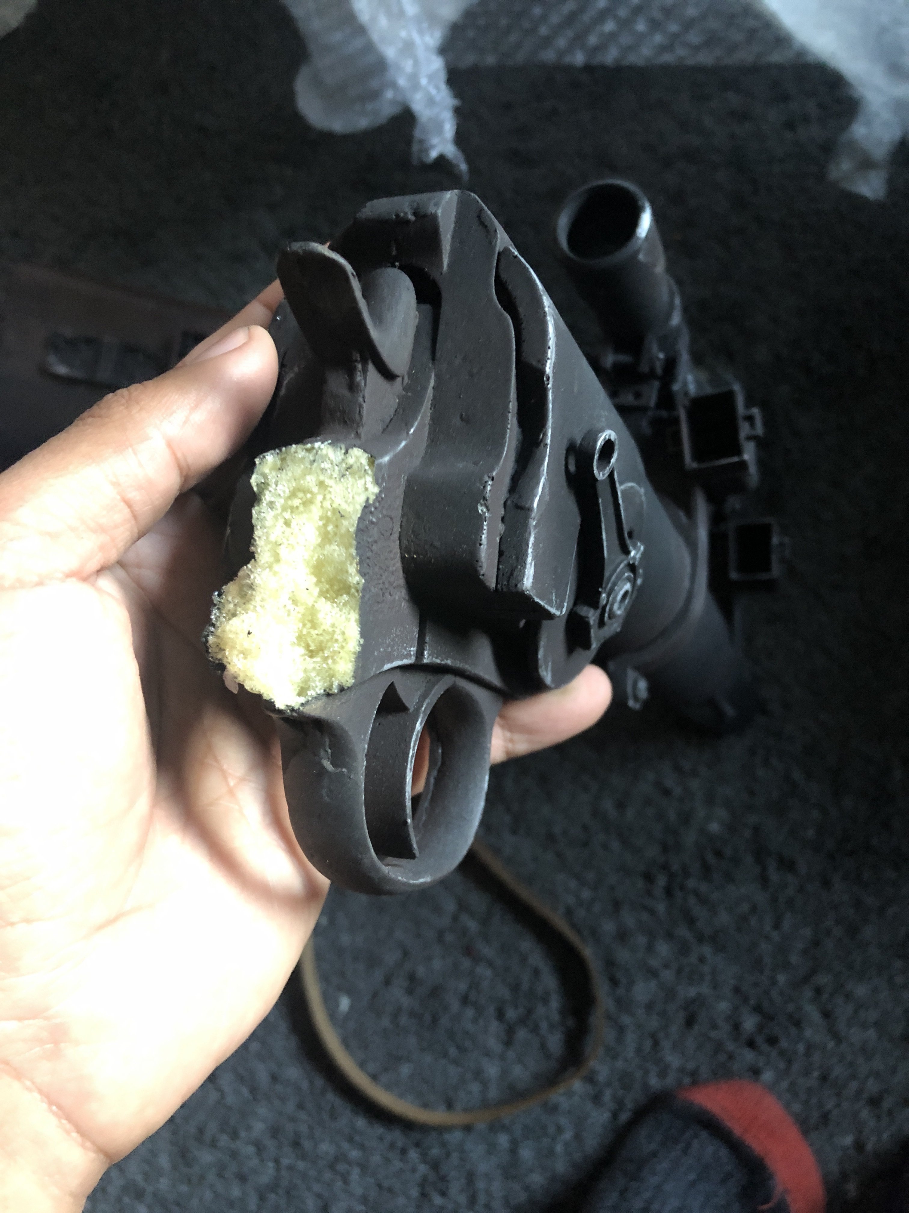

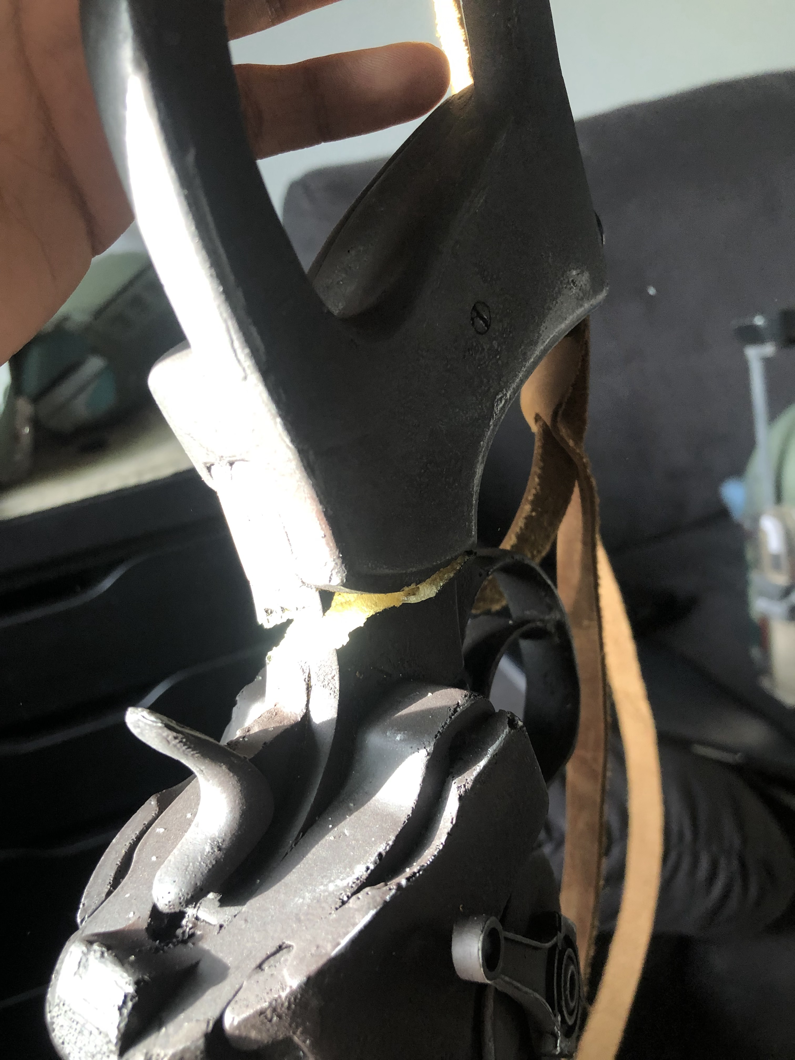

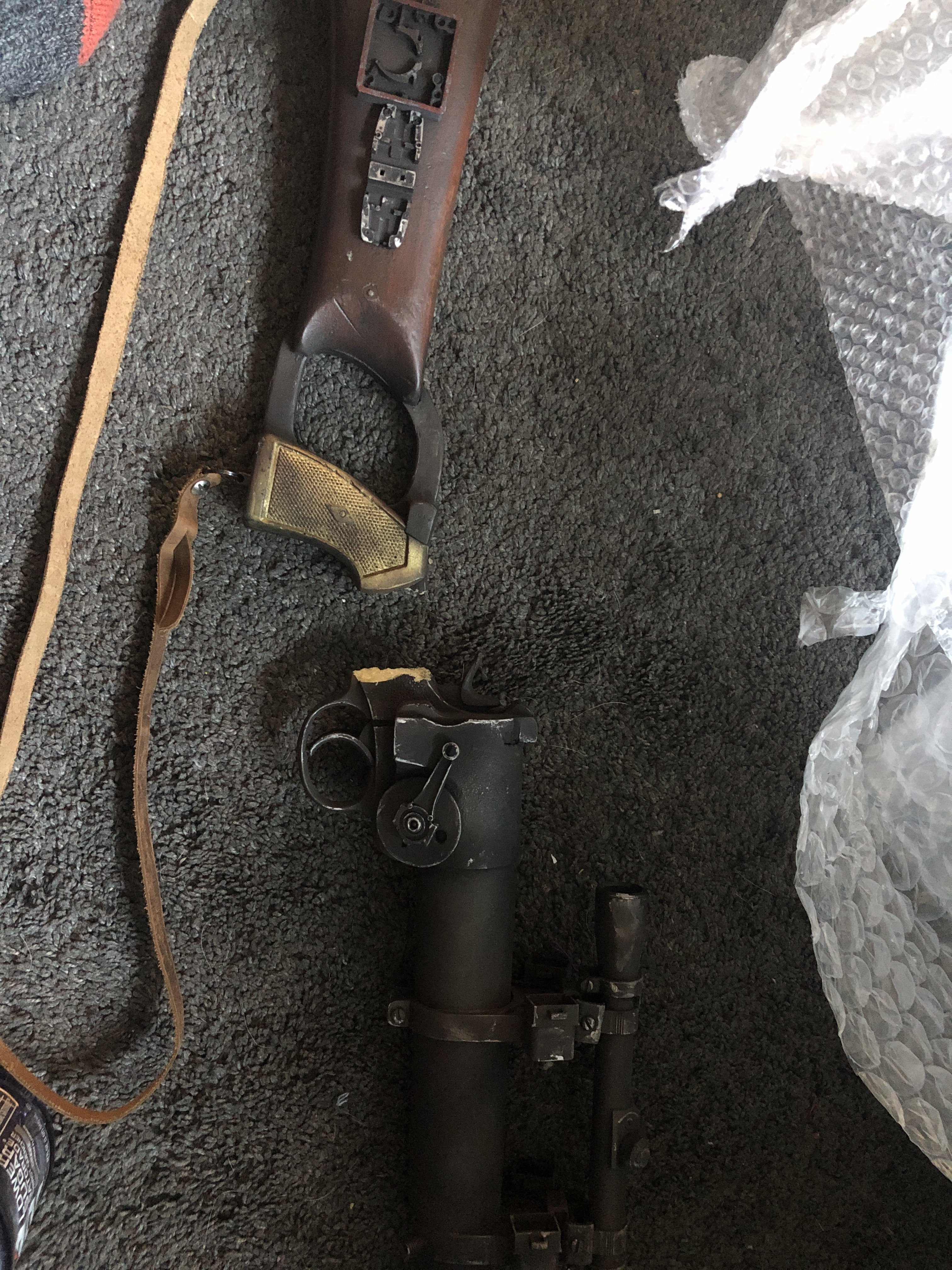

hey everyone,
So I received in the mail my ee-3 but it was broken in two pieces! Anyone have any good ideas as to how I can glue these back together permenantly? I’m thinking stick a piece of metal in the metal between both foam pieces and epoxy to hold them together.
Any ideas would be appreciated!

Dang, I'm wondering if a metal rod to connect both pieces, some epoxy to connect and hope that holds. Sorry about the damage!
In case anyone else has ever run into this issue,
Specifically designed for foam. Used primarily to make repairs on rc planes (like gluing on broken wings and such).

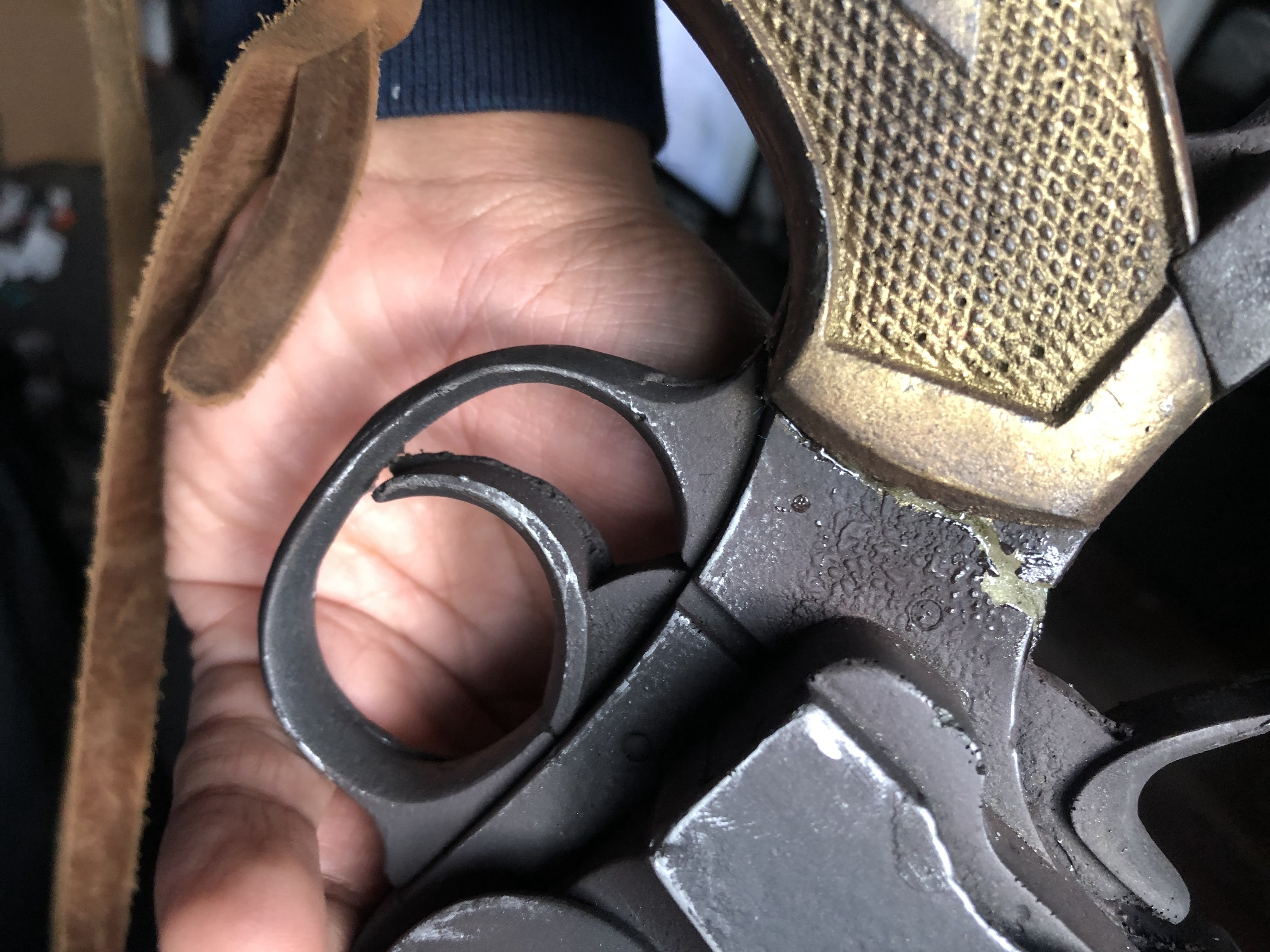

Update,
Sorry WhiteShadow , couldn't resist trying to fix it and since I'm not working today and decided to try and fix it using that glue.
-I used two 1/8 metal rods to make holes in the foam and then filled them with epoxy, using the foam cure on the actual foam.
-Let it cure for about 7 hours and voila! She's fixed! Ill let it cure for another day or so and surround the edges with epoxy and then hit it with the airbrush. Will update more once I get that done.
