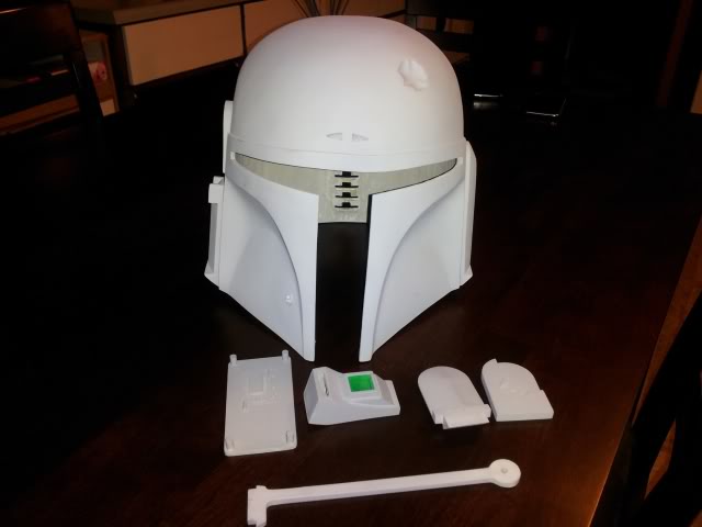

A new helmet then. I recently purchased a Bobamaker helmet from Cargo Hold. This one was in mint condition and the important Dent detail had been exchanged into a Fettpride Dent. I love the BM's durable finish and the opportunity of getting prepping and painting it immediately without need to do a whole lot of cleaning first. I was very happy with the acquisition. Just a tiny flaw; the other cheek and mandible courve seem to be warped a tiny bit, I need to figure out a way to straighten it somehow or then just leave it as it is.
I have to admit, I'm scared sithless to start painting this helmet!! The armor was child's play compared to the complexity of a layered ESB paintjob. For the painting project I hunted every template I could get and then compared these to each other and some pro paintjobs I had seen. Now that I have already started painting I can't believe how skilled and precise you master painters are, as it seems impossible to replicate every little scratch and chipping detail, yet you guys do. Hats off to the amazingly skilled painters here in TDH, you're crazy.
This is my newbie first go at painting a helmet and I'll try to do it as well as I possibly can, with the time and resources at hand. :)
This is how the helmet was pictured in it's original sales thread. Mine!

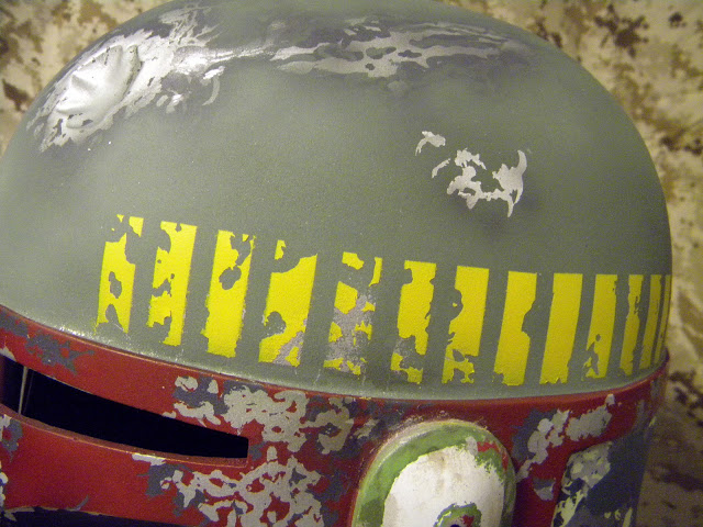

Hit it with black and BOOM, bad-*** ESB look achieved! Still miles to go with the finishing but now it's already visible where we're going.
scaled.php
Cheeks are still unweathered, some darker shading will blend the green and black cheek areas better into each other. I think when everything else is ready, I'll give the helmet a couple of thin, dark washes to tone everything down a bit.
scaled.php
More scratches still need to be scraped to achieve the final look. The grey areas on the green cheeks need to be added topically as I missed them on the first go.

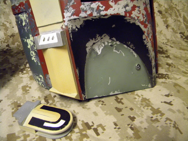

Managed to do some work with the other ear piece today. By this achievement the project grinds to a short halt because of exam week and the fact that applying liquid masking has destroyed all of my brushes. Red and silver chipping didn't work out as well as I would've wanted but luckily it's not the most iconic part of the helmet. :)
scaled.php
After I had carefully covered the surrounding areas I painted the ear piece with Vallejo Fire red. Then I did the red damage masking.
scaled.php
Silver coat and new masking.
scaled.php
Green shade is Vallejo's Pale Green, that I shaded with Devlan mud in places.
scaled.php
The look with liquid masking removed. I then masked the ear piece to paint the white logo detail on.
scaled.php
Two layers of airbrush white and we're set.
scaled.php

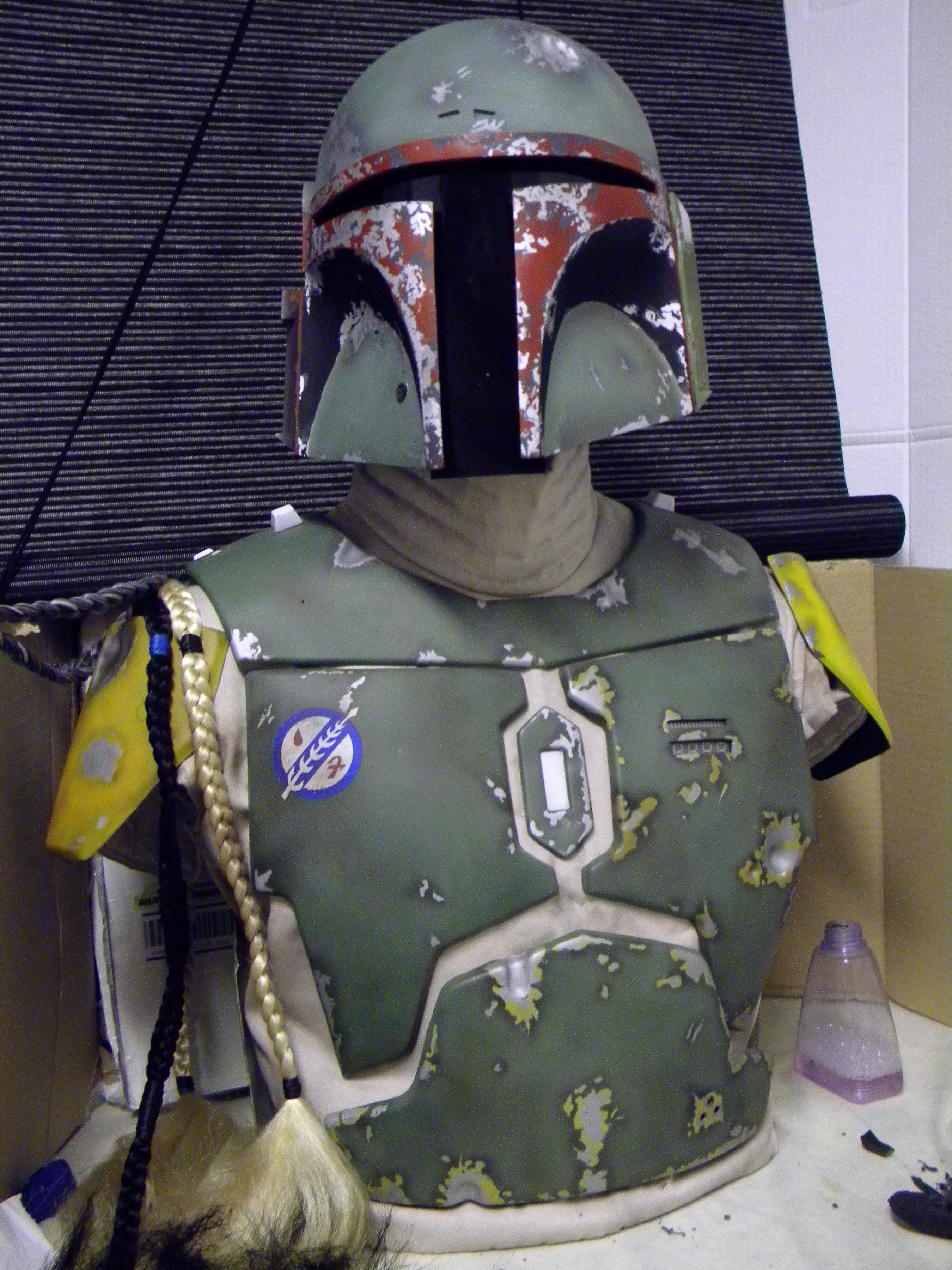

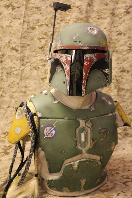

Some more Devlan mud weathering and then I got to remove the rest of the masking. I'll paint the small rune detail later when I have acquired some new brushes. The back panels need to be finished as well. Here's a bonus shot of the helmet on a bust, with slightly better camera adjustments. :) Note that the visor has not been attached yet.

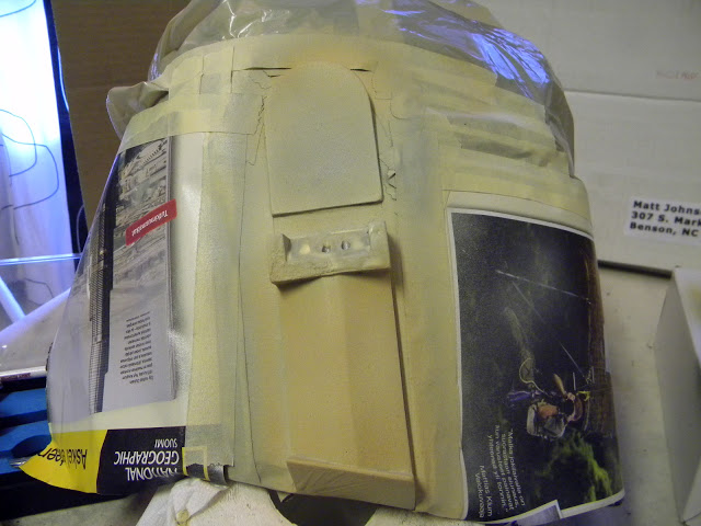

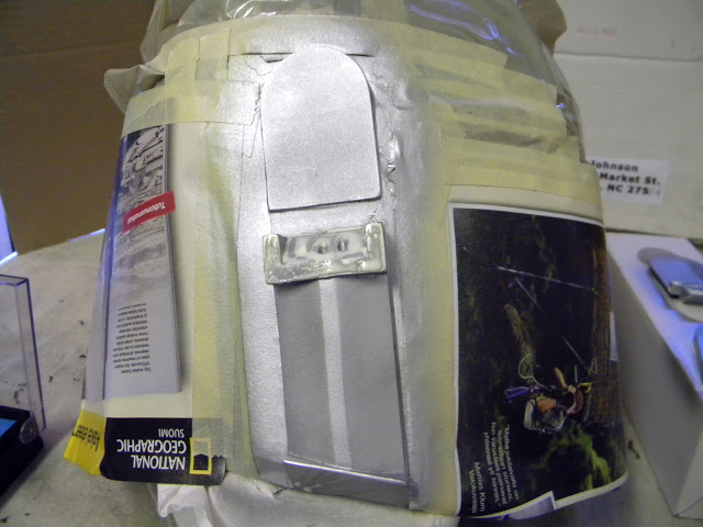

Another ear piece, another silver undercoat.
Model Air bone color and some Gryphonne Sepia and Devlan Mud shading.
The Black & White details I did freehand with a brush.
Finally I got to do the kill stripes. I masked the surrounding areas with tape and plastic bags and then cut even pieces out of some stickers to cover the spaces between the stripes. Unfortunately I kinda broke the aibrush compressor before I got to apply the fading into orange... I guess I need to do that later somehow.
A test fitting on a bust. Getting there. :)

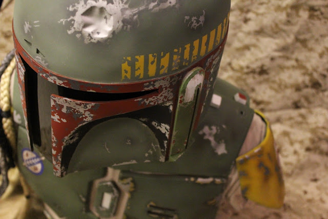

Great job man! I really like how it turned out! The damage looks great and the hues you got with the greens and the back of the helmet are well executed.
One note I would make is that the red on the visor frame looks too vibrant to me (IMO). I remember the ESB helmet having a more dulled out red-maroonish feel to it. If you could go back and touch that up a bit you'll have a helmet any Fett-fan would envy!
Can' wait to see the finished product! Keep on Fettin!
Big thanks everyone! Means a lot.
@Archaster777, you're absolutely right about the red. As I proceed with the weathering and some shading I'll make sure to apply some dark washes on the red to dull it down a bit. I hope this doesn't affect the silver parts too much but perhaps I'm able to target just the red areas. Good eye and thanks for the reminder. :)

I dunno, I think from those pics, your red actually looks pretty good, I wouldn't change it too much. If you look at the high res images in the celebration iv folder, it is a deep red, but also quite vibrant in certain lights - I think yours matches this well. If anything, maybe knock it back a fraction with some steel wool - but I personally wouldn't modify it too much..
