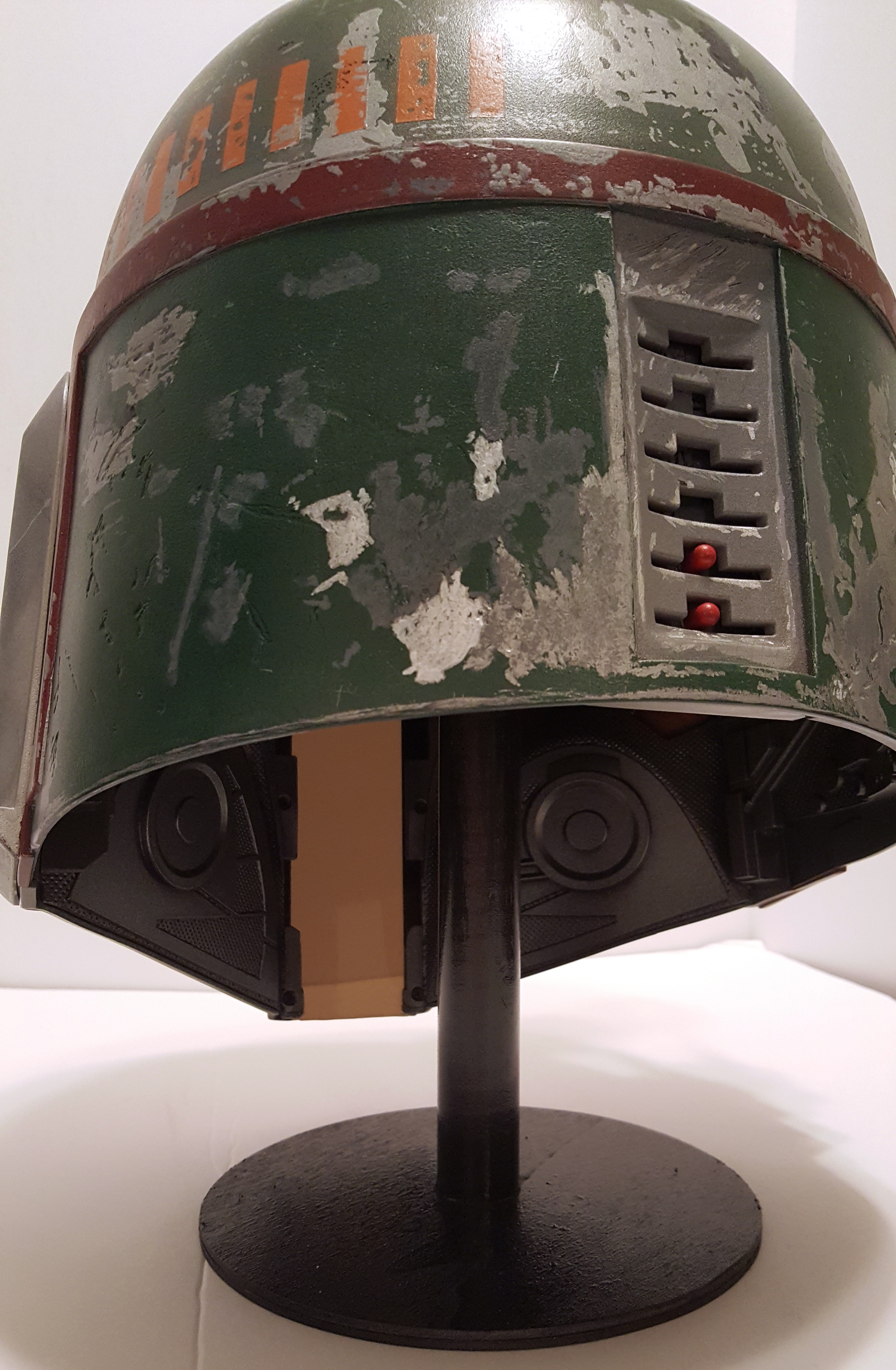

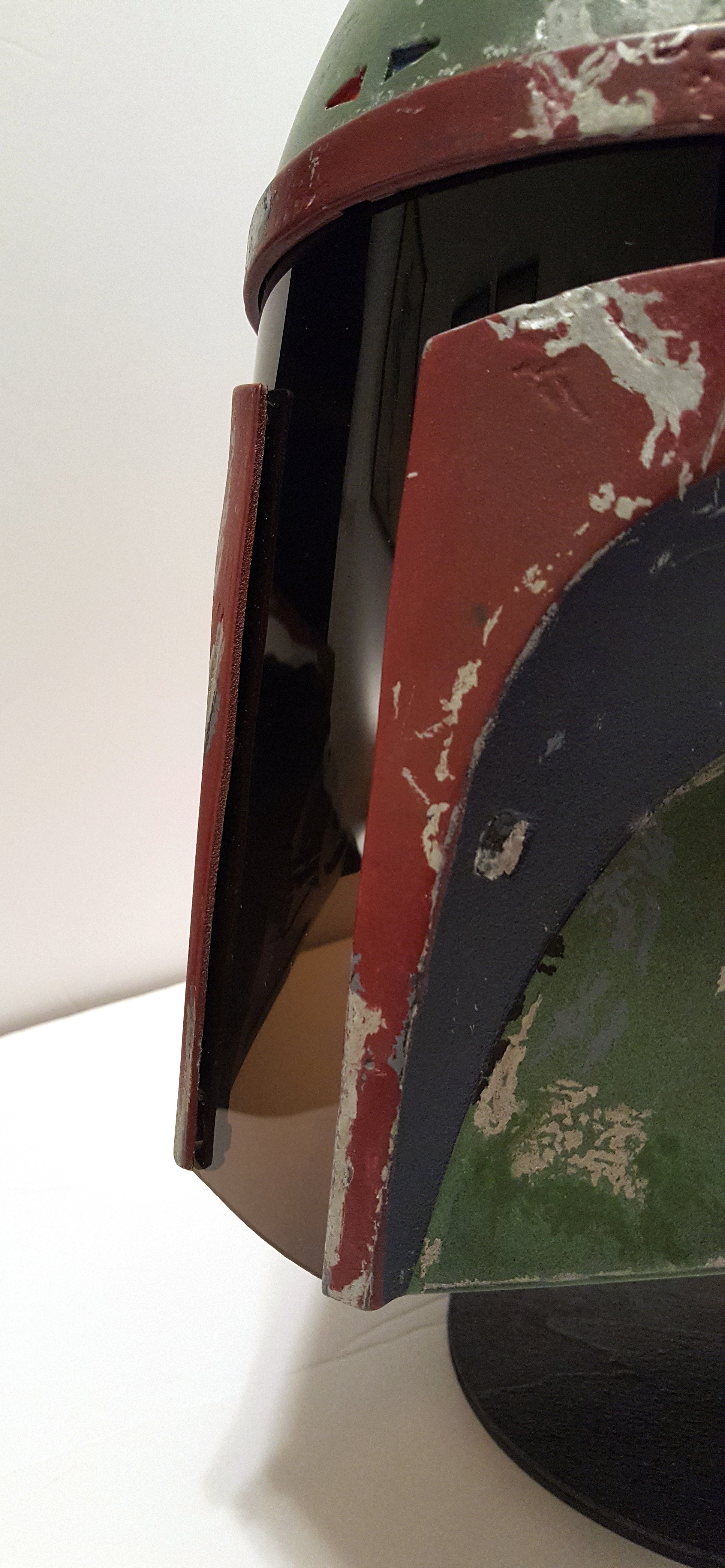

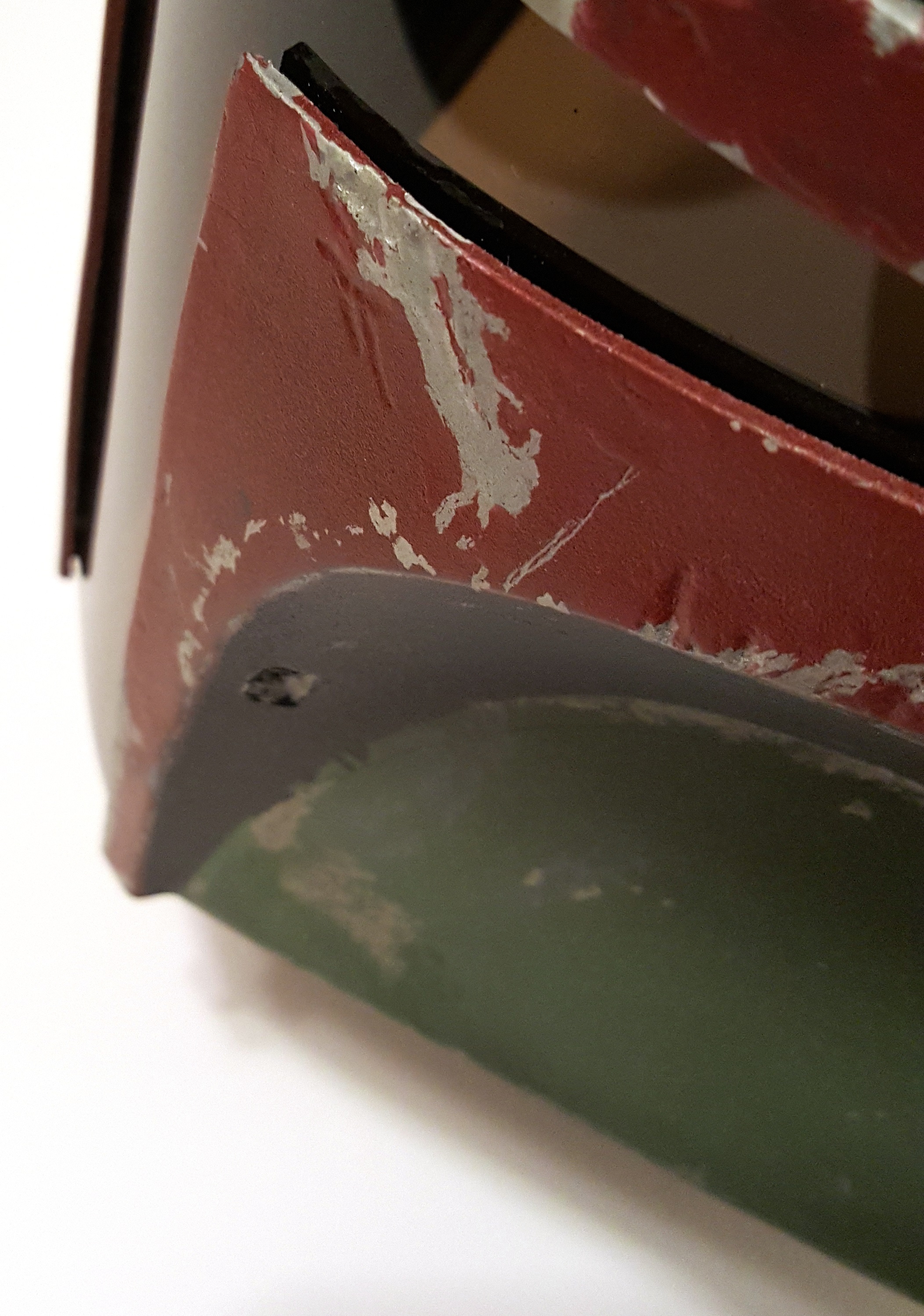

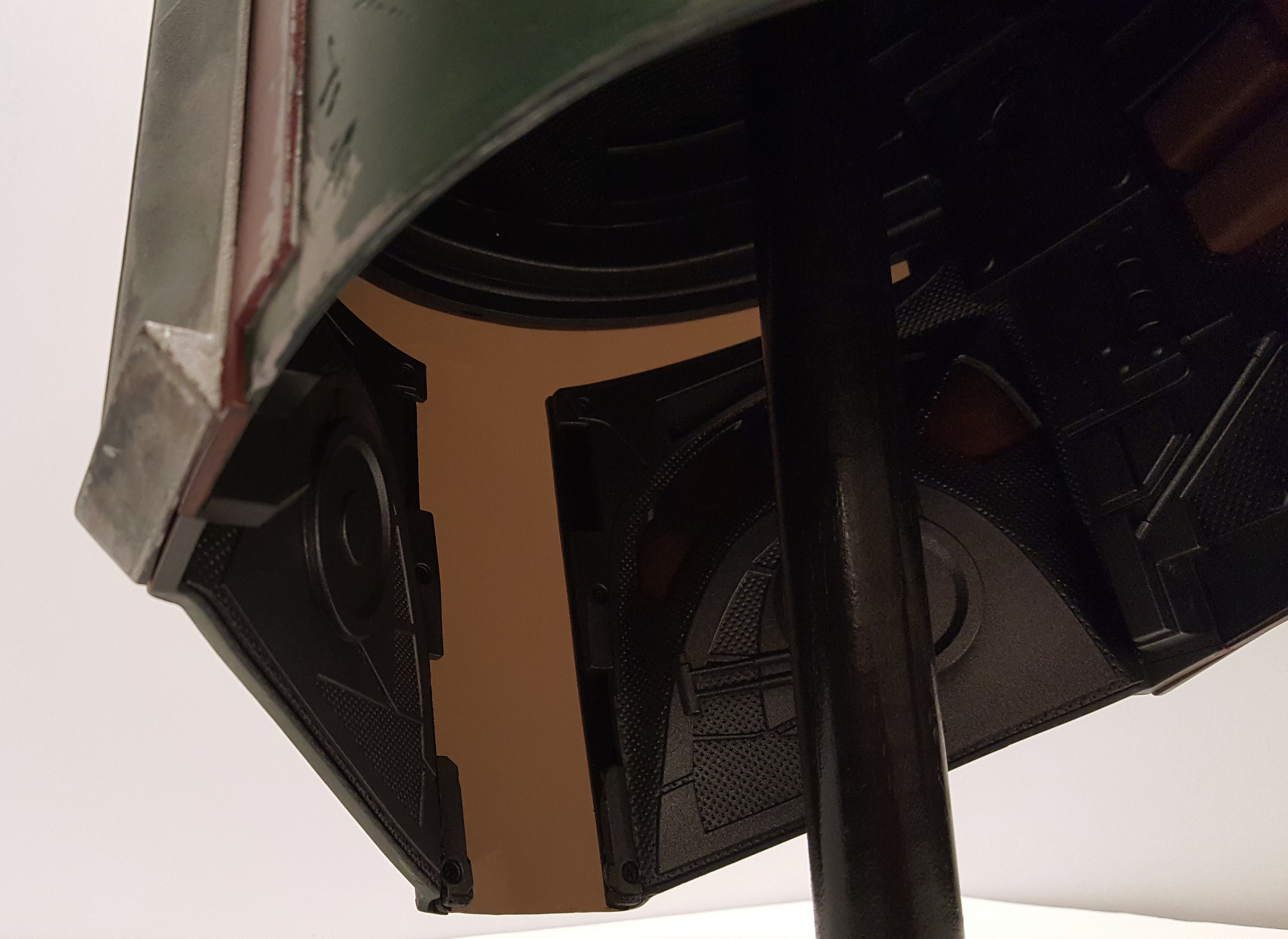

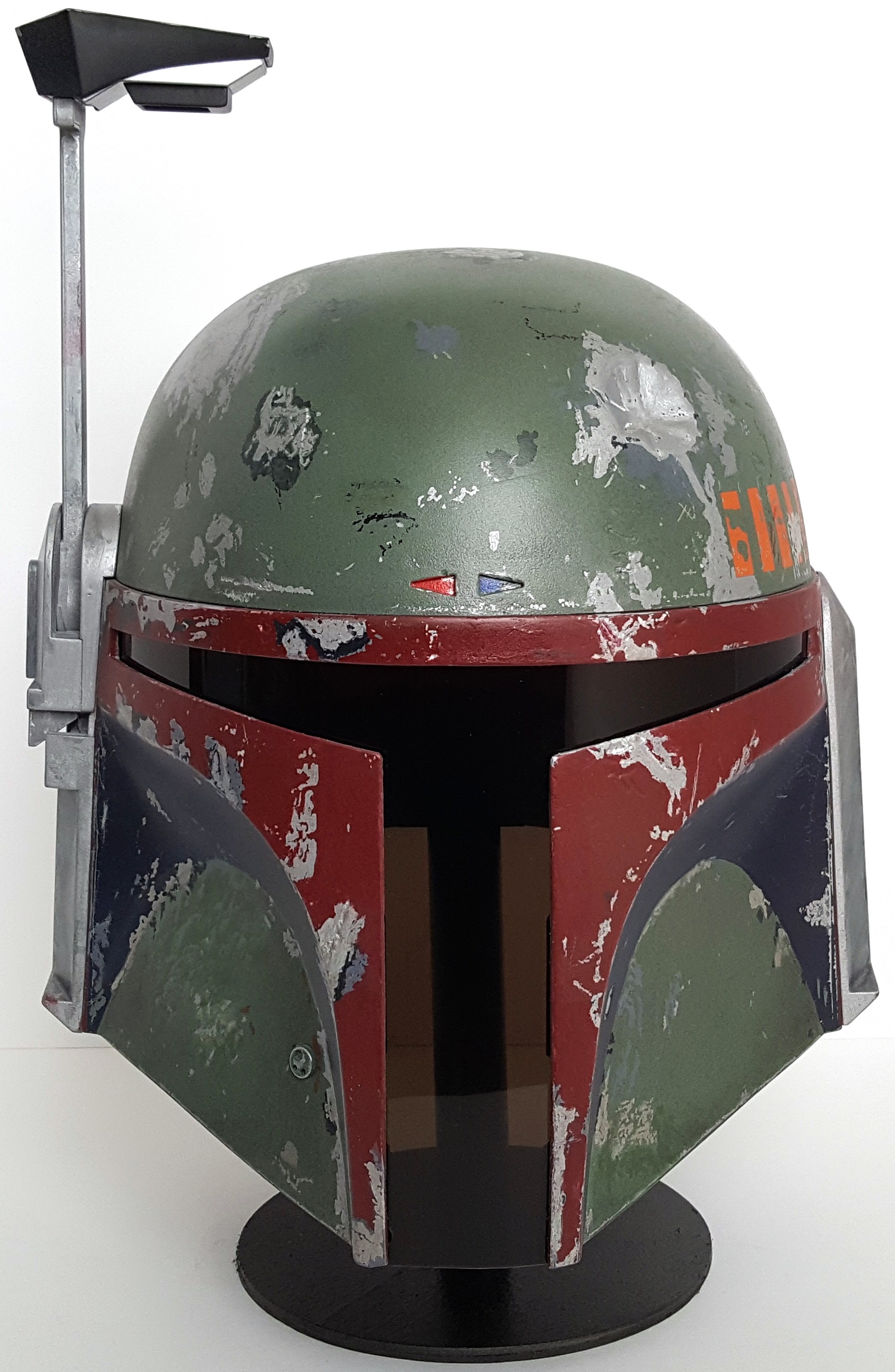

@IronSpiderFN , I ended up just biting the bullet and ordering a proper replacement from t-visor.com
I had to dremel the sh** out of it to get it to fit into Hasbro's goofy a** internal parts layout, but it turned out amazing.
