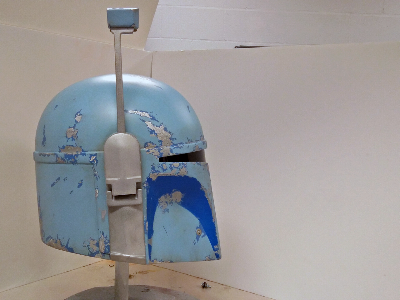

    Heyoo. Got a nice little cozy thread here to share with y'all about a little mini-build I did for the holidays; the classic iconic and much beloved Holiday Special Fett. Mostly inspired by both UMD S4L 's recent toon shaded helmet and rewatching RedLetterMedia's Holiday Special-special.

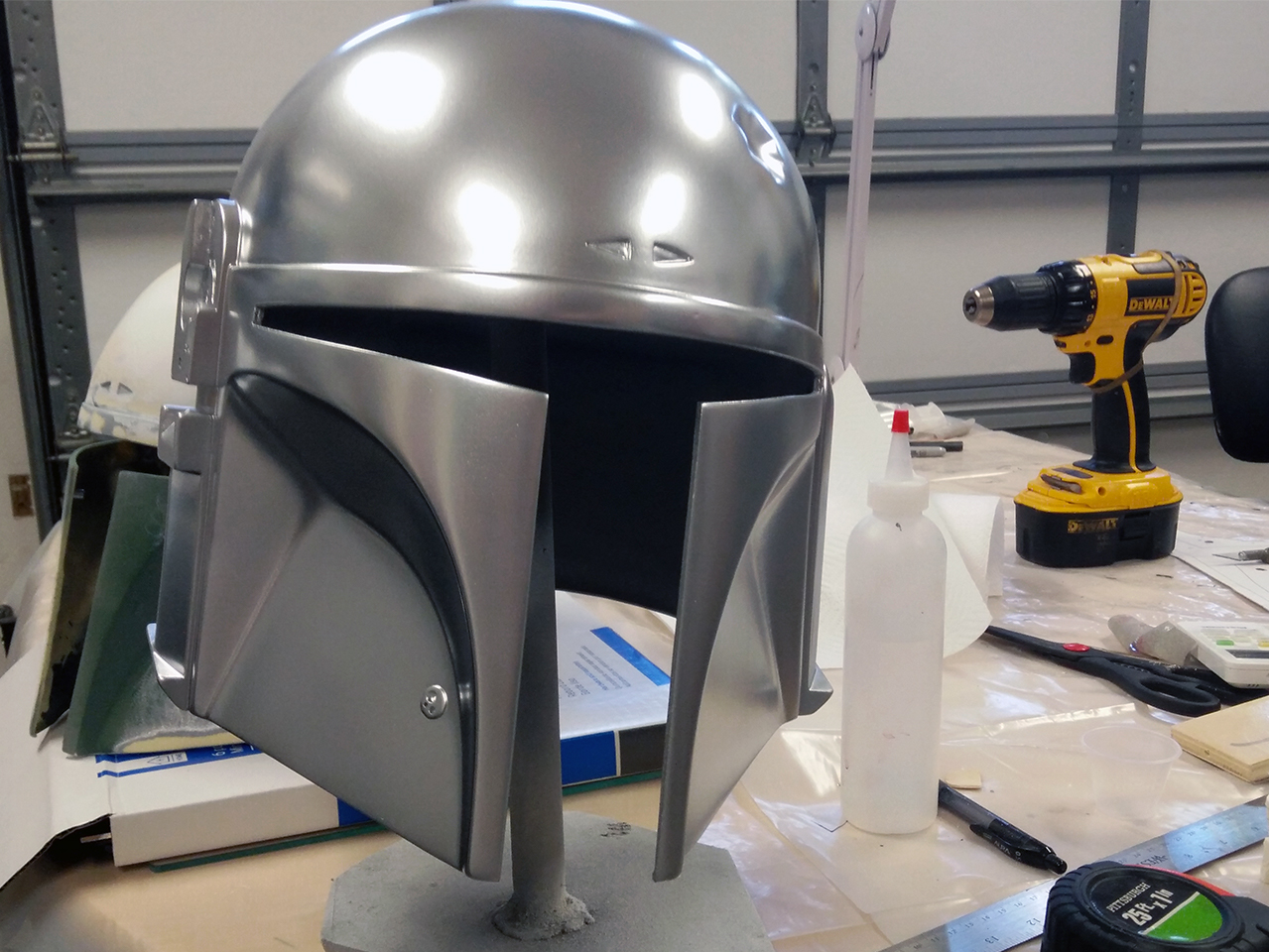

    Oh and a metallic. Brilliant Aluminum by Krylon. I started with that.
    Then I masked off a few damage zones for the silvers and covered the whole thing with the Wildflower Blue as a general under-layering.

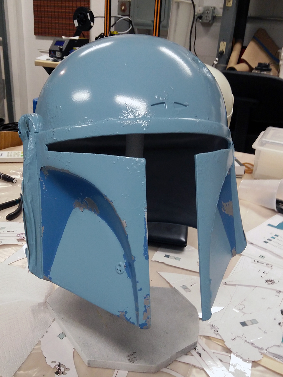

    Then went ahead and got everything peeled off and put a coat of matte over it to get rid of that icky glossiness.
    Seeing it peeled.. it's probably a little more damage than I wanted. I was intending for something a bit more conservative, more like the SDCC figure, but it can be hard to visualize it when you're painting on the latex. It's alright though, just something different.

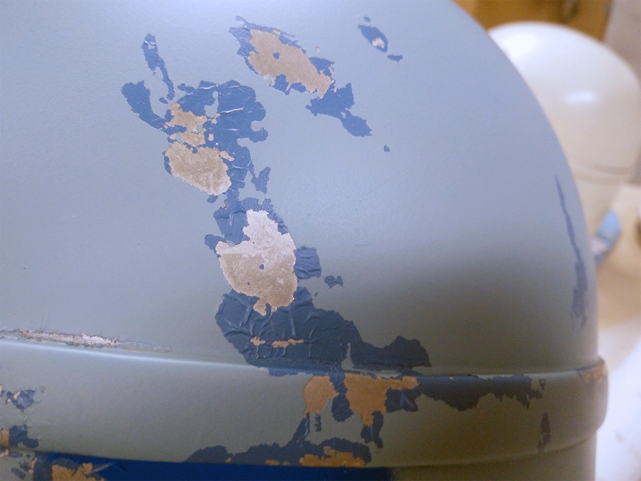

    Unfortunately the clear caused a little bit of paint wrinkling in the Wildflower Blue layer. I was careful to let each later get a full 48 hour dry time, but I suppose that color was just a little bit slower than the others (and I'm sure the cold weather doesn't help). Bit of a let down, but fortunately it's just in a few select areas and only affected an under-layer. The French Blue held up fine.

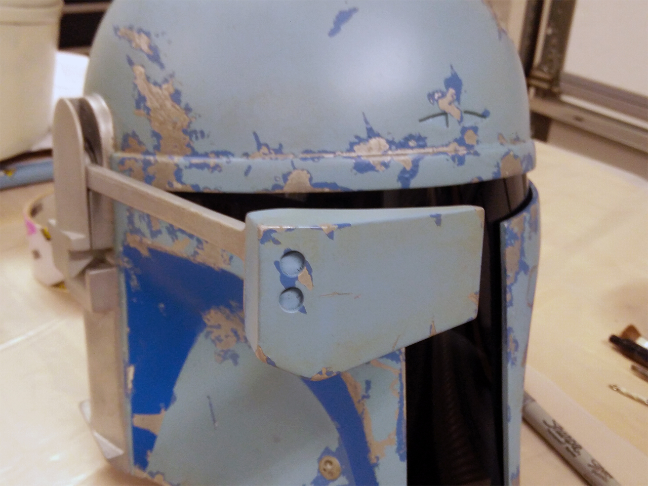

    After that I finished up assembling the RF stalk and other accessories, and did a quick weathering pass. I tried to go a little heavier on the tan and brown colors, since Fett did wear it on Tatooine afterall.

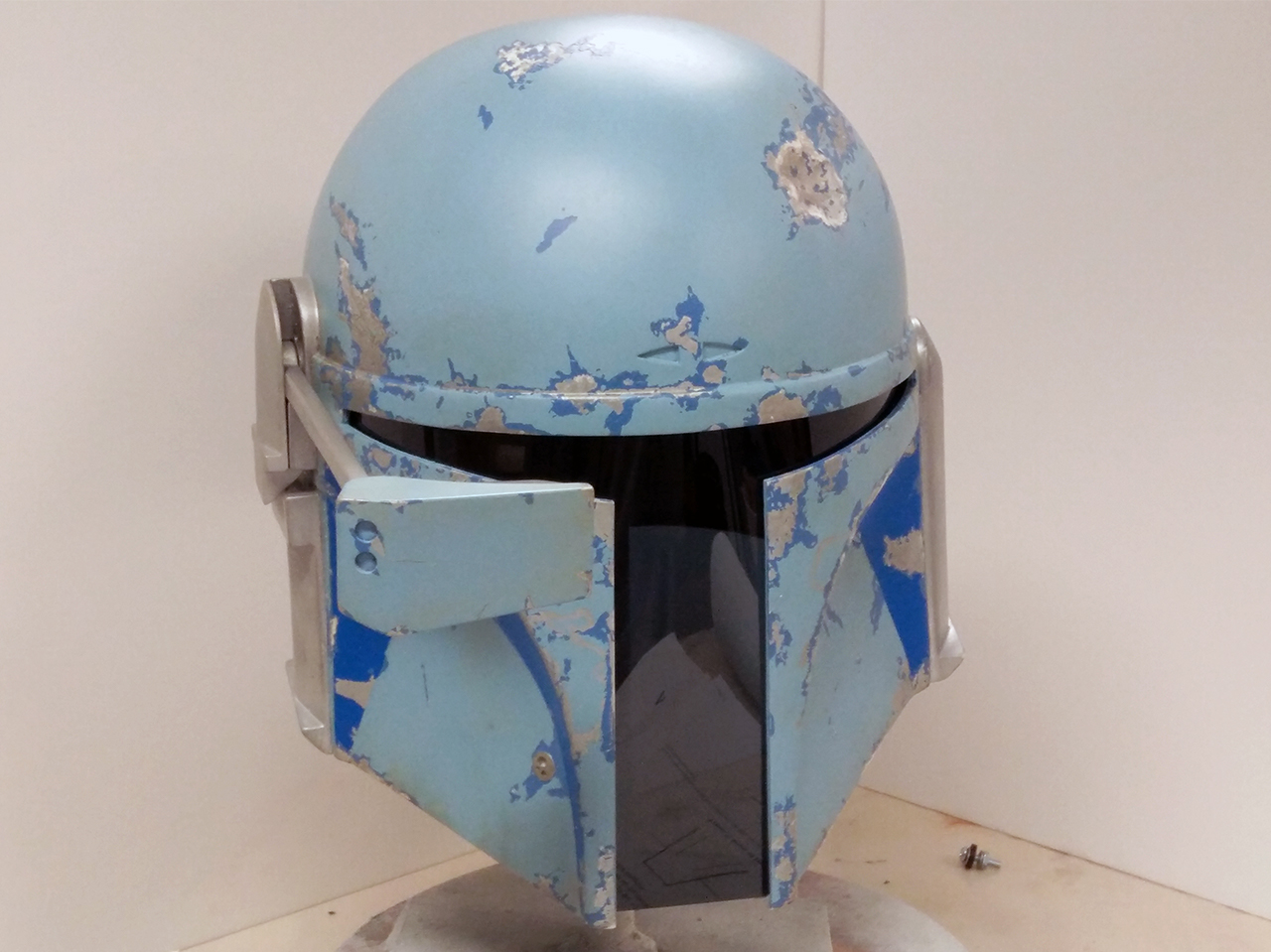

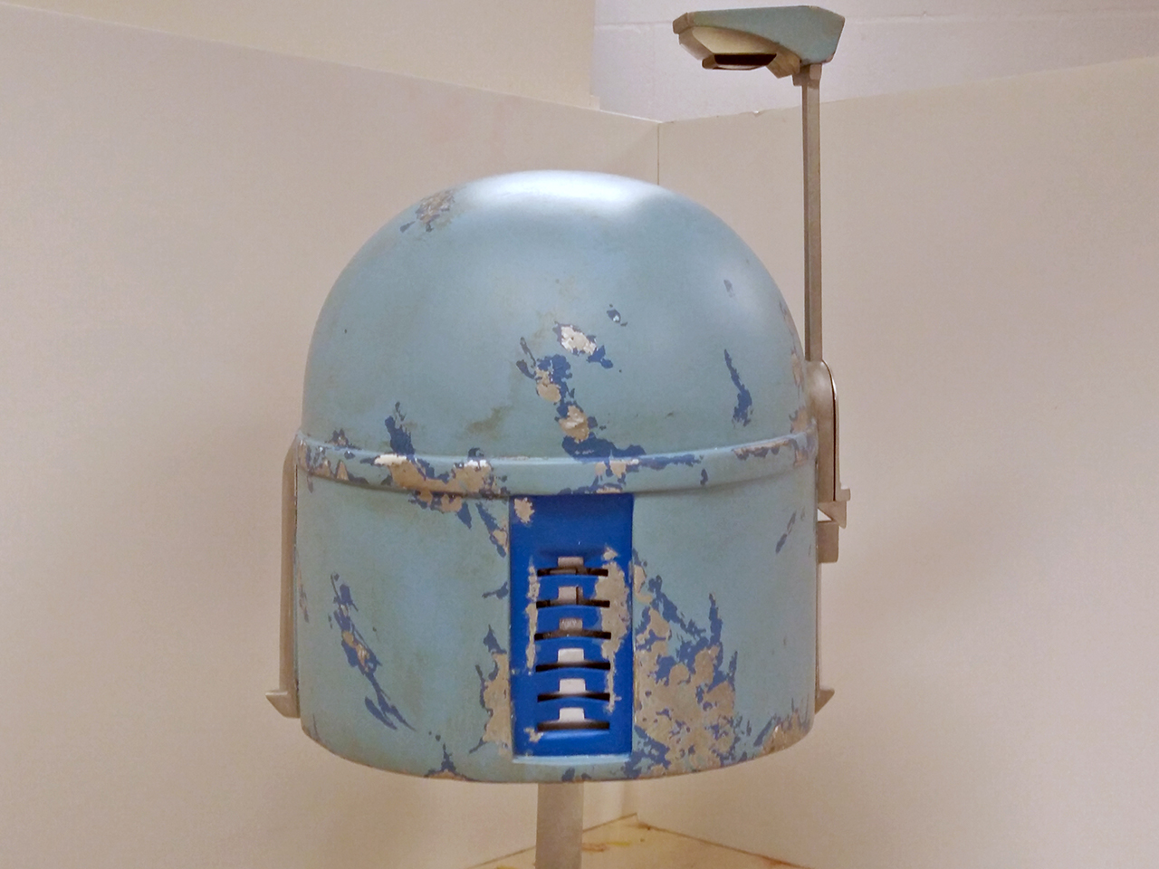

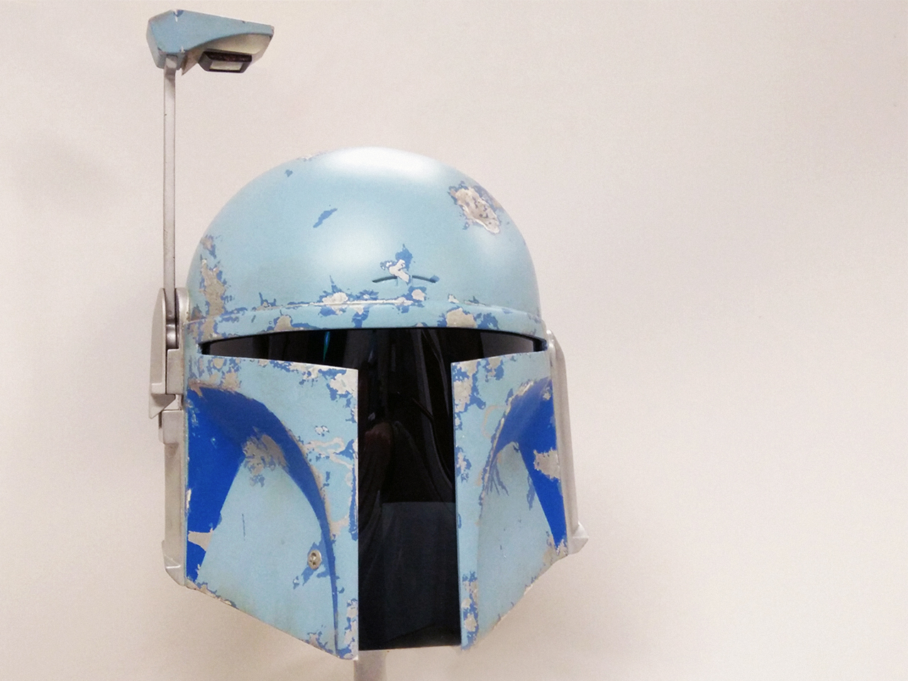

    And then it was pretty much done!
    Some glamor shots to wrap it up:
    IMG_20171211_215648.jpg IMG_20171211_215820.jpg IMG_20171211_215904.jpg IMG_20171211_220206.jpg
    Pretty fun little quick little build, took me just a little over a week to get it done, mostly spent waiting for paint to dry :x

    Sorry to see you had some paint wrinkling with your clearcoat. Next time I would try Testor's Dullcote. It plays well with every paint brand I've ever layered it over. Just be careful with spraying it over metallics as it will knock the sheen down 100%. Bright silver will end up looking like gray primer.

    Paint wrinkling happens when you mix brands typically...painting it with a rusto silverand clear wouldn't have yielded the wrinkling issue. Also the model masters dullcoat interacts well with both rusto and krylon....

    For the most part standard rattlecans are all just oil alkyd base paints, just with different solvent mixtures and accelerators added in. As long as they're given the chance to fully degas though and cure, most all of em can be used together without issue. I've been mixing the brands for years, as I'm sure many others do. Just gotta really respect the time windows, and always test new paints.
    Here's actually a quick little test piece I did just to prove I'm not talkin outta my butt; Rusto primer, krylon silver, rusto colors, and a krylon clear; all painted within the 1 hour they agreed upon on the cans. Silver got a bit splotchy from getting cleared while still wet, but otherwise no lifting or other problems.
    I will fully agree with ya that rattlecan metallics can be a pain though, still haven't met one that doesn't like to leave a buncha powerdy residue that makes top coats peel. And they take fooreverrr to cure. I usually like to avoid using em.
