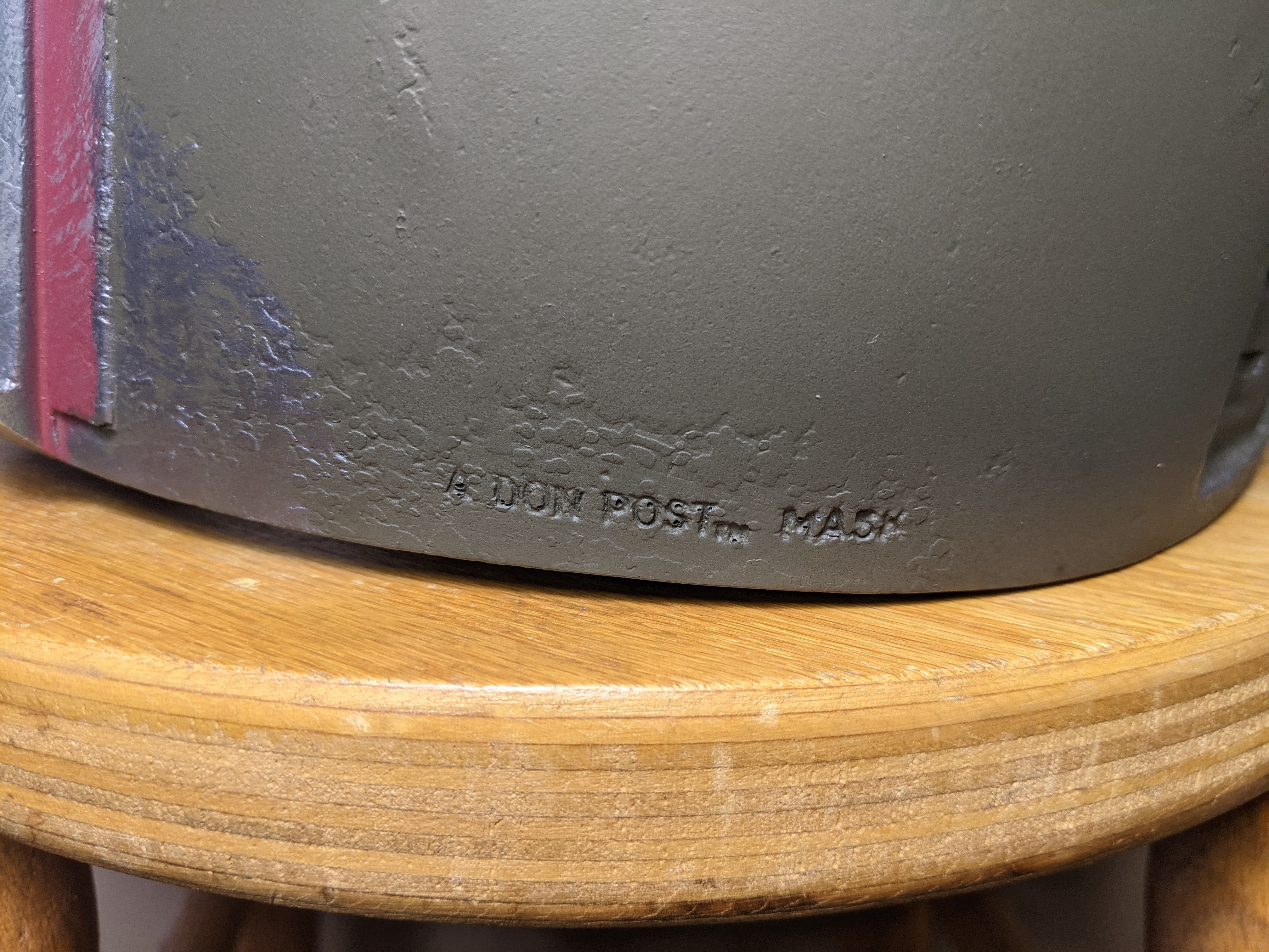

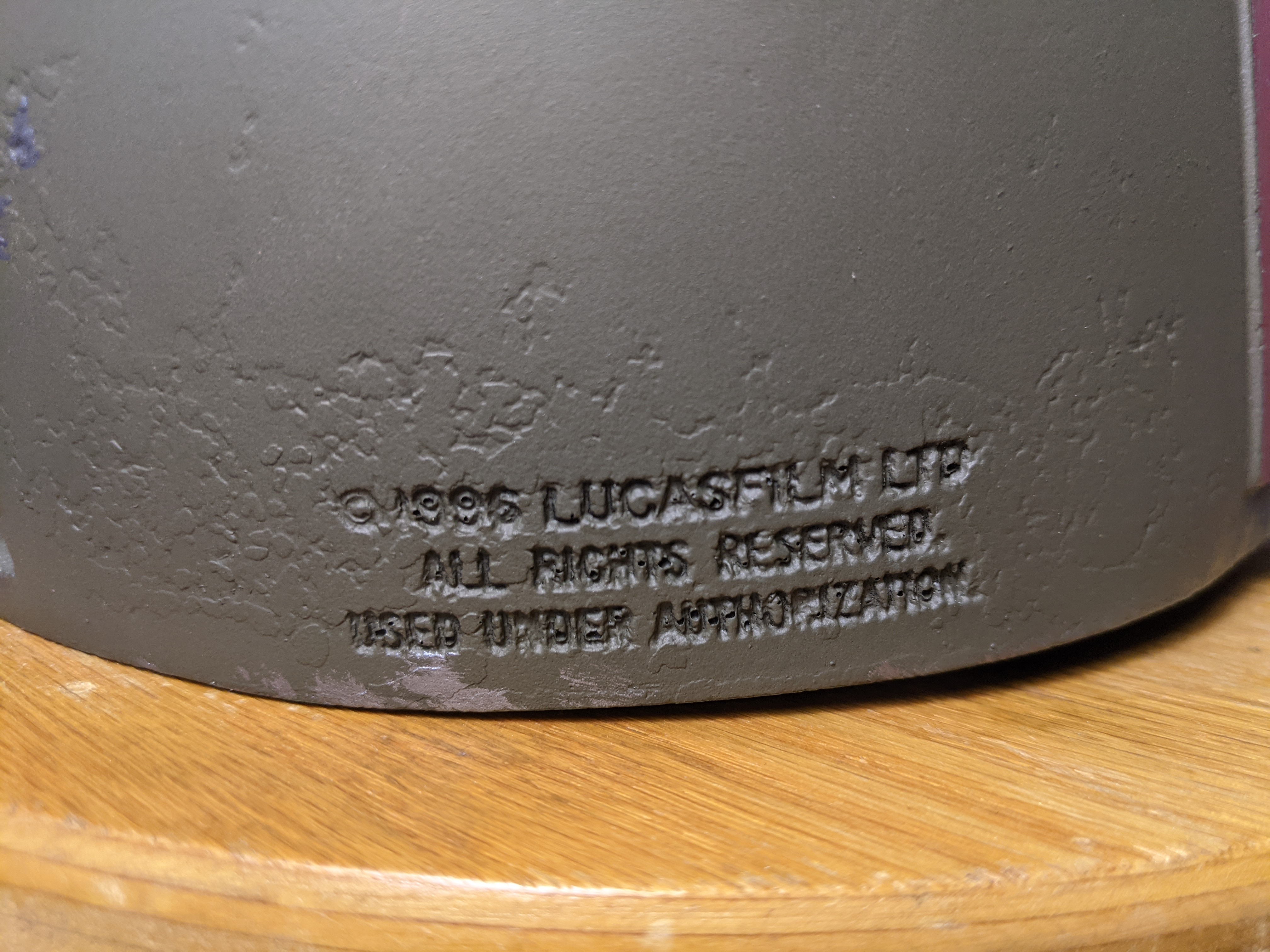

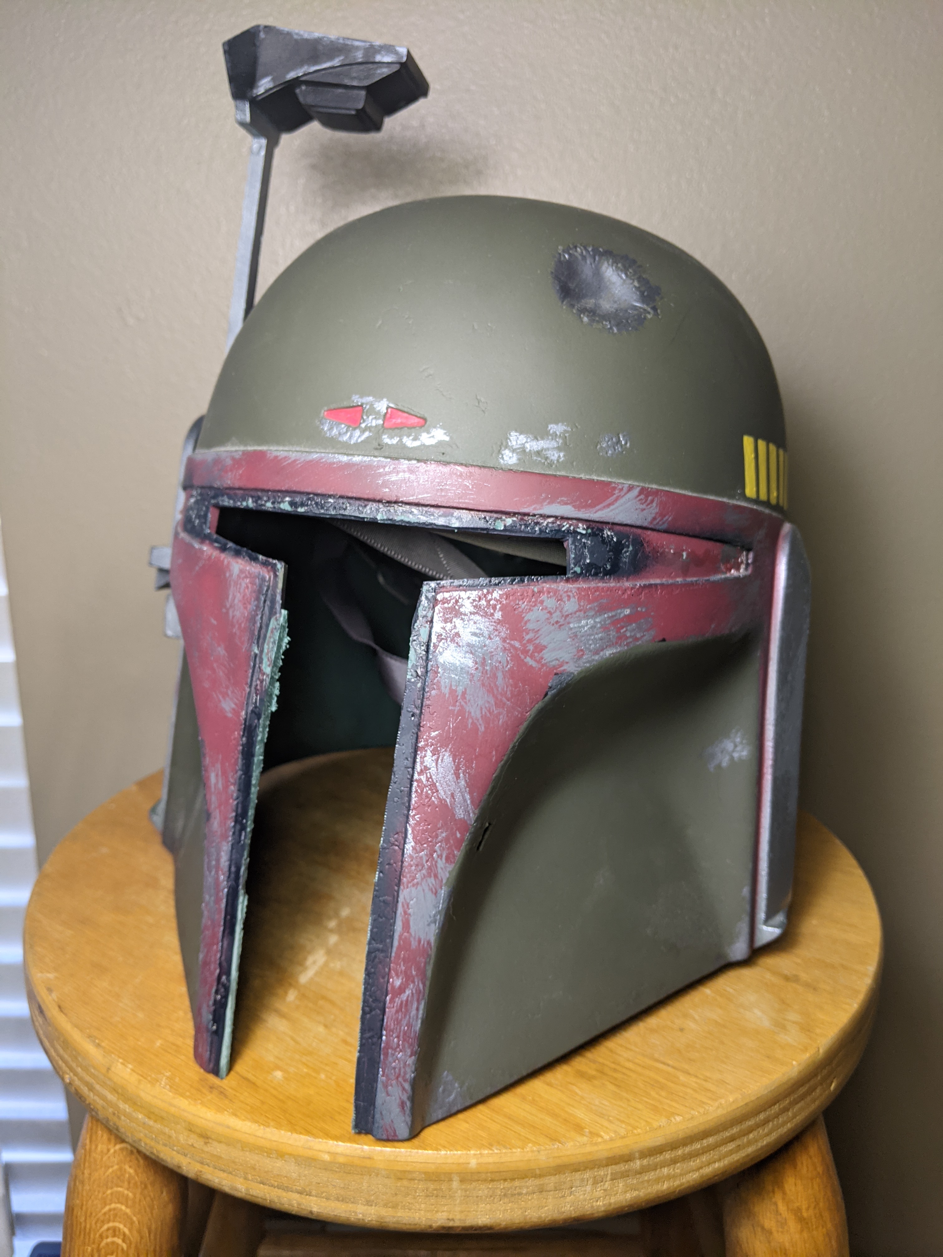

Apologies, yea. Green psudo flexible stuff. The paint is spray paint that's gotten onto it over the years. Everything but the green is original. The rest has been masked off at times while the green portions have been repainted as black, or back to green. I plan to repaint the whole thing, but I'm just figuring it's best to try and take some of the 2-3 layers of spray paint off first.
Is this version vinyl and thus good to go to town on? (I took the original chunk out decades ago with a small hobby saw, so no dust/residue. took ages).

Yeah, that's a vinyl helmet.
Cutting it is probably less hazardous than cutting resin or fiberglass. A regular dust mask will do just fine.
As far as painting goes, I'd do a little research on what type of paint would be best. But again, no stripper or it'll eat into the vinyl.
