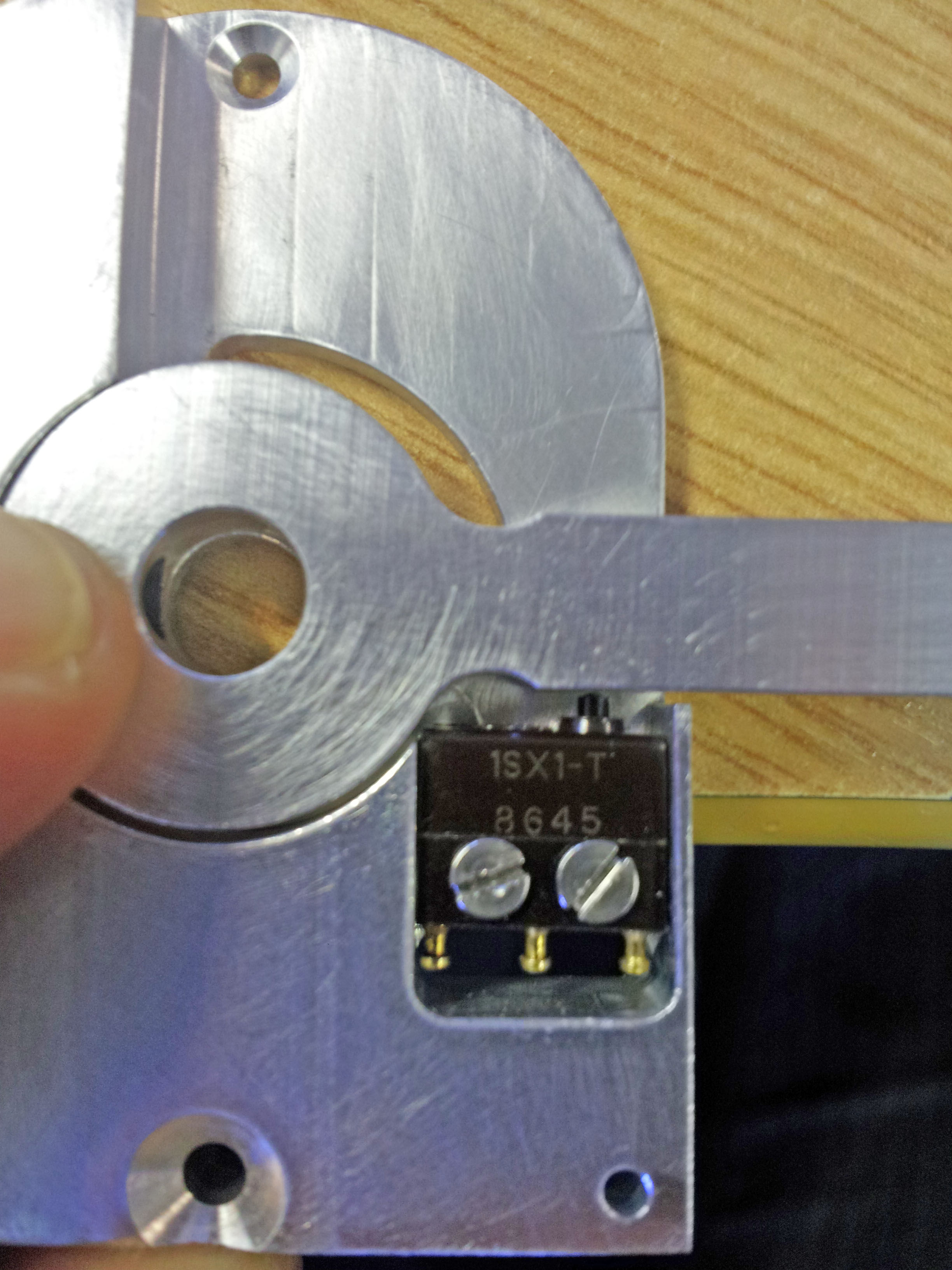

OK, so I got a set of the metal GMH ears and I also have one of the micro switches. but it doesn't fit! :( and I thought oh jeez, I guess I got the wrong switch! well, my GMH shows up with the resin ears that came with it, and guess what? the switch fits in the resin ones... am I doing something wrong? has anyone else had this problem?

From my small amount of experience with the ear piece from the GMH, the micro switch usual does not fit in it. The GMH is a smaller helmet and from what I have learned from making the terminal Fettler topper kit that uses the Honeywell switch, both the switch and the ear piece needed to be modified to get the switch to fit.
The GMH ear I have needed to be sanded out to get it to fit and the stalk had to be altered a bit to ensure the switch would work properly.

The switch could also be the culprit. There are several versions of the 1sx1-t. I haven't really done research on the differences between the models.
The resin ears were made to fit the microswitch.
Gav and I decided to use the measurements directly from the GMH master when we made the microswitch dugout on the metal ears.
In hindsight we probably should have made it to fit the switch but we wanted to keep all the dimension ratios as accurate as possible.
Since the GMH suffers from generational shrinkage all you will need to do is file a bit off both ends of the switch.

I've done 2 build ups of GMHs with the metal ears and on both of them, I had to
slightly sand the microswitch on both ends to get it to fit snugly in the slot.
As far as drilling out the mounting holes, I prefer to drill them just a bit oversized
so I have room to get the ears in exactly the right position. I use small washers
on the inside of the helmet when I install the screws.
