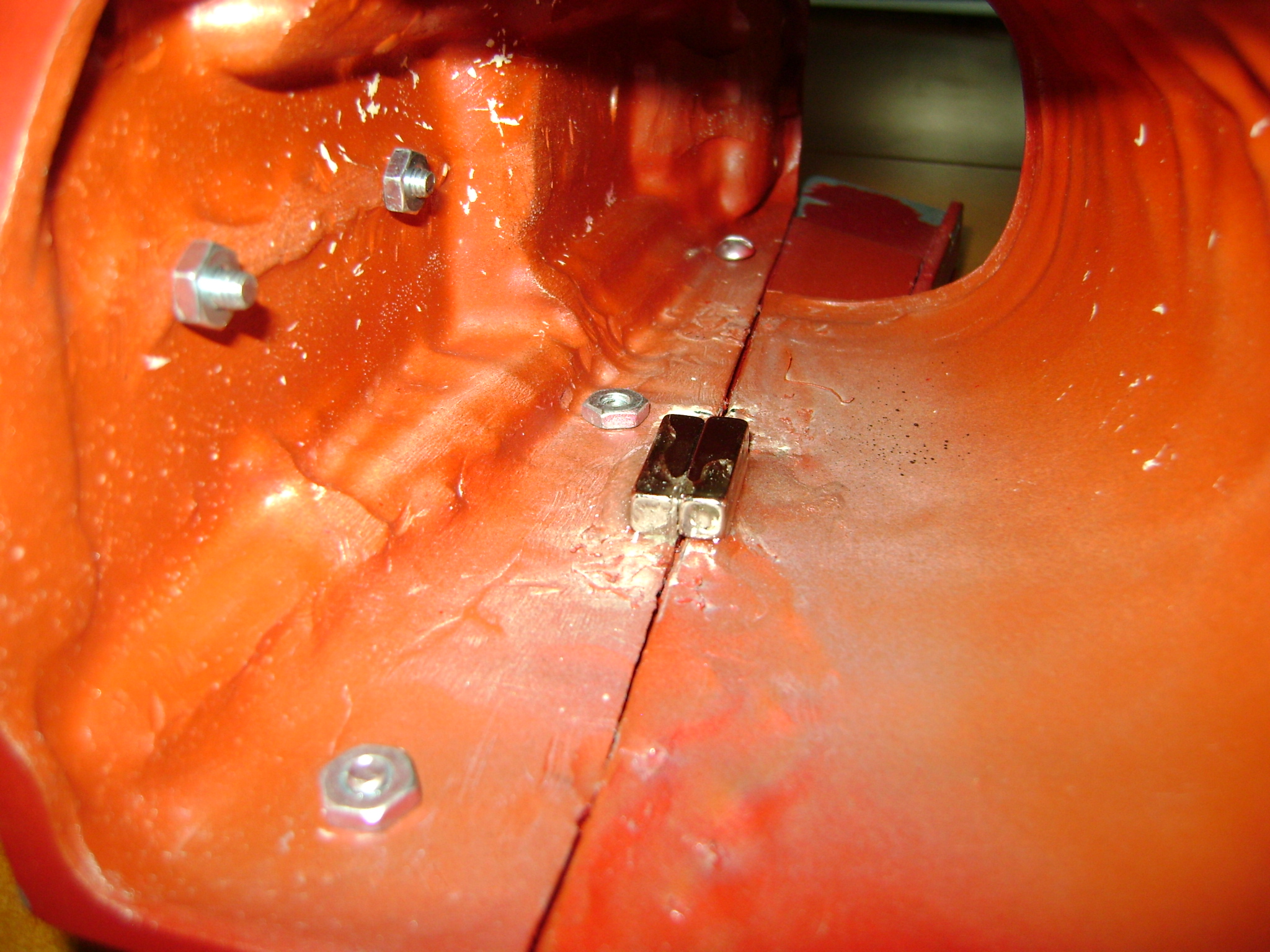

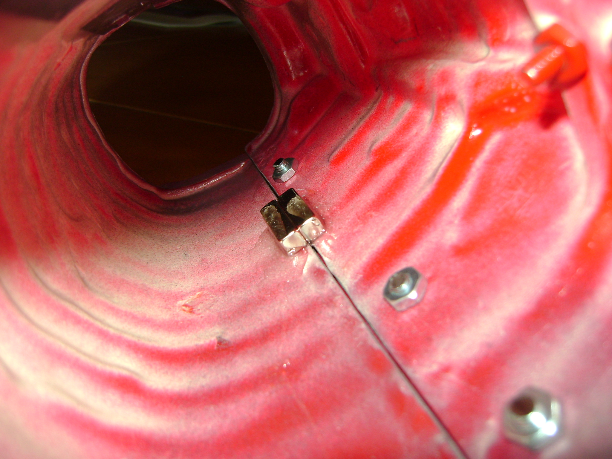

Here's how I did mine. I miscounted my magnet count the first time around, I have added one more set to each gauntlet, so each gauntlet has 2 sets holding them together. I placed a sticky note in between the magnets when I epoxied them in place to keep from accidentally gluing the magnets together. I have MOW gauntlets, and yes they have some bulk to them, but the rare earth magnets hold very securely. The other half of the clam shell is hinged, so they clamp over my forearms and snap shut with the magnets, they hold tight but pop open easily enough. Not sure if you have already completed yours or not, and Im not knocking the hinged method either, just thought you might want an answer to your magnet question. And I just got done trooping at a local library mini-con for 3 hours with out any problems.
