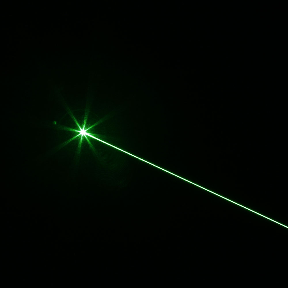

Yes it worked marvelously. The beam is only visible in day times indoors with a smoke or low lights.
However for evening and night troops it looks incredible and bright laser that will reach the clouds!
A few mandos saw me shooting it in the air and every single one is going to add it.
I'll try to grab a pic I took if I can

Try this if the first video didn't work. I took this video back when I completed it. I was so happy but the video just wouldn't show how awesome it was I assume because of the lens flare someone told me? I donno but it's amazing and another addition to my costume.
I used a 50Mw (above FCC standards) and a 5 MW (within FCC standards) so I only shoot the 50 in the air for show.
It's quite impressive at night when trooping you just must be responsible with it not to get into people's eyes.
I am doing a troop this Saturday for the Washington Mystics WNBA and my Clan leader for the Mercs (doing this troop for mercs not my 501st garrison) told me to please take my batteries out so I am not tempted to use it in the Verizon center lol. However he is planning on adding them to his gauntlets too.
Just BE CAREFUL using it if you decide to go with it

I am using Machinecraft aluminum nozzles. I installed the diode behind the nozzle with hot glue (they go into each other by about 1/2" so that is where I applied the glue.
You need to use two AA batteries for each light if you're doing two like me. If it will help anyone I am happy to take a photo of inside my gauntlet or make a video showing the operation.
