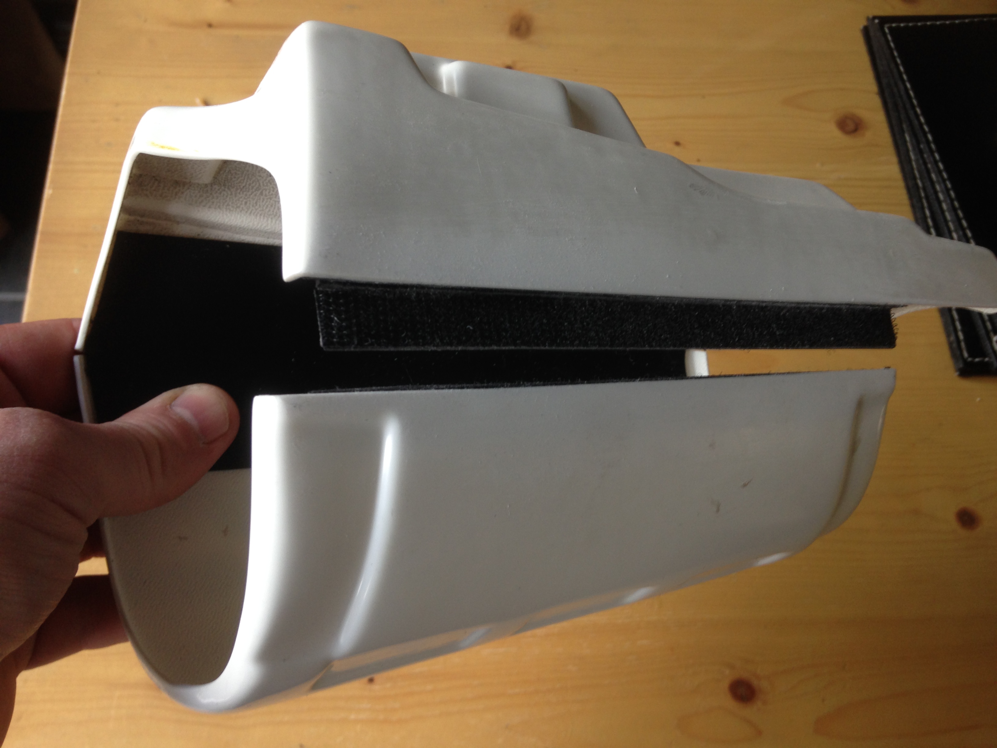

I use Velcro. Works great.
This is what I plan to use. In a month or so once I have them assembled, I should be able to find out how well it works. It should be pretty easy to use velcro to function as a hinge, but I'm not sure how I'll keep them closed. I was thinking I'd have a short length on either end on the inside bottom shells, so I would close the shells and then squeeze my fingers in and pull the velcro straps to velcro against the inside of the top shells.

As I stated in my original post this is what I currently using and due to the thickness of my forearms it starts separating after awhile. Hence why I am on the look out for something else. My only concern with hinges is that they would be too tight, why i thought magnets would be a good try. On that note, my right gauntlet is RKD and sits fine with Velcro and I am capable of putting my arm in and out without taking either half off of the gauntlet.

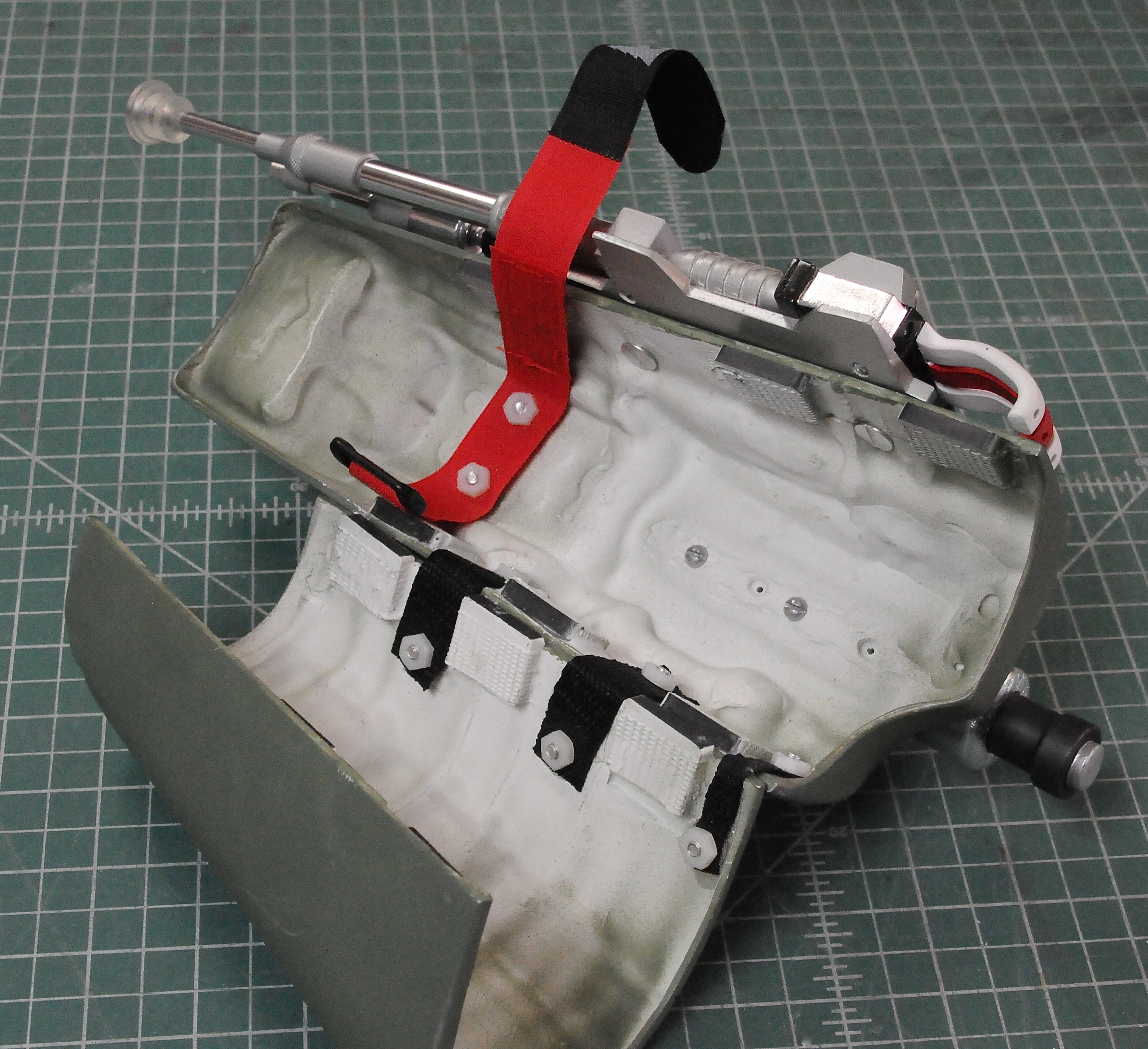

Maybe the way that I did our gauntlets will give you some ideas for yours.
I used six sets of magnets from Lowes big box store epoxied and reinforced with fiberglas (probably overkill) to aline,by offsetting with the seam, and hold top to bottom.
Another nice thing about the magnets is that their weight lowers the center of gravity on the top heavy gauntlets. Some soft hinges were used to help in suiting up and
just in case the gauntlets did open. Wrist straps (the red ones) really keep them upright and solid. They can't fall off even if they did come apart. Hope this helps some.

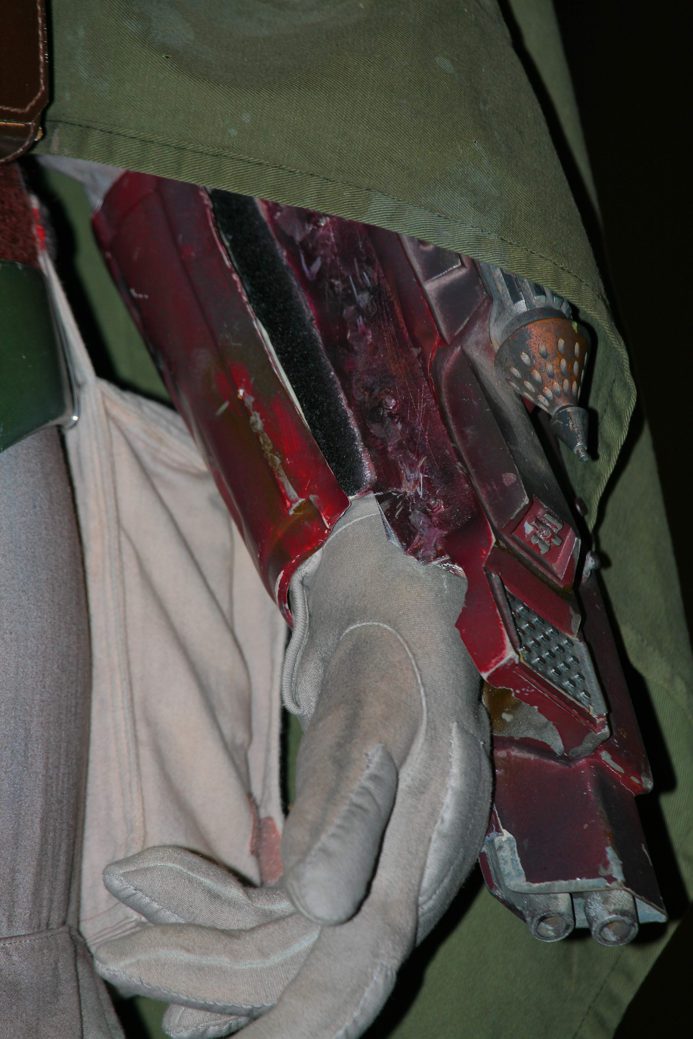

I glued a thin piece of flexible plastic inside the gauntlet to the top and the bottom of each gauntlet creating a clamshell. Both gauntlets fasten on the inner body facing side using Velcro . The right is over and under , the left fastens under and over (see image)
