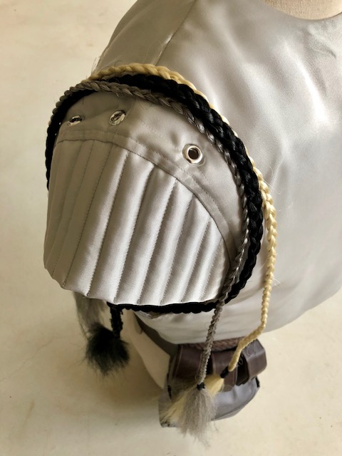

I thought I would share how I prepped my vest and attached the wookie braids - pictured is a BatNinja vest.

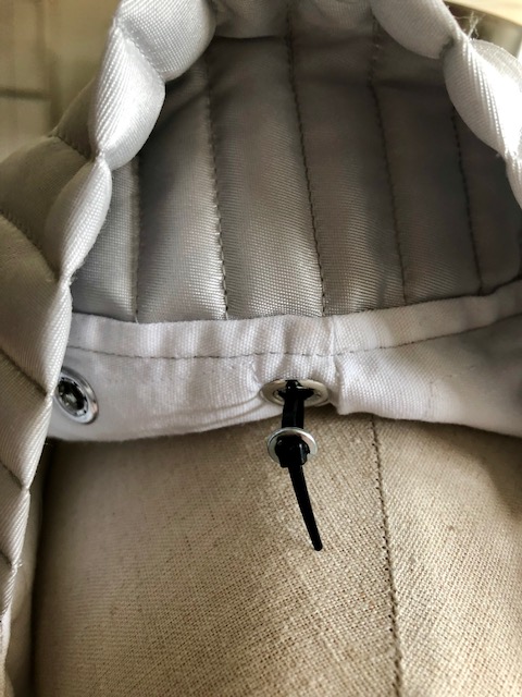

All you'll need are some * zip ties * washers * scissors *
The washers are optional - If the female end of the zip tie is bigger than the eyelet opening you won't need to use a washer.
I used standard hobby shop eyelets which run a little big - the zip ties I had lying around in the garage would pass through the opening so I added some washers that were big enough to not slip through the eyelet openings and made sure the female end of the zip tie wouldn't slip through the washer opening - I find that the added washer secured the smaller zip ties around the braids very nicely.

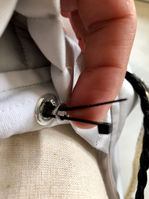

Needle the zip tie through the washer and then through the eyelet from under the shoulder;
Wrap around the wookie braids and then needle back into the eyelet;

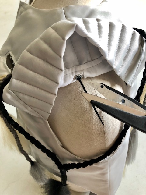

From underneath the shoulder, needle the male end of the zip through the washer first and then through the female end of the zip tie and then only tighten midway;
Do the same for the other openings;

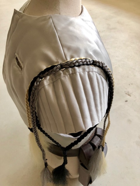

Not tightening all the way at first allows you to position the braids how you want them centered (I centered the black, moved the gray longer in the back, and the blonde longer in the front - I think that is how I saw it laid out in a reference photo in the past).
Once in the correct position tight the zip ties all the way and cut the excess.
Voila!
