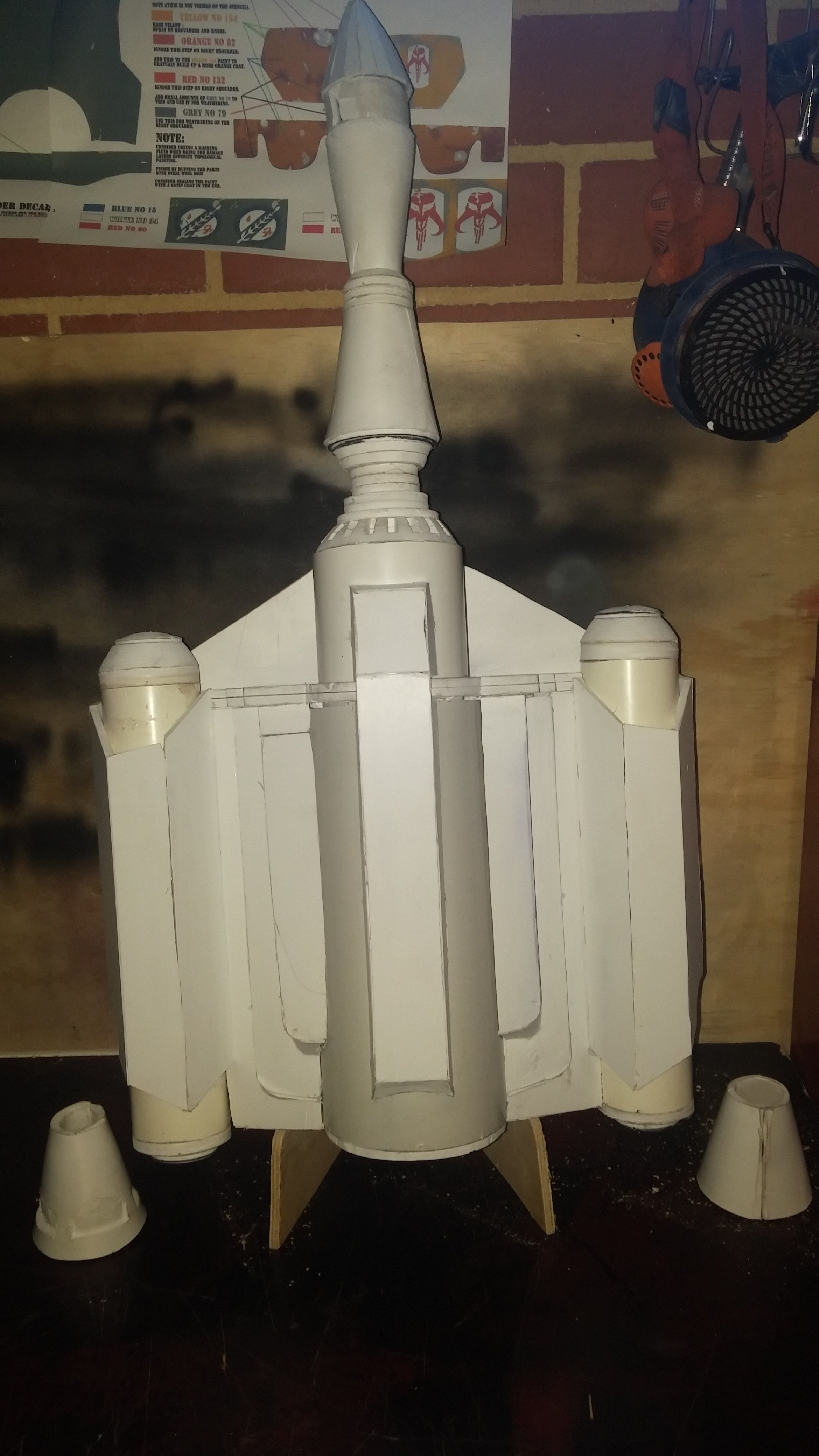

All I will say is give it a go like we do in the land down under I have started to make my fett with PVC foamboard in 2mm and 5mm all I will say is its a lot of time and a lot of planing expect to have a learning curve with materials you use. I had to pull apart the jetpack a few times to get it all inline with the drawings

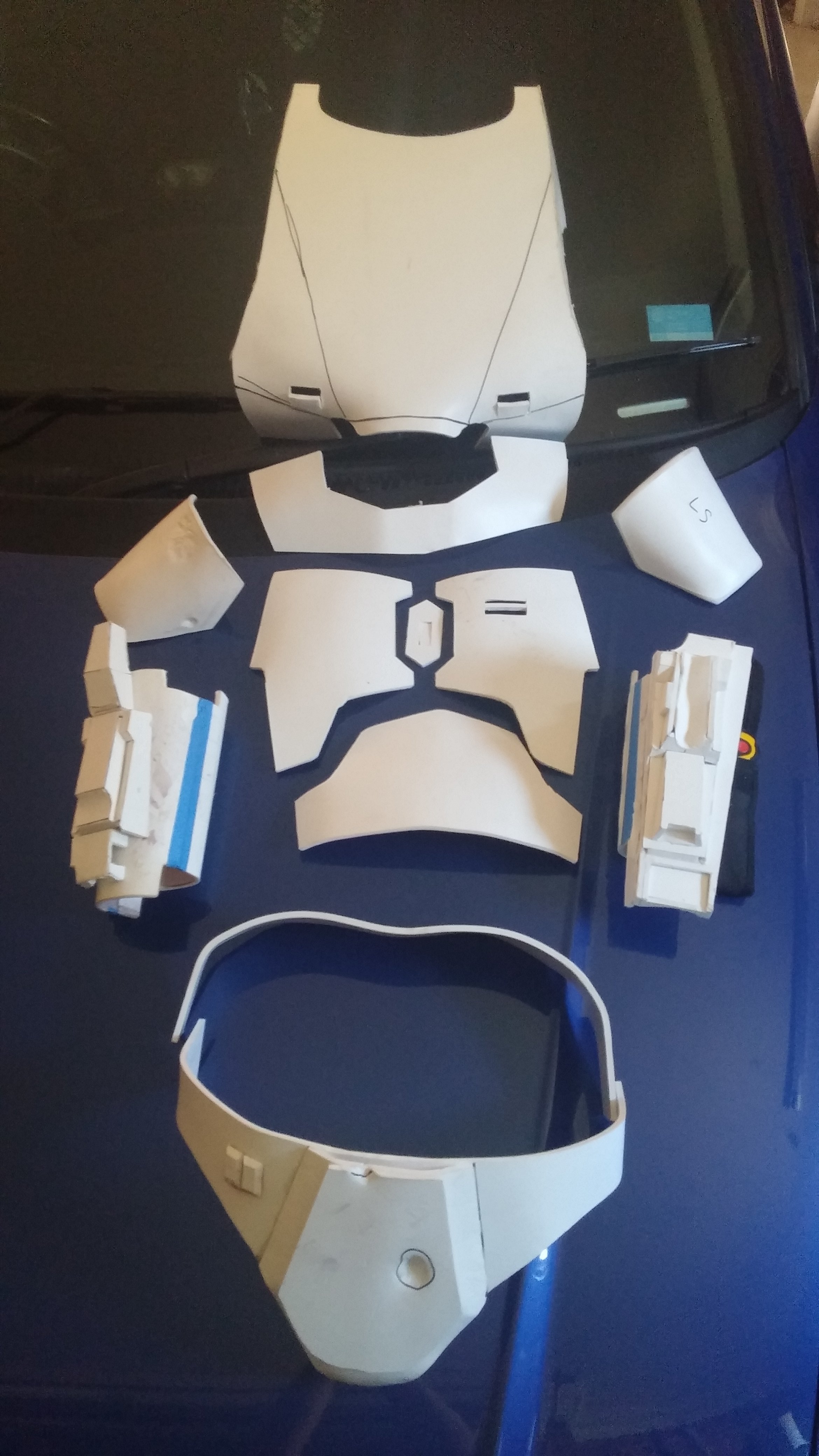

I made my armor from some cheap-o thin walled 4" diameter PVC pipe. It took just as long to do as a set from Sintra would do I would think and was very in expensive (like $8 for a 5ft chunk) you would probably spend the same on both of these so I would get what's easier to obtain in your local area
