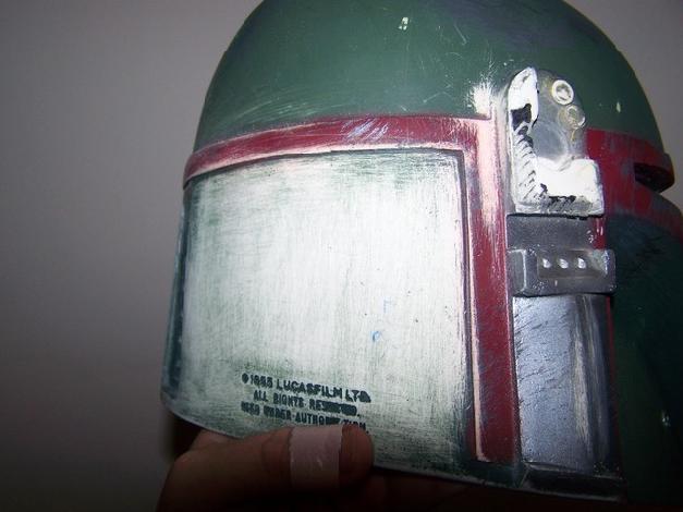

ok so heres my first update! I started sanding but i want to know how I am doing, do i need to get all of it out or just most of it? so when i do my first primer it will look decent?
also i popped off the range finder and it came off it one piece! LOL, with a little injury to my thumb, damn exacto-knife LOL as you can see in the pic!
With the DP 95 i think thats the only piece that can come off, or at least thats what it looks like to me, is there any other pieces i need to remove besides the visor?
heres the pics!
You cut yourself taking the ear off? QUICK mix some of the blood into the paint you plan to use! :) That way there will always be a little bit of you in that helmet of yours! (that's the way Boba would have done it, I bet! ..... if he cut himself while working on HIS armor!)
All kidding aside... you're doing a great job sanding! The primer and later coats will go on smoother and without thick painted areas if you sand it all off before applying your own colors.
Keep up the good work!
If it were mine, I would also use a touch of bondo or green modeling filler and cover the DP and date imprint on the back. Let it dry and sand it smooth. Just an opinion, but if i were doing a custom repaint, I would not want the factory markings on it.

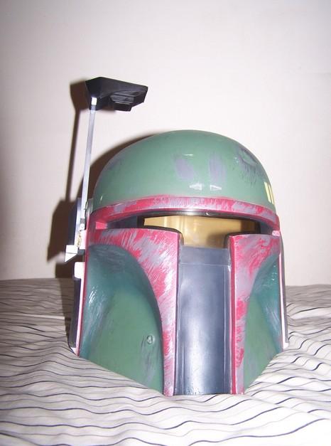

hey dude welcome aboard. I did custome dp95 , and it looks great. well i like it , any who in case your wondering how to get the worp in the back of the helmet out, just use a metal half ring. I used a paintbucket handle , and it worked very good, i didnt even glueit . i just placeit and it stays in. just make sure; when you cut it to the size, each tip of the half ring is flush with the sheeks, im pretty sure youl figure it out . i know you didnt ask , but just trying to help. good luck dude.

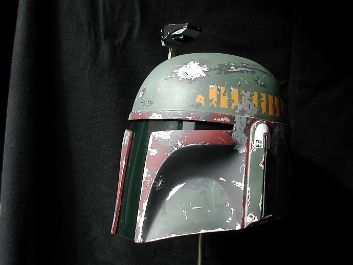

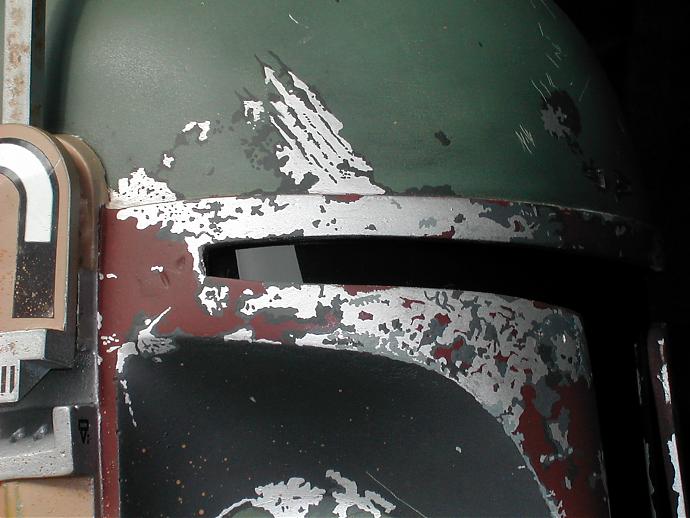

Here's what i got out of my DP 95. It's currently on ebay Austria 'cause i want to move on to a BM helmet now. I used Rogue Studios paint list and the reference dvds. Also very helpful was AFettFullofDollars stencil thread. Thank You!! the dented helmet is a unbelievable source and a great community.
Damn Wofi, that an awesome DP95! Ive got my old DP95 stripped down to plastic with with a reinforcement ring. I had it finisehed once, but it' didn't look worth a ****. So as soon as I figure out a way to fit the visor in there, I'm painting.
