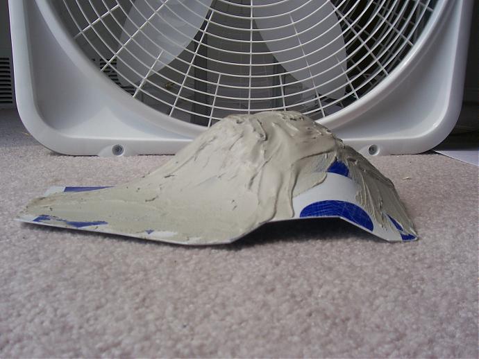

So far it would appear that my 'darts' reasonably successful in creating a nice shape with the sintra. After I got it hot enough (the oven worked much better than boiling water!) I formed the shapes on my chest cast and let them cool. Well on one side - the other side got too hot and did strange things... :rolleyes Anyways, after it cooled the piece seems perfectly content to stay in the right shape, i.e. I can take the duck tape off and it retains the shape, so I attacked it with bondo. My *theory* is that the bondo will be strong enough to hold the 'darts' together... I don't actually know how strong the stuff is. Anyone know the answer to that?
It's drying now (hopefully the bondo actually sets this time - the first batch never dried... I assume inexperience was to blame. Good thing it was just a test batch.), but here is a picture of my chest piece all covered in gooey bondo. I also put the pattern piece in the picture so ya'll can get an idea of what I started with.
So, my questions are: how strong is bondo? (I'll find out what the relative strength is in a couple hours when I start flinging the armor around, but I'm curious about longevity) And what do ya'll think of the shape the piece has? Am I successfully avoiding the softball look? ~crosses fingers~
I know this is going to sound bad, but could we get a side shot of the Bondoed version? The reason I ask is I'm putting together an armor set for my wife for a project for school. If you can get a decent shape out of sintra... to say I'd be happy that I don't have to put together a vacumformer and make molds, would be an understatement.

Side shot attached Hagen. :) The shape isn't fantastic, but I like it. It's curved to accommodate and not to flaunt. I don't think a shaper curve would work, but I dunno. In any case, it very very badly needs to be sanded, and probably have a bit more bondo added to really smooth it out. But you get the general idea.

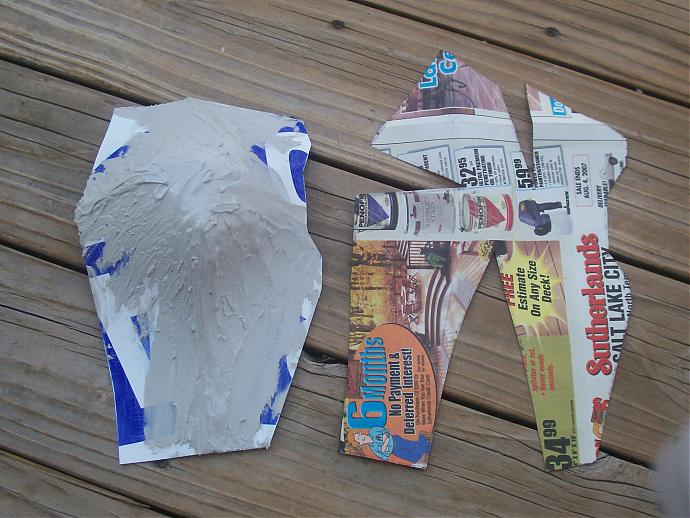

The piece isn't cast, it's just heated and formed sintra. I have a chest cast that I've been using to make patterning easier though.
See the newspaper piece in the picture? I took a piece of newspaper and put it on my chest cast, and then folded and taped until it fit nicely. I then made three sorta straight cuts - top, side, bottom - to make the pattern lie flat again. I traced that onto the sintra, heated the sintra until soft in the oven, and then kind of pulled the cuts together so it formed a piece like my pattern did before I cut it. I duck taped the darts/slashes together until it cooled (and I let it cool slowly because I was terrified that it would warp under sudden cold water, though I was on the floor near an AC duct, so maybe not that slowly). Next, I sanded and bondoed the front, and then I used off-brand JB weld on the back. On the next piece I'll probably use the JB weld before the bondo, but either way should work ok. If I hadn't had JB weld stuff on hand from building sabers than I would have bought the plastic weld stuff, but impatient me already had one thing and didn't want to go buy another... ;) I've had really good luck with that stuff anyways, so I'm not too worried about it.
After the bondo & JB weld seemed solid (a couple hours for the bondo, about 40 mins for the JB) I dropped it on the deck repeatedly. And then I whacked the railing with it. No dents, no cracks! I guess it's going to work... My only potential worry is the difference between humidity in Utah and GA, but hopefully it'll be ok. :)
