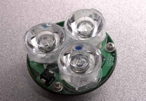

Anyway, I'm draging out this old thread because this is what I used in my custom bucket. I used the kids bike helmet route and bondoed up all the holes but the front two, then mounted these babies inside, flush, pointing out. It's pretty wicked!
