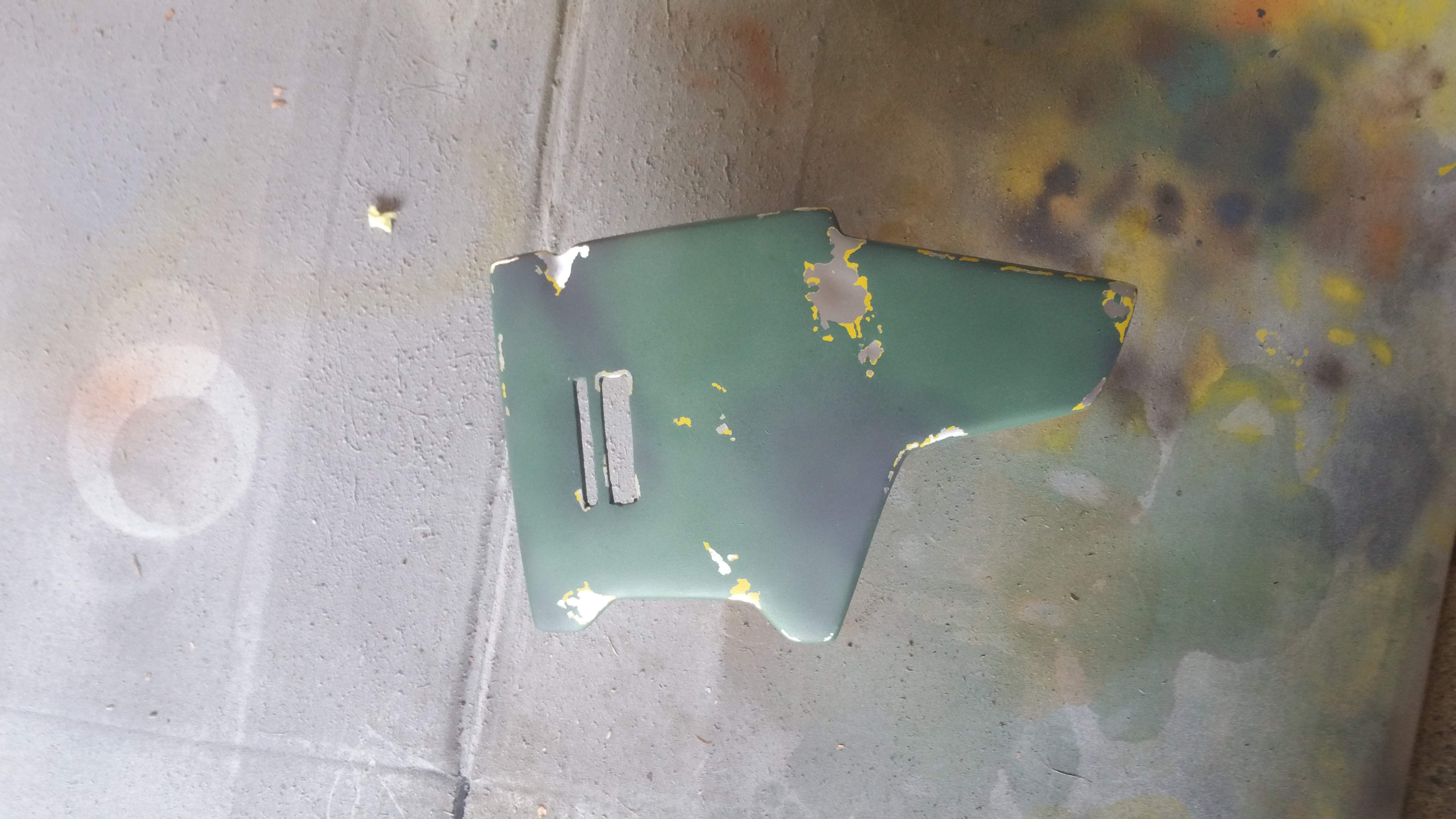

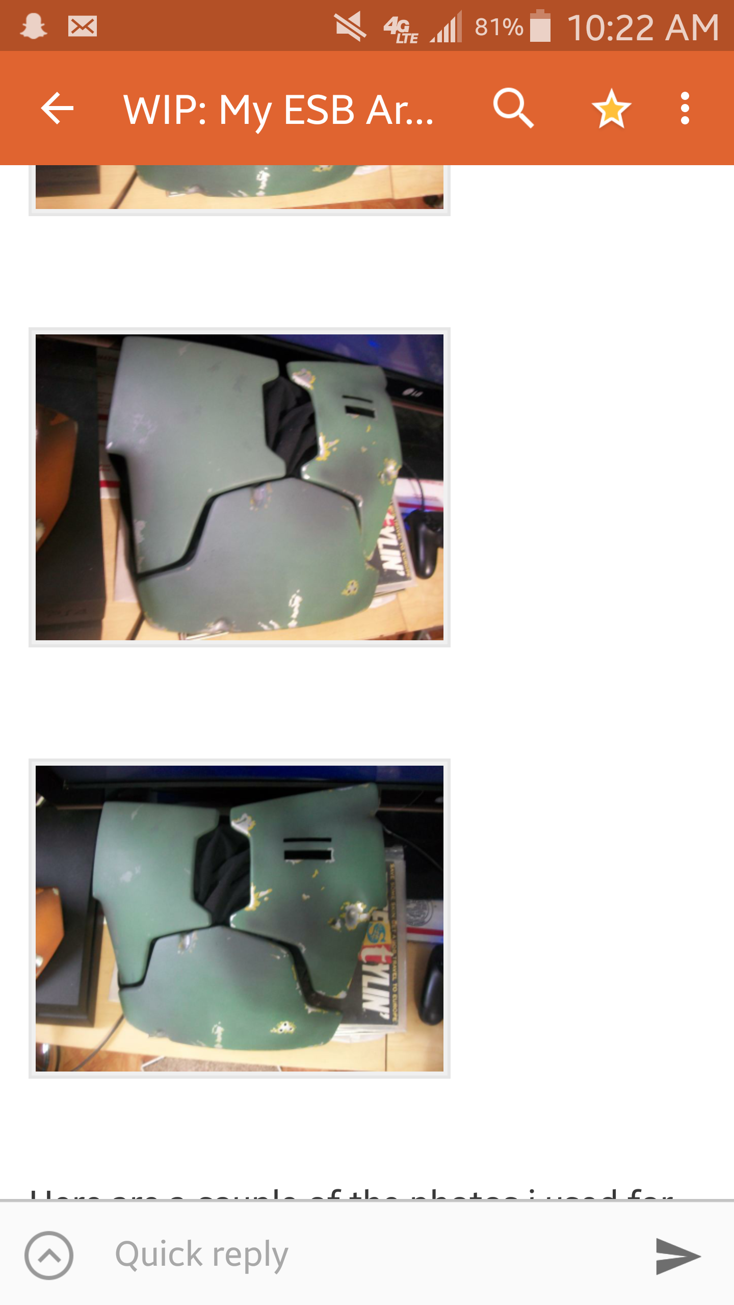

With New York Comic Con only a week away, an update is in order for my ESB armor. Now, my helmet is a whole other story and I need to set aside more time than a week for it, but I can get this armor done! I didn't have the time to wait for humbrols, so I went a Model Master route. A little risky considering theres no definitive MM list,but here's what I have so far:View attachment 92475View attachment 92476View attachment 92477 uploadfromtaptalk1443666179724.jpg
Honestly, I'm pretty happy with how it's coming out. I used the ref pic off of the 501st for the knees, film shots for the shoulder, and worked off of DVH and Mattys pics for the chest piece. Thoughts and (gentle) criticisms welcome! [emoji28]

what model master colors did you use ?
For the shoulders and knees:
Base Yellow- Yellow Zinc Chromate
Orange Mist- GO Mango Orange (heavy on right shoulder and right knee, light on left knee)
For the Left Chest and Ab: (right chest TBD)
Base Green- Panzer Olivgrun 1943
I used acrylics to weather all of them
R. Shoulder and R. Knee: a 3:1 mix of Delta Burnt Orange to Charcoal
Chest and Ab: Tamiya German Grey I think, I'll double check that too
The base silver was Rustoleum Bright Coat Metallic Finish Aluminum, 7715
I sprayed this, masked, primed and then began with the model paints. When I didn't prime all of the model paint peeled off. Hope this helped!
