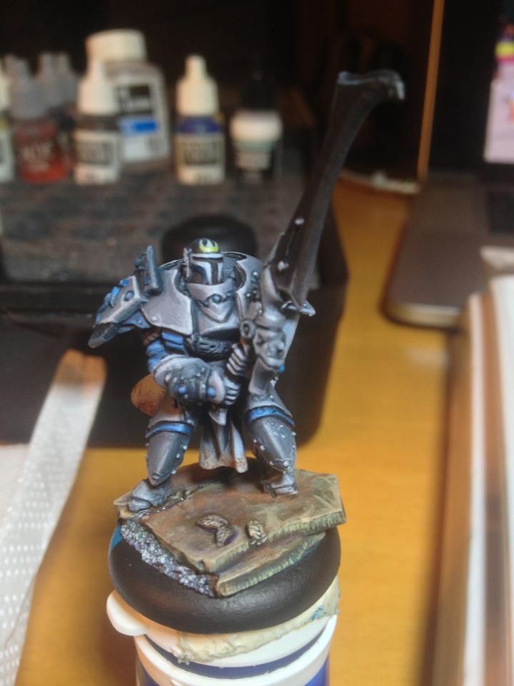

I am a Tabletop-Player and have painted miniatures for sale for some years. I have always worked with acrylic colors (mostly Vallejo Model and Game Colors) doing that and have now read through the forums and flipped through some Youtube tutorials on painting props. You guys seem to use enamels exclusively to do that. Would you mind telling me why? From my point of view the waterbased acrylics should be far easier to work with and should resist wear and tear as well as enamels when using a hard clear coating followed by matte coat.
Here is an example on a modified 28mm miniature from the Warmachine/Hordes Game of Privateer Press. It's Dawnguard Scyir and I let a sculptor make some Mandalorian helmets, which were then cast. I swapped all heads of an entire army and will paint them up in the Death Watch color scheme. So this helmet is about 3mm high.

I think enamels tend to be favoured for hard parts simply because they are a more durable finish. Wearing a costume will impart a little wear on hard parts, with all the little dings and bumps that can happen when you're out and about. Enamel paint will better resist scraping and chipping, compared to an acrylic. I know exactly where you're coming from, though. I use acrylics for laying down paint on models myself, but I started weathering them with enamel products (like AK Interactive's excellent line of enamel weathering solutions). To each his own.
Okay - but this isn't a strict No Go, yeah? For display purposes this should work pretty well then. I will definitely check out the weathering solutions. Got some pigments from Vallejo now for weathering - what I will definitely use are the enamel metallics. Acrylic metallics have always been a mediocre solution for me.
Yeah, you should be fine with acrylic for a display build. And myself, I'll be using buffable metalizer enamels for my raw metal bits on the suit (flamethrower, gauntlet rocket, etc.)
