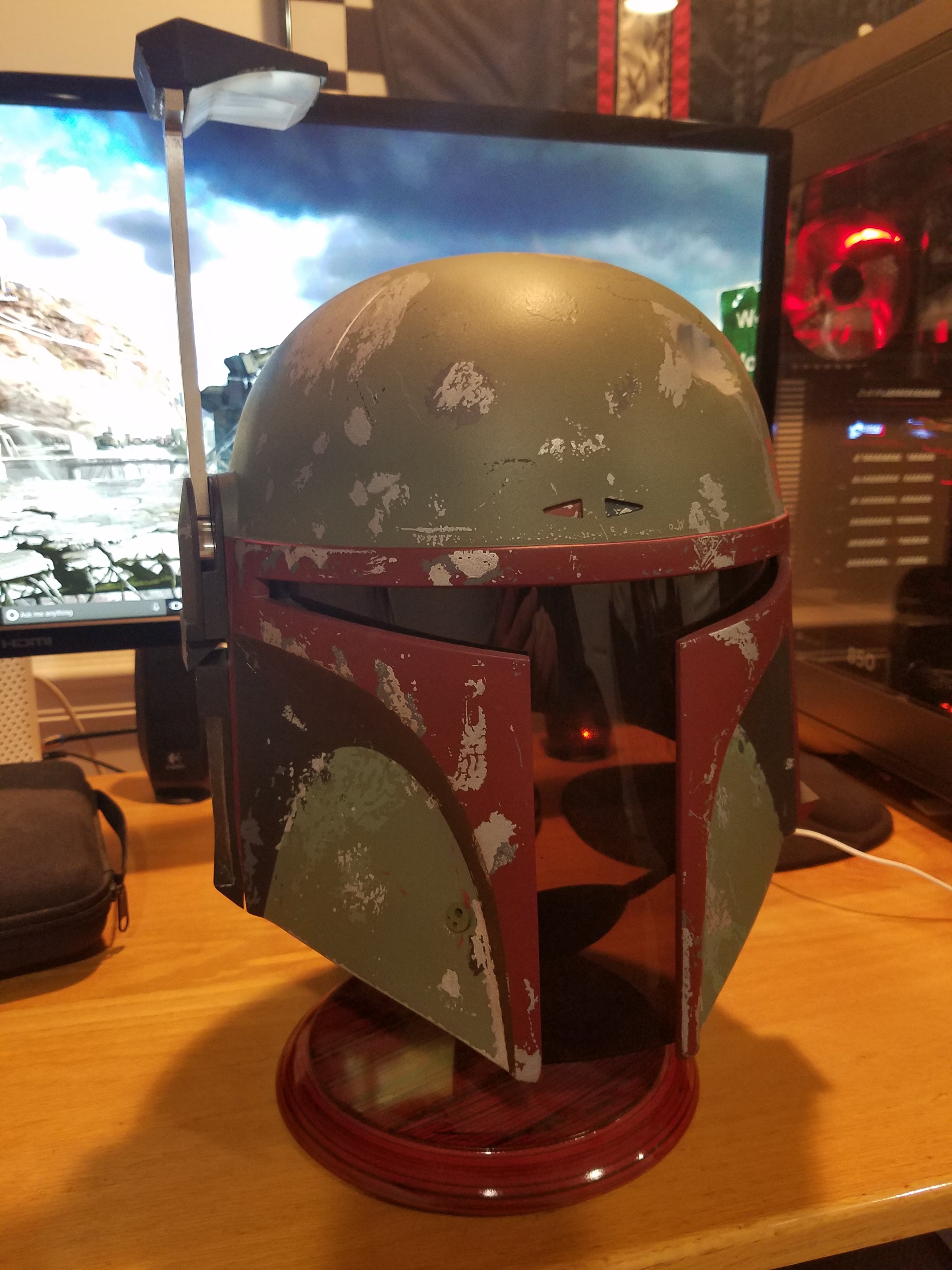

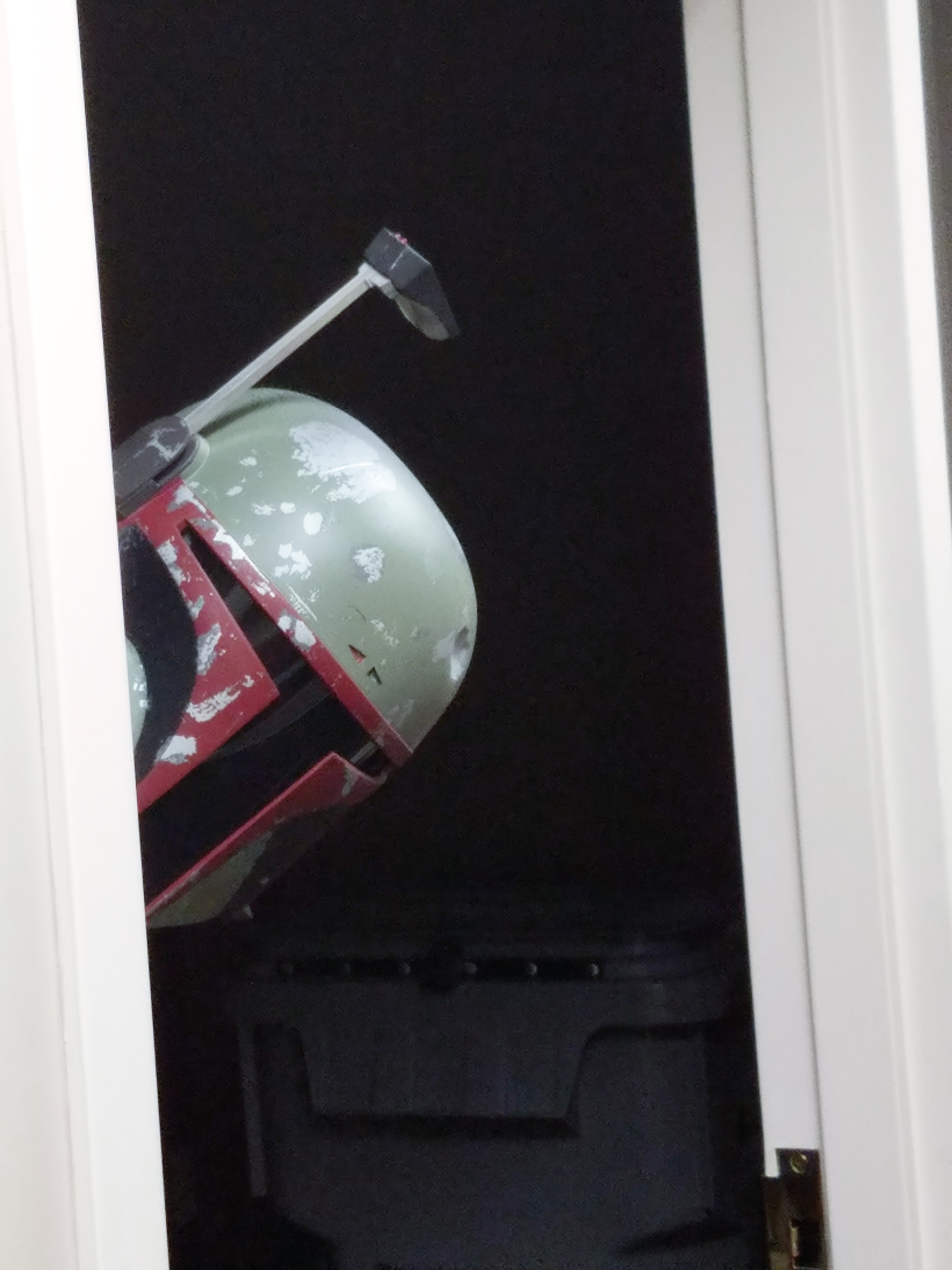

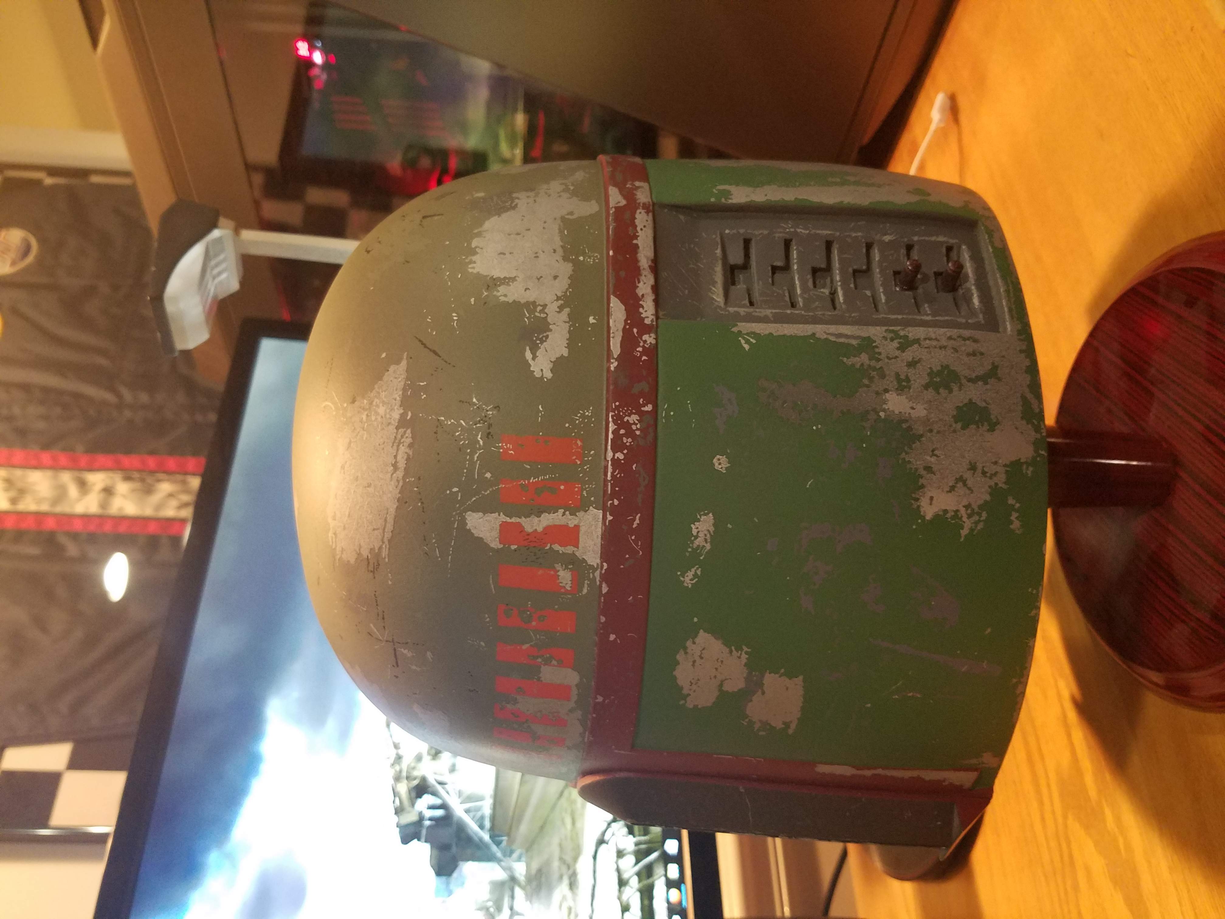

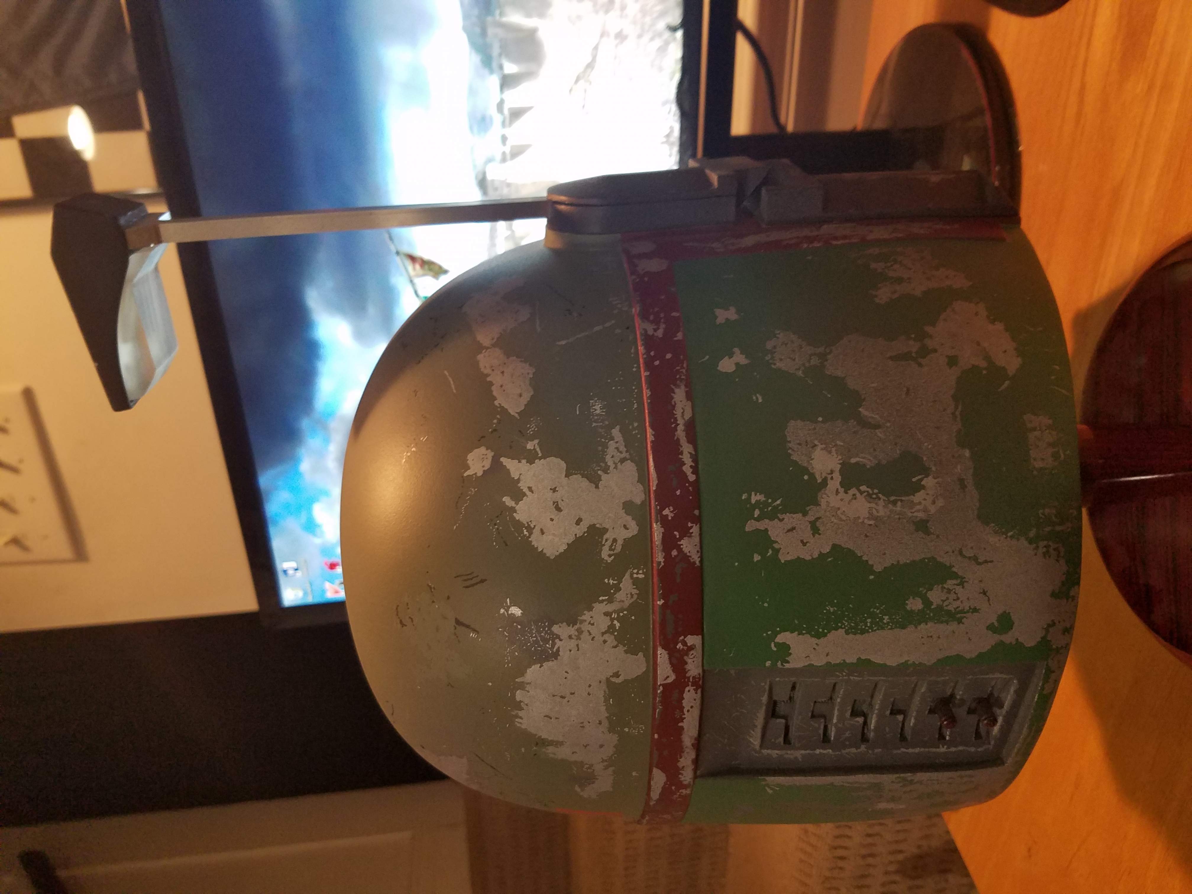

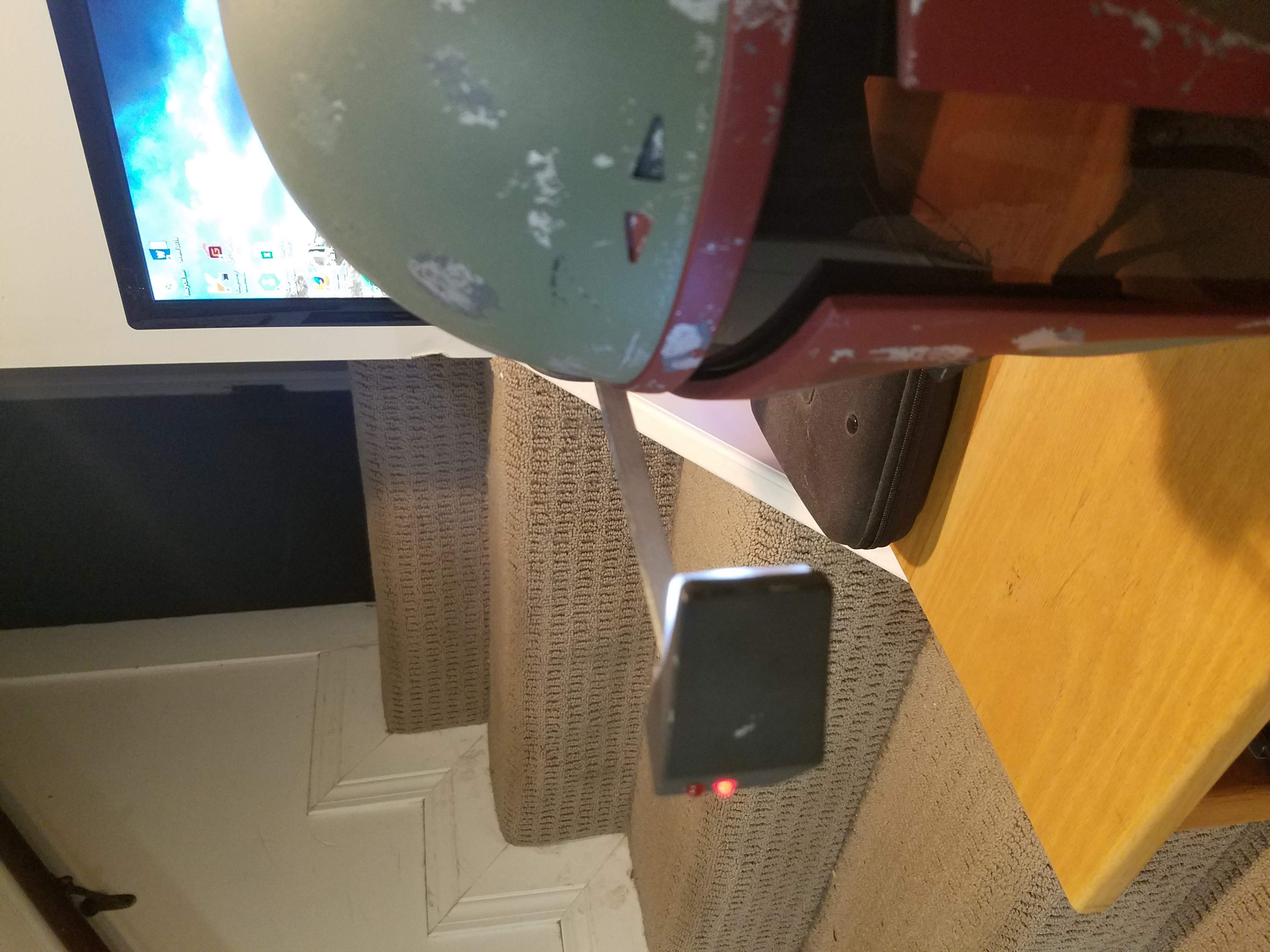

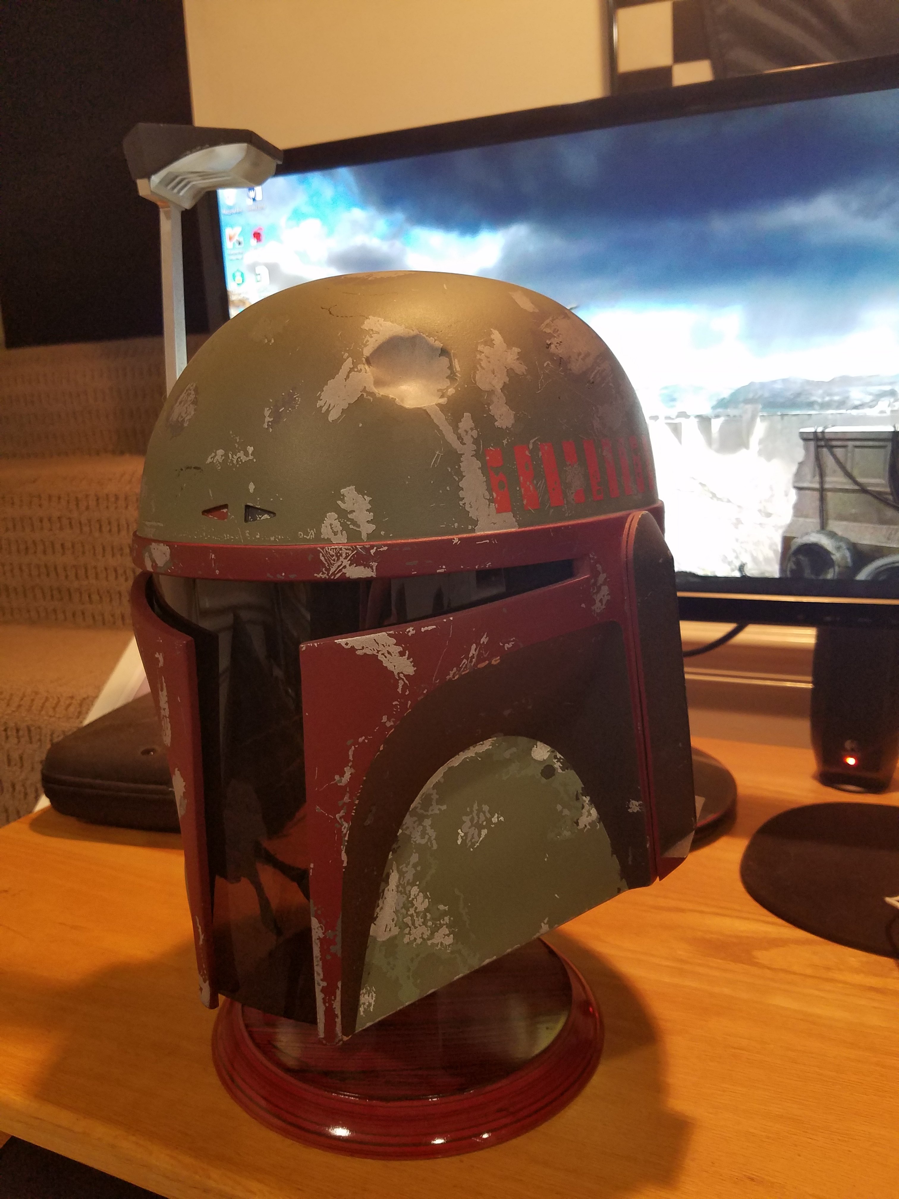

Well it looks like it’s finally time for me to start a build thread. I'm going to just show the helmet for now since it's the only thing that is close to being completed. For the helmet, I got an Animefan premium helmet and had AFFO$ paint it for me. I also got a hollow aluminum stalk from Mojo_skywalker on ebay since I wasn’t too fond of the resin one. The dental files on the back are 3d printed from Toolguy. They seem a bit large but I don’t have any real ones to compare them to. Not yet at least!

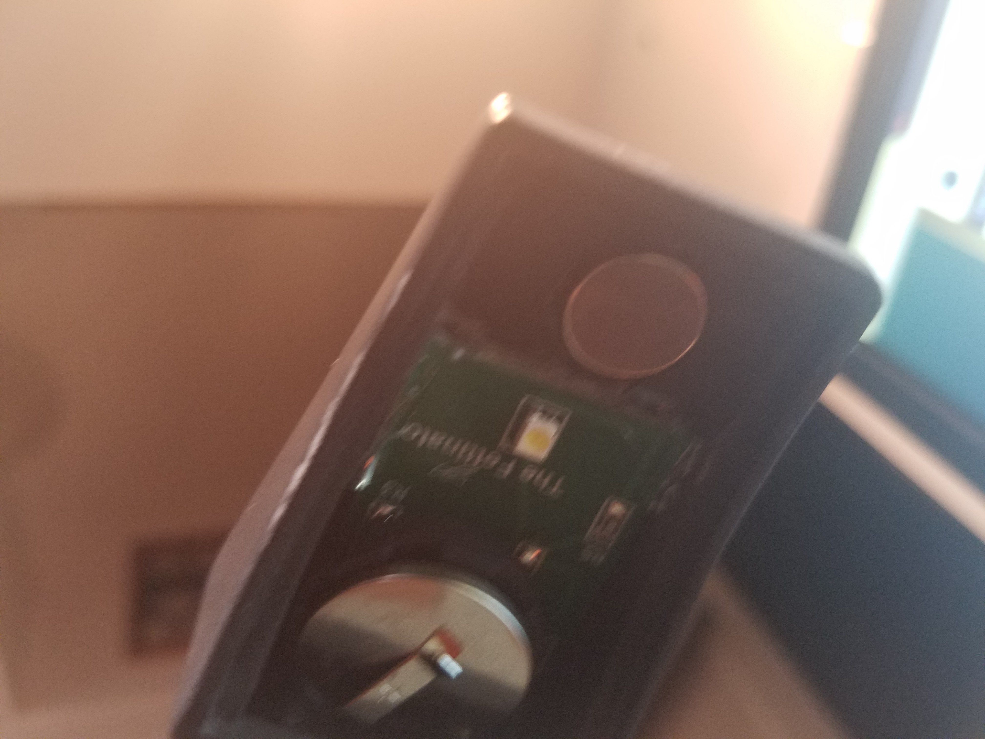

The rangefinder has a Jc27 self-contained light kit in it as well.
When I was attaching the servo, I ended up putting magnets in the ear cap to hold it on. I was originally skeptical of this and wanted to use screws but after doing it I have no worries at all.
I also used magnets to attach the Perspex block to the rangefinder.

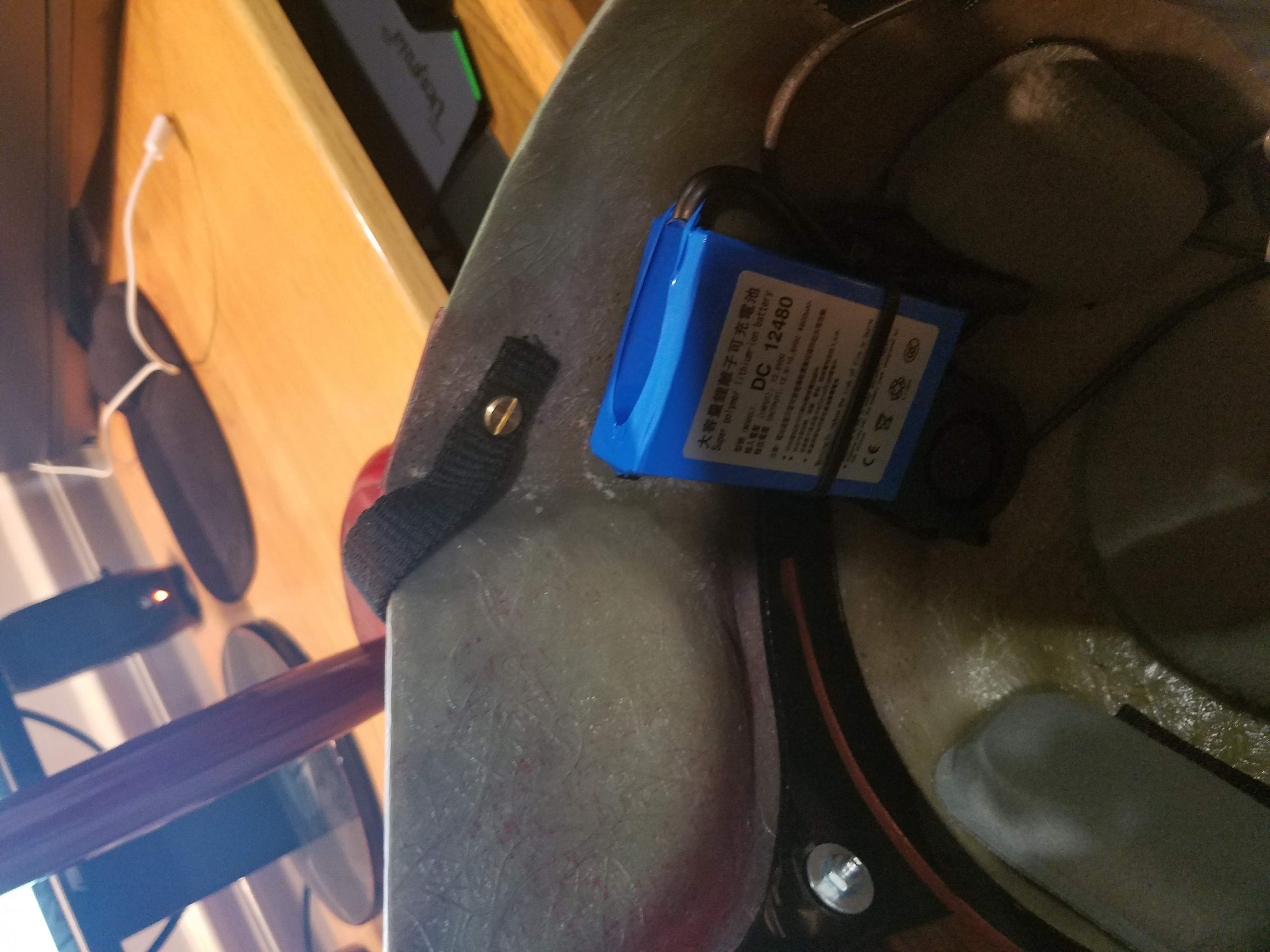

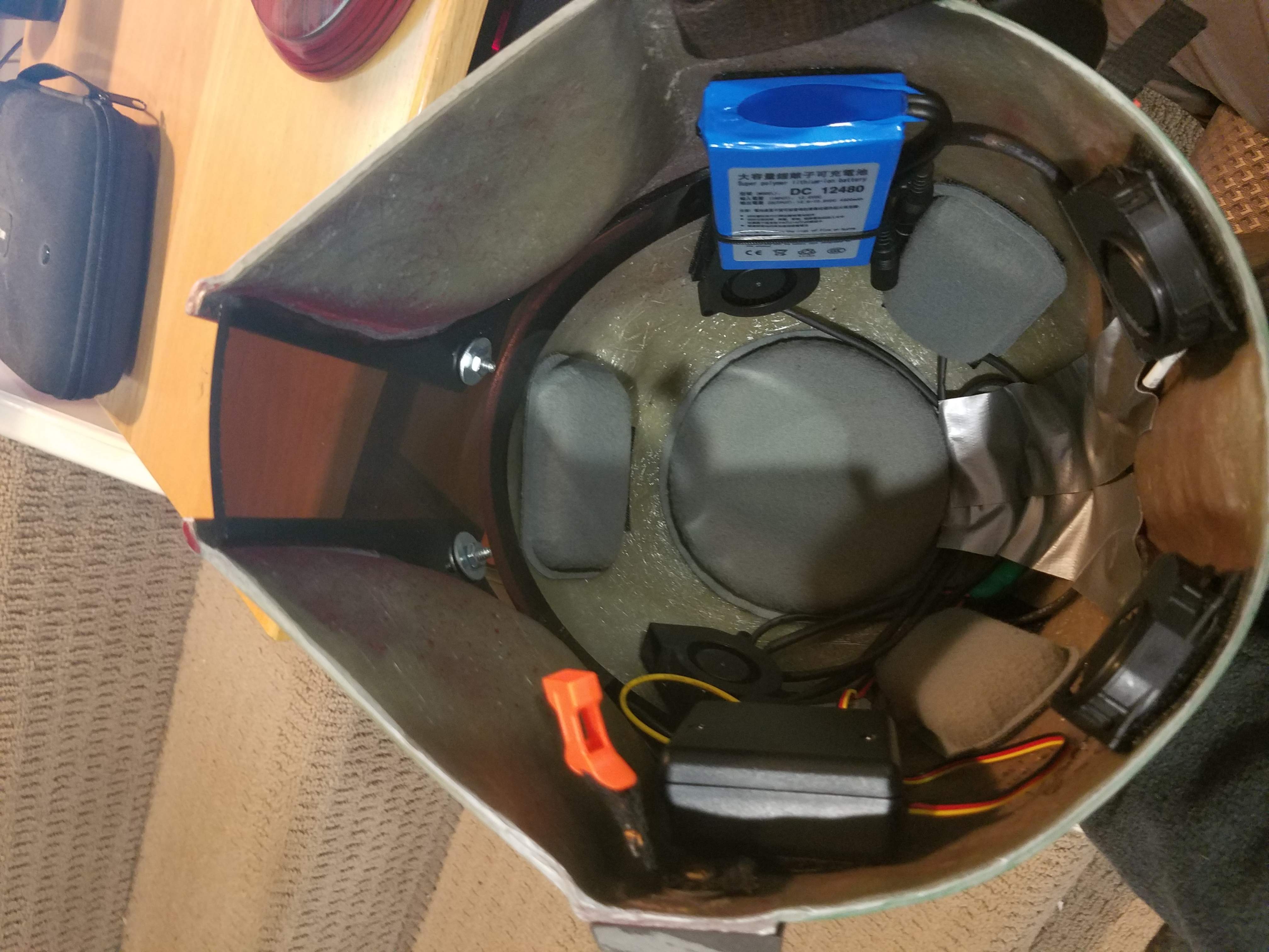

Now for the inside of the bucket. I had Crumdum make a power system consisting of four fans and a servo power hookup. This way it will all run on one rechargeable battery and will save me some space in the helmet. The battery is set up to have to power connectors on it. I can put it in one of the hip pouches or a thigh pocket and power my chest lights and mic system (so I can hear people) at the same time I power everything in my helmet. That way I’m not using dozens of AA batteries for every troop.
I put a chin strap in it as well. I know the orange buckles are not accurate but I like the color and it won’t be seen so why not add a personal touch. For that matter the chin cup isn’t accurate either. I put in some military helmet padding which is attached with the industrial strength Velcro. I used the Velcro to hold everything in place as well. All of the fans, the battery, and the wireless receiver for the servo are held with Velcro. I did end up having to hot glue the servo itself in due to the Velcro thickness causing problems.
Next, I’m going to put a mic to attach to my aker inside the helmet since I have a huge head and the headset that came with the aker is very uncomfortable when the helmet is on. I’m going to get a wireless mic and just Velcro it in as well. Then I can put the wireless receiver in the aker and I won’t have any wires attaching me to the helmet normally.
I also want to route the wiring better and secure it better than just using ducktape and I was hoping to get some advice about that. Thanks for reading and I’ll be updating the thread and photos with other stuff I’ve acquired as I finish individual parts.

Looking very nice Drax! I've used this for connecting to my Aker: Pyle PDWM96 Wireless Microphone https://www.amazon.com/gp/product/B0007L8BQW -- but be warned, hooking to the same power supply as my fans/servo, I got bad feedback in it any time the fans or servo was working. Also, I used a combo of hot glue and some Zap a Gap to secure the wires cleanly. Looking forward to seeing more!

I'm actually going to let the mic be powered on its own. It has a rechargeable set up and should last for 8-12 hours when fully charged. Heres the one I was planning on getting.
https://www.amazon.com/dp/B01M7RNBL...UTF8&colid=67GFVF2EJ4N0&coliid=I1H2YOR3SHXKC4

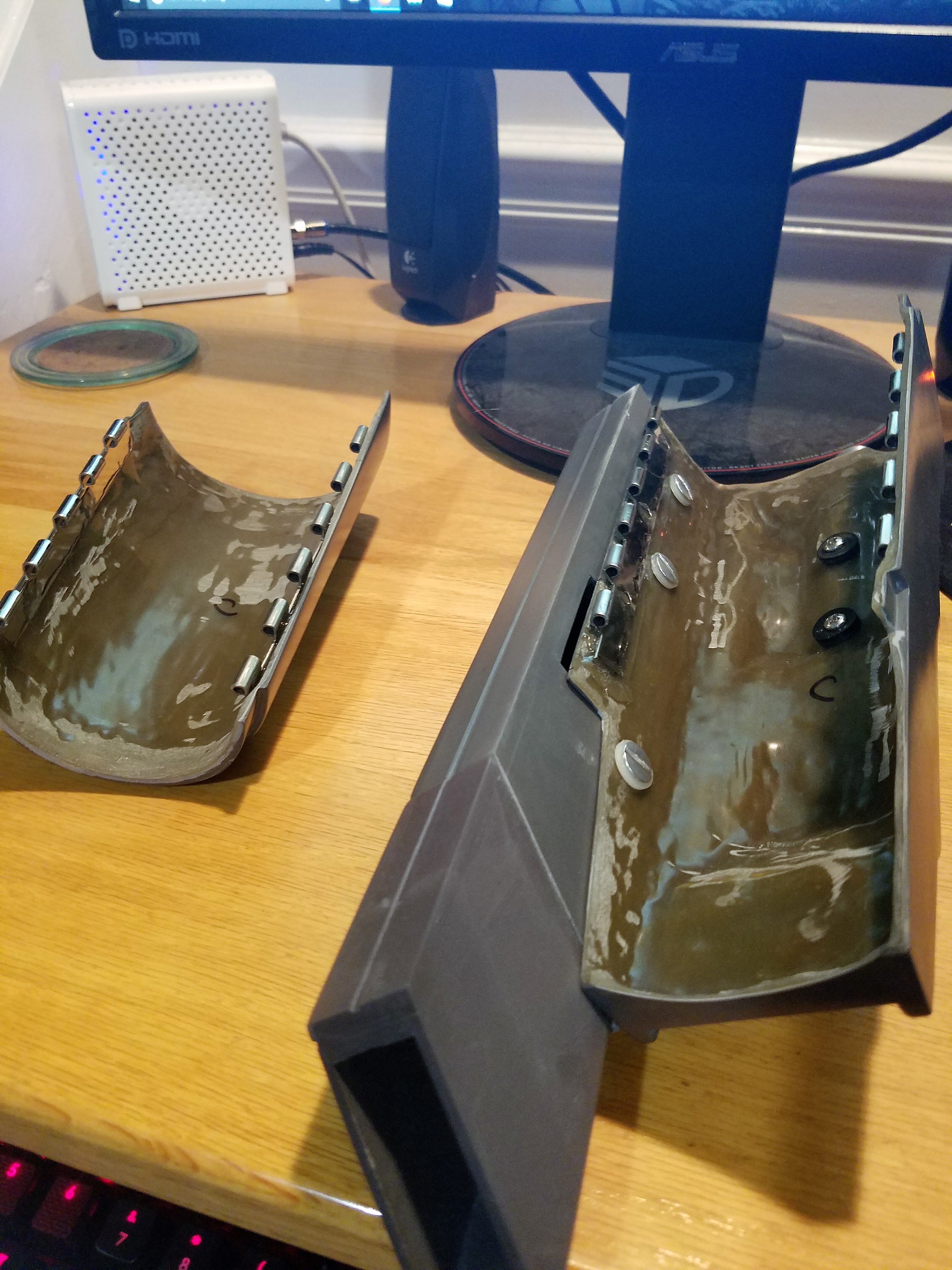

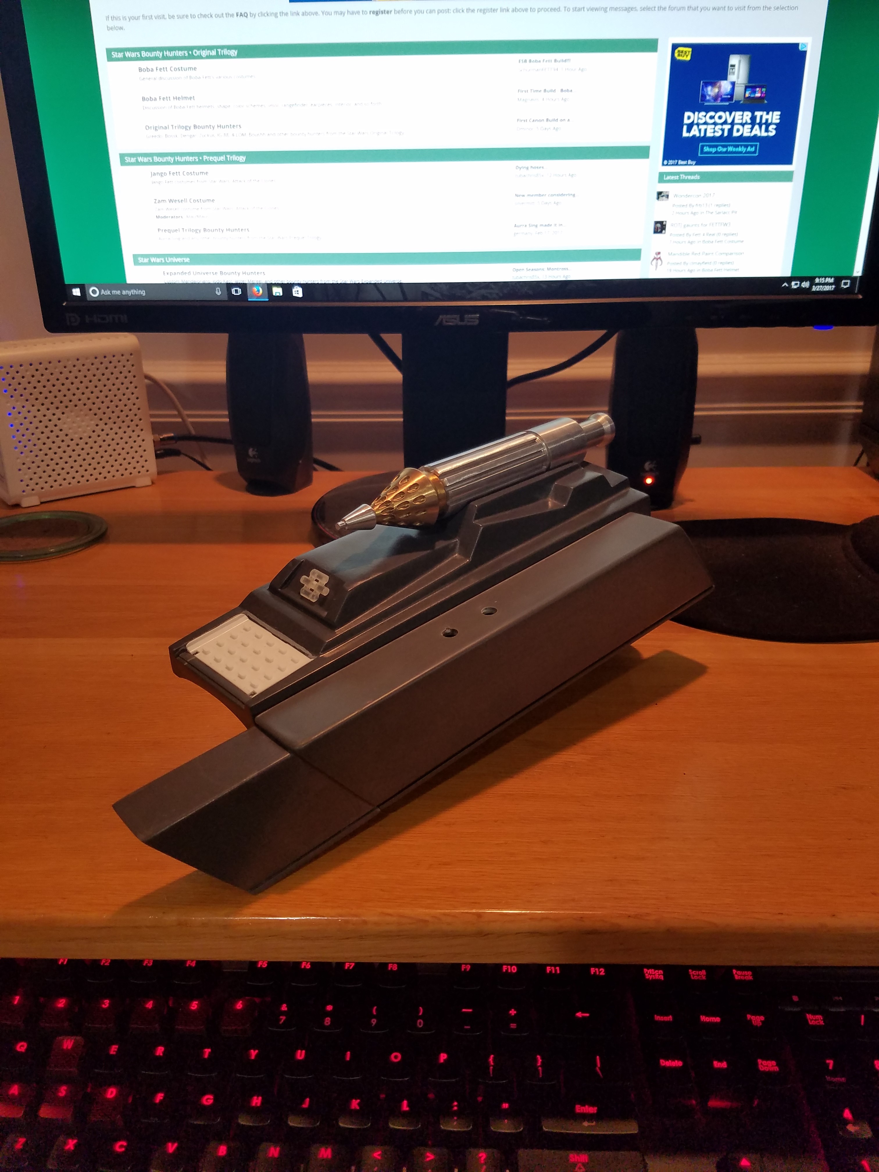

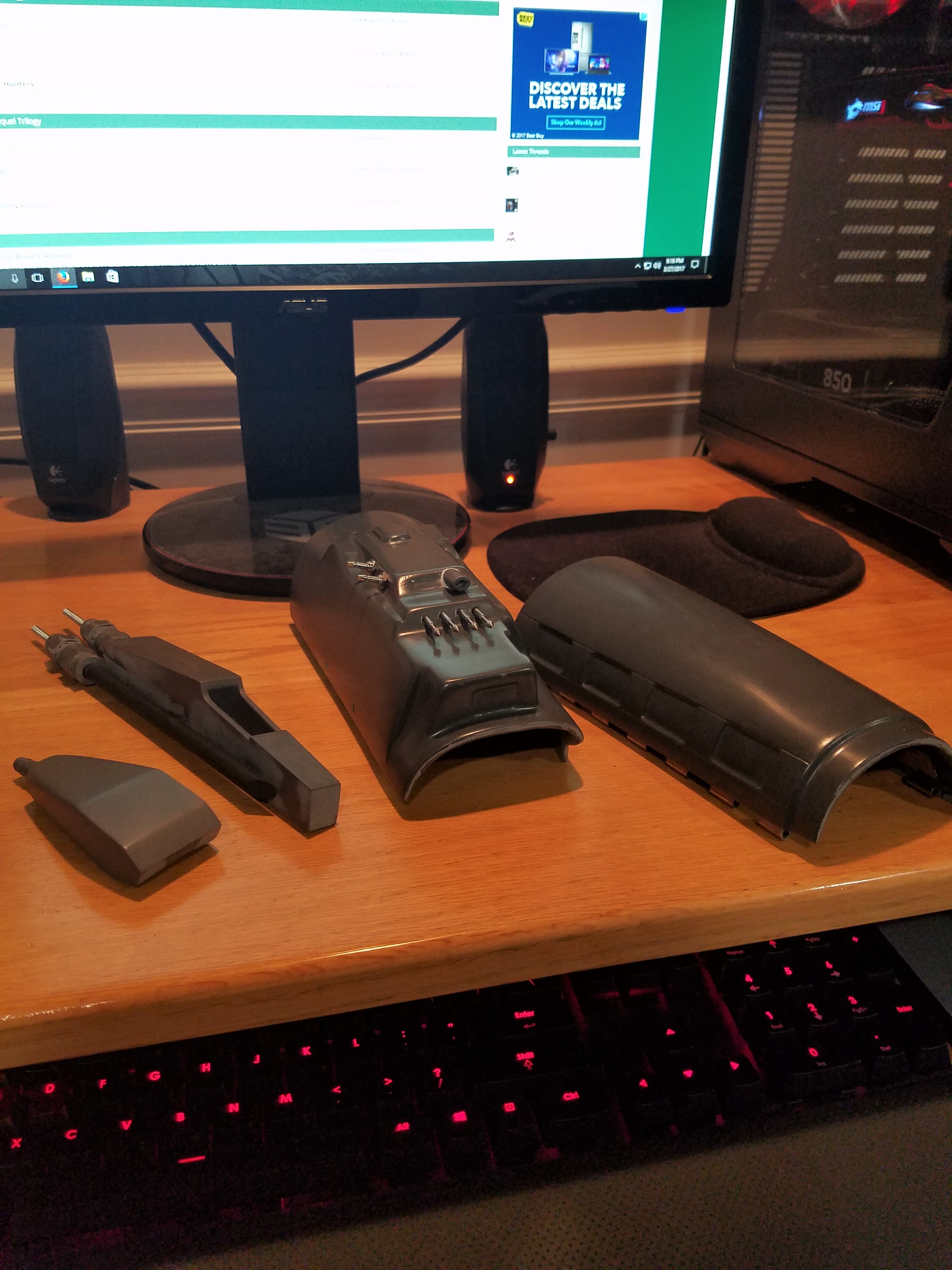

It's been a bit since the last update but I've been working on my gauntlets. I got a set of fiberglass gauntlets from Cruzer when he did a run last year and I'm very pleased with them. I used piano hinge as the closure but I didn’t use them to actually hinge the gauntlet. This way no hinge is exposed and it gives it a really clean look.
I attached the hinges with quick setting epoxy as well. For the flamethrower body, I lined it up where I wanted it and marked it with a sharpie. Then I drilled holes in the shell of the gauntlet and marked the holes on the flamethrower body.
After drilling them out I was able to put Chicago screws inside of the flamethrower body so that I can access the battery for the electronics inside of it. Getting the screws inside of the body was a bit tricky since I couldn’t get my fingers in such a small opening that far back to my drilled hole. I had to put string through the hole and then put the Chicago screw on the string and tied a washer to the end of the string and pulled the screw to the hole. I also epoxied the Chicago screws in as well. The only thing that's left now is paint and attaching the whipcord launcher and the top hose connector.
