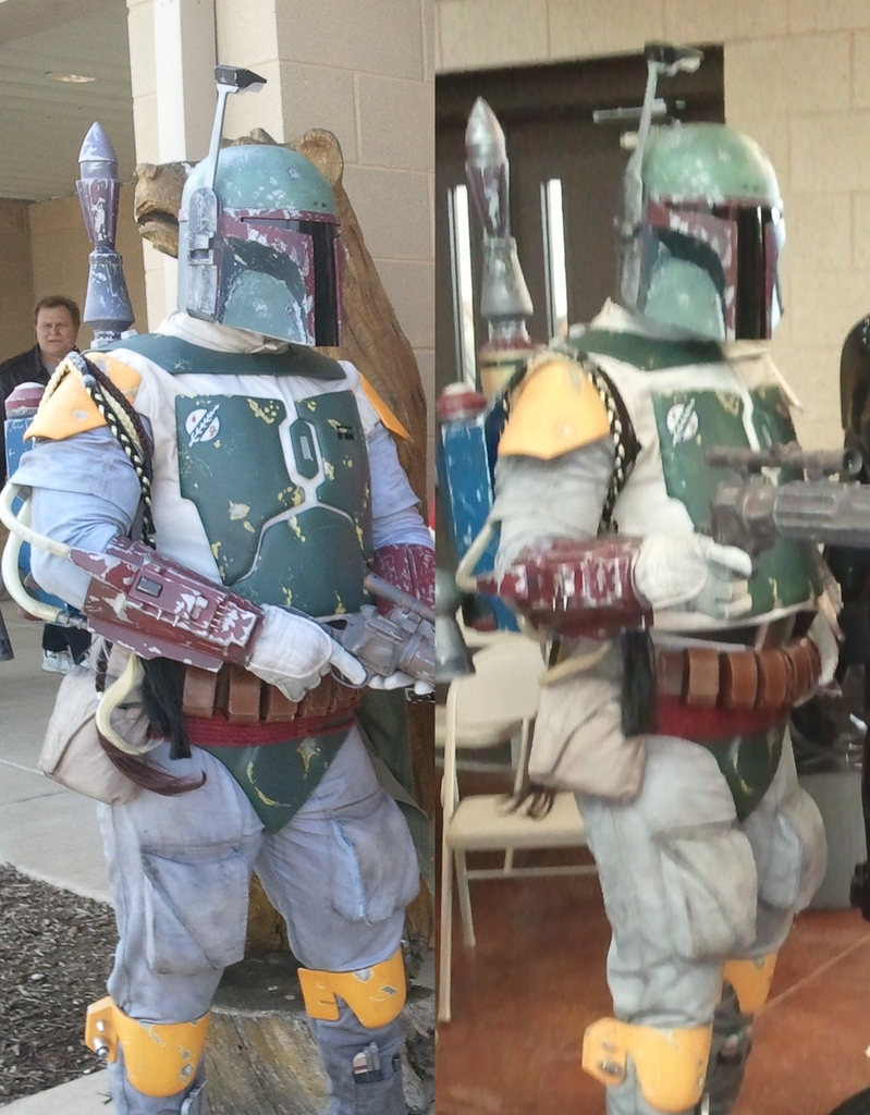

This gave the light gray coloring, but the seams still have the blue hue. For the weathering I used a combination of acrylic fabric paints air brush & some spray paints. Using browns, grays, & black. I wet the suit & applied a very diluted acrylic paints to the suit which allowed the paint to absorb into the fabric & give a natural look. Then air brushed & spray can to hit the larger areas. In different lighting it gives a different appearance in color.

Here is a photo taken at at troop on the same day inside & outside to show how lighting affects the coloring.
I hope this helps some.

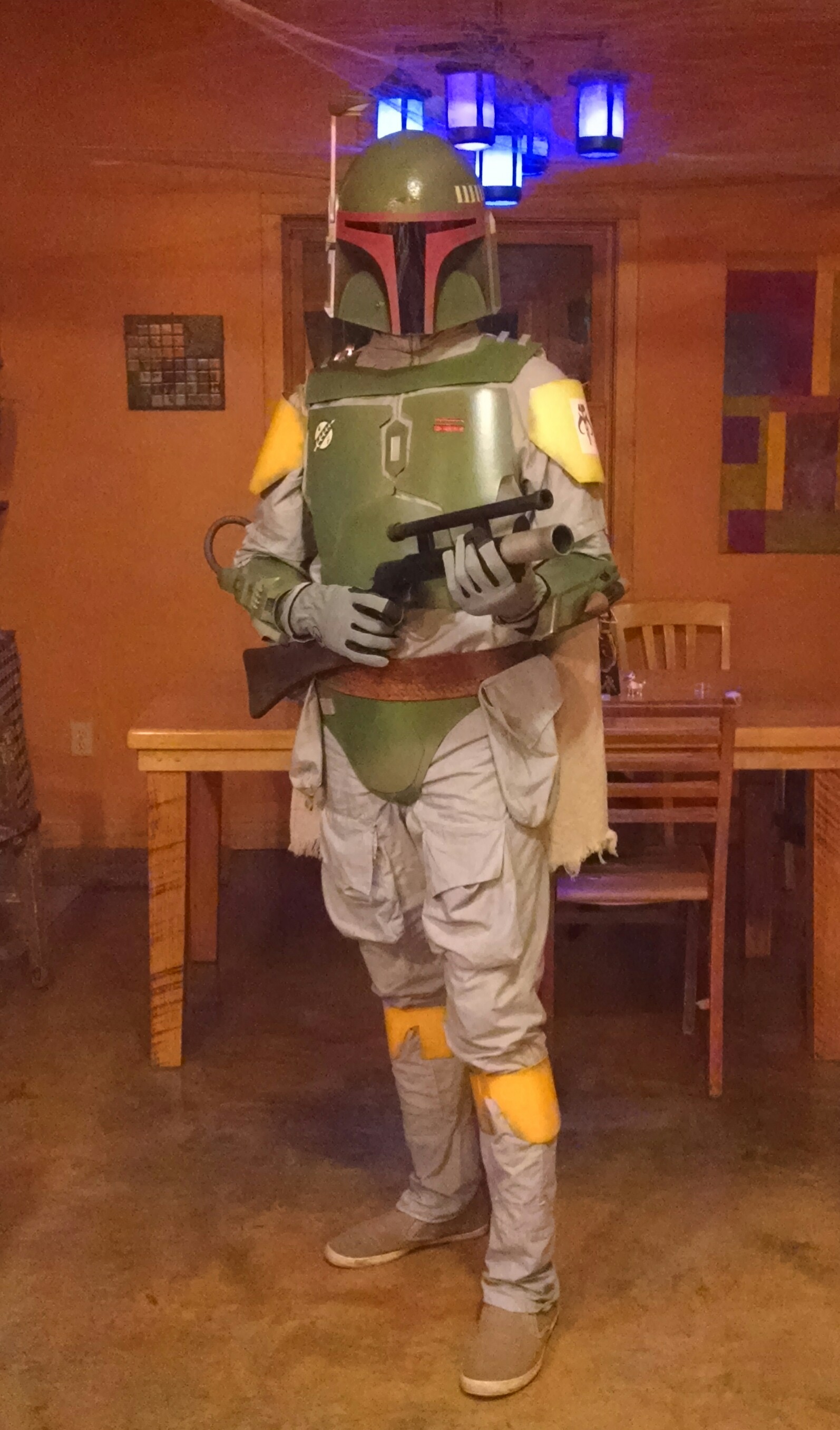

I'm relatively new here, but I can share my experience. I made my own flightsuit from lightweight white cotton twill and dyed it using Rit Pearl Gray liquid. My suit weighed less than a pound dry, so I used 1/2 of an 8 oz. bottle in 3 gallons of just boiled water, and added about 1/2 cup of salt (all I had, should have been 1 cup for cotton).
I did this in a canning pot that holds about 5 gallons. It immediately turned quite dark gray and purplish and I was very concerned. I left it in for about an hour, stirring occasionally, and then took it out and rinsed it repeatedly, until the rinse water was clear, and then ran it through a wash cycle in a washing machine, and dried it on low.
The result is pretty good in my opinion, and as has been mentioned the warmth/coldness depends on indoor/outdoor lighting:

can you please post larger pics? would love to see more detail. thanks!
