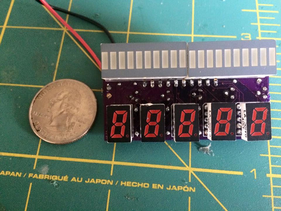

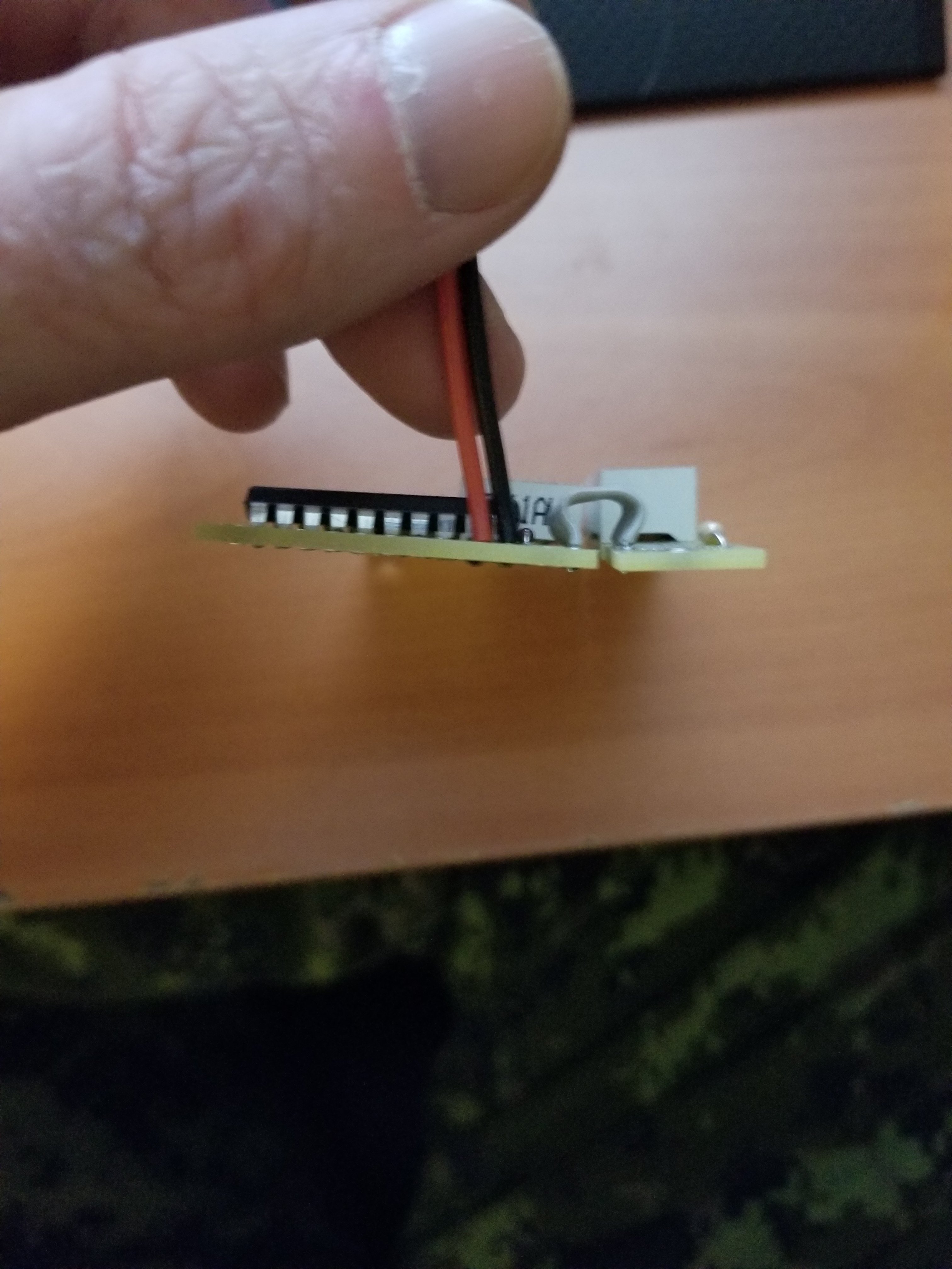

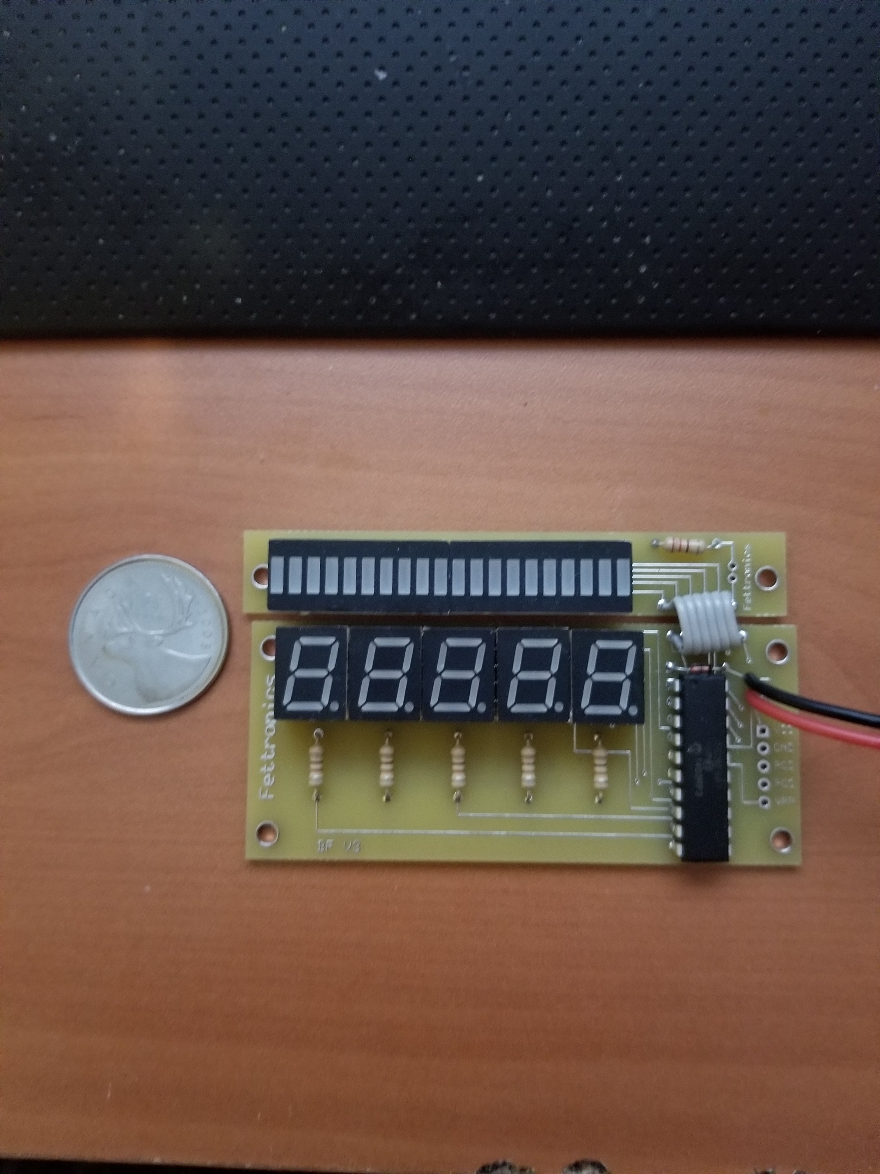

Your gut is right. The lower profile is reason enough. Size wise theyre both slightly oversized.... Fettronics did a run years ago with original sized parts a few of us got them REALLY legit. The numbers and the bars are smaller (by a fraction) which lets you cut the hole in the chest to the correct size. Either way I recommend Fettronics....
Slimmer profile, cost, and availability were what swayed me to get a Fettronics. I got the Rafalfett sequence and I am very happy with what I received. Jon works and ships quickly.
To be fair though, I have talked with a few members who love their hotpockets boards. I will probably look to get one down the road after completing my build to see which one I like better through practical comparison.
Fett4u
I have a hotpockets chest set and while I like it overall, I do not like how much it sticks out. so for my next set I will be using something with a lower profile.

When I first designed the light set using the PIC chip, I did a battery life test to see how long 3 AA batteries would last. I kept it running for 3 days straight before stopping the test, not because the batteries died, but because I figured no one would be trooping for 3 days straight, so what was the point if they lasted longer :)
If you get the light set with red LEDs, the 3AA battery pack works fine. The red displays I use are very bright at lower voltage and don't really require a 4th battery. The other colors take a bit more power to light, so a 4AA pack would be a better choice for those.
