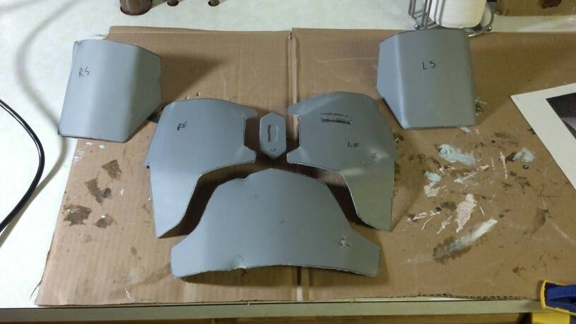

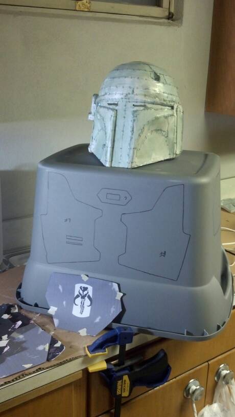

Well I picked up a big plastic tote and printed off Rafal's templates for the chest armor. I think I am going to use the plastic tote for my chest armor, and use Fierfek's peps for the collar, backplate, gaunts, and knees. Today I'm gunna try and heat and bend the chest armor pieces. Let's hope this goes well.

So I decided to go the Box-a-Fett route. Seems to have come out pretty well. I just need to round the edges a bit and clean them up.
