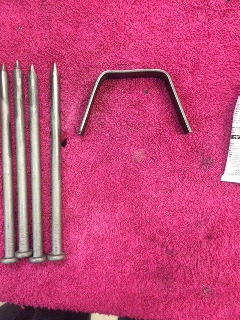

Materials:
Steel Flat Bar 3/4" wide (you only need about 1' but I could only find 3')
4Galvanized Steel Nail Spikes
4 Small Flat Head Screws
4 Small Round Head Philips style

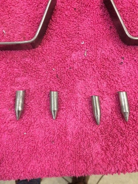

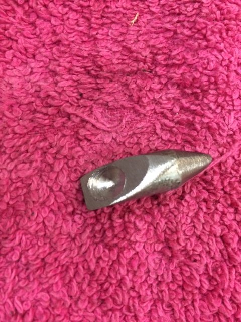

Round off the square tips of the nail spikes with a grinder.
Grind down the tip to flatten it out a bit.

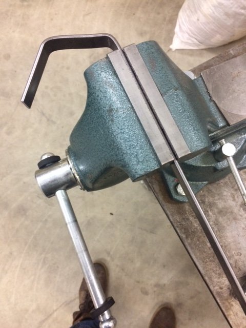

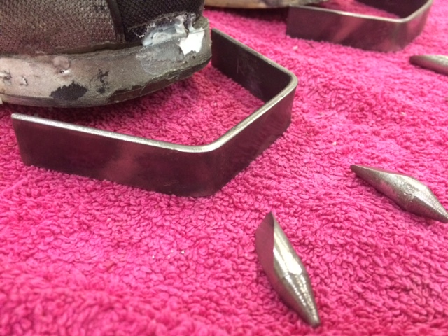

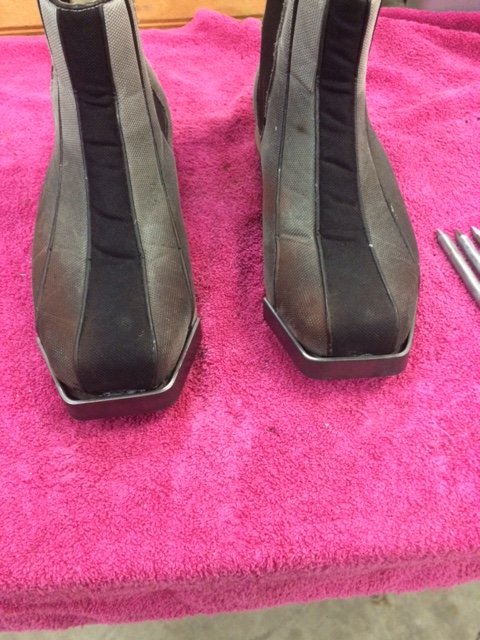

Measure your boot and bend the flat bar accordingly.
Also for a clean bend and less mark up from the vise, use
extra flat plate between the one you are bending and the vise
grips. The markings do however add a very cool weathering texture
from the vise grips.
Weather to your liking.

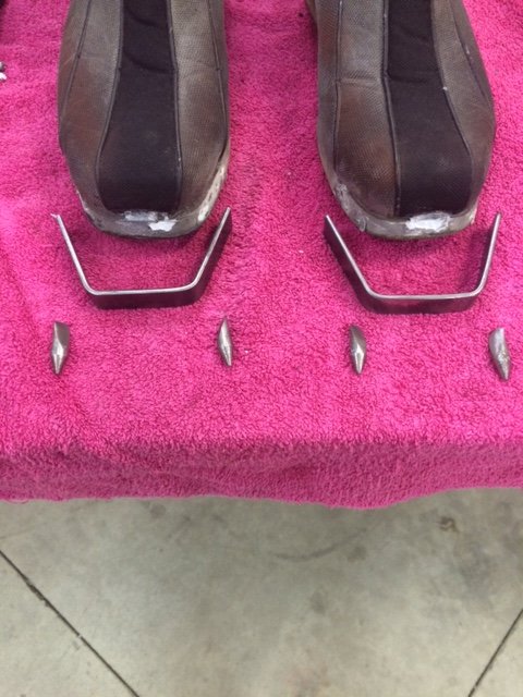

Match up the flat bar with your boots.
Cut the nail spikes to length.

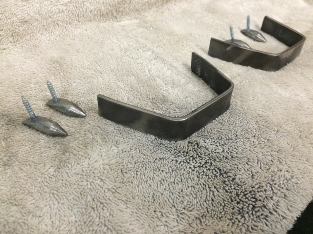

Grind off and angle your spikes according to bend in flat bar.
Match them up with your flat bar.
Drill a hole in the spikes to the rear deep enough to recess your flat head screws.
JB Weld your screws in the recess making sure the screw
is at a 90 degree to the angle of the spike.
Let the JB Weld cure for 24hrs.

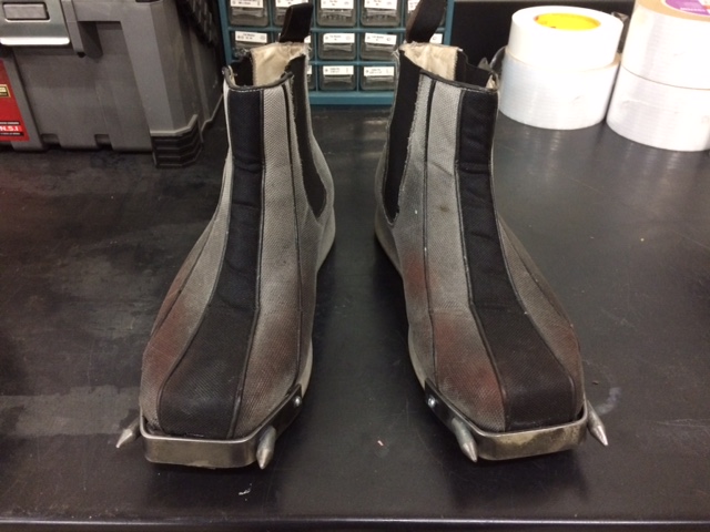

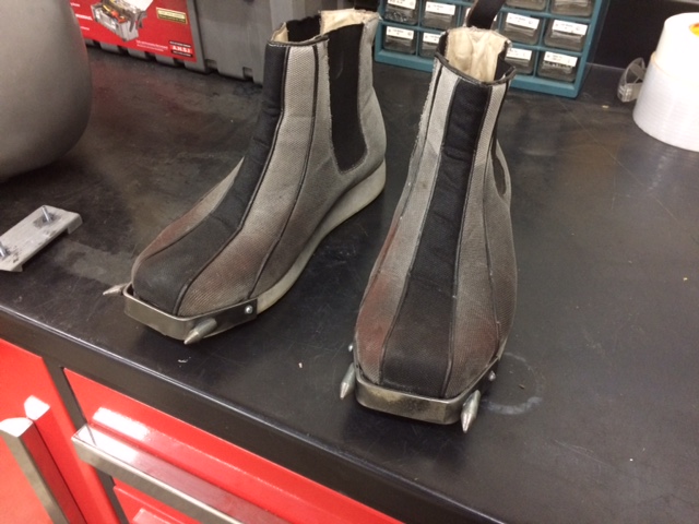

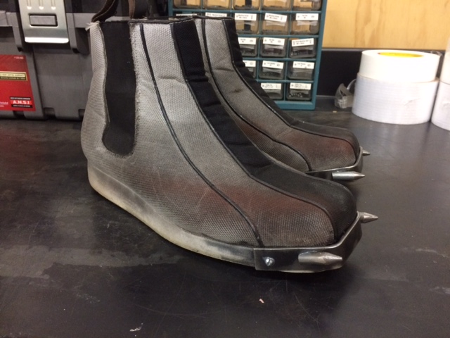

After the JB weld is done curing on the spikes, drill holes in the flat plate for the spike screws to go through and JB weld them to the flat plate once attached to the boot. Then Screw in the Round Head flat head style screws towards the rear.
Finished! Not 100% screen accurate I know but you can definitely get it there with the right boots and a good eye! Hope this can help some doityourselfers
