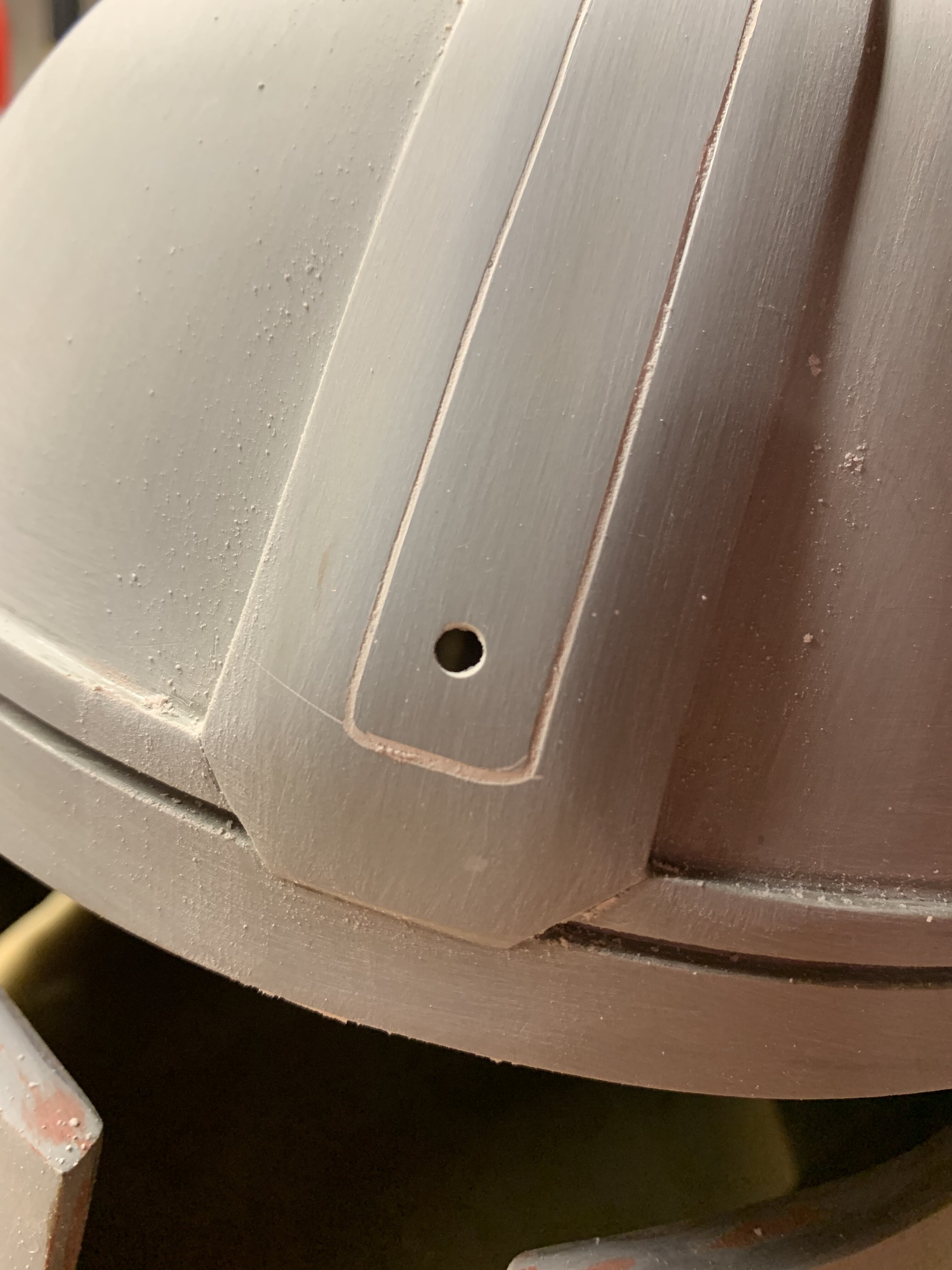

Don't overthink it. The scribe line you produced is clean enough and the triangle file will follow the path, make it slightly wider and straighten it out as long as you go slow and lightly. You can see I still need to work in the front still.
bigkidbiggertoys
I did it exactly the way you started, with a straightedge and scribe, followed up with the needle file. I didn't get it perfect but with a bit of spot putty and primer it will look good in the end.

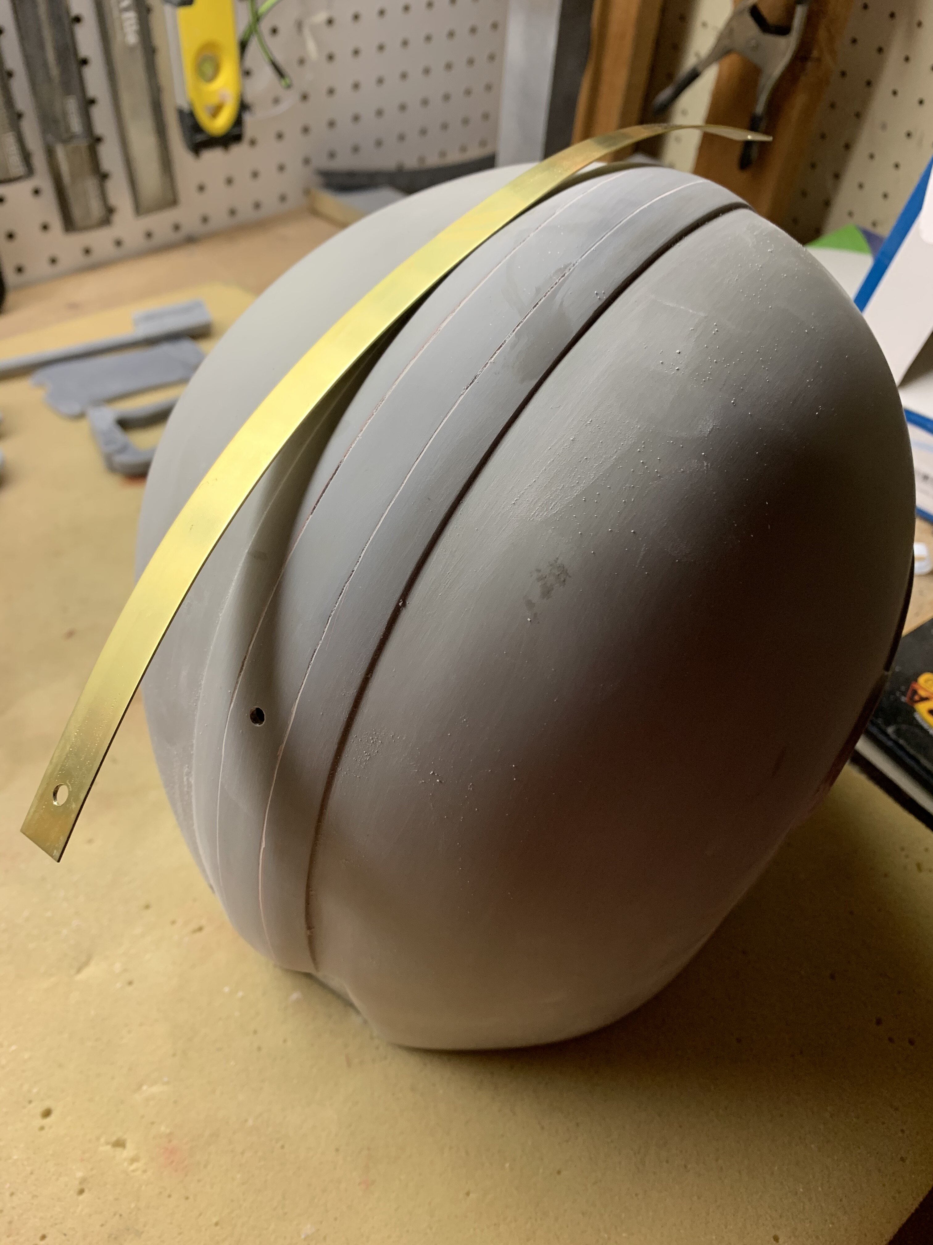

Hey all, got around to doing it this weekend and was a total success. filled the gaps with Spot Putty, (I didn't have any regular body filler on hand), let it dry, sanded it, and then soaked it in thin super glue. Let that dry, sanded again till smooth. Bolted down the brass strip guide ( I drilled holes in the crest to bolt the strip to), filed along the guide with a cheapo crosscut triangle mini-file, then filled the bolt holes and sanded it all smooth. Looks great. I'll post pics tomorrow.
Appreciate all the advice and guidance!
