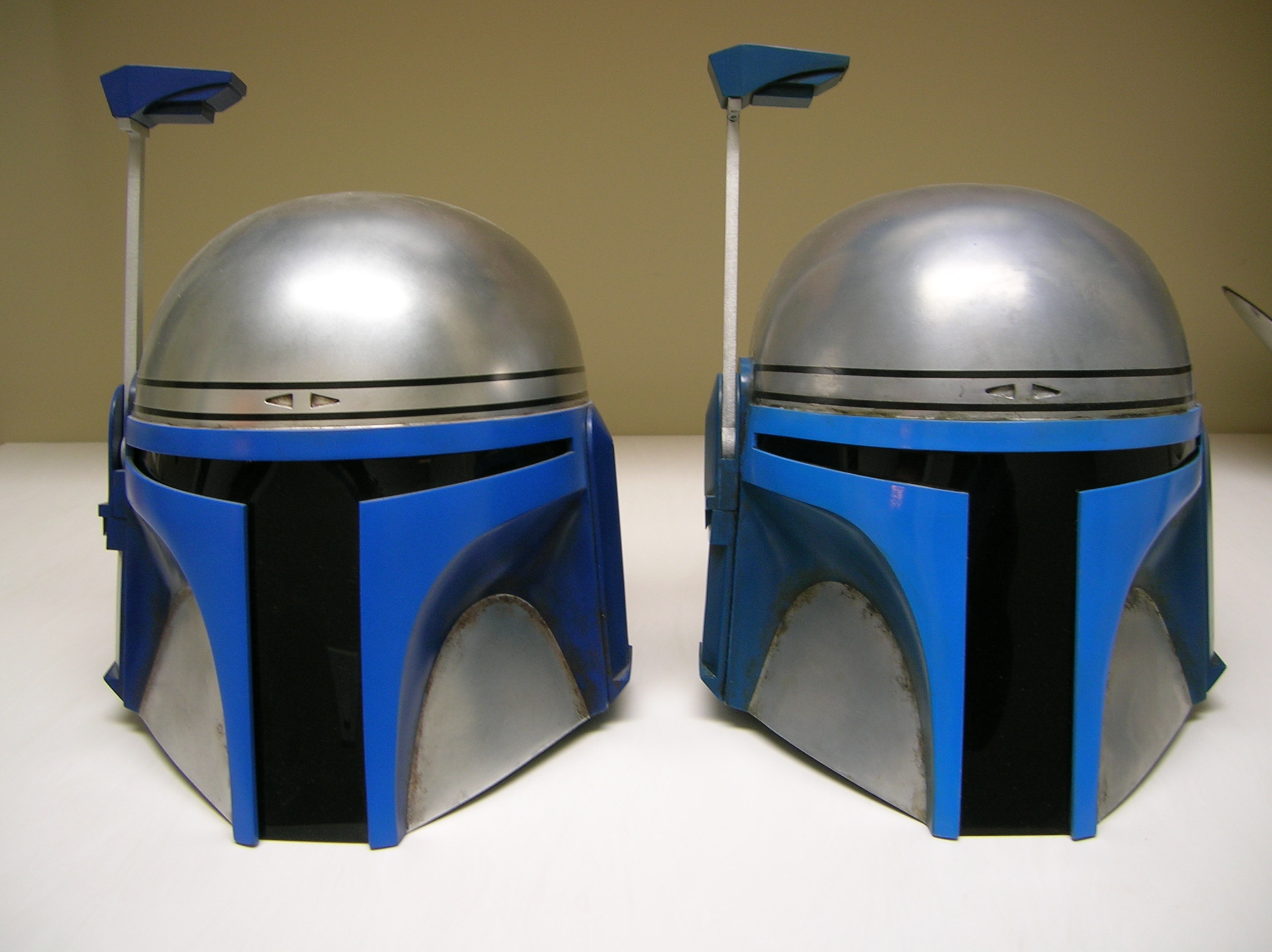

I have posted a pic before of a rub n buff & Alclad II helmet. They are very similar but the rub n buff one acquires a nice, worn patina to it. Can you tell which one is painted?
Right is RnB and Alclad on the left?
I've never used alclad myself but from pics of others helmets I've seen is that it's extremely shiny. The one thing about Jango is that the silver is somewhat shiny, but you're going to have to beat it down a bit to dull it out. You'll see that a cold cast helmet compared to an RnB, that the cold cast is actually "darker" in appearance where RnB is "brighter" silver, which is why Vince mentions adding a patina
