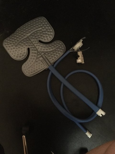

I tore apart a Kodiak cooler that I got from one of my surgeries. The pump is small, so I'll be able to print a mount for it. The tubing is insulated, which will help keep the water cool, while in transit to the pad. The pad was for my shoulder, but it will work nice on my back. Here's a company that sells a water cooling backpack, with the same size pump as mine, and theirs comes with a 12V battery pack that lasts four hours. I ordered a camelback of sorts that is insulated to help stretch the cooling time. I've already hooked it up once and it works awesome.
