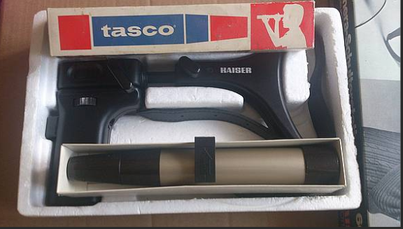

The blaster:
You have some options like 3D printing, like RafalFett models. I know Stormrider should be working on a sling gun kit.
However, if you have some patience, you can find most of the real parts on ebay. The pistol handle and shoulder stock are Kaiser camera holders, while the barrel is a Hand Telescope. The barrel holder and under barrel attachments that you see in the references were fabricated for the gun and were no real part that we know of.
